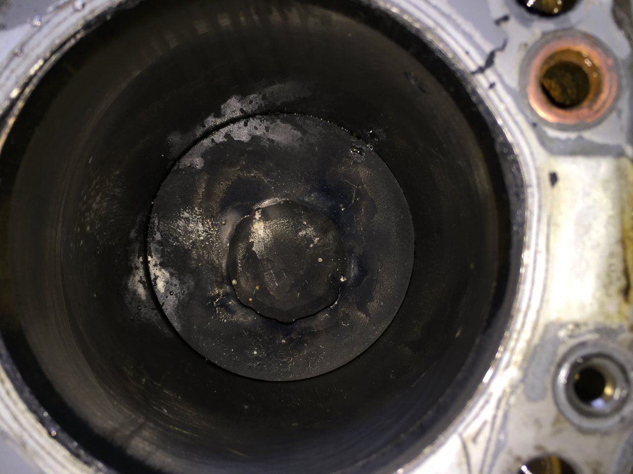

Thought i would dig this thread up rather than making a new one.
Im up for a rebuild on my early 1HDT as well, cracked a few pistons, and so far from what i can gather from my searches (someone correct me if im wrong but)
Using the later pistons and larger injector washer is best correct?
Also genuine pistons are best? are they the same as ART pistons? i did find some place selling ART pistons with the note "(genine toyota)" beside it.
And yes or no to ceramic coating? i have read some conflicting stories on weather its worth it or not.
Also anyone played around with the edge of the combustion bowls, i did read on some cummins stuff they like to remove the sharp edge of the combustion bowl to make a nice smooth radius into the bowl to avoid hot spots
Engines Australia engine kits have a good reputation and are generally well priced.
I have talked to them on the phone and they sound like they know whats up. ill just have to make up my mind on how much id like to spend hahah. So no one has any feedback on ceramic coating pistons?
Ceramic coating might help mitigate hot spots and even out temps across the piston more decreasing thermal stress on the piston crown.
I wouldn't go radizing the rough edge on a piston bowl without considering carefully it's purpose. Lots of studies out there looking specifically at bowl shapes and injector angles and bowl tumble and how the edge of the bowl deflects the flame front away from the cylinder wall and prevents the flame front from easily crossing the top of the piston. Im not saying you can't improve it, but the odds are against you as it works in conjunction with the injector angle and the spray as it projects as a cone. Altering it without some serious thought would be like taking a die grinder to your ear canal to open it up so you can hear better. Subtle nuances on bowl shape have dramatic effect on combustion characteristics.
What id like to achieve is a engine that will hold together at current power and torque levels (around 150kw and 600nm), it has been running on this set up for around 80,000kms now had a total of 563,000kms on the engine when it s*** the bed, injectors tested fine so im thinking it may be a combo of the tune on the warm side and pistons that have been up/down and hot cold a billion times and have just given up.
So really a standard rebuild will probably be fine for a long time but i figure while its apart i may as well do as much as i can to help avoid a similar failure in the future.
Im no expert but from what i can gather from my reading so far is that the ceramic coating helps keep some of the heat out of the piston, that along with the standard oil squirters keeps the piston temp down. So in a petrol engine the ceramic coating dose a similar thing?
Yes that makes alot of sense on the bowl mods, ill have to do some more googling and see whats out there, sounds like it may just be be safer to leave it be haha.
