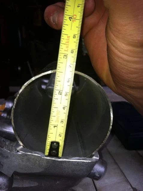

I am limited to using 3" pipe on my plenum due to hood and water line clearance.
Hopefully that will be enough to help and notice a difference.:meh:

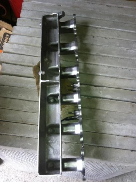

Looks good size. Are you entering from the top. Cause if your coming from the front shouldn't yoube taking the center divider thing out. Oh and might want to roll your pipe so the seem get cut out
The picture is just being shown with a piece of 3" SS for a size comparison.
I haven't finished the machining aspect of it yet

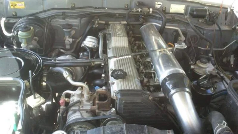

Yes I am going or a centre entry of 2.5" for a top mount ic

On another note this was found the other day:

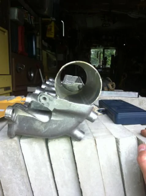

I may have to do a slight angle cut on the rear end of the log manifold for coolant line clearance. I am hoping to get my length of 3.5" aluminum pipe today.

Its not actually tapered. The surface area of the open core is the same as the surface area of the open intake manifold. So its just distributed evenly.
