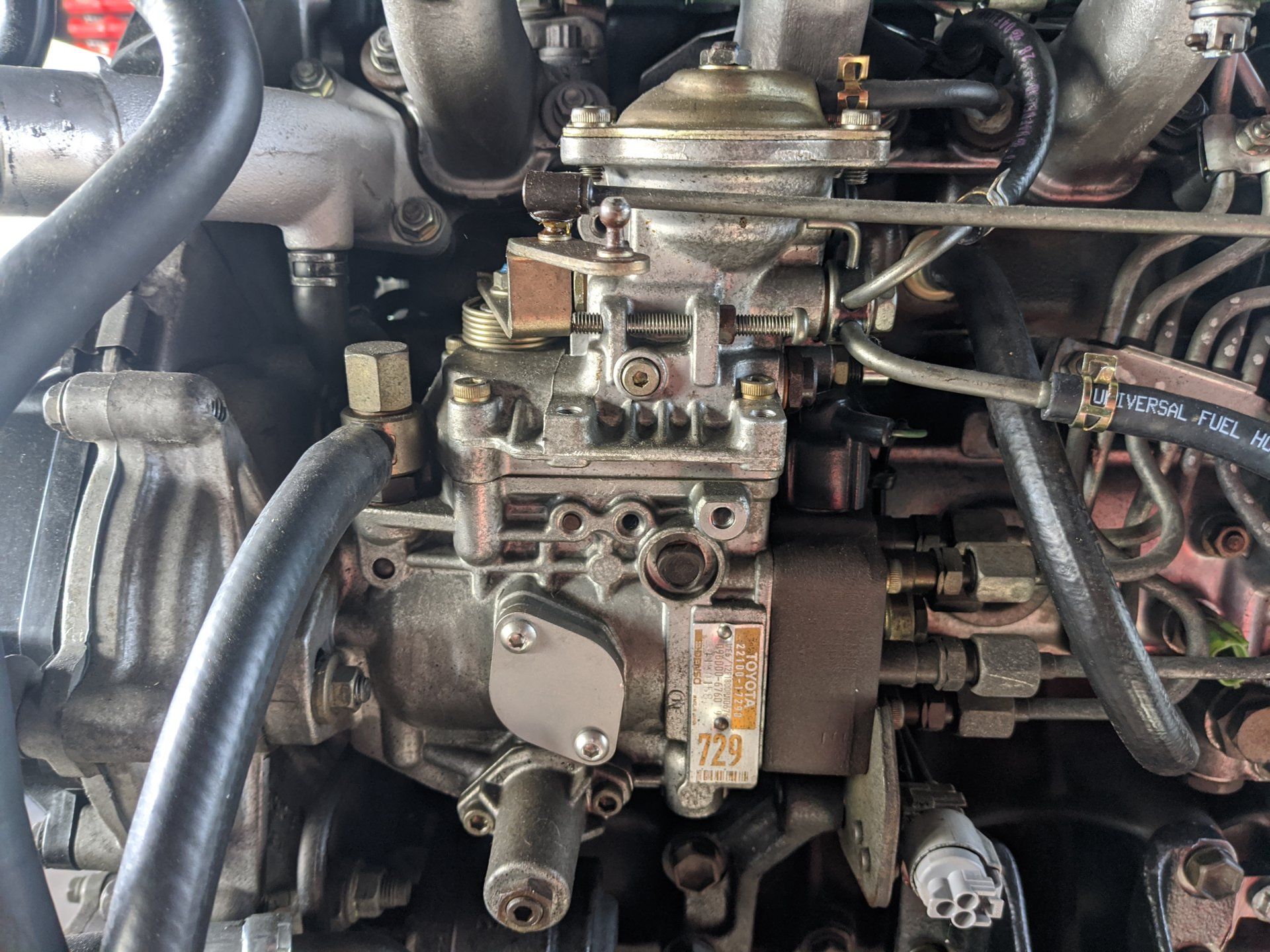

I have been looking for information here on how the ac idle up functions on a 1HD-T. On my 3B there is a valve on the inner fender connected to a vacuum switch on the IP that presses the fuel linkage forward. My 1HD-T came with ac from the factory but I cannot find anything vacuum or electronically actuated to perform this function. Does anyone know?

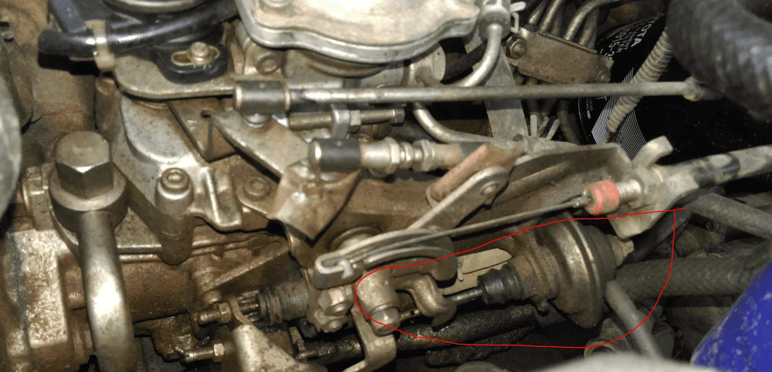

Im pretty sure its this guy:
Hmm, that part is not installed on my pump. Can anyone else confirm that's what it is? Looks very similar to the idle up linkage on the 3B. @Jroc561 if that has a vacuum tube routed to it, where is it coming from?
Wonder why that would have been removed or perhaps not installed to begin with...

The A/C idle-up Actuator is part #88031-12150
From looking at that pic of your pump it definitely had all the AC idle up parts attached at one stage. It wouldn't be hard to get the parts required and get it working again.
The vacuum lines come from the vacuum pump but it goes through the AC solenoid first. It only increases the idle when the compressor clutch is engage. Pretty simple to put back in also.

Thanks for the part number, and thanks KiwiDingo for the info.
You are correct, this motor is on a stand right now and it's going into a 3B powered 70 series. Only reason for referencing the 3B is because it also has AC so the electronic and vacuum parts are already installed in the truck. I was curious if the 1HD-T with AC does not operate with the same technology as the idle up component on the ip isn't there. I assumed this aspect would be plug and play so I was confused. In any case, my question is answered. I'll look for these manual swap threads and won't ask questions about it here.
