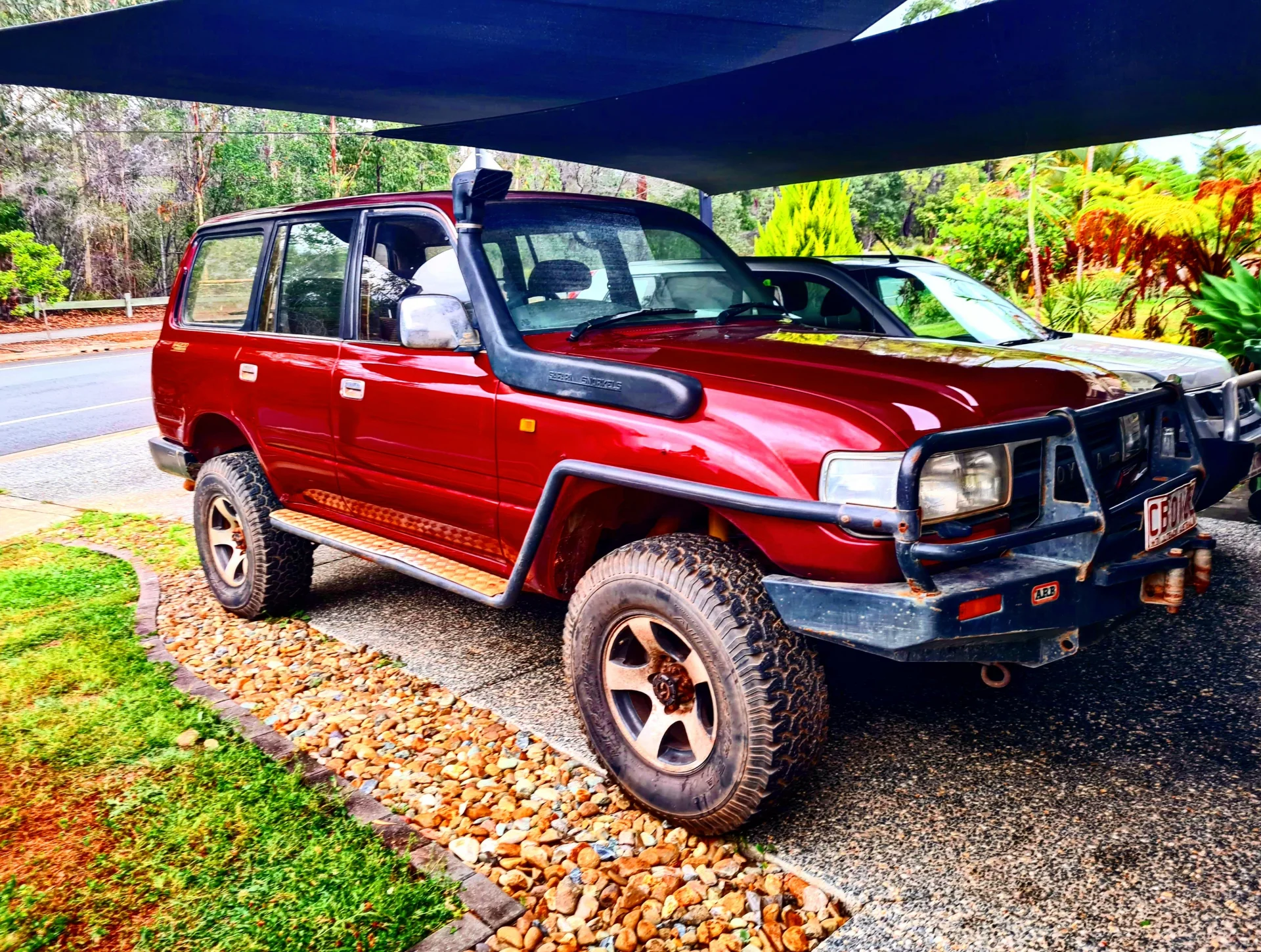

Its a '93 model. 5 Speed and a factory part time case. Its apparently a GX model which i know nothing about except it has a working sunroof, the stupid climate control AC and a fancy factory sound system

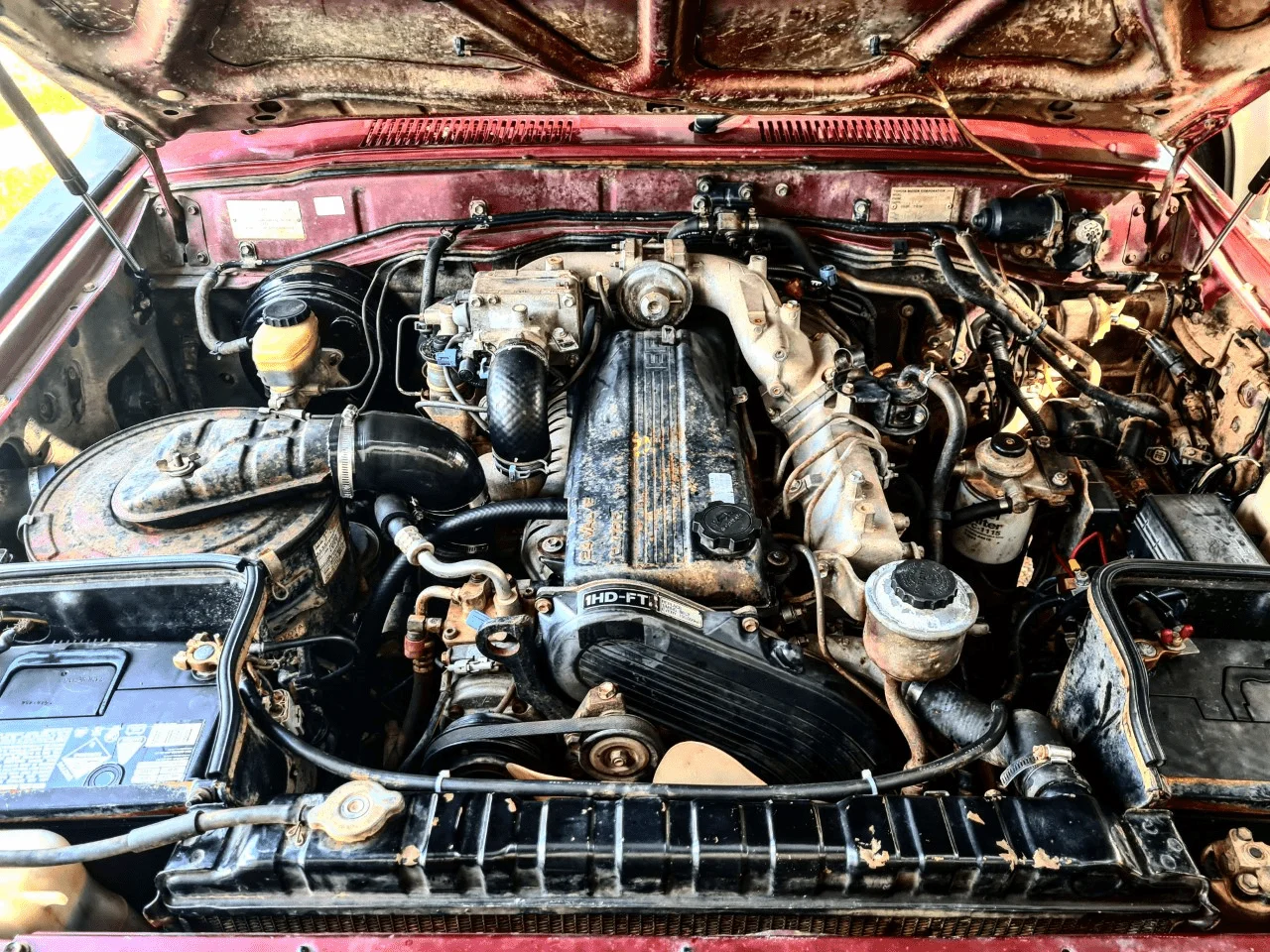

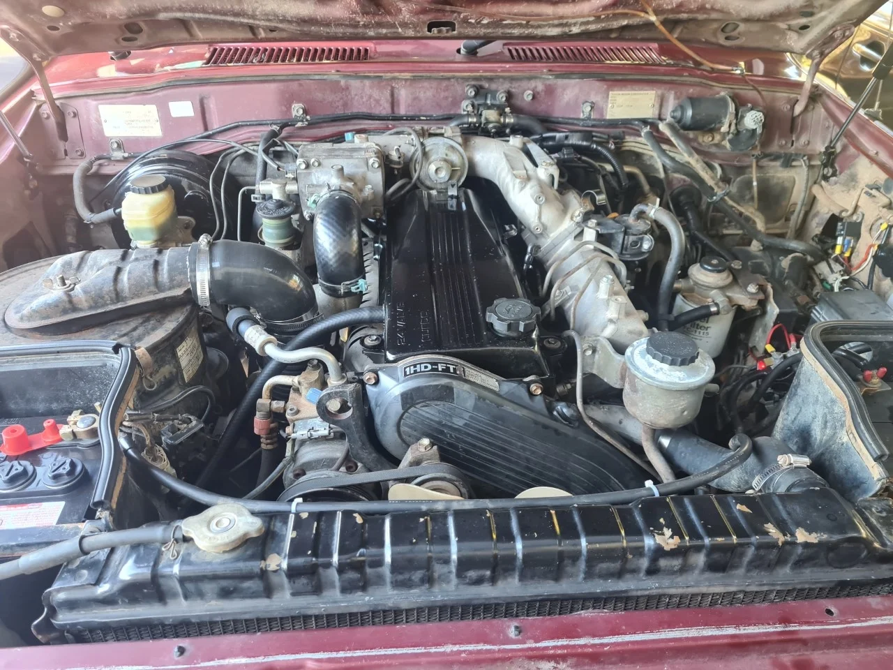

Ripped out the junk 1HD-T and put the FTE in, 1 million times better. Also fitted a 1300nm NPC clutch too, fure future proofing purposes.

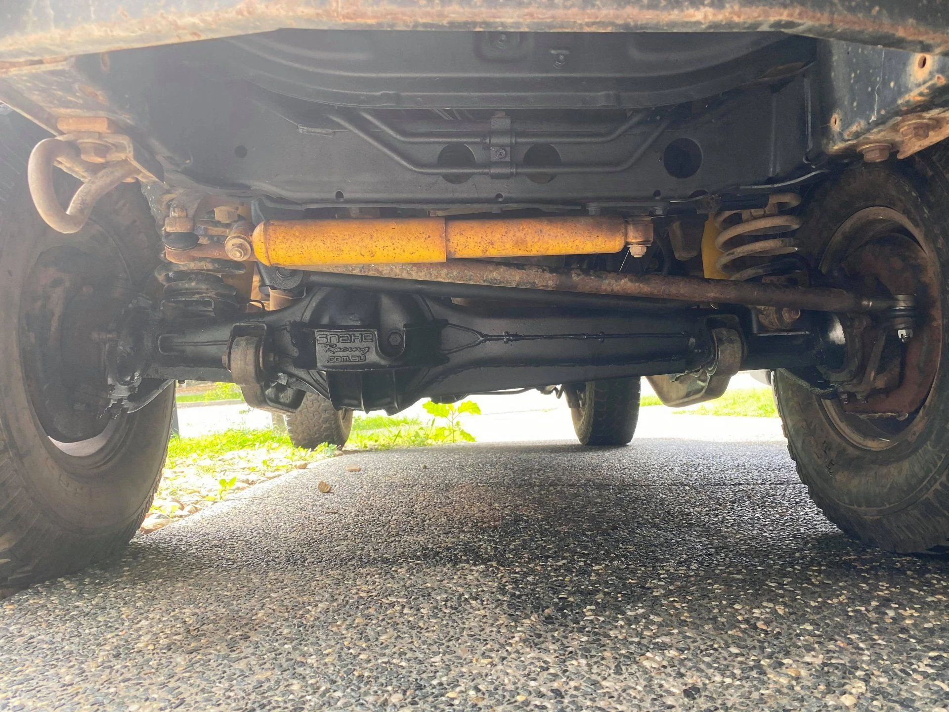

Its got 105 series axles underneath it too. 5 stud wheel pattern and the bigger axle studs and dowels. Front diff is full braced and has an ARB air locker in it and solid draglink and tie rod. Will be doing some chassis bracing and maybe hydro bumps on the front end very soon. Plus superior arms

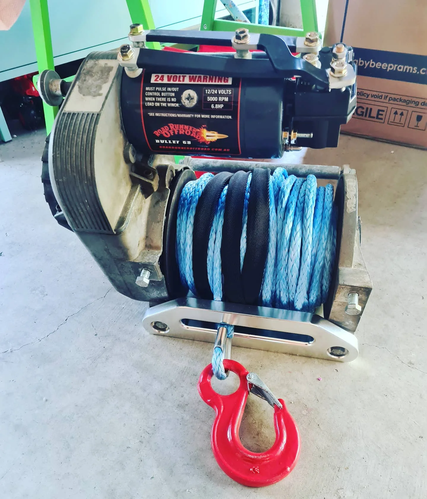

Finished rebuilding my winch, will have to hack apart grill to fit.
Knocked a few leaks and niggly little issues this week. New rocker cover gasket, inlet manifold gasket, replaced the little Oring in the rocker cover for the crank vent, deleted the EGR, deleted the intake heater element, installed a boost gauge.

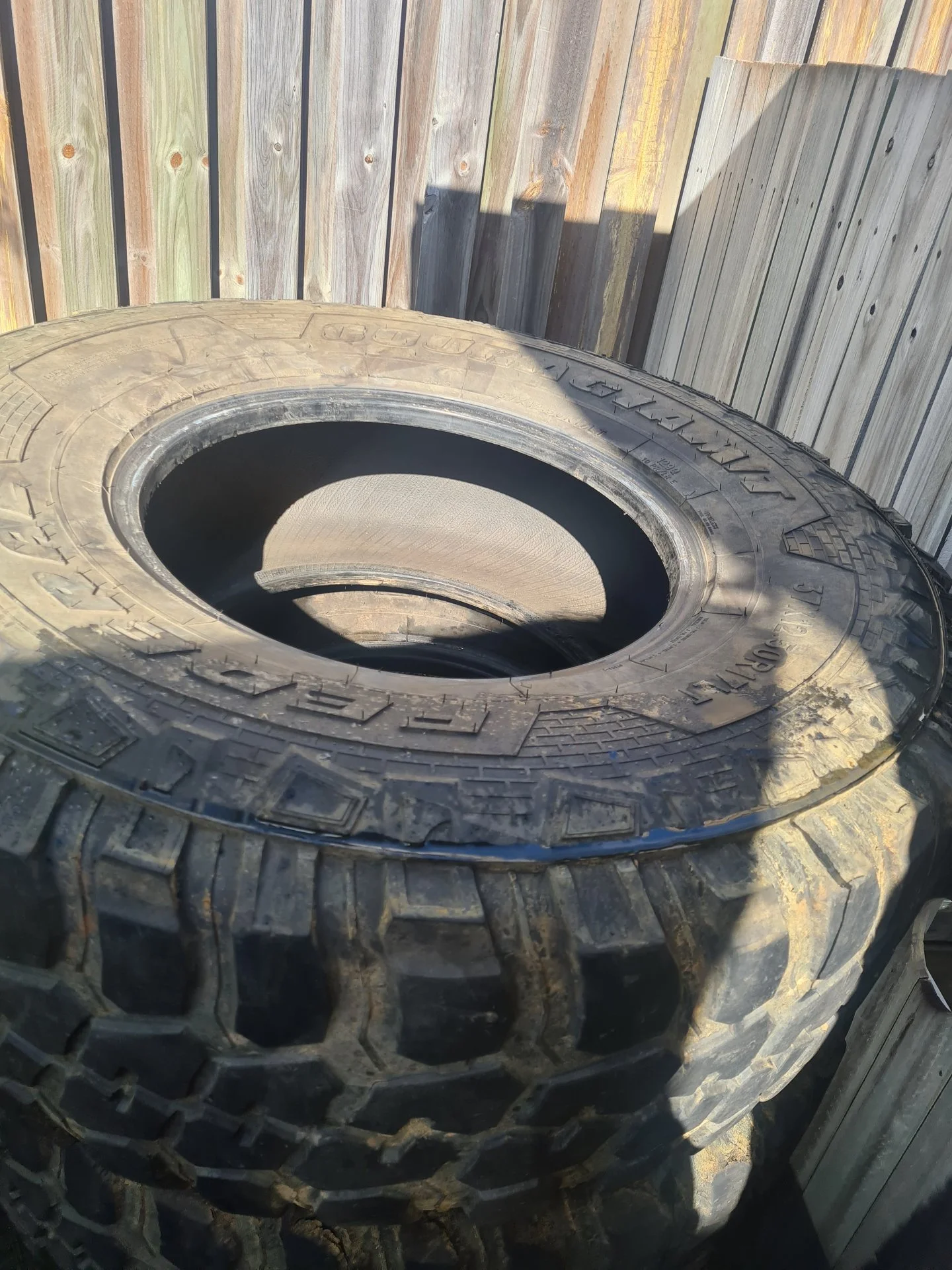

Picked up some cheap 37s the other day
37x12.5x17 Federal Couragias, pretty worn but the price was right. Will get it all setup and working before buying good ones.

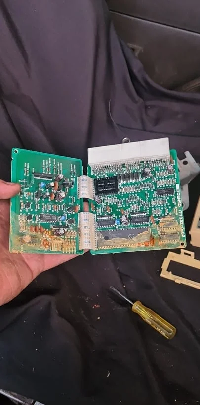

Also been chasing the auto climate control not wokring issue and finally worked up the motivation to pull the dash down to find the amp and sure enough it was toast.
Gimme cables any day lol. How do you fix the climate or is it possible to convert to regular 80 HAVC ?
Yeah cables for sure! Im not sure if this is repairable and they seem to be hard to find. Would need to get an entire donor system everything is this system is controlled by electrics so not really worth trying to do cables
