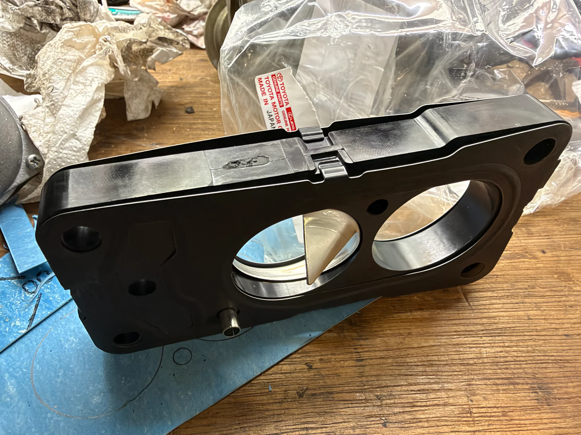

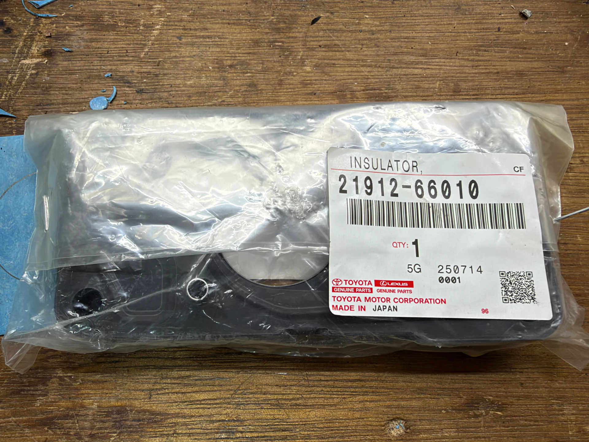

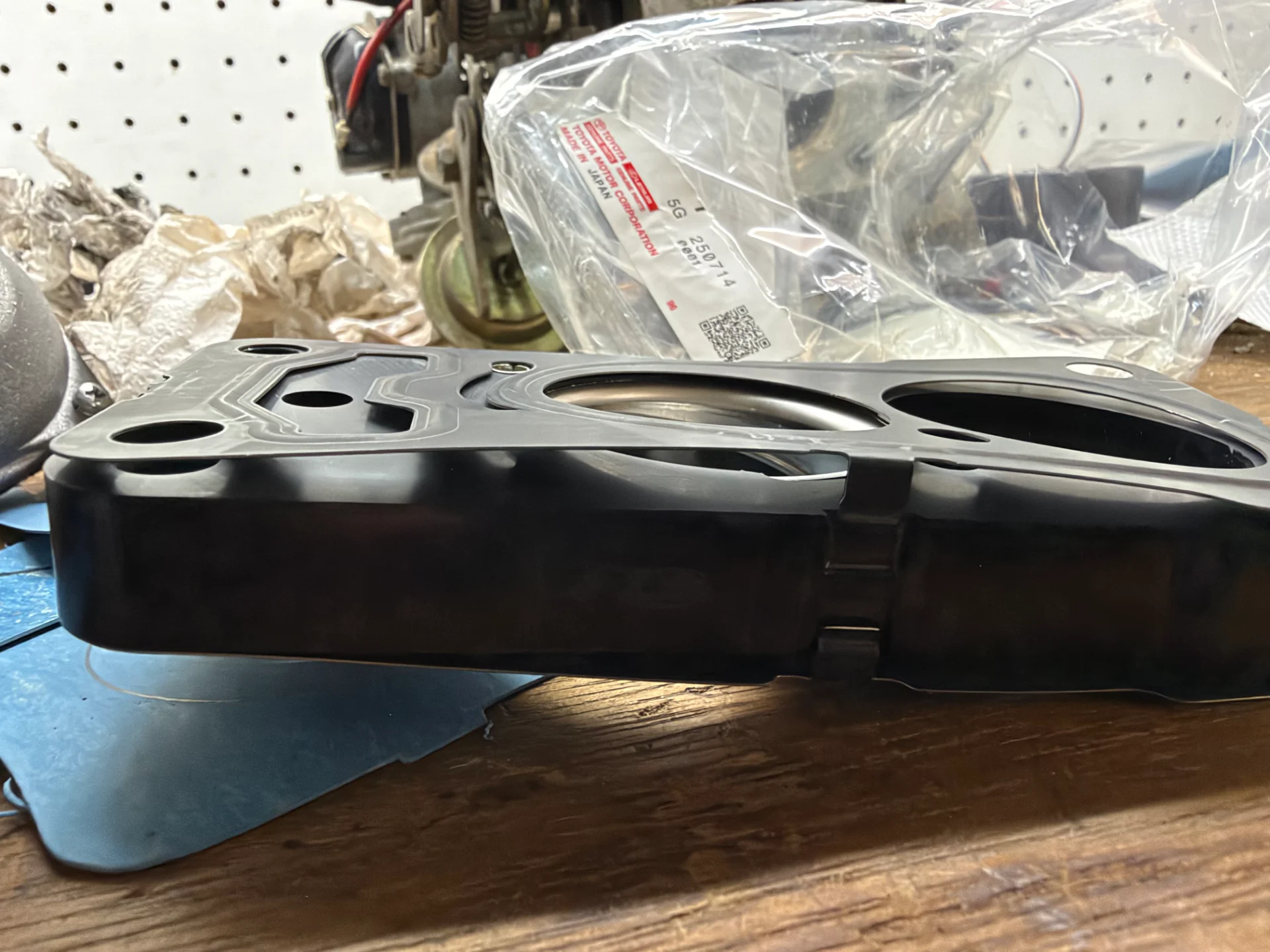

Hi all,
Replacing the heat insulator on the bottom of my 1FZF carb. Ordered the insulator and it came with two metal gaskets - top and bottom. My current one had RTV on them which was a right nightmare to remove, but somehow just metal gaskets also feels a little suspicious (so I can understand why the original work was done with RTV, but it wasn’t Toyota work I think).
FSM says just put as is. Should I do as it says or should I make a gasket from some gasket material and sandwich the heat insulator and metal gasket assembly between some more paper gaskets? Any experiences welcome.

If you notice the metal gasket have ridges for sealing, I would use them. Be easier to take off next time.
RTV and gasoline don't work well together
install clean and dry

As others have said, install sans rtv. The Toyota gaskets of this style are designed for a dry application. 1FZ-F is a great engine, I have one in my 75 and love it.
Thanks. Did it that way, looks good. Does this mean if I ever remove the carb I need to get another gasket though? If it’s a crush application it’s single use?

Correct. Those gaskets are not available separately from the insulator assembly itself.
Don’t take the carb back off.

Understood. Not that I think this information is available anywhere, but is there any guidance on when these insulators will go NLA? I feel like I should have a spare one if the carb ever has to come off for any reason, but I don't REALLY want to order one right now...
