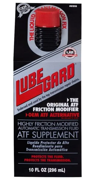

I would also add a bottle of LubeGard (black bottle) to the trans fluid. A lot of times the transmissions need extra friction modifier as things wear. Keep in mind, this isn't a fix, but buys you time before the inevitable rebuild.
Appreciate that!! Will get a bottle on order and let you know the results!
