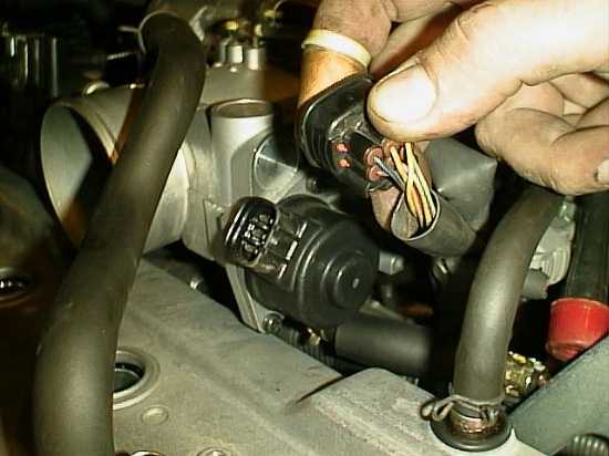

You guys can easily check it, removing connector plug from IAC valve and start engine, if RPM will be high engine is ok, mine do this but won't keep nigh under ECU controlling IAC valve, also I don't have low RPM after disconnecting battery terminal as usually it should be for FJ80 93-95

Thanks for the input guys, I tried the trick of unplugging the IAC and it did idle very high. So does this mean that the problem is somewhere else in the engine? I have a sneaking suspicion it’s my air flow meter but can’t be sure.

Pull the IAC. Clean it and the port it mounts in. Replace the o-ring.
It'll be wise to pull the throttle body as it eases the IAC removal and helps prevent stripping out its screws.
Pulling the battery resets the ECU's learned program for IAC control. I think I pulled it for 10 mins, but Cruiserdan's posts tell the correct amount of time for 93-94s.
