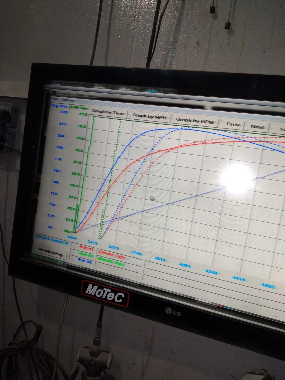

Picture of my head as it’s being worked on now:
First Run Result
Second Run Result
RED = HP , BLUE = TORQUE
First run powerband (muffler closed)
Second run powerband (muffler open)
Video of the second dyno run
Head work should finish by Wednesday, I will either take it to the dyno the same day or the day after and will post the results here.
What is this??, completely unexpected results.
Small gain in wheel horsepower, but a massive gain in wheel torque!. I expected the opposite.
On top of that I am making peak hp and peak torque much earlier in the curve, which is really good, I thought oversize valves would flow less due less velocity at lower rpm and make less low end power, that defiantly did not happen based on the results.
Before the headwork: 181 wheel hp, 168 wheel torque
After the headwork: 190 wheel hp, 230 wheel torque (+62 lb-ft !)
