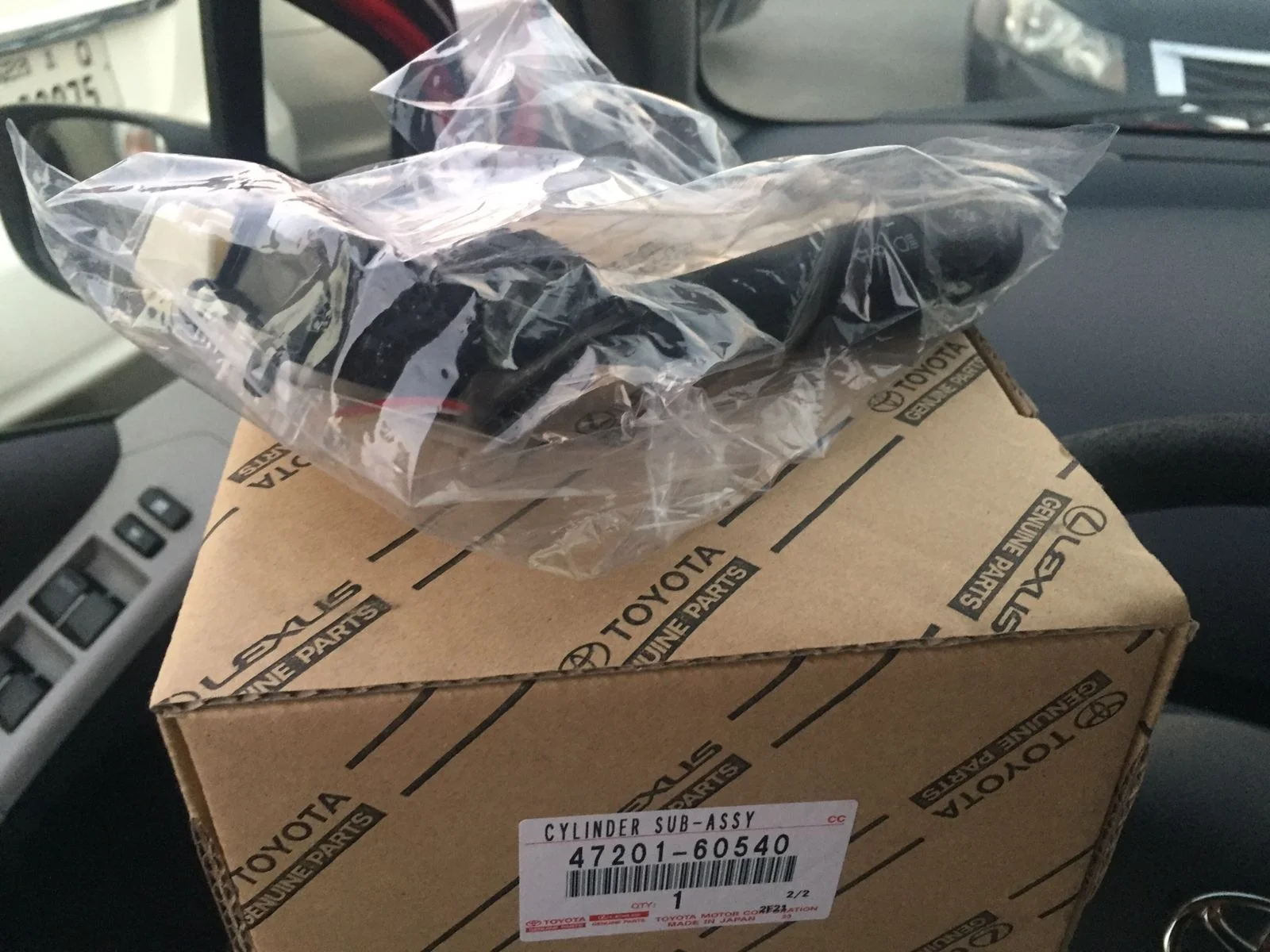

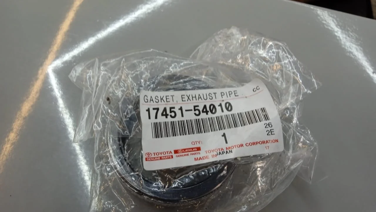

The last few items included a new control stalk, which fortunately was available new:
exhaust gaskets, etc.

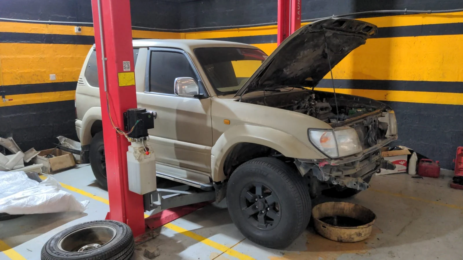

Anyways, the little truck is getting a quick bath before inspection--our understanding is that cleanliness is appreciated by the inspectors.

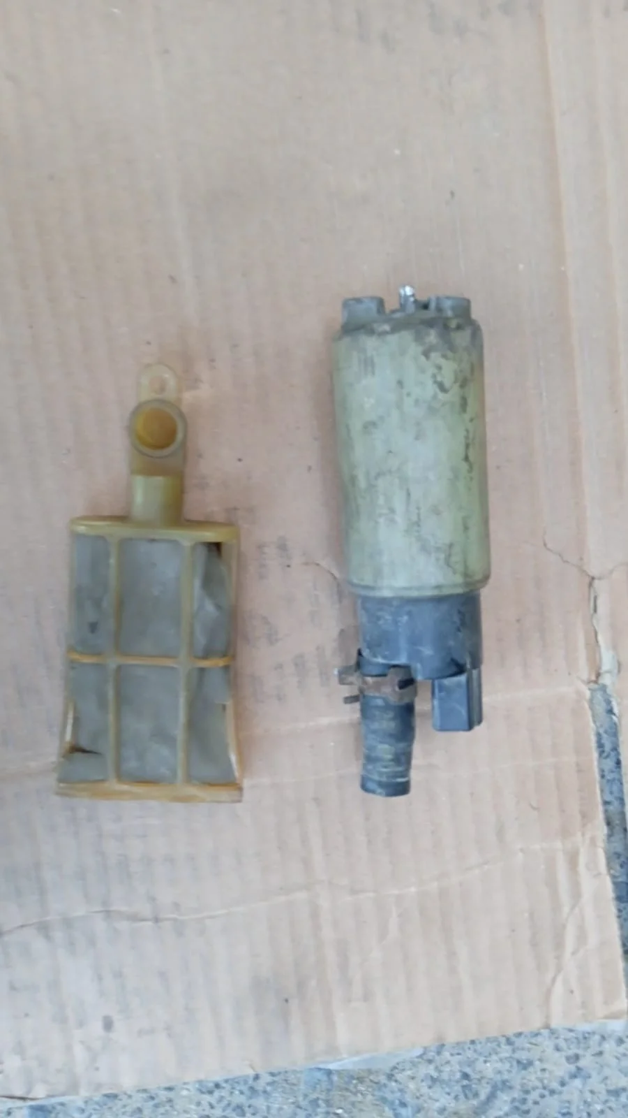

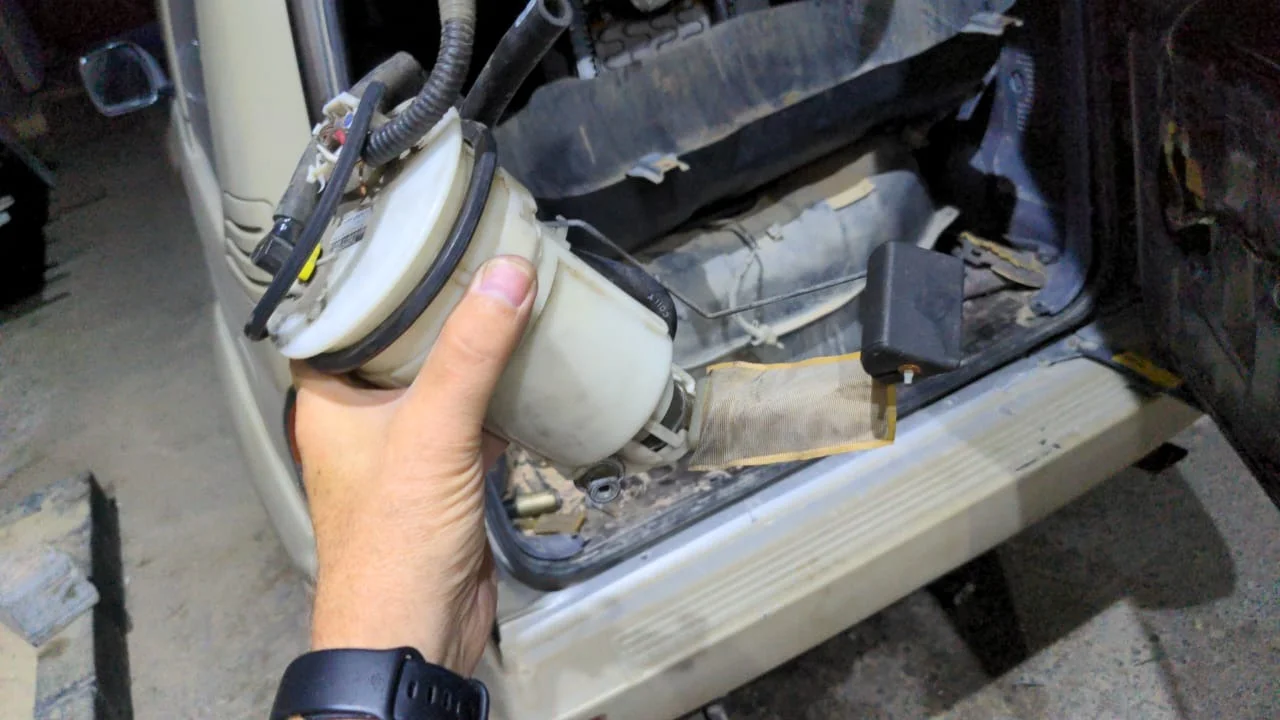

Bit of a setback today. Flatbeded the truck to the testing station but it got bashful and would not start.

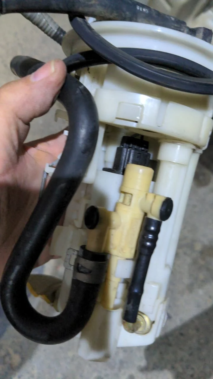

Here is the guilty party:
(Pretty sad. Now that I see it I would want to replace it in any event.)
Turned out to be a fuel pump issue. Went to Sharjah and picked up a similar assembly for the pump itself. The guys are going to see if it works tomorrow.

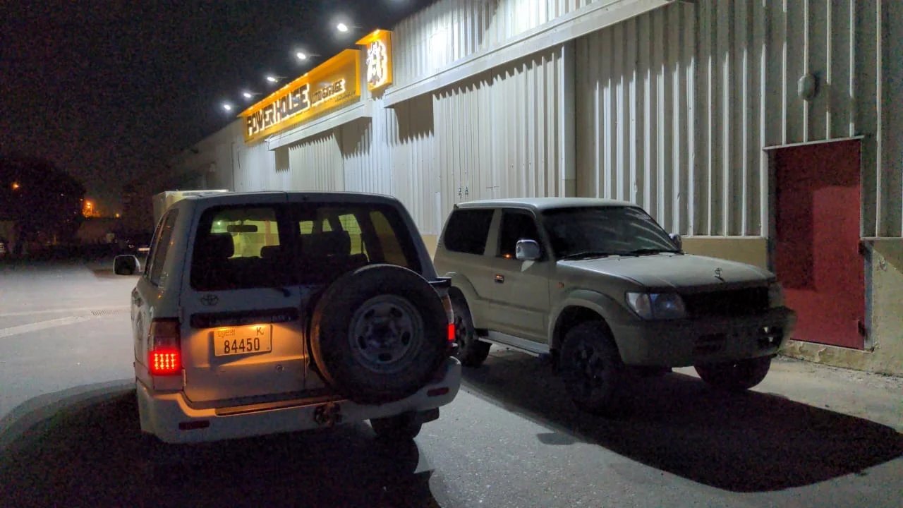

Delivering the parts at 10pm
(Thats the 105 daily driver)

There was some miscommunication and they did not put in the fuel pump. It will have to wait until Monday. With a little luck the little Prado will not get bashful again at the testing station.
Fuel pump done and operating fine.

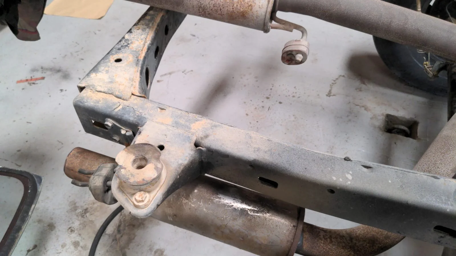

But a bit of another setback today. Inspection could not be done. A couple of issues surfaced:
This is the tow point at the drivers side, front. Someone must have pulled really hard. This needs to be cleaned up and re-bolted.

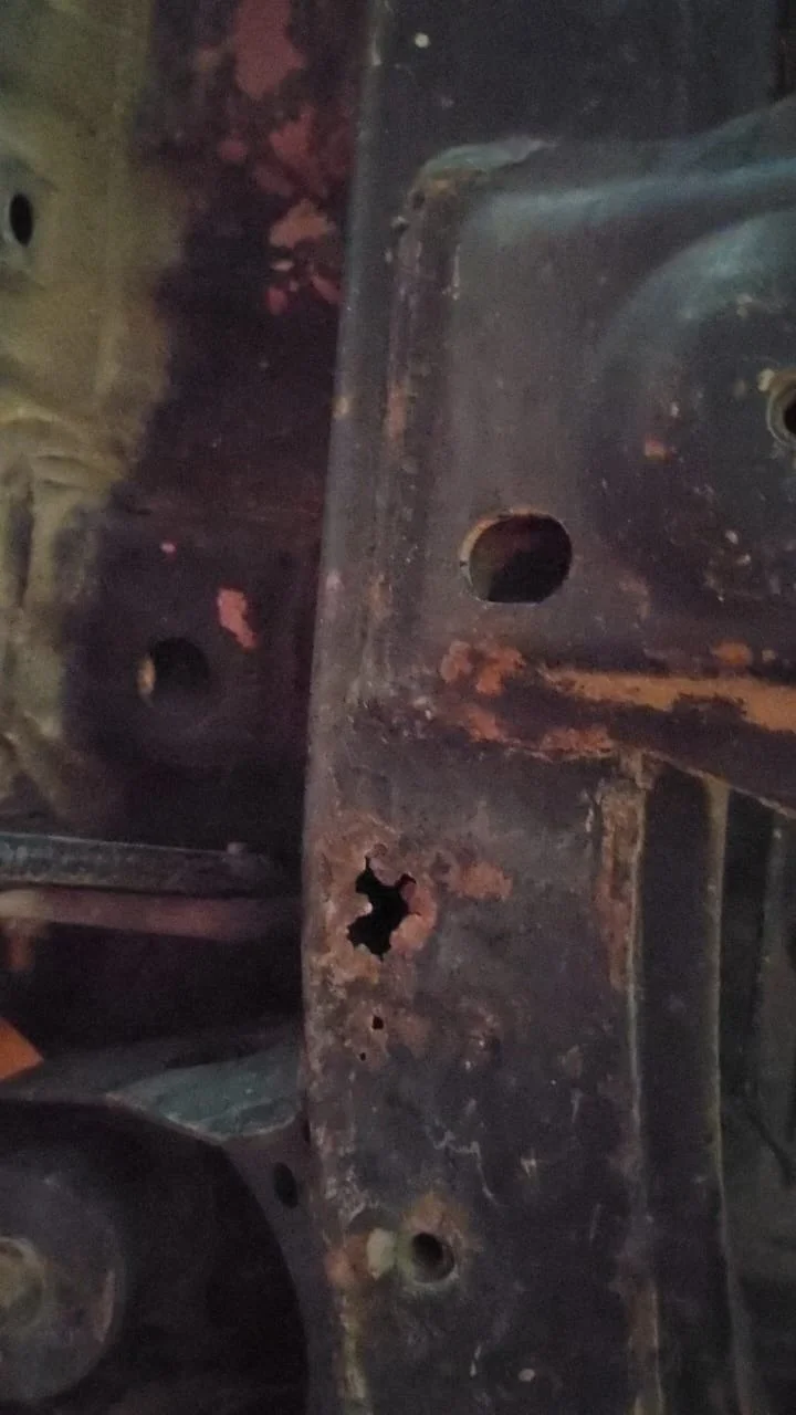

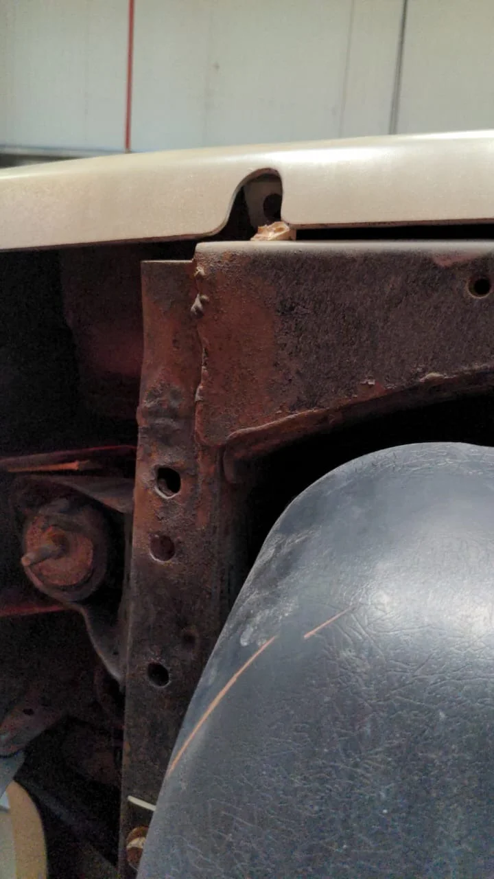

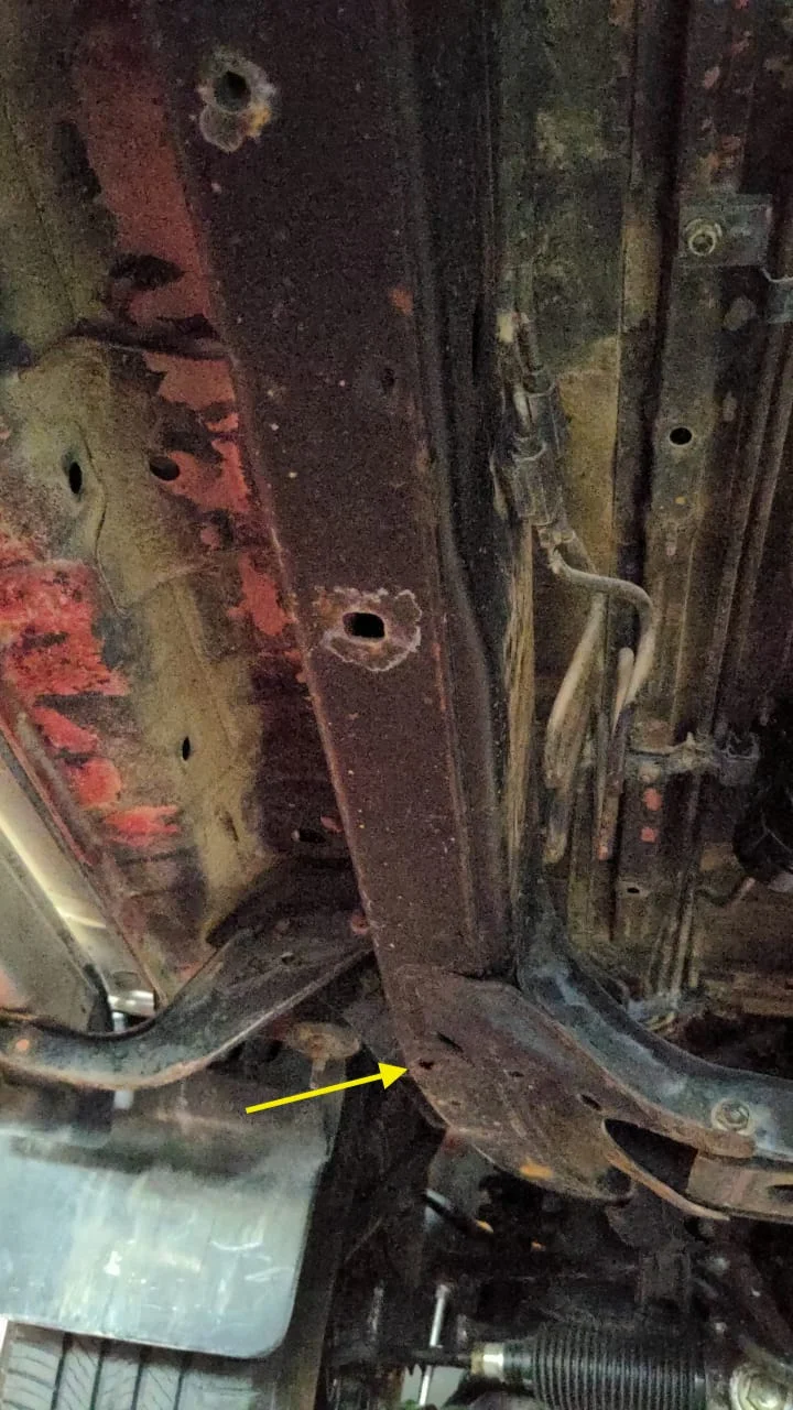

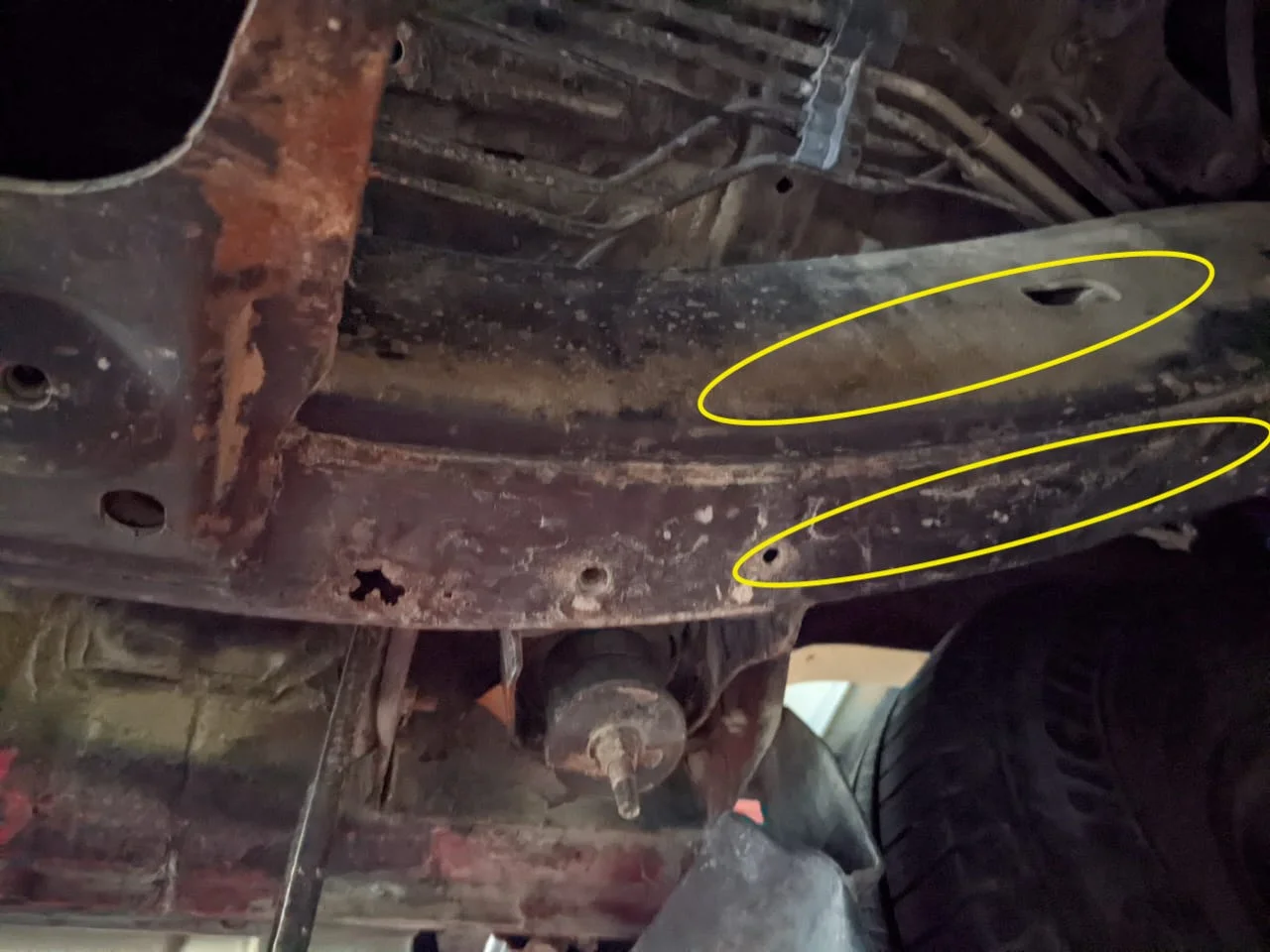

And most significantly--
It is a small hole and looks very localized and there is no sign of anything similar on the other side.
The owner of the garage messaged me to tell me about this and I had a real sinking feeling. I've been through this with other trucks. But his is very manageable. It can be cut out and replaced without compromising anything. The owner told me that he has seen this before in this era of Prados. But mostly just a little forward of this.
Have any of you seen anything similar?

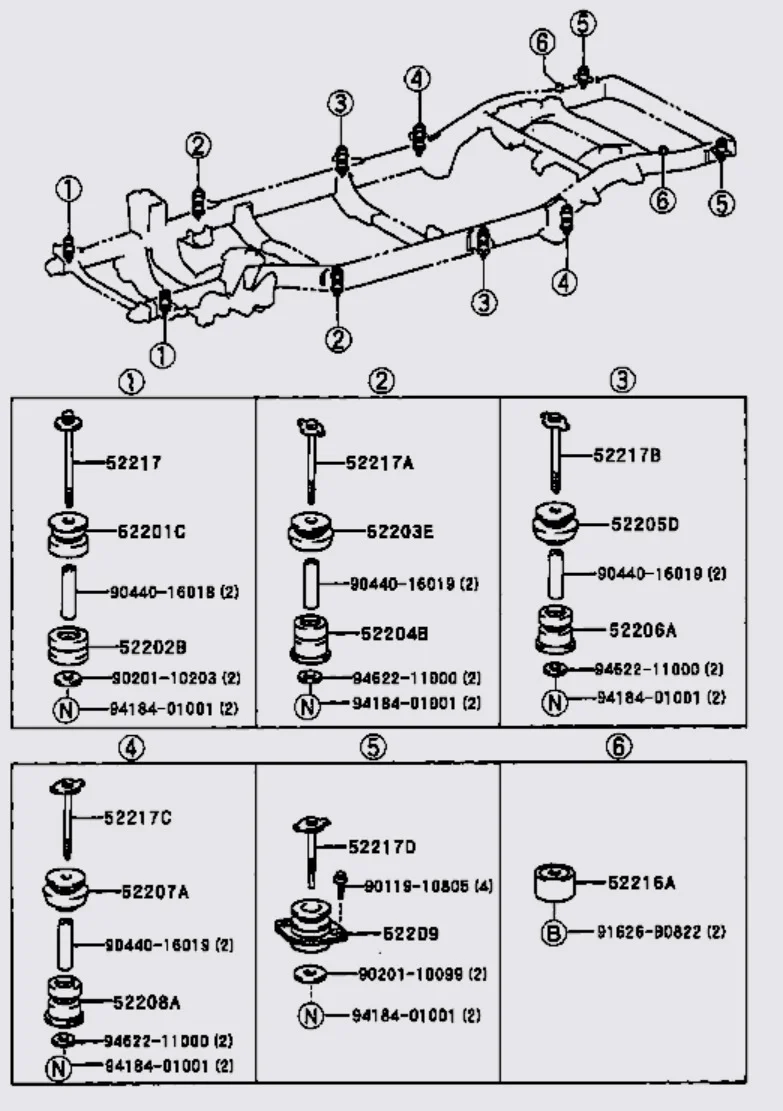

And while we are dealing with this, we are taking the opportunity to change all the body mount bushings and hardware that we can--
All this stuff.
@John Young do you know if the frames on these 90 series are especially prone to rust, like if they were used on the beach for instance?
I don’t mean to derail your thread, but I’m wondering what you’ve observed over there. The 3rd gen 4Runner frames are known to rot aggressively here in the US and I think the 90 series may be on the same chassis.
Hi Ozark. I don't have much knowledge to add. The 98 is literally the only 90-series Prado I've ever been under. I'm a real nubie on the series. The owner of the garage was quite specific in that he has seen a lot of serious rust issues just forward and on the side of the frame rail from the hole in my frame.
The owner of the garage went under it with me yesterday and he pointed to these areas as places where he has seen bad rust problems on Prados of this era. He also was pleased that the rust-through was not more extensive.
The rust issue seems pretty manageable to me.
Here in the desert, some of the issue is that the sand has some salt in it and it is actually a very hot and humid environment. I have no idea why this particular spot rusted out but I've seen pretty weird stuff. I also had a 2000 model 100 whose frame completely rotted out, so you are good to be concerned about Mr. Toyoda's frames from this era. There was a recall on some years for this.

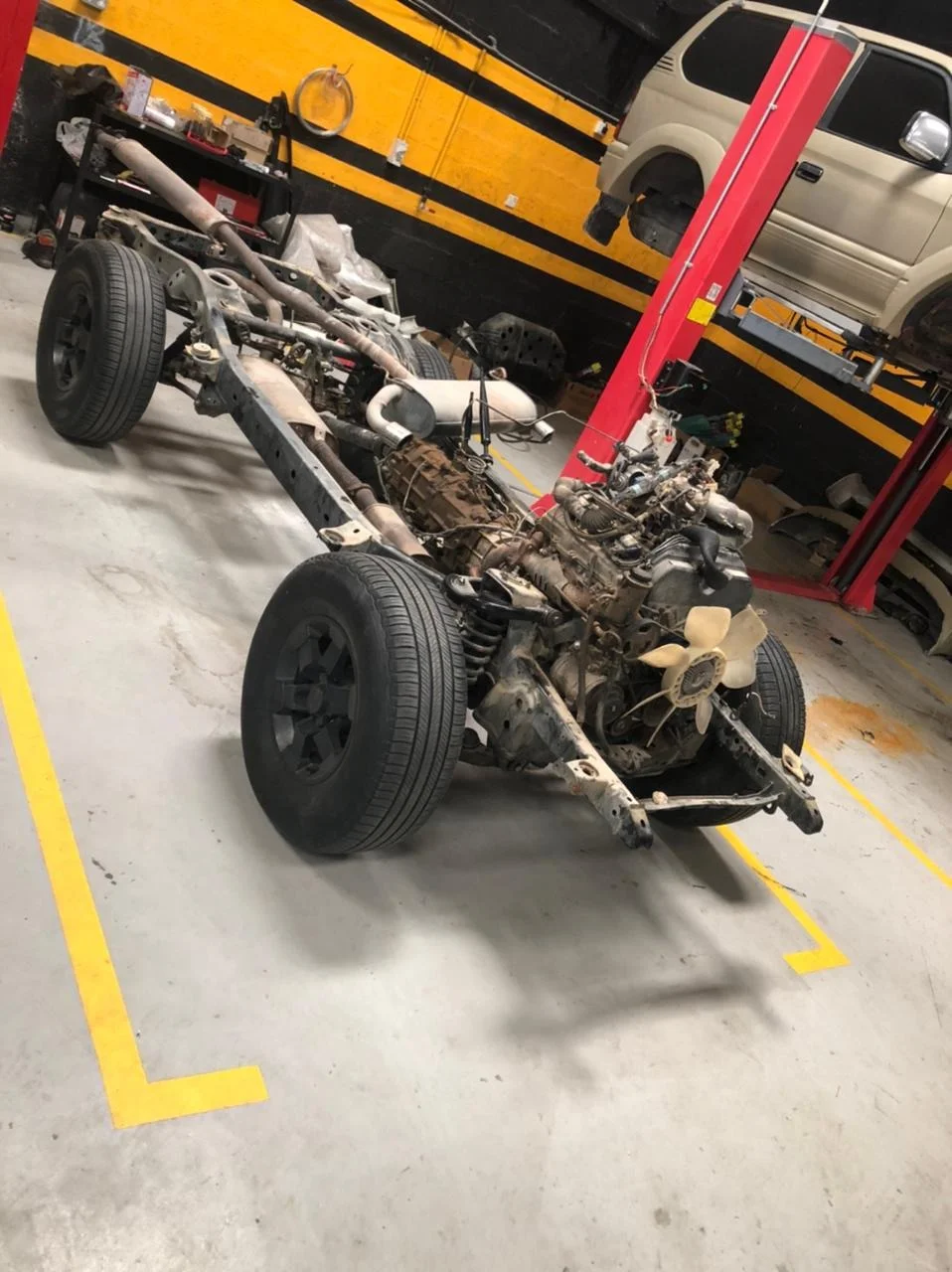

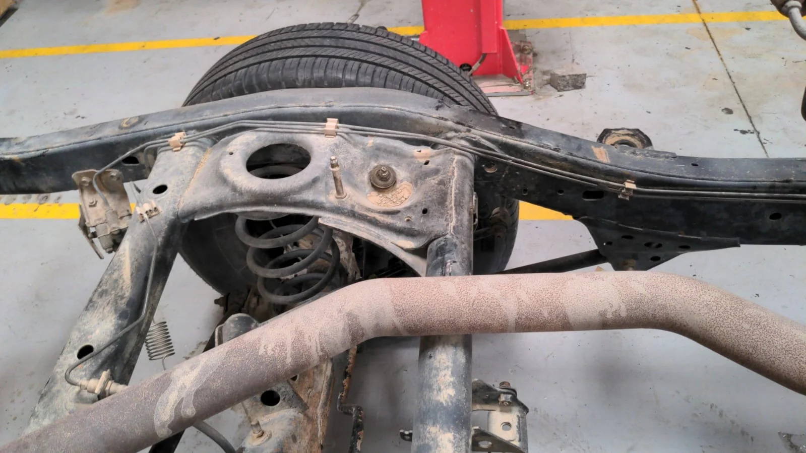

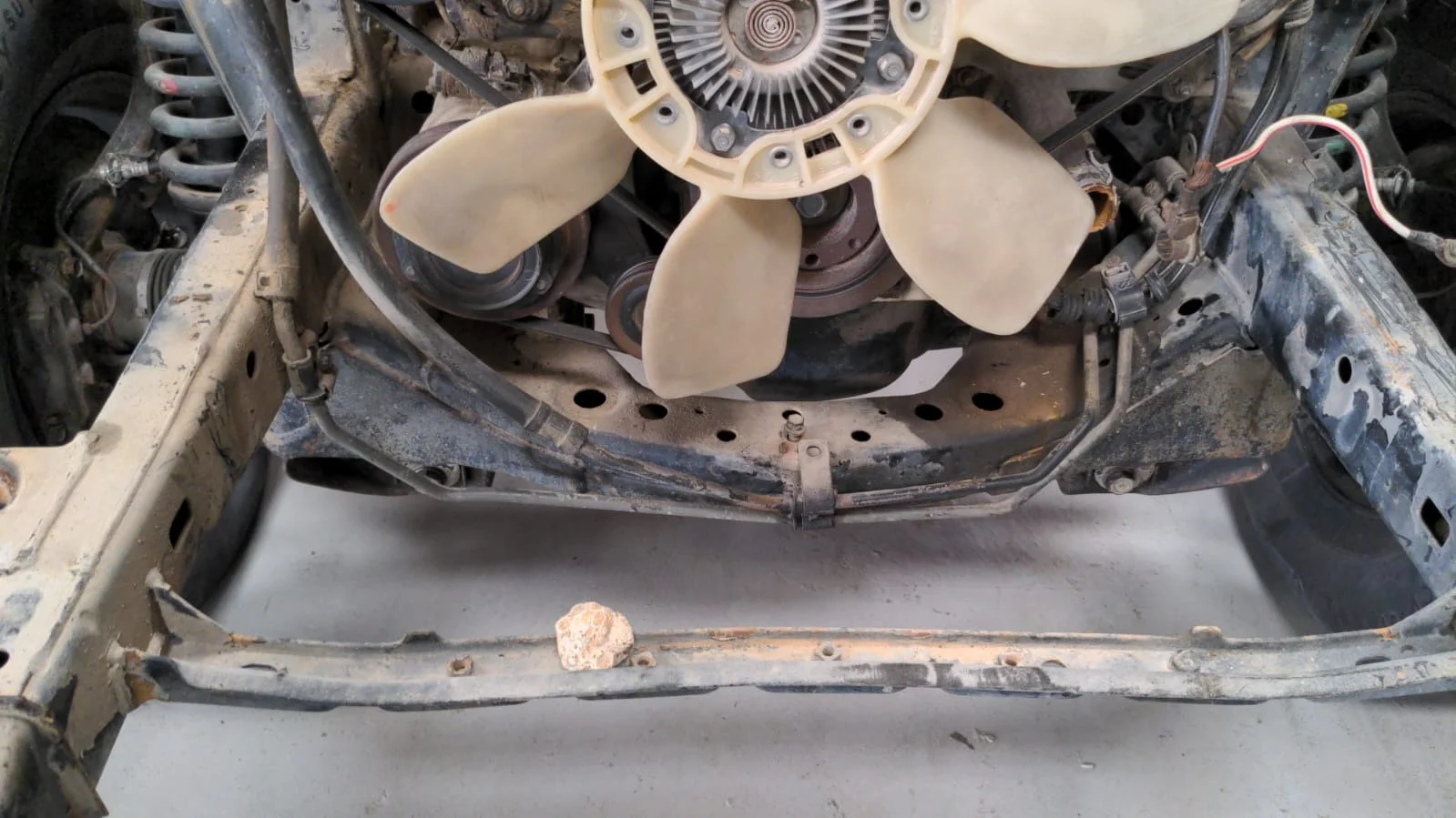

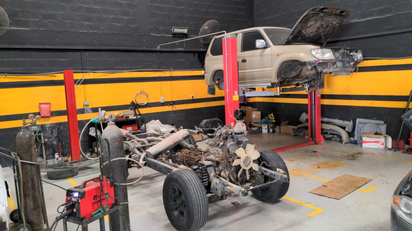

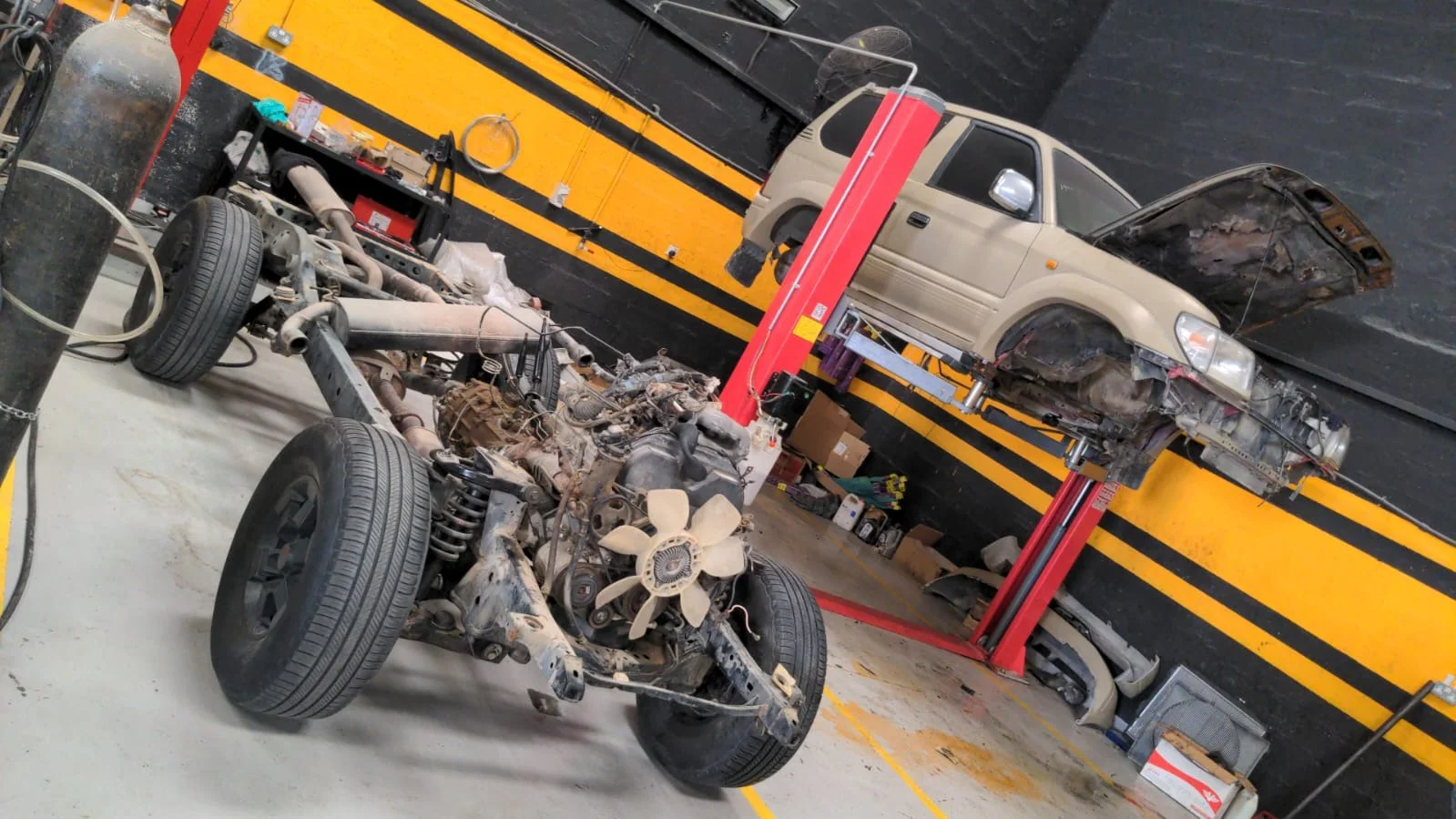

The guys have dropped the chassis out of the little prado to make repairs easier.
First they disconnected the main harness:
And then they lifted it up.
Here is another photo of the little Prado having gone topless
That is someone else's exhaust pipe lying on top of her. I don't know whose.

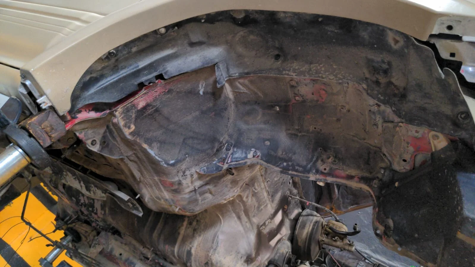

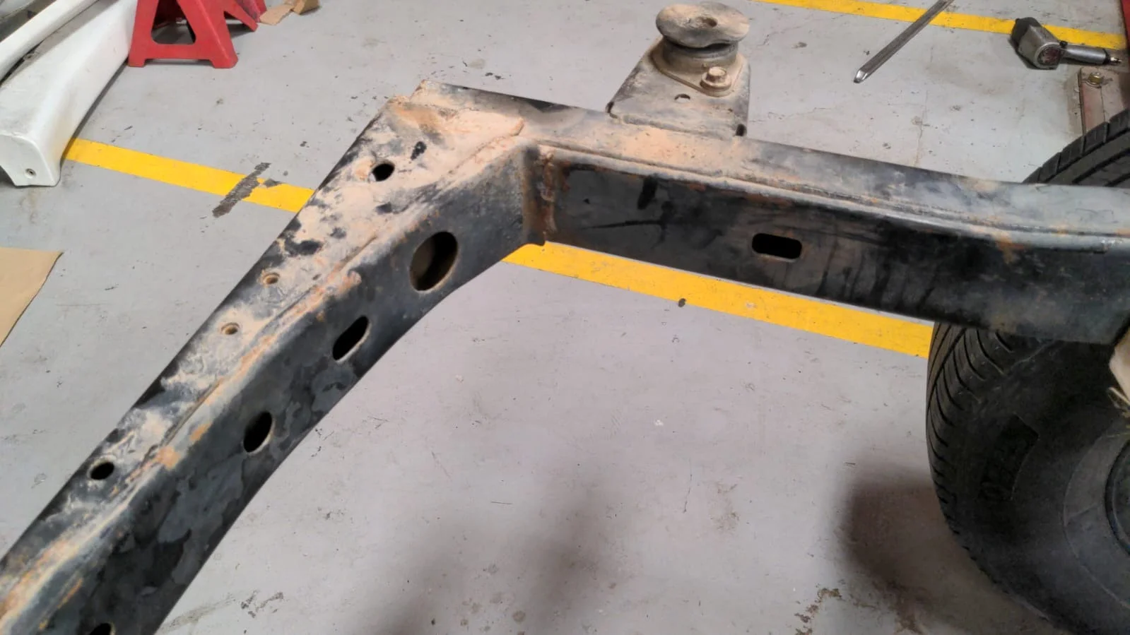

I am going to take the opportunity to pressure wash the chassis and also to clean up the underside of the body and possibly put some rust proofing on.

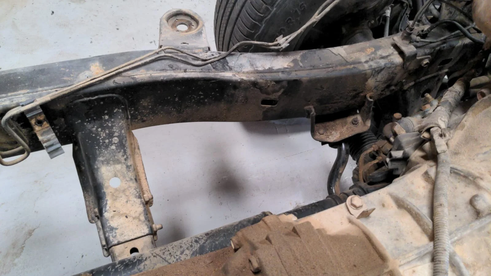

Here are a few photos in case any of you are wondering what it looks like under the body.
This is above the spot where the little hole is located:
Other side:

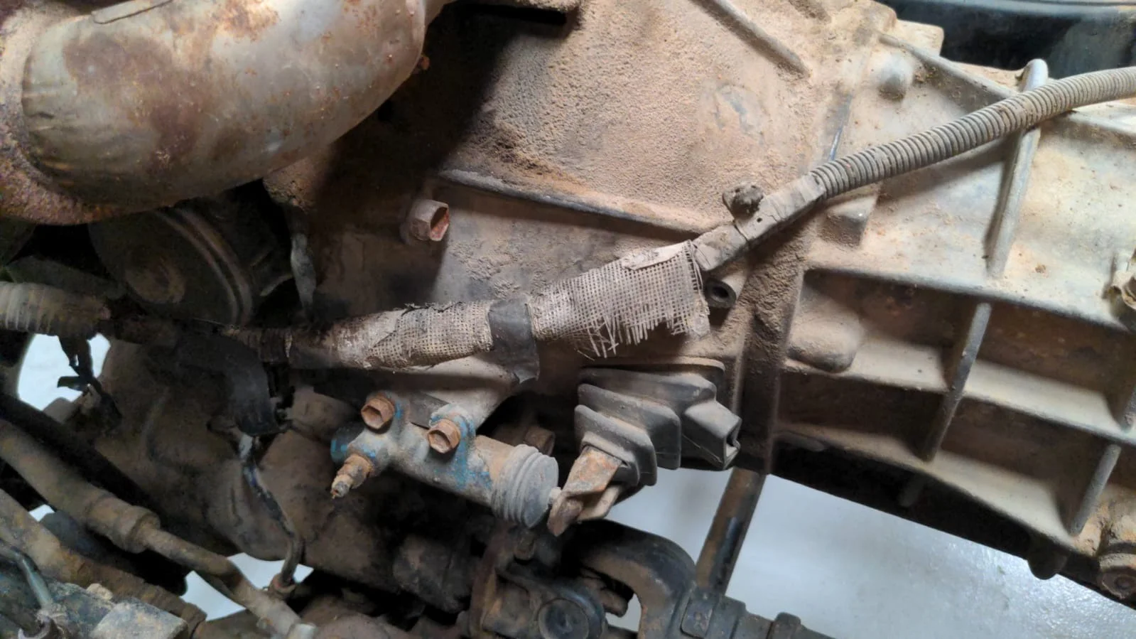

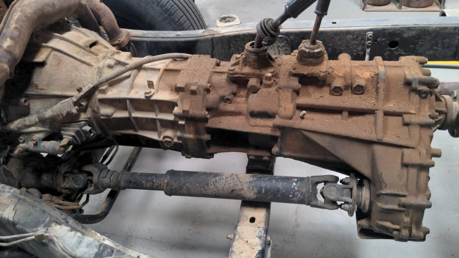

I'm not familiar with this transmission/transfer case combination:

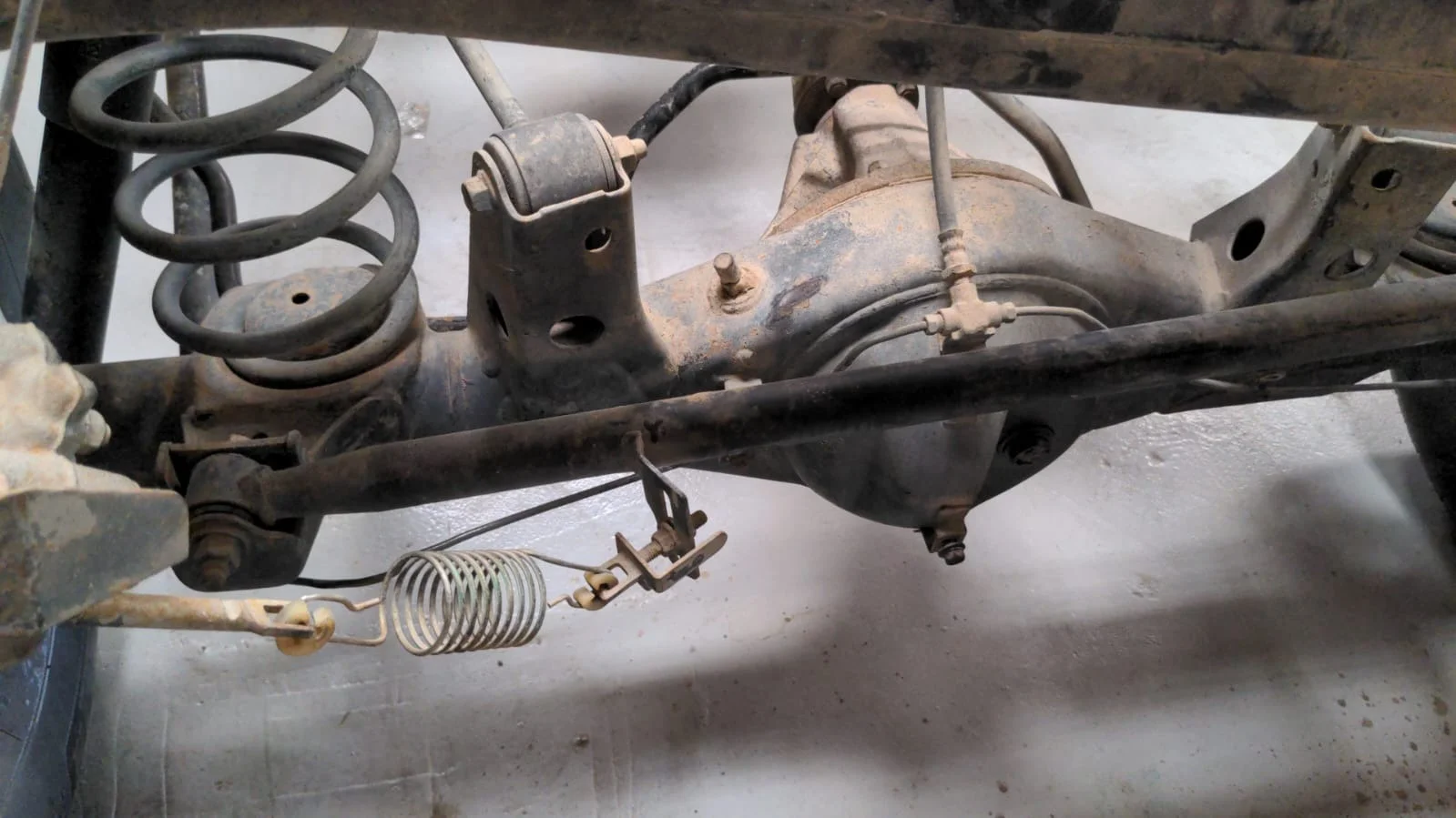

Passenger side rear:
Driver side rear:
Rear corner
Clutch slave cylinder looks a little sad:
What do you think? Should I replace it?

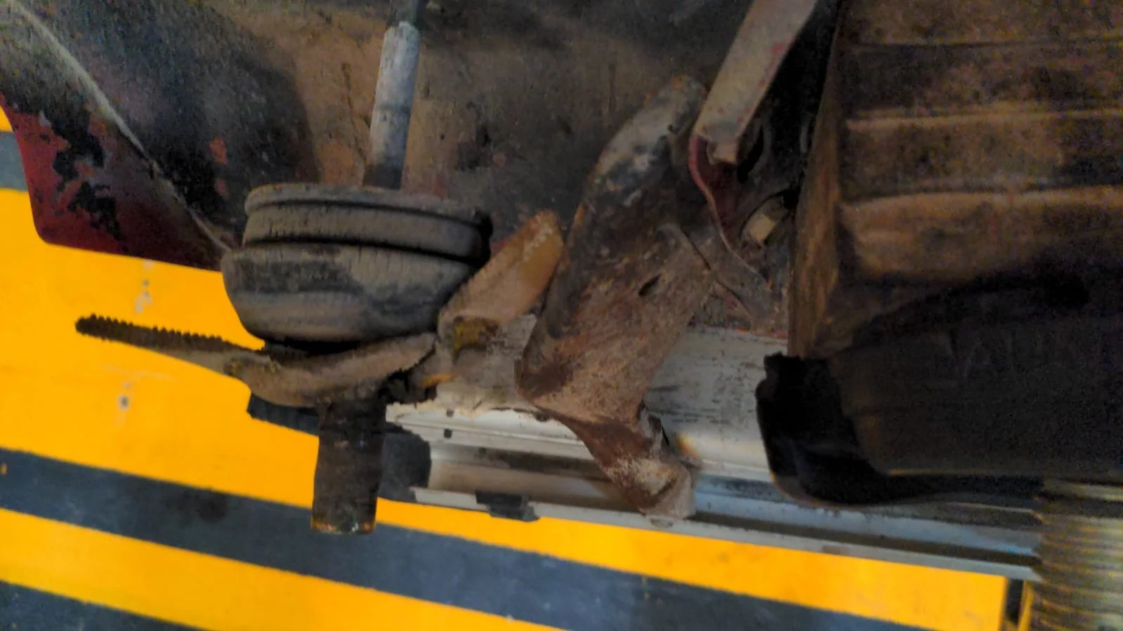

And here is why the running board is all wonky:

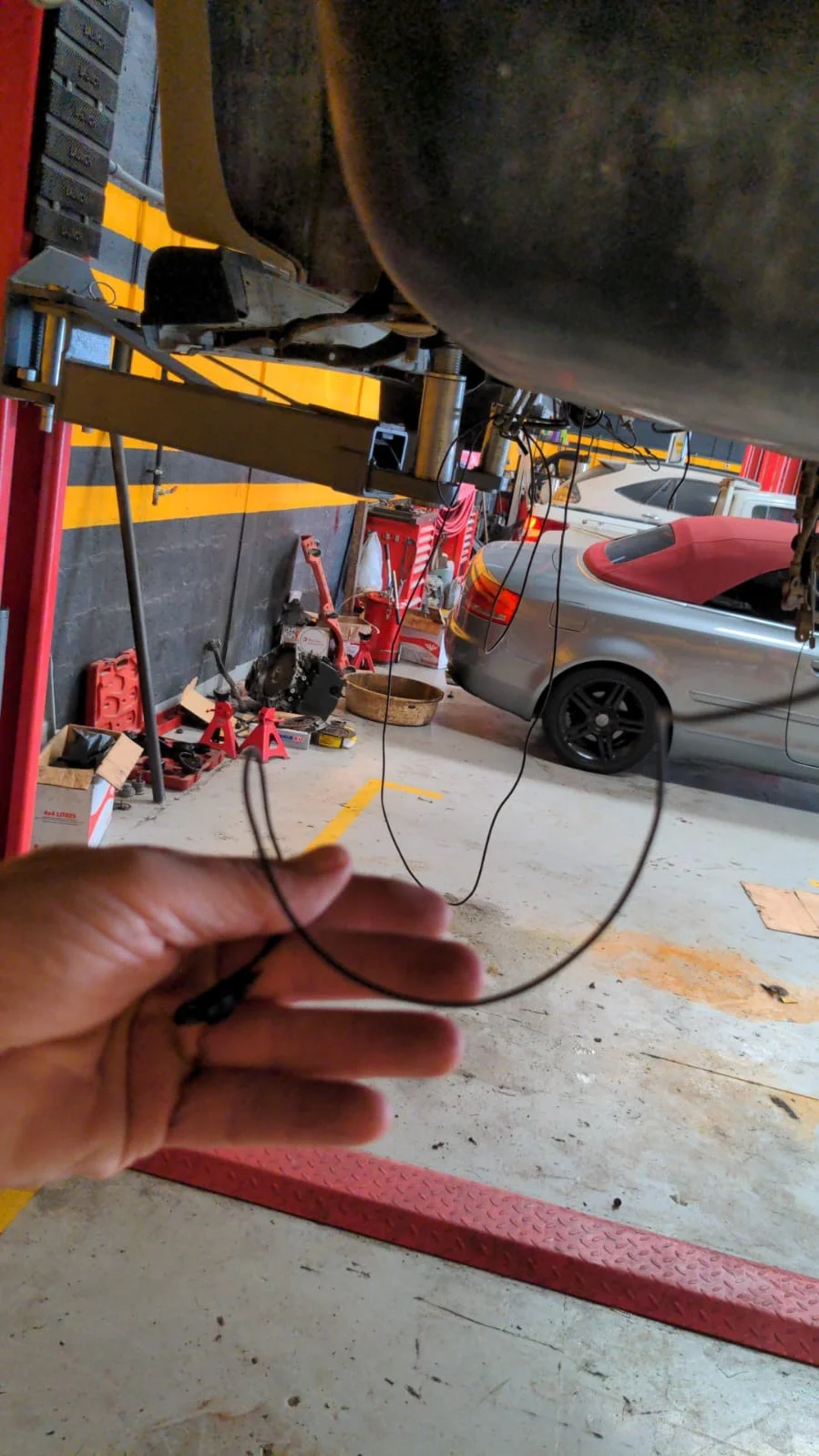

Here is a strange dangling wire:

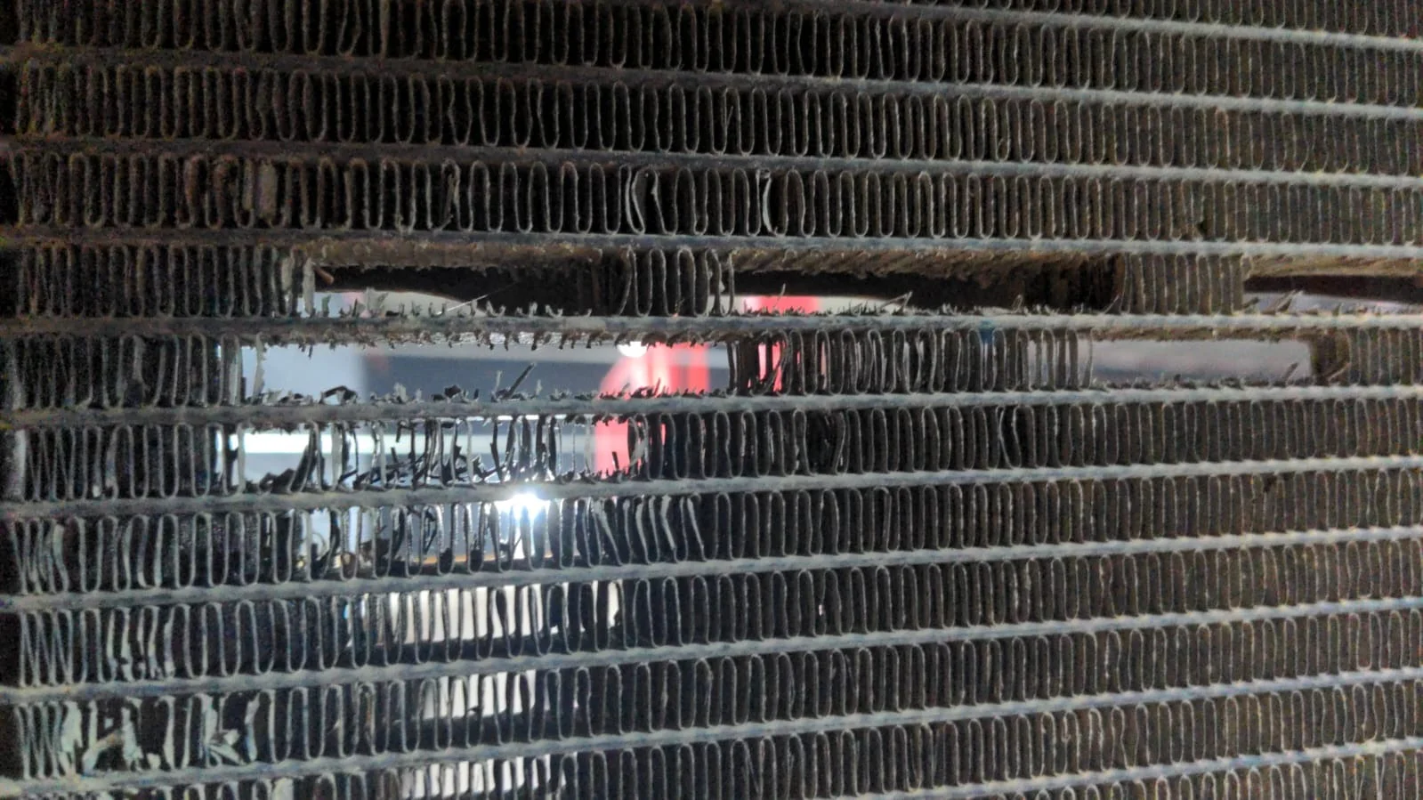

I was looking over the little Prado again today and noticed this when looking outwards from the engine bay:
The AC was working fine, but it is just a matter of time. I'm adding this to the list.
