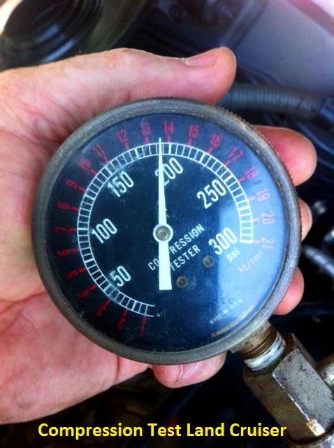

Compression test wet/dry
Leak Down Test
Blackstone Oil Analysis
Those will determine if you NEED to rebuild.
Definitely do a compression test before anything else.
I have 312K on my engine and still have 190 psi on all cylinders (dry/cold).
