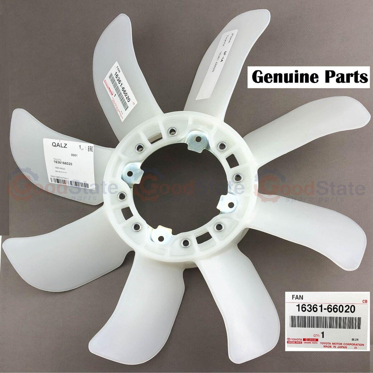

Do you have a fan shroud around the fan?
Does your fan look like this?
I might be asking a stupid question here.
not a dumb question, I actually didn't know how important fan shrouds are till very recently so I can see why some choose to remove a cracked or broken shroud rather than replace them. But anyway yes, my shroud and and fan are oem and are in great condition.
