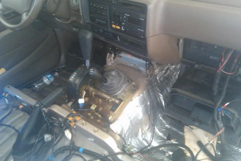

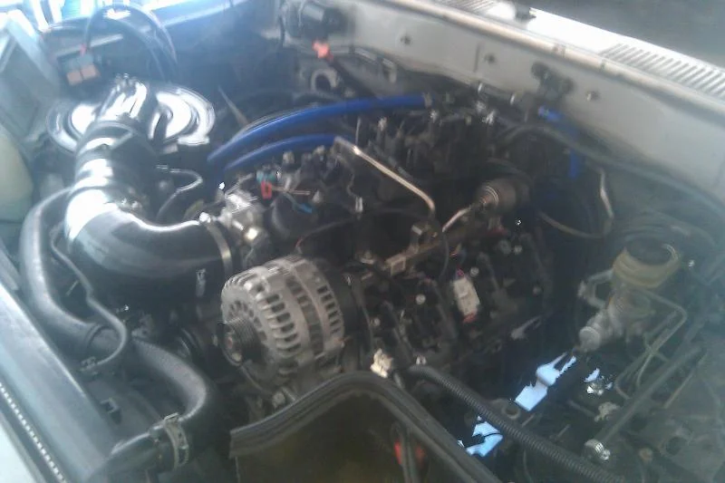

Been awhile since Ive posted so here are a few photos of the progress. Wiring is essentially completed just need to position the PCM and new fuse box. AC lines are done, I eliminated the tube that ran along the fire wall just seemed like it would be too close to the exhaust.. The shifter is what everyone else is using the 91/91 80 shifter though I didnt cut any holes in the floor just retained the stock position and it works great! Also cleaned the cluster up turning off all unnecessary cluster lights off ie oil level, abs, plus wired up the CEL to work with the GM PCM (works great!) If your wondering why my interior is all ripped out I spilled a bucket of used oil in the back on my way to O`Reilly's to recycle it and the **** got everywhere :mad:.. All that is really left it so reinstall the interior, notch the trans pan and run the exhaust. Test fired it up yesterday open header :D my neighbors love me haha..

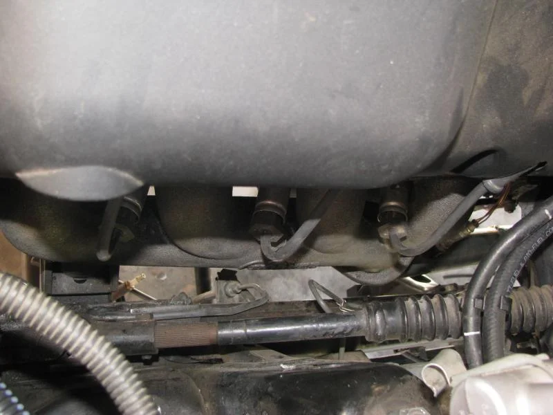

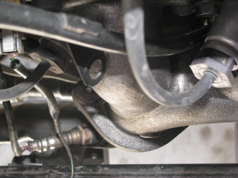

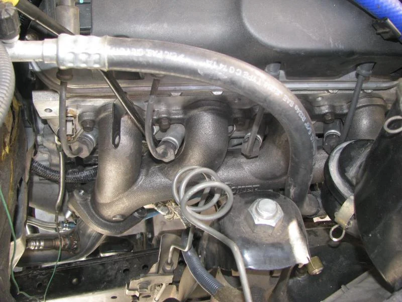

Exhaust is done dealio. Manifolds worked out great, and they werent much more than the headers. Clearence is perfect from the firewall and frame plus they allow you to run the front swaybar. Manifolds come with a beefy stainless flange, you do retain the factory head side gasket and hardware. For the exhaust flange a 2010 Camaro gasket is used. Drove it for the first time in a year (only on and off the trailer, but still!) and will take it on a hot lap when I get my small punch list knocked out. :beer:

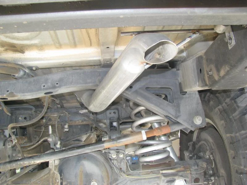

Dumped the exhaust little above rear bumper so I wont tear it off when dropping off steep drops.
