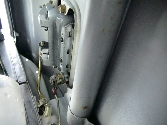

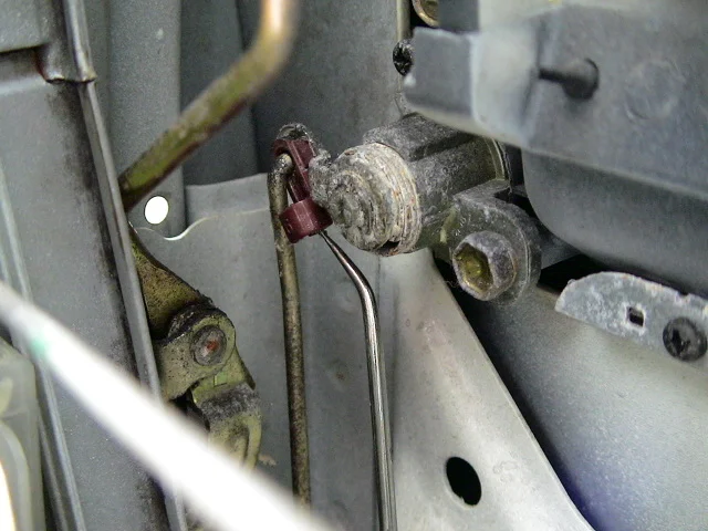

@WyattEarp1918: which snap/clip is broken, can you post up a photo?
Example: photos below are from a FZJ80L left front door:
I wouldn't trust a 3D printed clip. Especially when I could buy a new one from Toyota.
I did that as well and used a zip tie as a "temporary" fix........ last year. They are about $1.30 but I had to wait for a larger order because i didn't want to pay 10 bucks to ship it. The part number I found is 69759-06020
