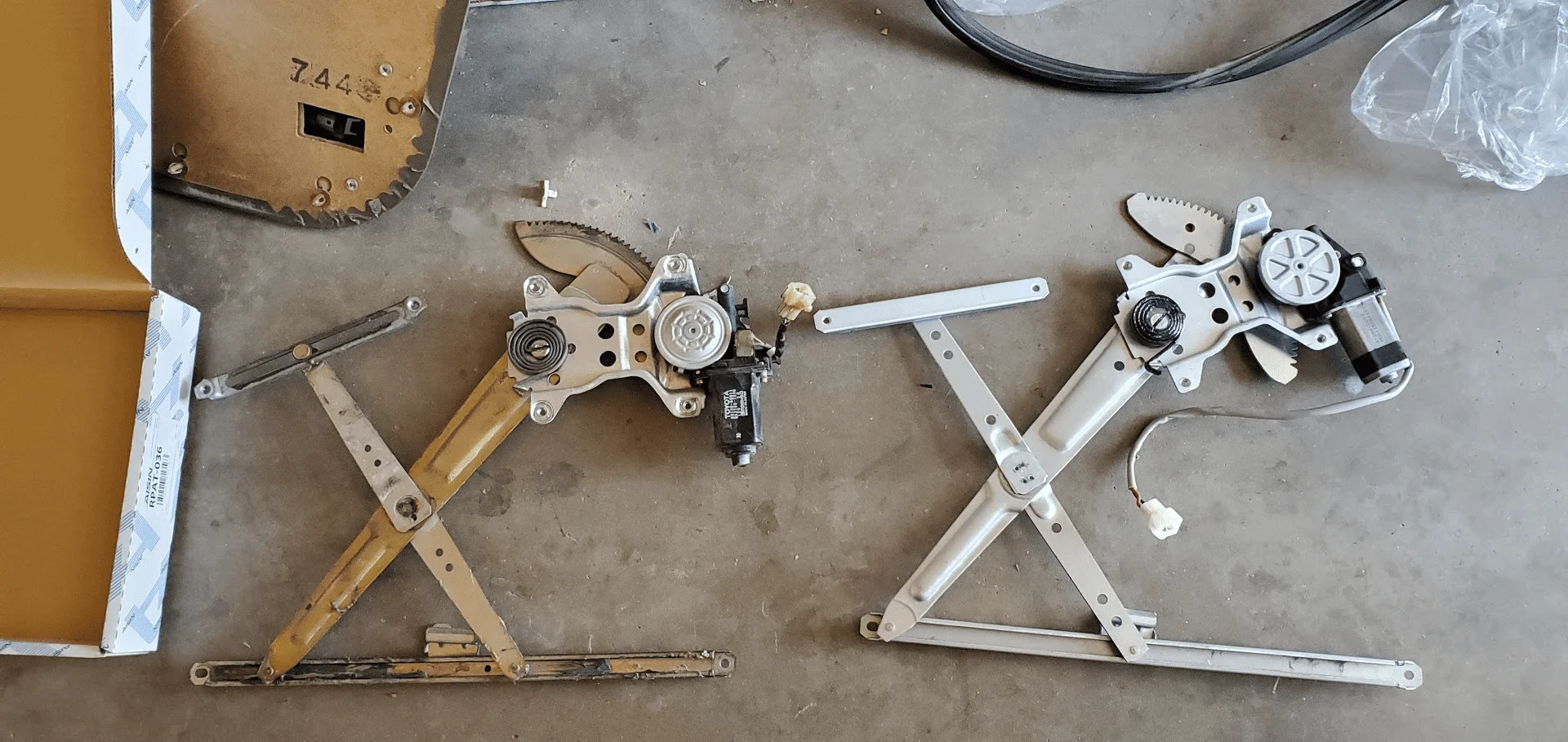

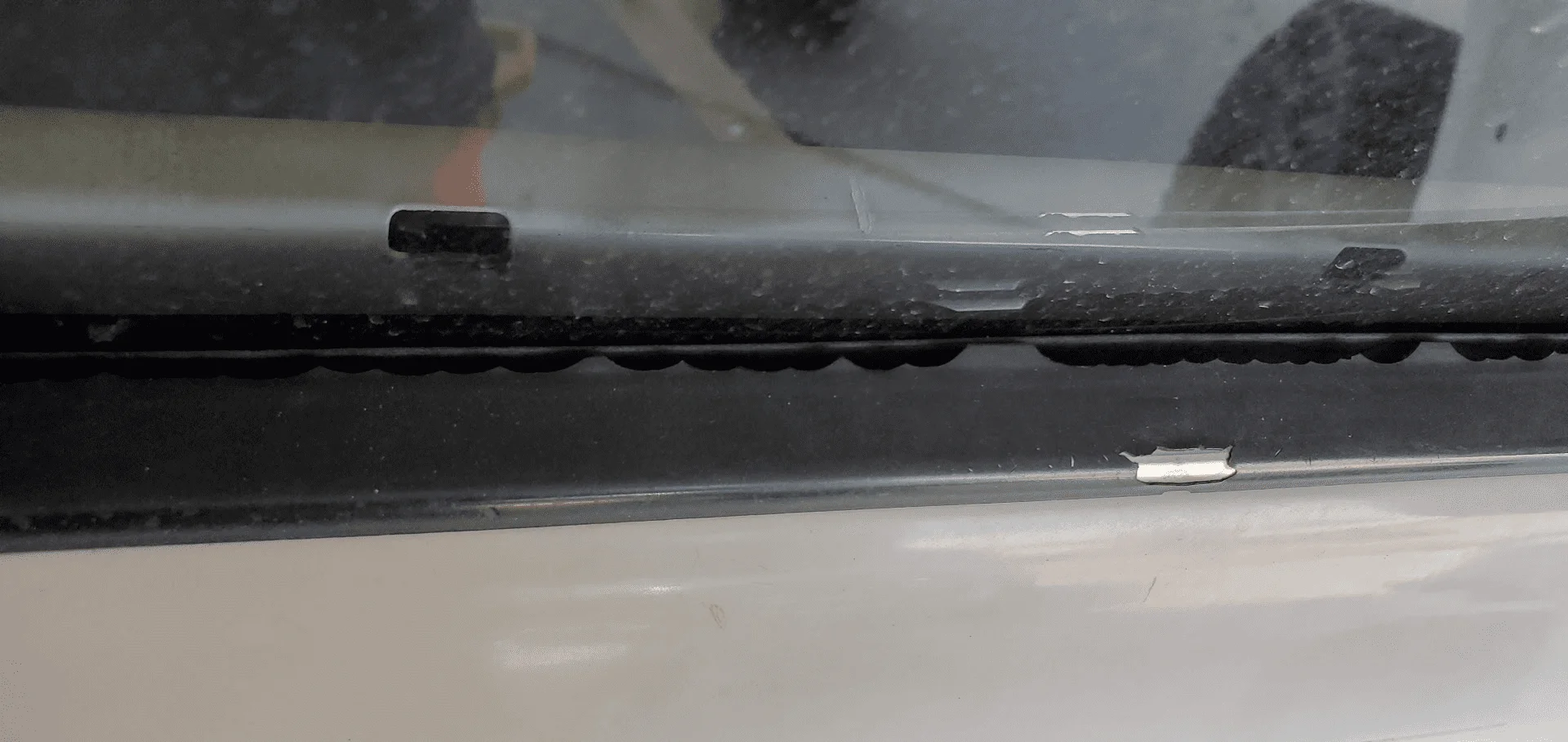

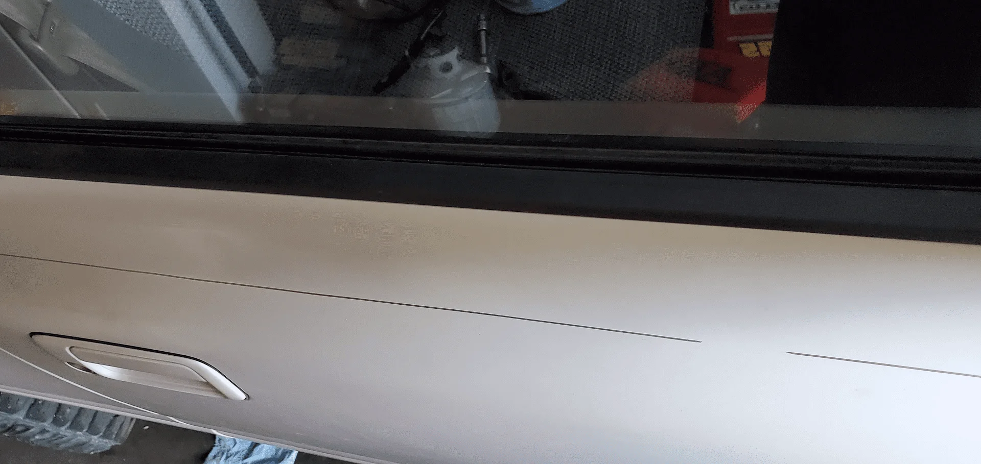

Ever since I bought Kronk, the windows have been slow and don't really work when it is cold outside. With winter coming, I knew that I wanted to remedy that. Also, the outer window moulding on all of the windows was beat to hell. So, I did some work yesterday and replaced all of the window runs, outer moulding, and replaced the front window regulators and motors with Aisin units from RockAuto.

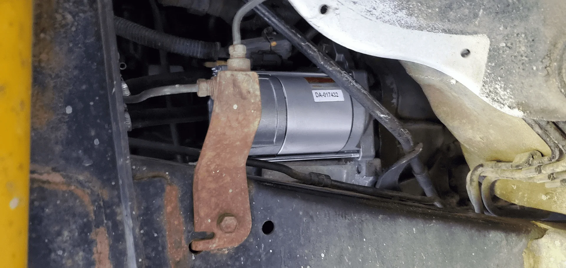

Did some more work today. I have been having some intermittent starting issues. Based on some troubleshooting, my guess was the starter was going south. So, I replaced it and also replaced a few other PM type things including the EFI relay, circuit opening relay, fuel pump relay, and fusible links. Now I have a good supply of spares. Later, if I have some time I will rebuild the original starter.

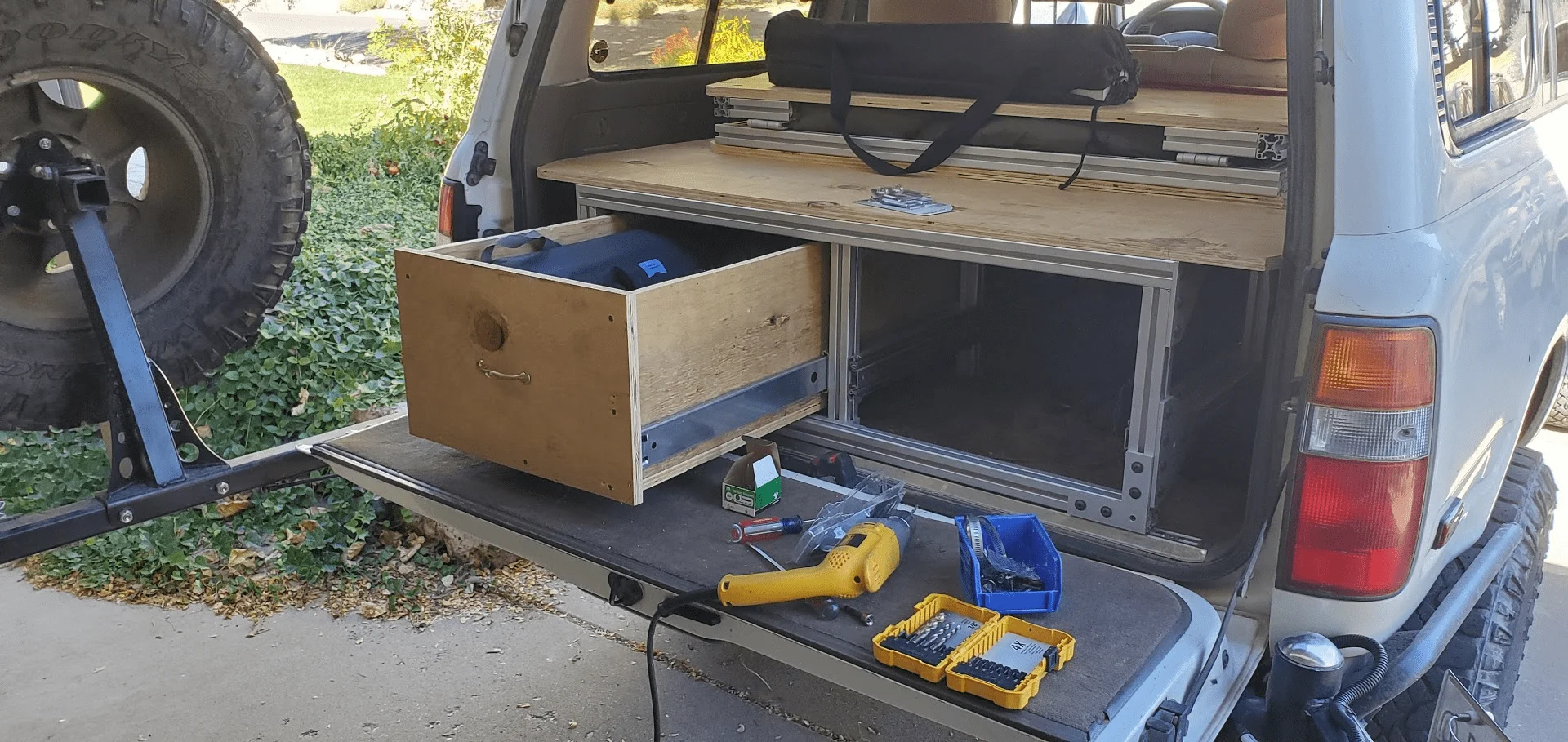

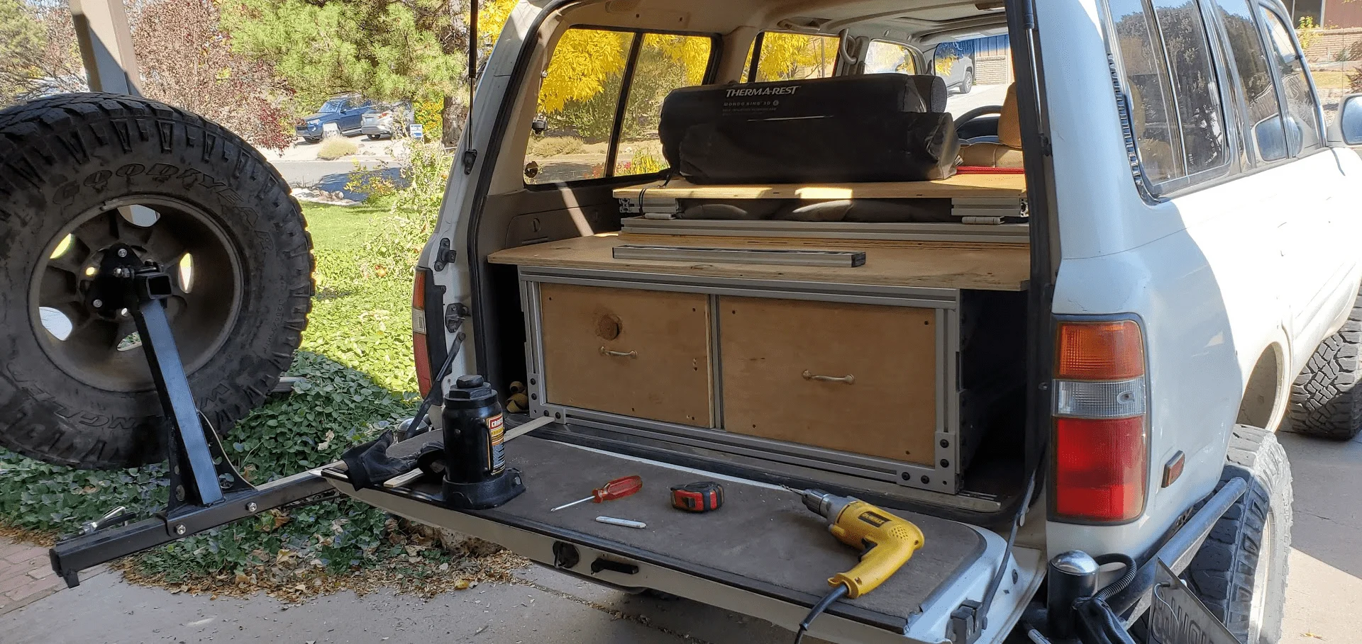

I finished the drawers for the sleeping platform. I still have to paint things, but it works.

I will be curious to hear about those window regulators and how they work, thinking about doing the same.
So far, so good. It is nice to have windows that function well even when it gets cold. Coldest it has been so far this year is in the teens, and they worked just fine then. Time will tell how well they hold up.
