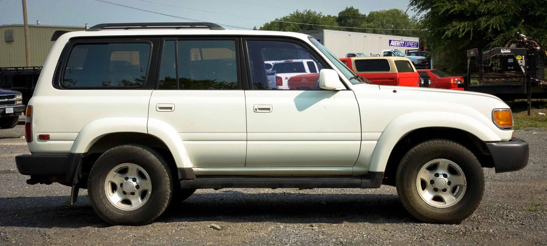

We’re writing this thread to share our observations and lessons learned as we repair and outfit an 1996 FZJ80. It will be used for overlanding after we retire and to do backcountry trips. Here are the pictures of it when we purchased it.

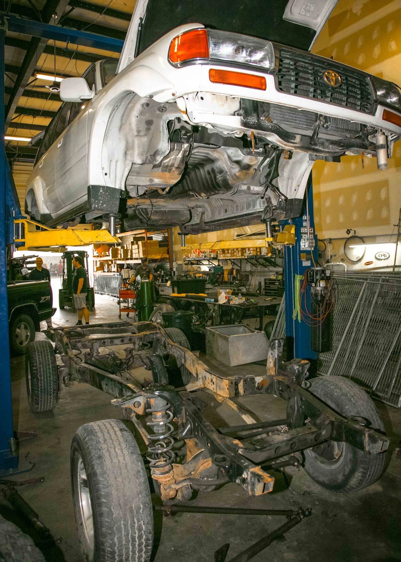

ORI in Winchester had done two JK builds for us so we went with them for our overloading project. The first thing we did was start tearing it down to evaluate everything. Here is the body separated from the frame. We were surprised at how much rust was on the top of the frame and hidden by the body. Good news is that the frame was still solid.

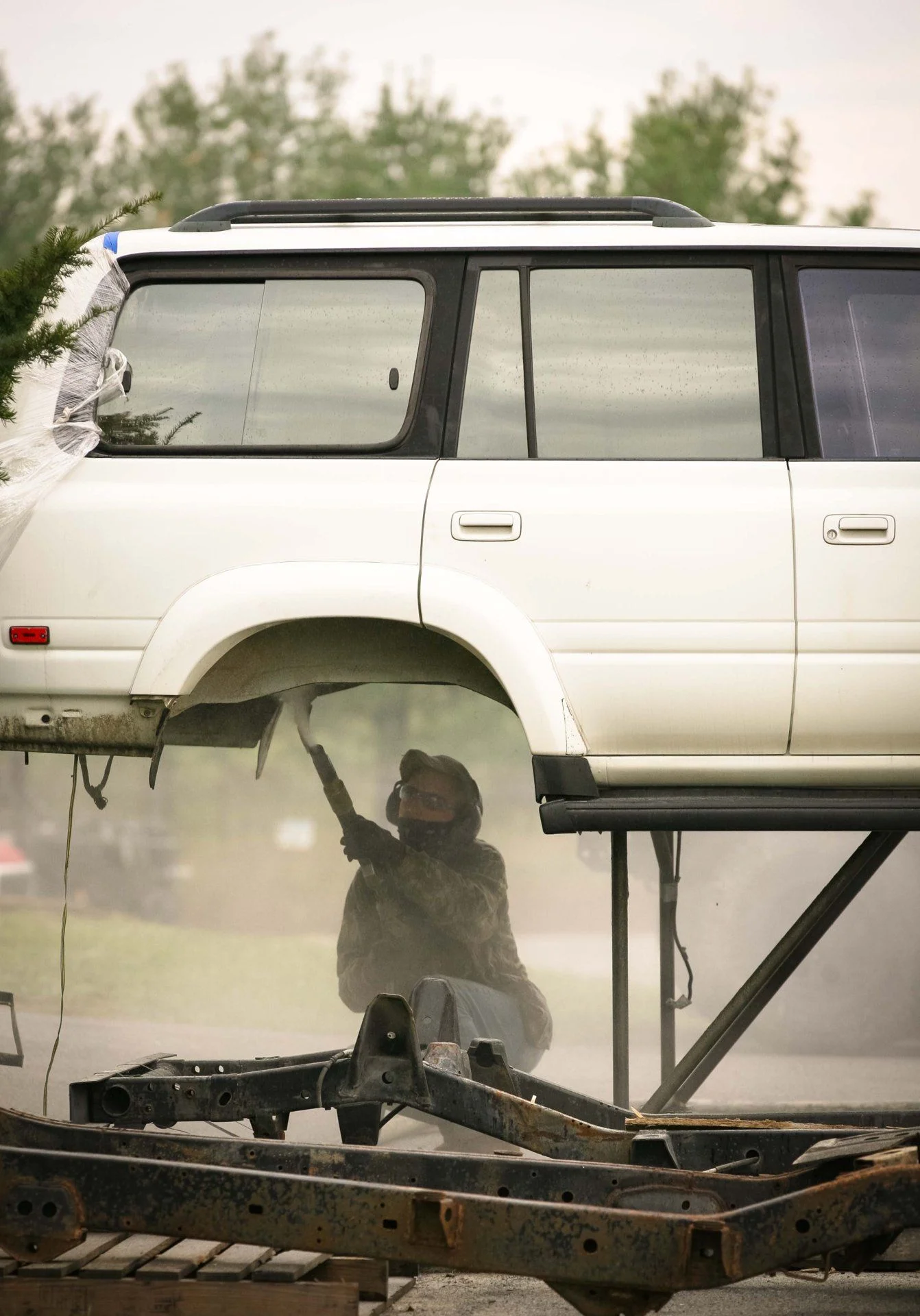

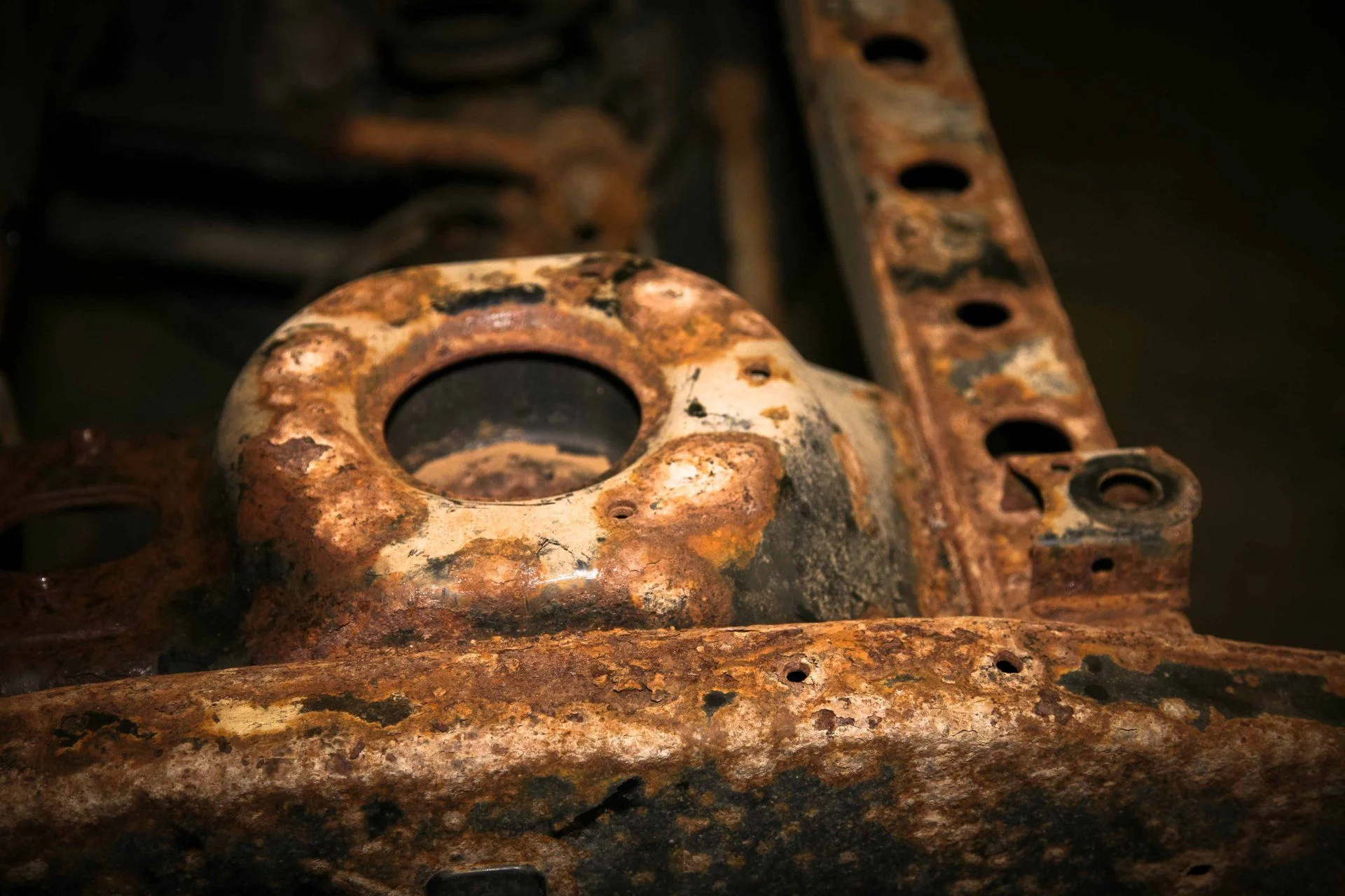

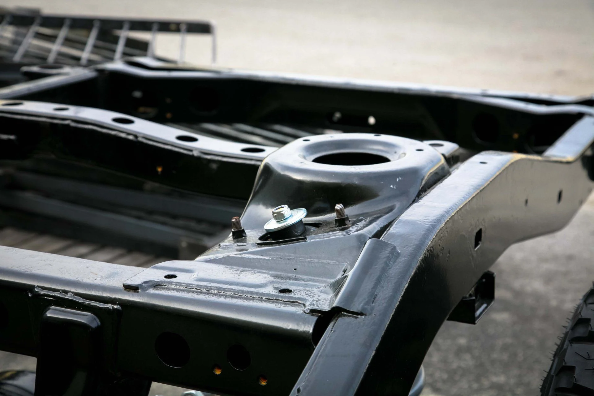

To treat the rust on the frame we decided to have it sandblasted and re-powdercoated to prep it for POR15 rust prevention coating and Eastwood's "Internal Frame Coating". You can see the divots in the frame where the rust was getting started. That said we are extremely please with how well the frame turned out.

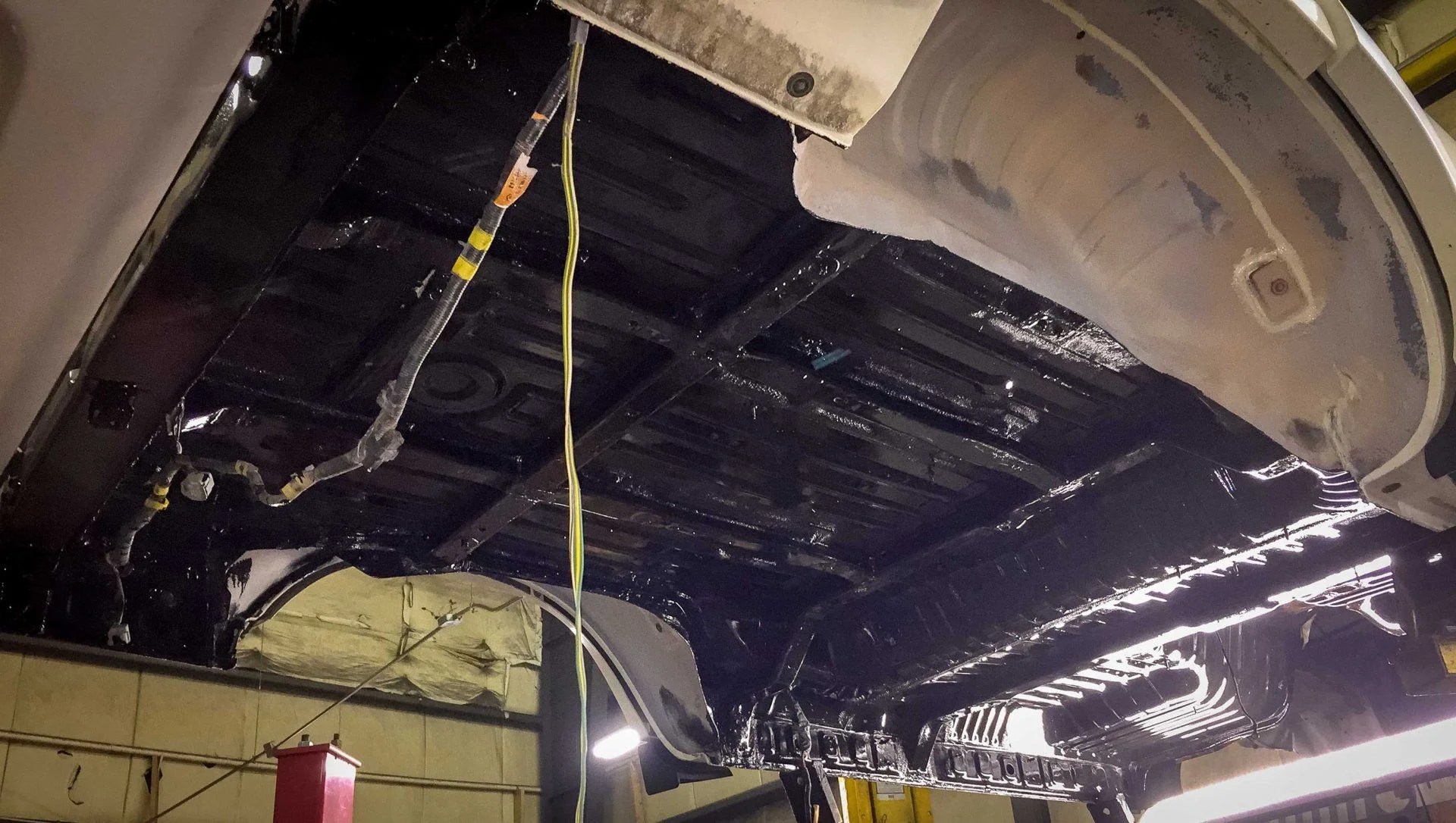

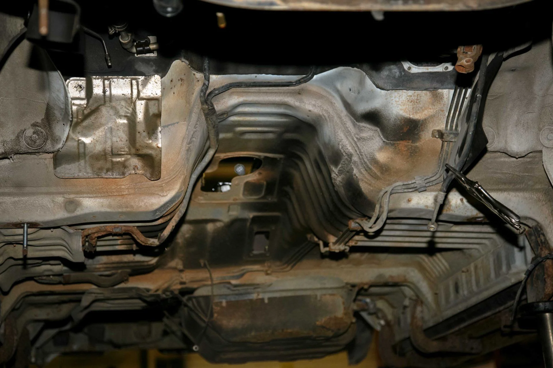

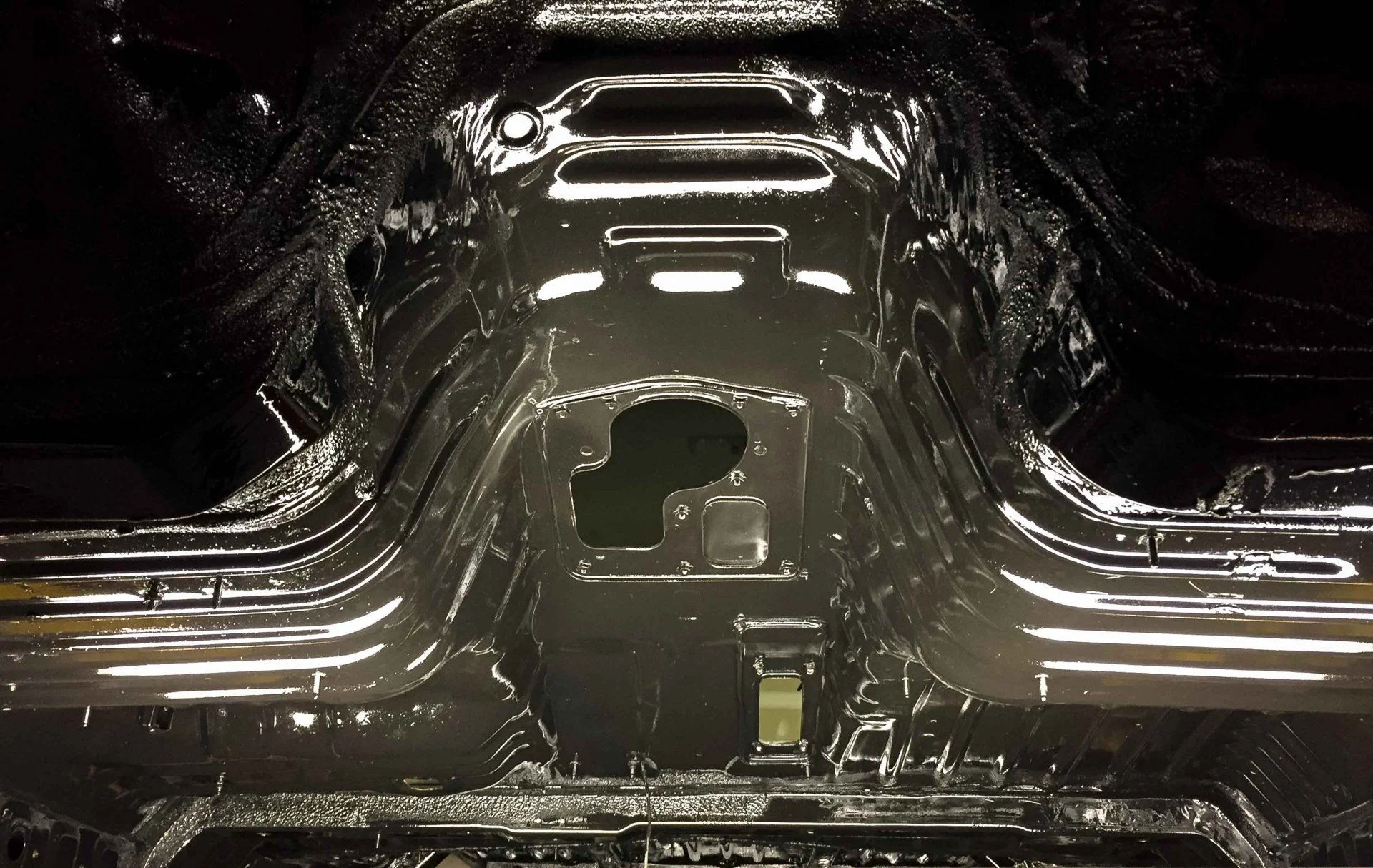

Once the underside of the body was media blasted any remaining rust was mechanically removed. All the seam seals were repaired using commercial grade seam seal and then POR15 was added. Below are pre-media blast and post POR15 pictures.

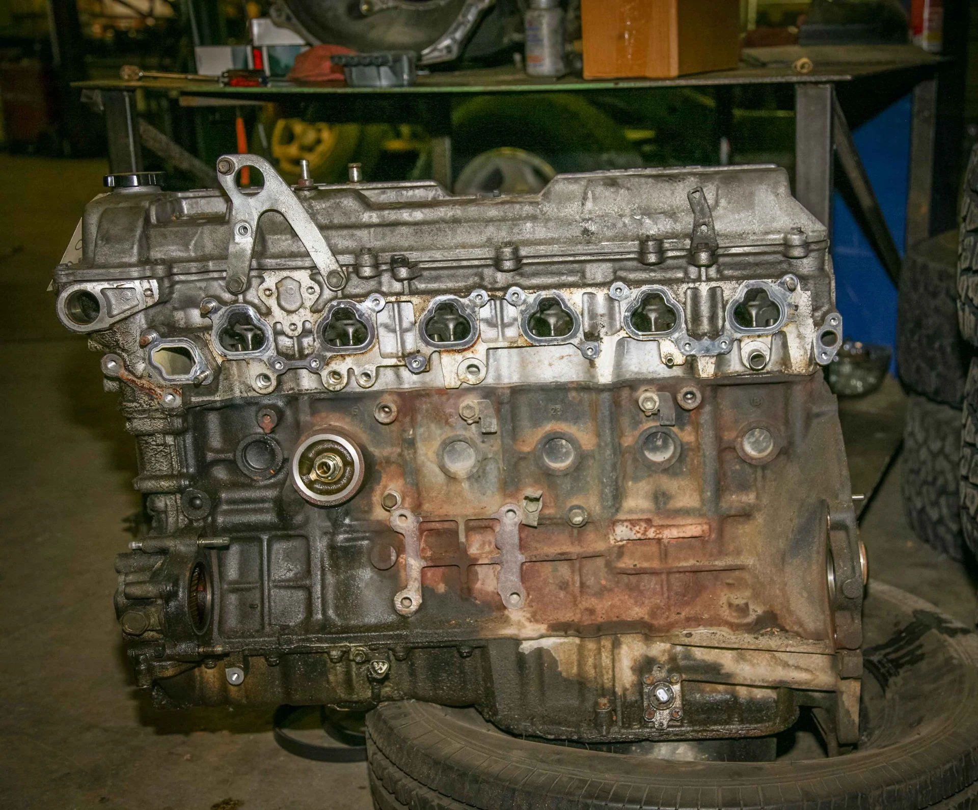

The engine: is currently being rebuilt by Victory Precision Machine with a Brian Crower stroker kit and possibly a turbo. This is a much debated topic going on in the 80's tech section. in the end, to get through VA emissions it may just be the stroker kit. :)
96 LC Stoker Kit and Turbo ECU/Tuning Advice
Below are pictures of the engine still in the frame, the block stripped down to go for the rebuild and one from VPM of it during the build.
