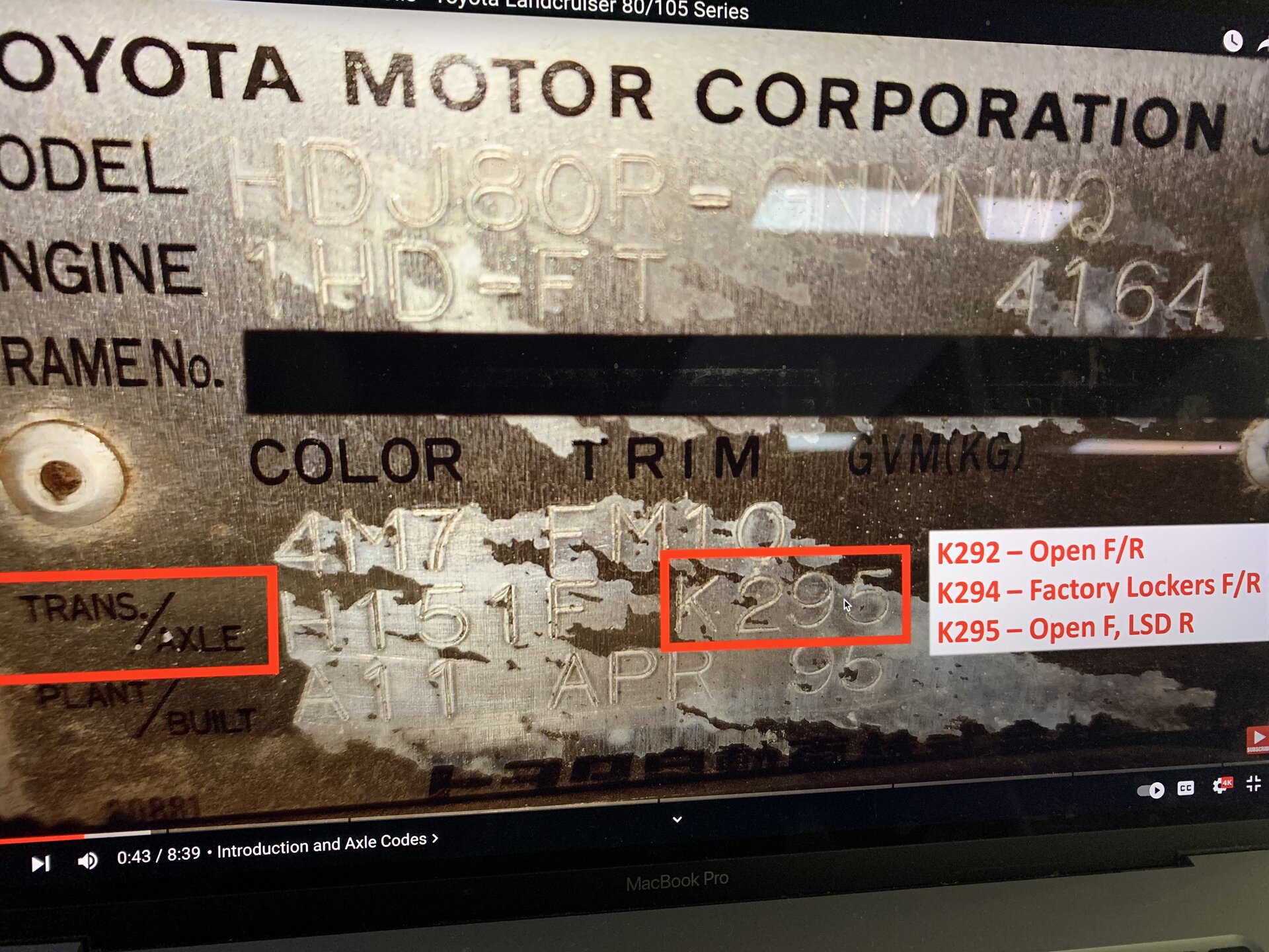

Looking to buy a 1995 80 series thats been imported from japan the listing says it has center, front and rear but doesn’t have the switch for the front or the rear is there a difference between LSD or locking differential (switch wise) and information will be very helpful since I am new to land cruisers all together.
The vin code for the FR & RR lockers is k294 and the switch is the same round dial. The center diff lock switch is standard on some and not on others. At least I haven’t seen anything to contradict that. I lived in Japan for 5 years.

LSD stands for "Limited Slip Differential". Different than a "Locking Differential" or a "Lunchbox Locker".
These do not require a switch and are Limited Slip with clutch plates inside. These operate on differences in rotational speed and torque and work well in mud, but not as much on the rocks. They may or may not actually be in there. You have to open up the differential to see if it's really there.
I am not aware of the K295 code, so you may search that to determine exactly what it means.
Be very wary of "deals" like this and realize you may not be getting what you think you're getting, especially if you don't know what it all means and ask the right questions.
K295 is a axle code for a diesel powered R&P axle, taller gears - 292 & 294 were the only ones USDM got as we’re all gas.
I posted it before there’s 4-5 axle codes from 292 thru either 295 or 296, IIRC 293 was a diesel R&P ratio LSD, but offhand I forget 295.
If you search my username, and the uncommon axle codes - you should come up with the ratios of R&P’s the 293/295 got & what other features like LSD, etc.
HTH.
If it was just LSD would it have the switch also?
If it’s LSD, then it wouldn’t have a factory e-locker/functional locker rotary switch.
Highly unlikely it’s got an aftermarket locker either as a Torsen axle is the closest you could come to having a LSD/near-locking hybrid. And it’s not a locker, more a torque multiplier to reduce ‘1 tire fire’.
AFAIK, LSD & diff lockers are mutually exclusive - it’s a either/or situation.

But it would be interesting to see your door sticker - I know the chart I posted was correct info, just not what all countries got what drivetrains.
I’d be surprised if you’re not a K295 (3.xx ratio, non-LSD with a e-locker package).

It's certainly 4.10 ratio w/ elockers, turbo diesel, automatic. Very common drivetrain for a diesel 80. 3.xx ratio axles are exceedingly rare.
K294 has lockers...
