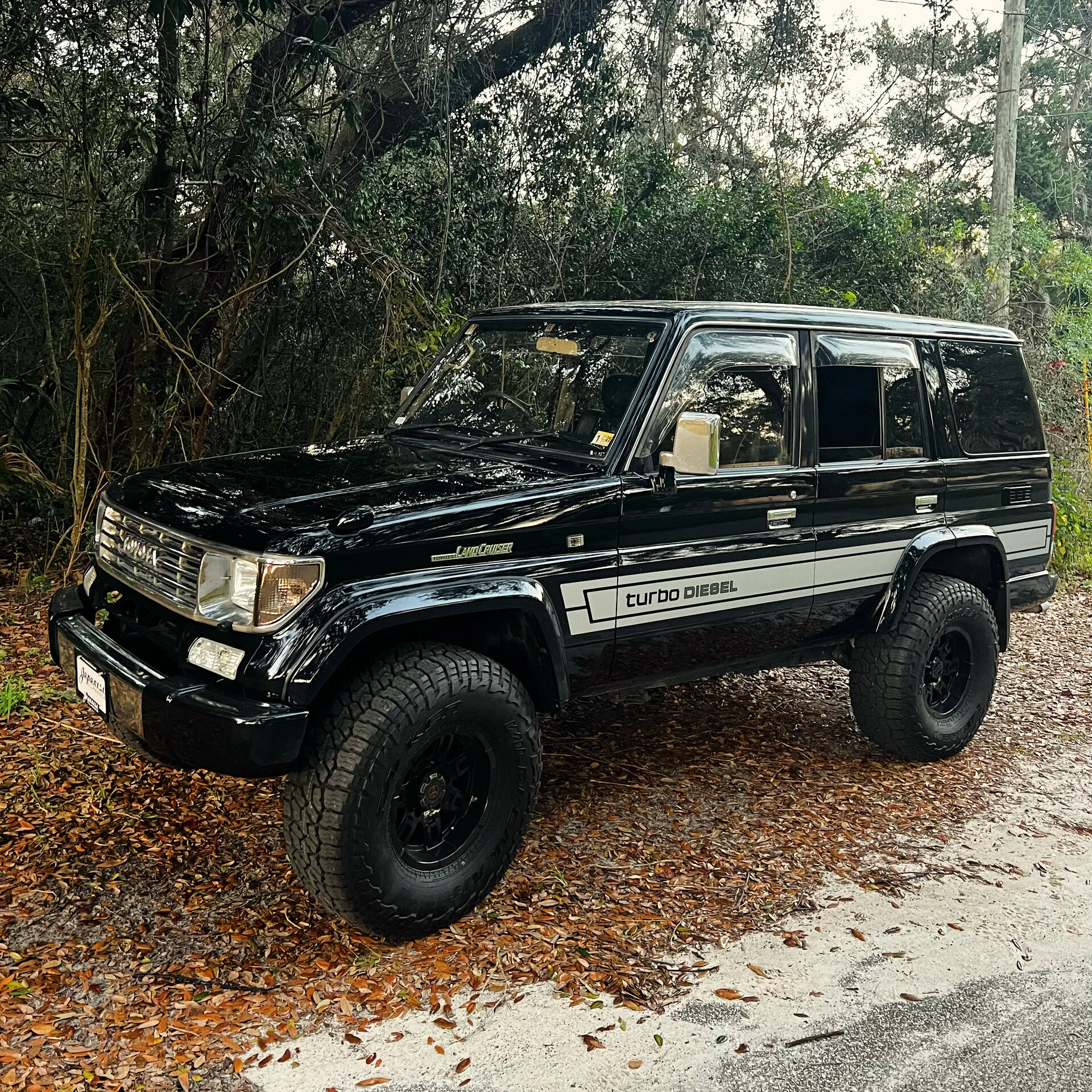

Good Morning! I am looking for a roof rack that I can mount a rooftop tent. Any recommendations?
Also, where do you guys mount a spare? I see a barn door mount but I worry about the weight on the hinges, I think a bumper mount might be better. Or maybe a swing arm? What do you guys do about your spare?
added some photos below
