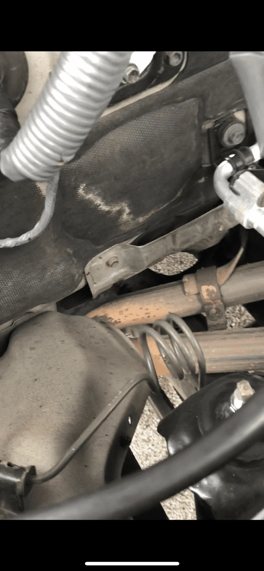

Today, I drove to work. No issues. Ran out to grab some lunch. Returned to work, and noticed a fairly steady dripping of coolant along the inner passenger side frame rail, right near the cats. I figure it’s my rear heater lines finally going out, so I close the heater valve all the way to keep it from dripping excessively. Top off with coolant on my drive home, and see it’s still dripping. Crawl under, and the rear heater lines are dry. I trace the leak back up to behind the small heat shield that sits on the firewall. Pull it off. Nothing super noticeable. Take a closer look, and notice the firewall insulation in the engine bay on the passenger side, is damp with coolant. I check hose connections at the coolant tee, and they’re all dry, including the rear heater hard line that runs down the firewall to the passenger side of the transmission. I also checked the passenger side carpet inside the car. It too, was dry.

Can't really see anything from that one photo, can you post up more photos
with a couple of close-up shots, showing the leaks?

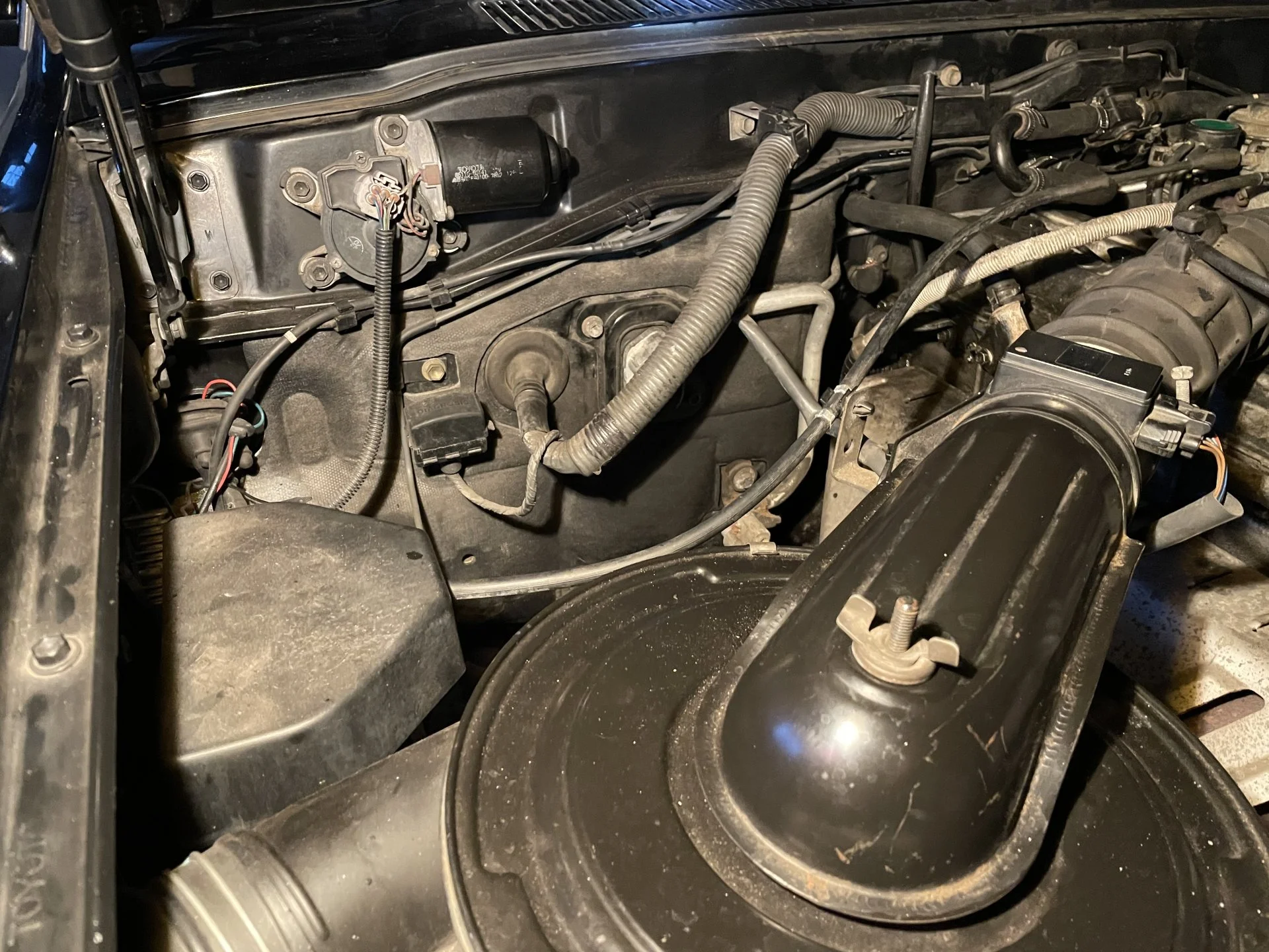

My problem is that I can’t see where the hole, or crack is because the only visible is the wet insulation and then dripping down by the heat shield. Looking at the photos you put up in your original post, I have the exact same leaks. It’s as if you took photos of my truck and described my leak.
It looks like it all comes from that area. I’m guessing the culprit is the hose going from the thermostat housing away towards the firewall (to the left of the heater control valve).

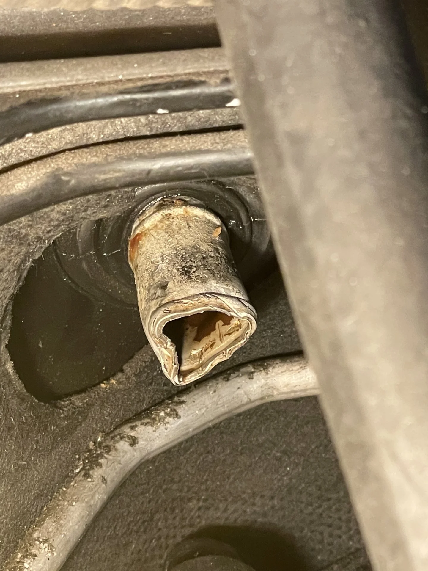

I found the problem, the pipe leading to the heater core was not round at all and the hose couldn’t cover it properly. Also I pushed the heater hose all the way into the firewall, which meant that the fluid was pushed through the grommet into the backside of the firewall. Hence I could not see that this was where the leak came from.
With advise from legends I used a pointy round wood stick and slowly made the pipe as round as possible, and then clamped the hose more carefully. Now, not a drop leaking!
