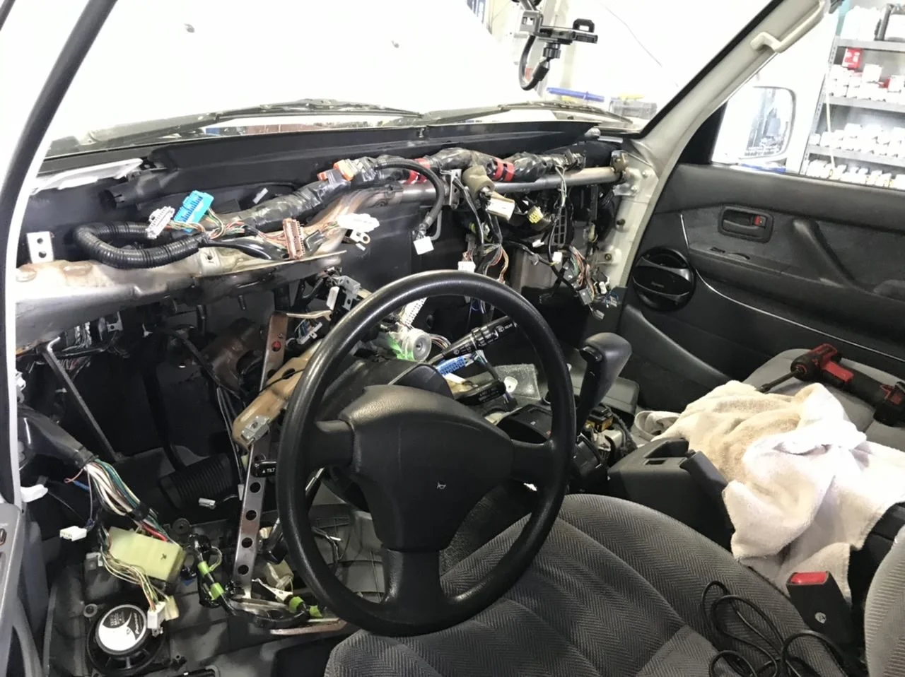

This is what my dash looked like when my mechanic was replacing the heater core.
sadly your's has the old style dash so its a good 8 hour job, if not more. my biggest issue was finding one. they changed the style, and the box it sits in sometime in like 96 i think (96.5 maybe??) and now they no longer sell the one you need. not sure if you can even find it aftermarket anymore (i couldnt 2 years ago when i did this) so i had 3 options.
i could put a used one in and pray. i ended up going this route.
i could have one re-cored but i had a hard time finding someone to do it.
i could replace the compete box for about 750 bucks. way out of my budget.
As much as i love my Land Cruisers superior Toyota engineering, i think Mr T really missed the mark in this case. Requiring 4 hours to dissemble, and then another 4 hours to reassemble the dash, just to replace a heater core is asinine. But it works out great for any service department labor wise, the customers wallet, not so much.
