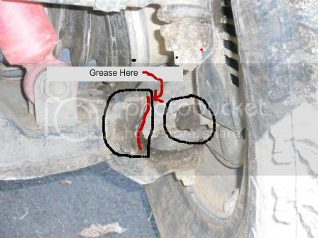

It's your steering stops. Look for the bumpers on the swing arms, there's supposed to be plastic pieces on them but often they fatigue and fall off.
Edit: oh yeah, the plastic covers are on the knuckles. Like posted, just put some grease on the stops in the photo.
X2, easy fix.
