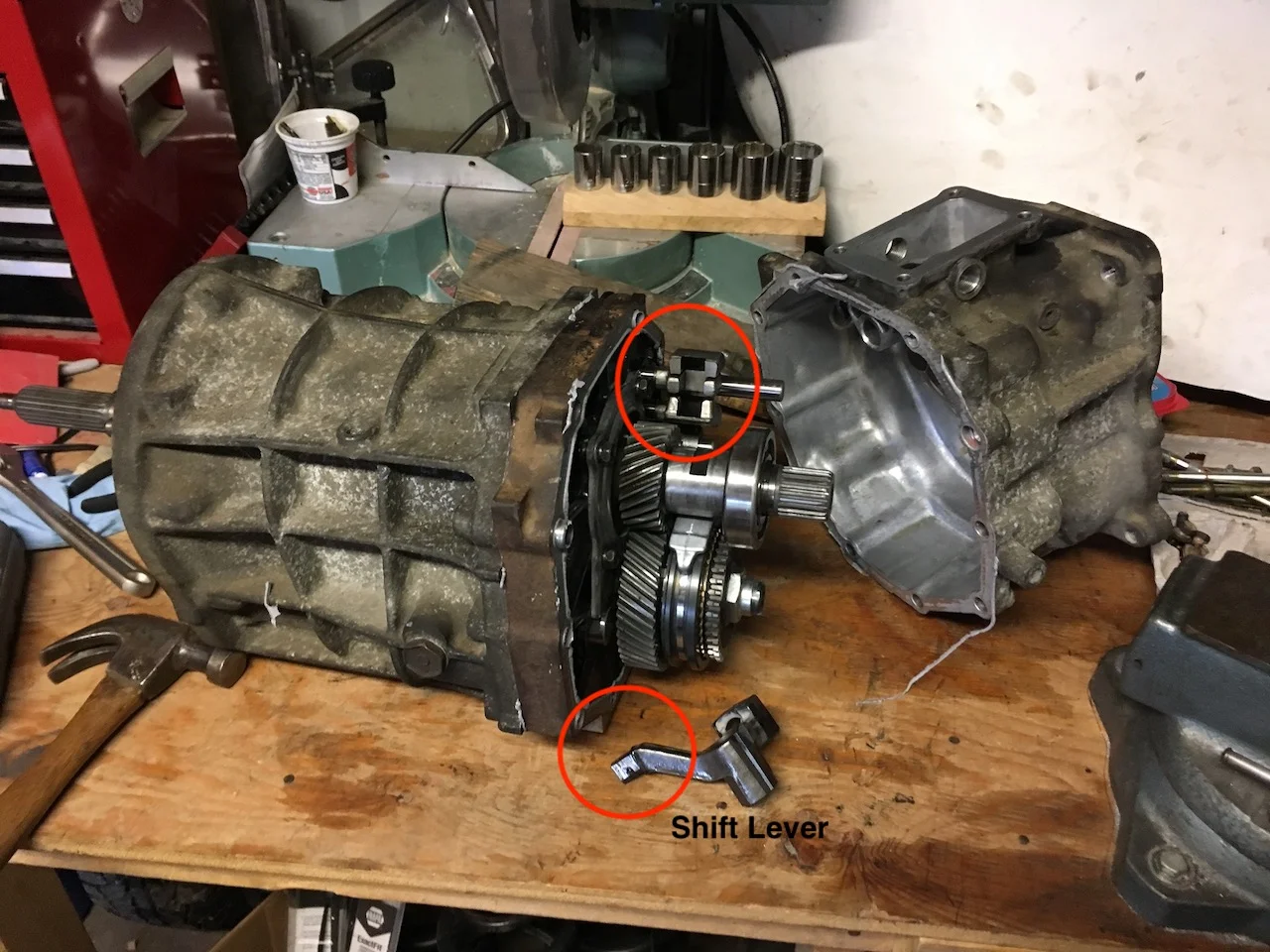

Unfortunately there isn't a good way to check for wear in the shift fork shafts or shift lever without disassembling the transmission. Here are the parts in question; the shifter goes in a socket in the top of the shift lever, which engages with the slots in the shift fork shafts. Wear in either of those components could make it difficult to move the shifter side to side. The detents for the shift fork shafts could also be worn, making the slots in the ends of the shift fork shafts offset from each other a bit.
Cool. Thanks for the input. I might start having a look around for a spare box & have a talk with some transmission shops.
Could be something else in the shifter assembly as well, wouldn't hurt to pull the shifter and check the shifter bushing and make sure everything looks clean and nice down there.
