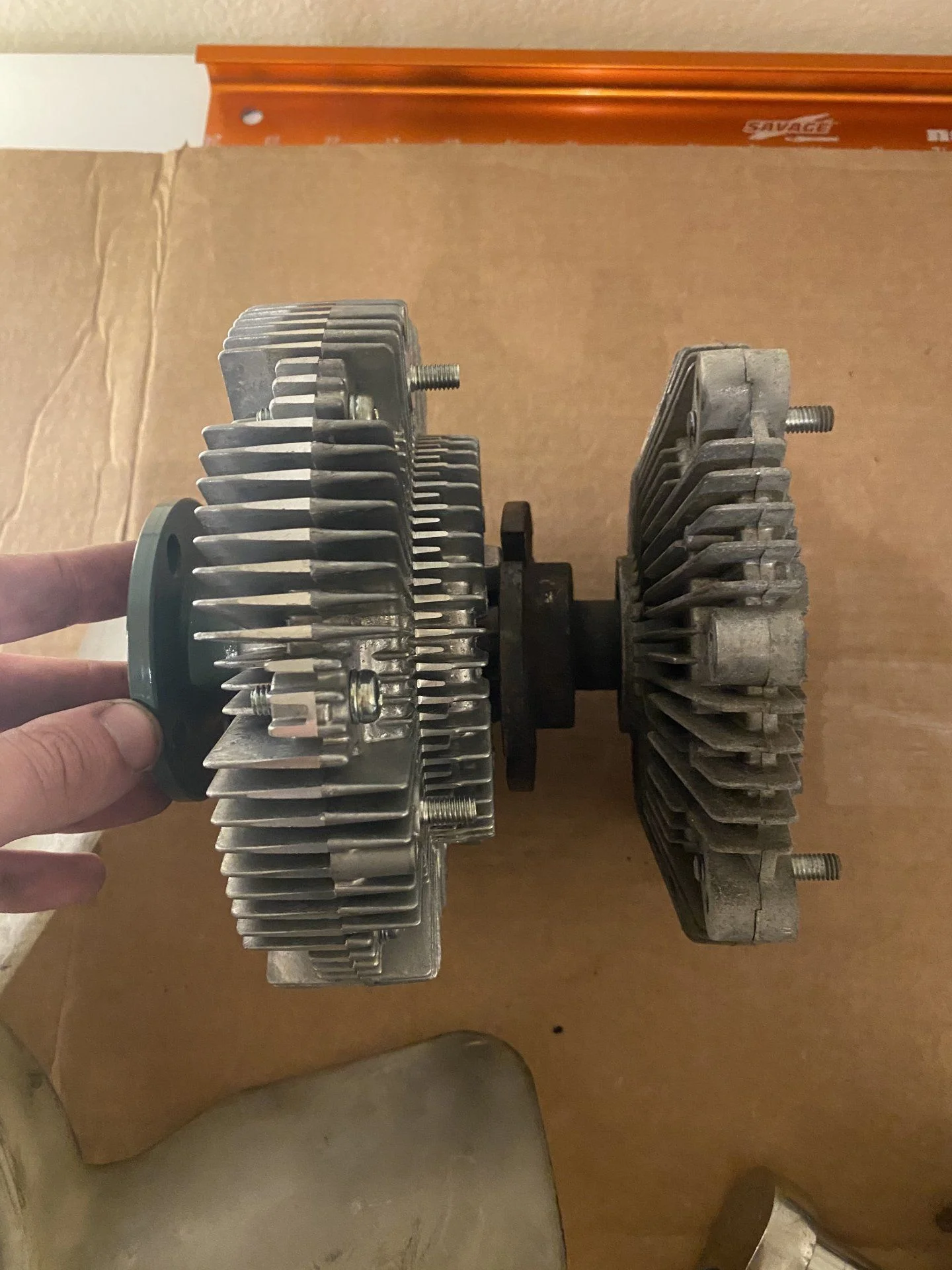

Ended up finding my issue to be the previous owner had a really dumbed down fan clutch installed, and not the beefy OEM unit.
Replaced it with a factory Aisin clutch as recommended by @jonheld and so far no overheating in 115 degree Phoenix weather! Still have the 15k oil just in case the fan needs more oomph, but don't think I'll need it, A/C stays cool at idle as well!
Picture of the comparison of the 2 clutches, new OEM on the left, what was in the truck on the right, yikes.
