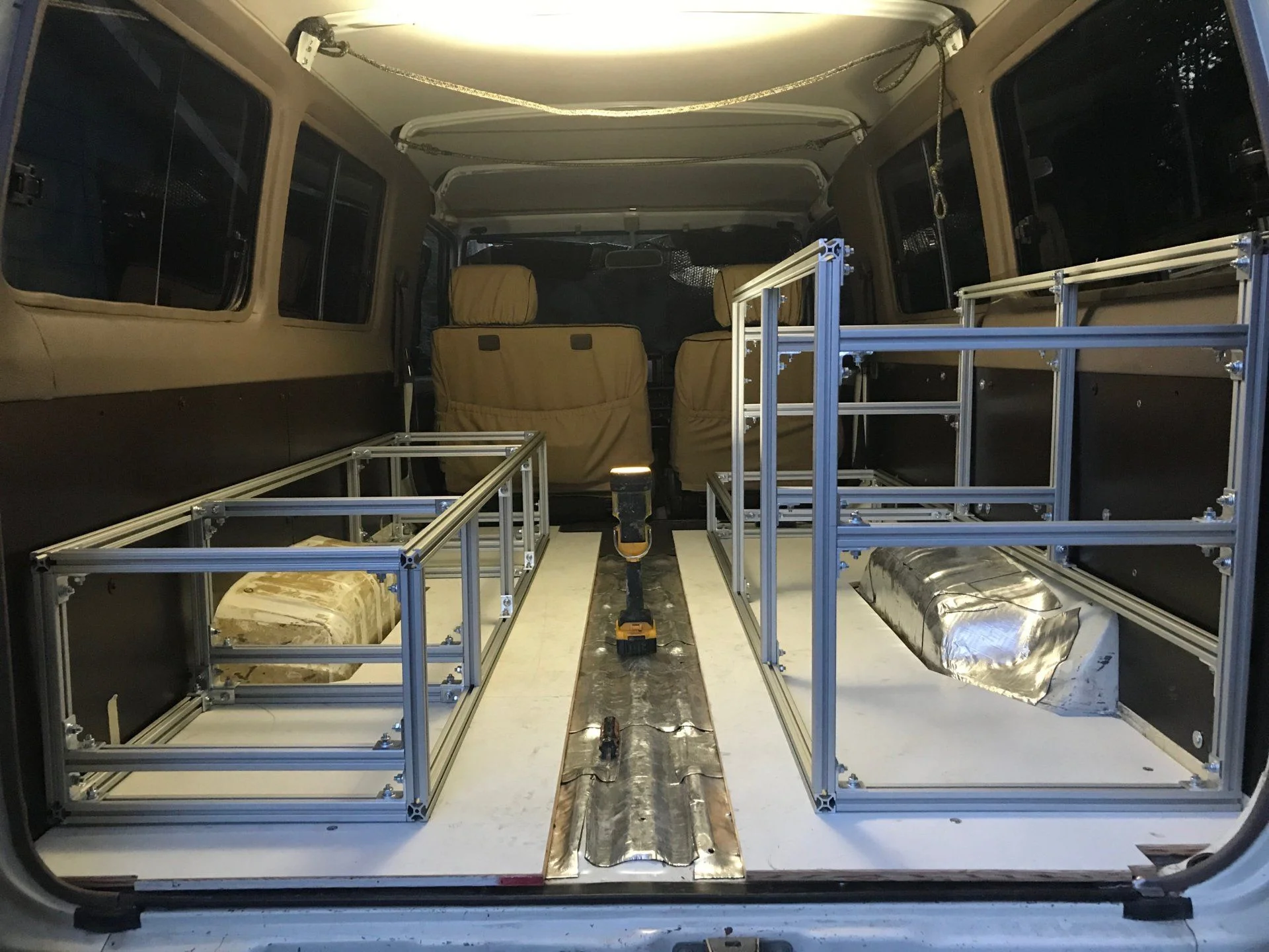

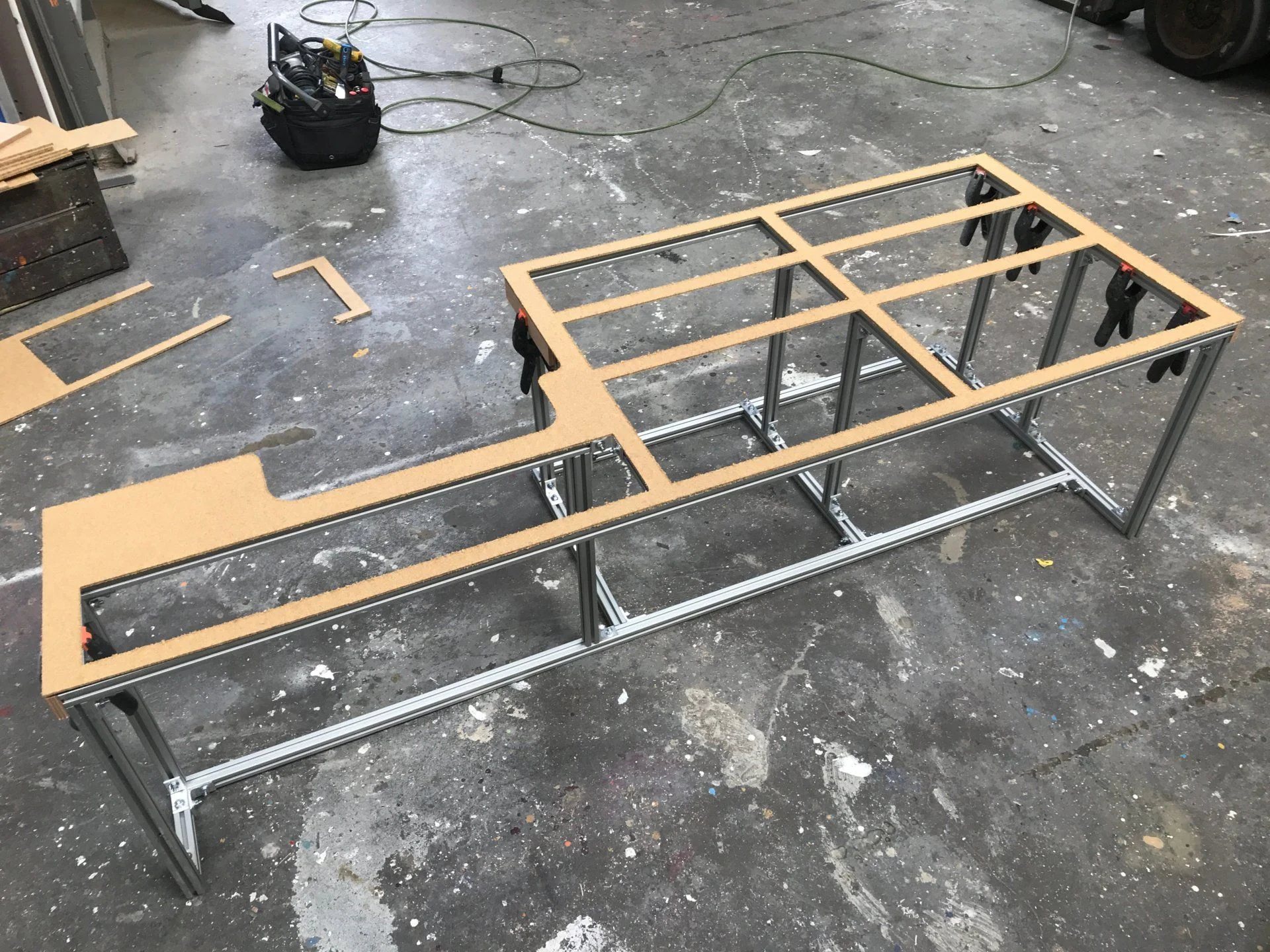

Hey guys. Just a quick update as I'm out of town working (what else is new) and materials just arrived to Portland to start building out the back. Luckily my buddy and builder got a chance to do some work for @umpqua and we were able to incorporate some of his good ideas, and get feedback on what didn't work.
There were a few simple priorities:
1. Light and strong
2. Be able to sit down inside without popping the top
3. Be able to stealth camp without popping the top
4. Clear walkway from front to back
5. Area for surfboards that doesn't require moving them to access drawers and storage.
6. Fridge access from the drivers seat for 100% non-alcoholic beverages of course
Materials:

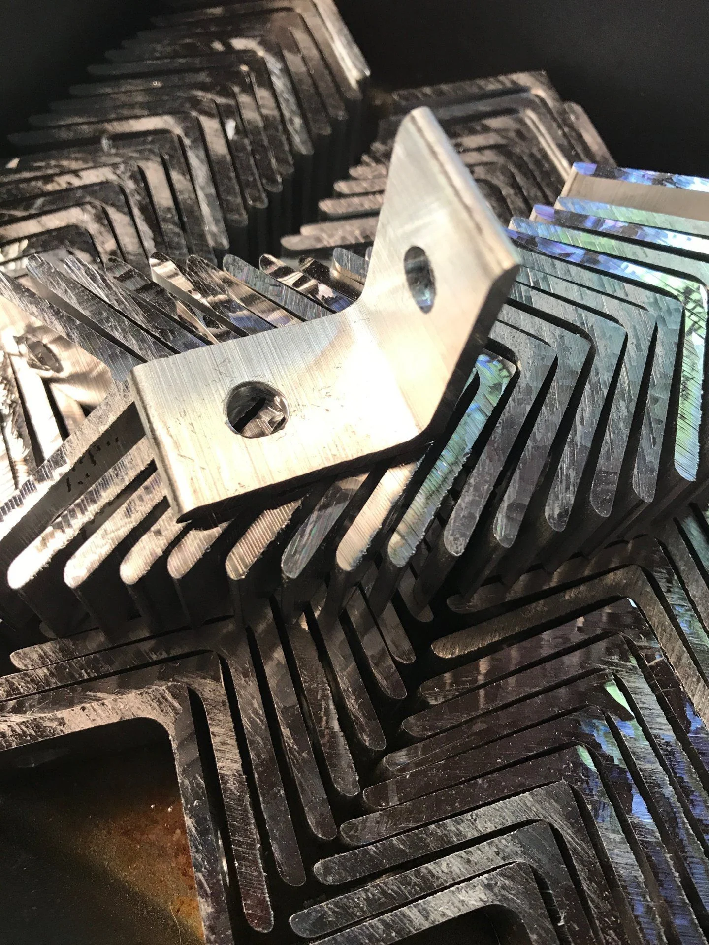

We ended up going with the 80/20 aluminum extrusions similar to what GooseGear does. A lot of the cost associated with that system is their proprietary connectors, but we were able to machine/fab our own in most cases. Drawer fronts and cabinet sides will be made from Okoume plywood. My dad is a long time boat builder and suggested this when I discussed the project with him.
I had to order a new fridge since the way the lid opens on the ARB is problematic for where we wanted it. Ended up going with Dometic CFX 50. More pictures coming in the next few days.

I sent my mine as well. Chop top party! Now the agonizing 3 month wait. :( On the bright side, the boxes in the back are all framed out. Waiting now on some drawer slides and some other bits.
2006007
Wow, this is coming along. I'll follow but would love to take a look at any point in the construction. Dana is going to do a great job for you.
Accuride Slides? Seems to be the go to although I really like the high density plastic ones in my 62.
