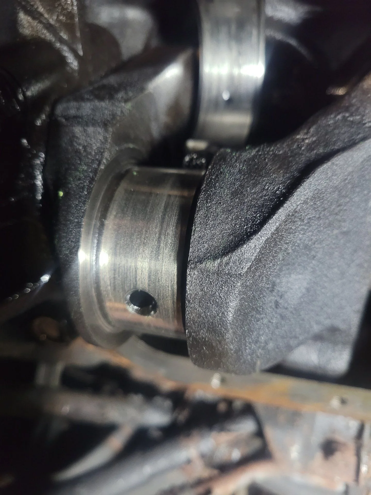

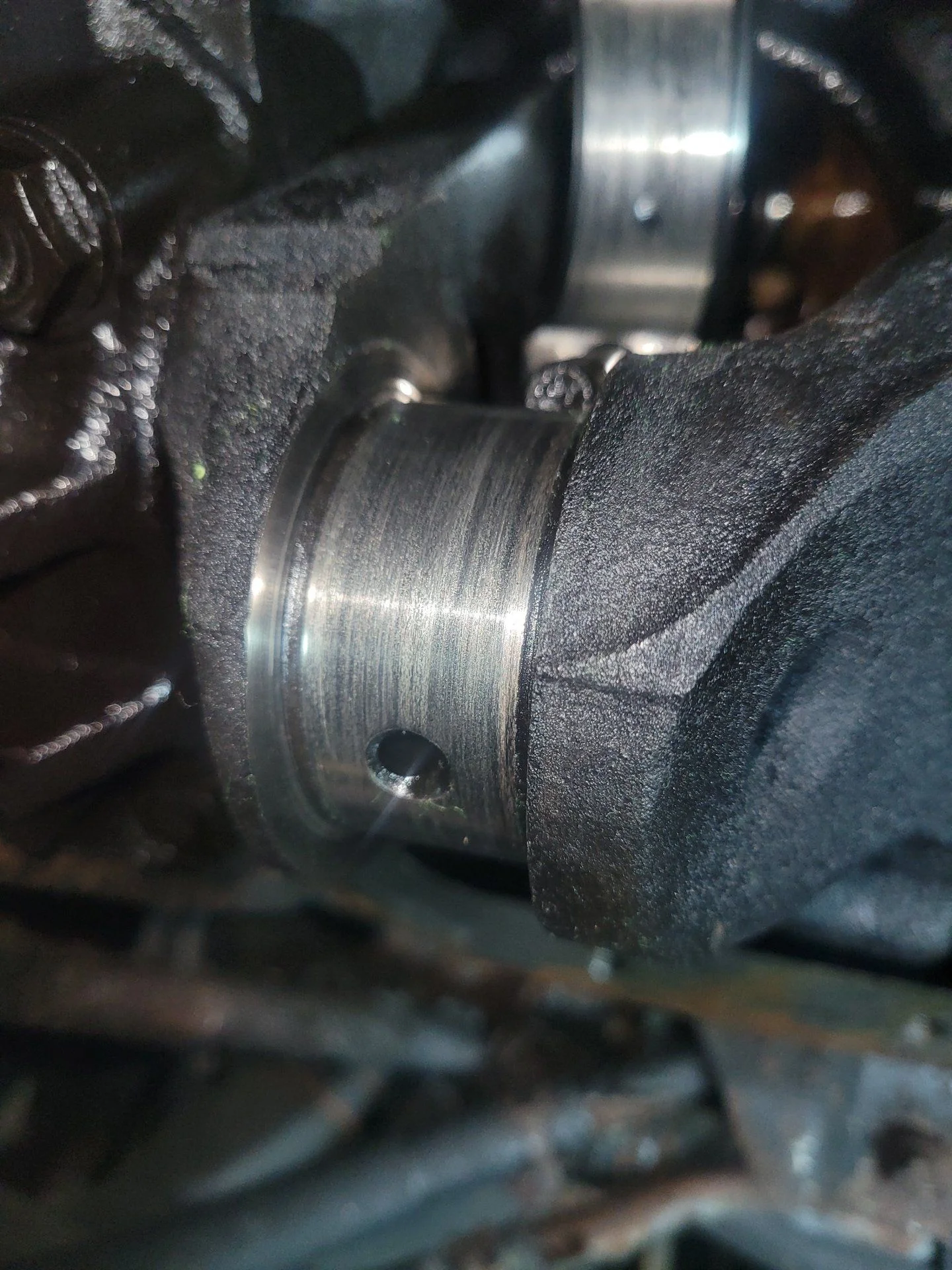

what does the crank journal look like?
It has a step to it but fairly clean. No deep gouges. I am going to post up some pics with measurements hear shortly. I just bought a micrometer to measure how bad the step is.

I took some measurements of the crankshaft journal. It measured at 2.3172 on the virtical 2.3034 on horizontal.
The step I felt on crank journal would not show up in the micrometer readings.
FSM has the clearances at 2.6xxx.
Here are some pictures of crank journal and rod.
It would be really great to get some advice.
If the journal is .014" out of round, then the crank needs machined undersize at least .020" to get back to being round. Round is a good shape for spinny bits.
That bearing spun inside the rod journal. The rod and crank need to come out to be resurfaced and trued up for new bearings.
Also, all the junk that came off those, went through the oil system and the other bearings got some of it too.

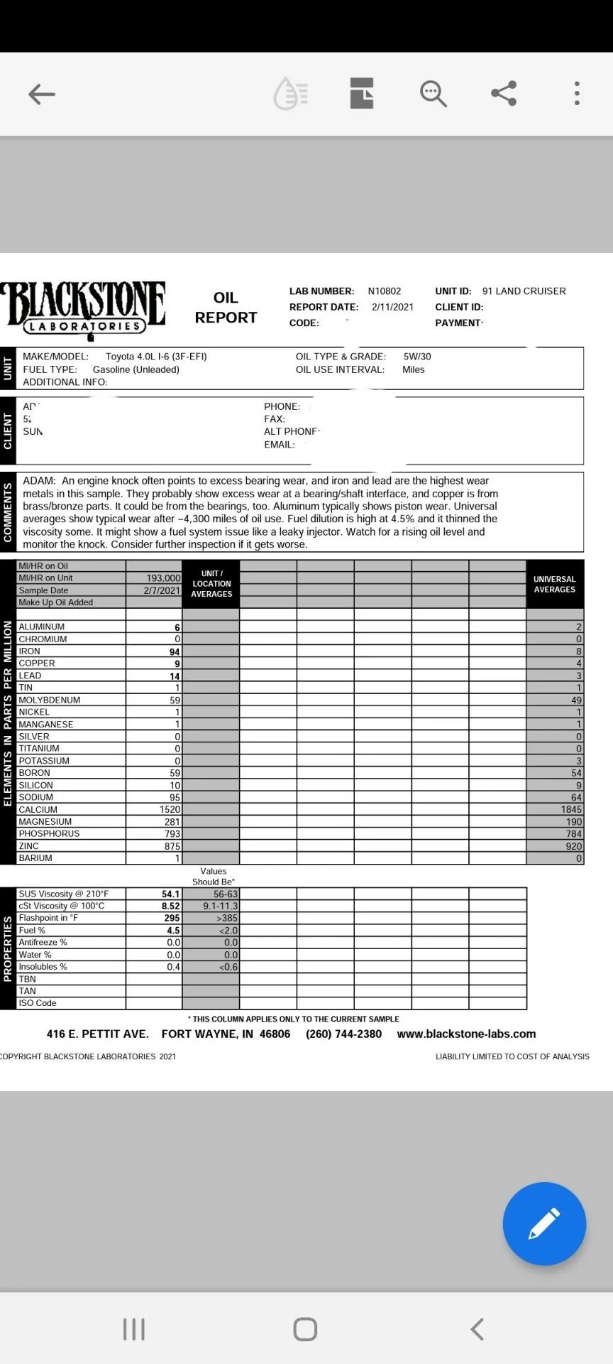

If you are wondering what a blackstone report looks like on a badly spun bearing. Here you go!
