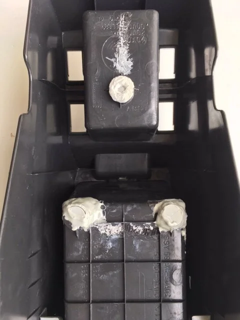

A couple of pictures of when I began patching up the unit.

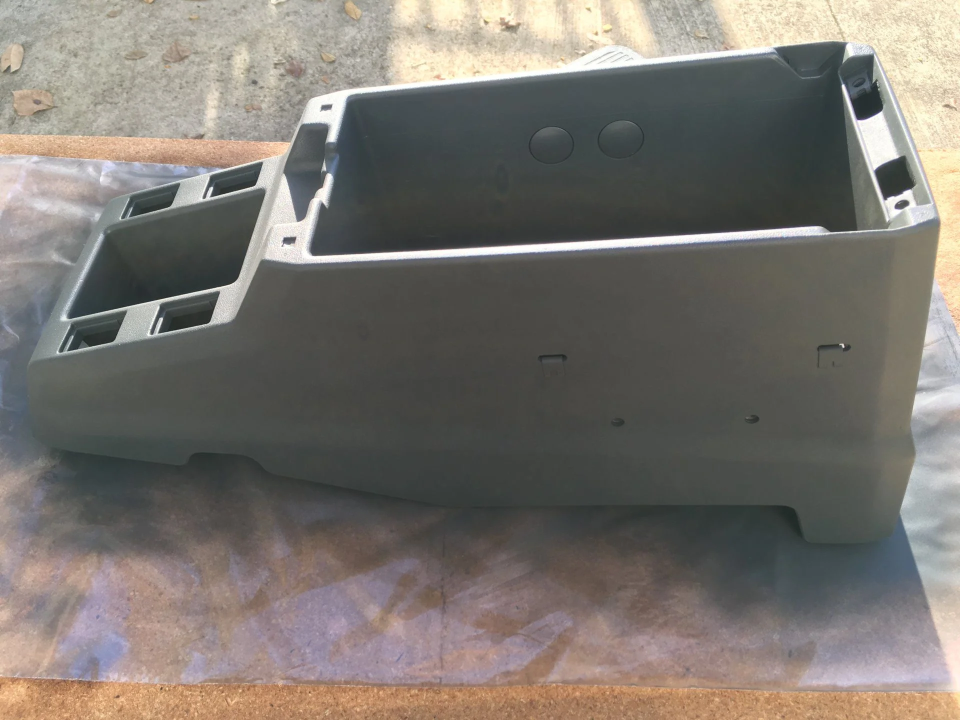

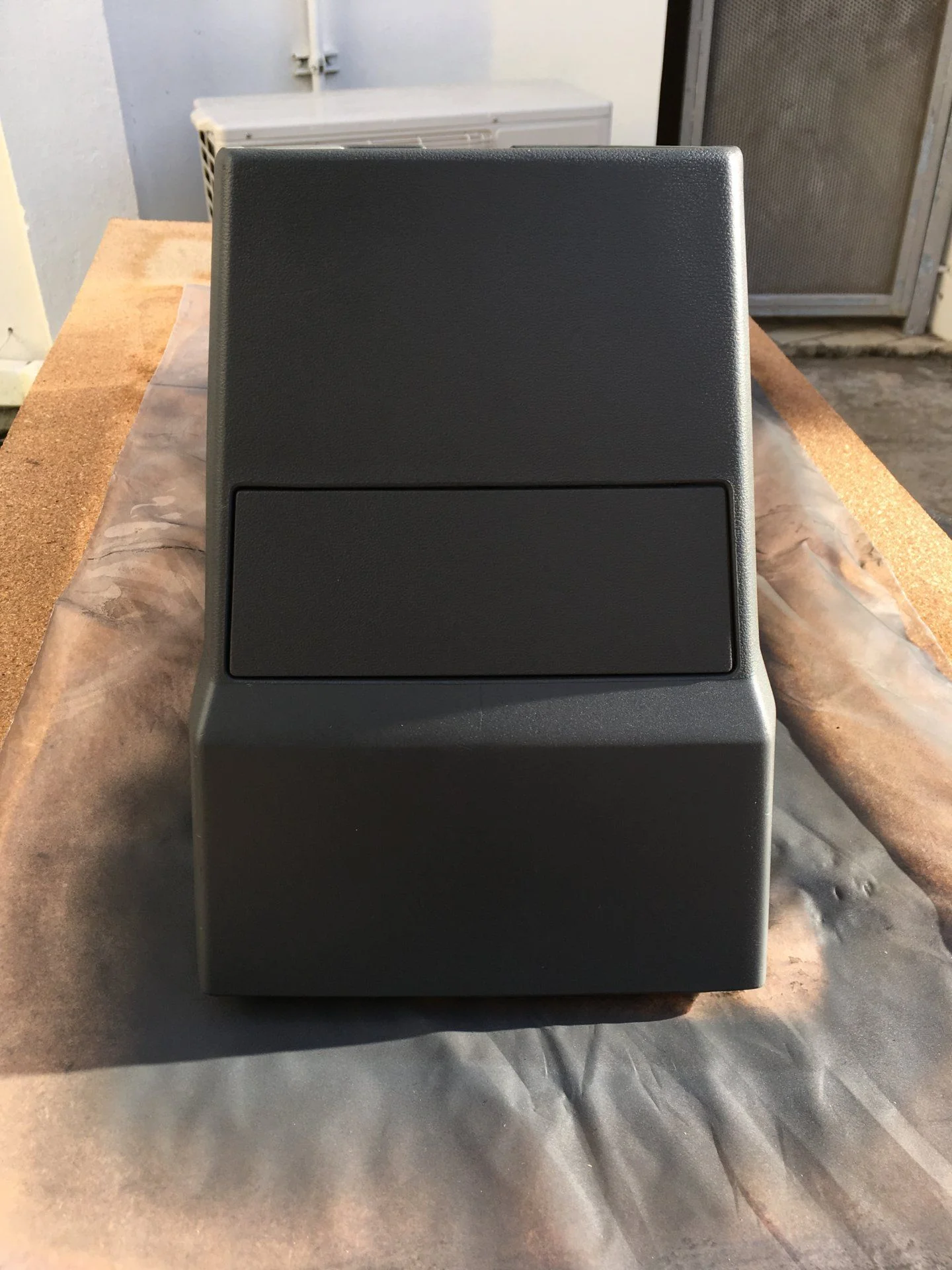

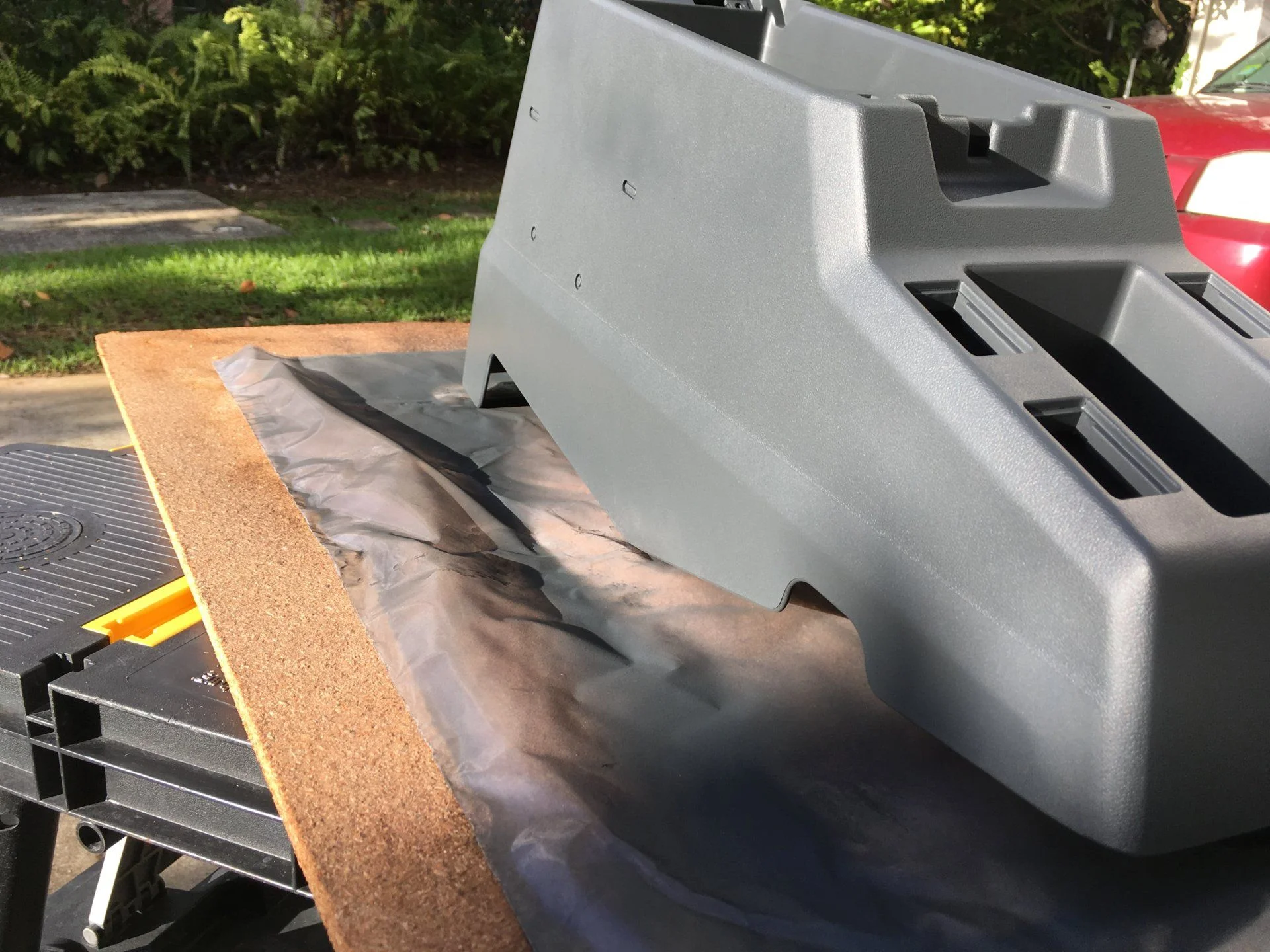

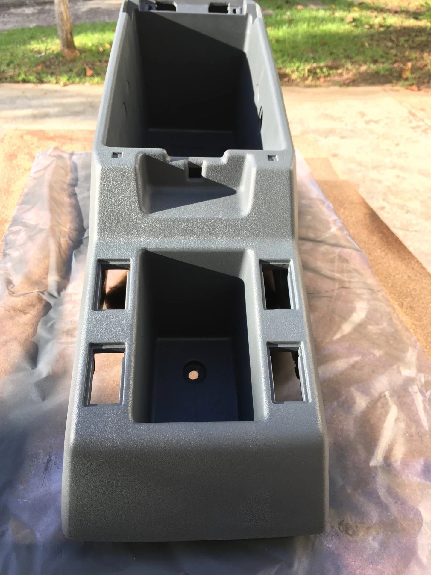

Ok. So the sun was shinning today and I decided to give it a shot. Here are the steps I took:
1) thoroughly washed rewashed and washed again with Dawn
2) washed rewashed and washed again with simple green using a green scuff pad
3) used TSP and TSP substitute to try and make sure all the grime was off
4) sprayed on SEM 38353 Plastic Prep and wiped off with shop towels x 2
5) sprayed 4 light coats of SEM graphite 15303 recommended by @CaptClose
Super content with results. My biggest mistake was having used a heat gun to try and bring out the plastics oils and recondition the console that way, prior to deciding to paint it. The blow gun method was NOT effective and cracked+ondulated the console. If it were not for the imperfections caused by the heat gun, I would say the console would have appeared brand new. Time will tell if it will hold.

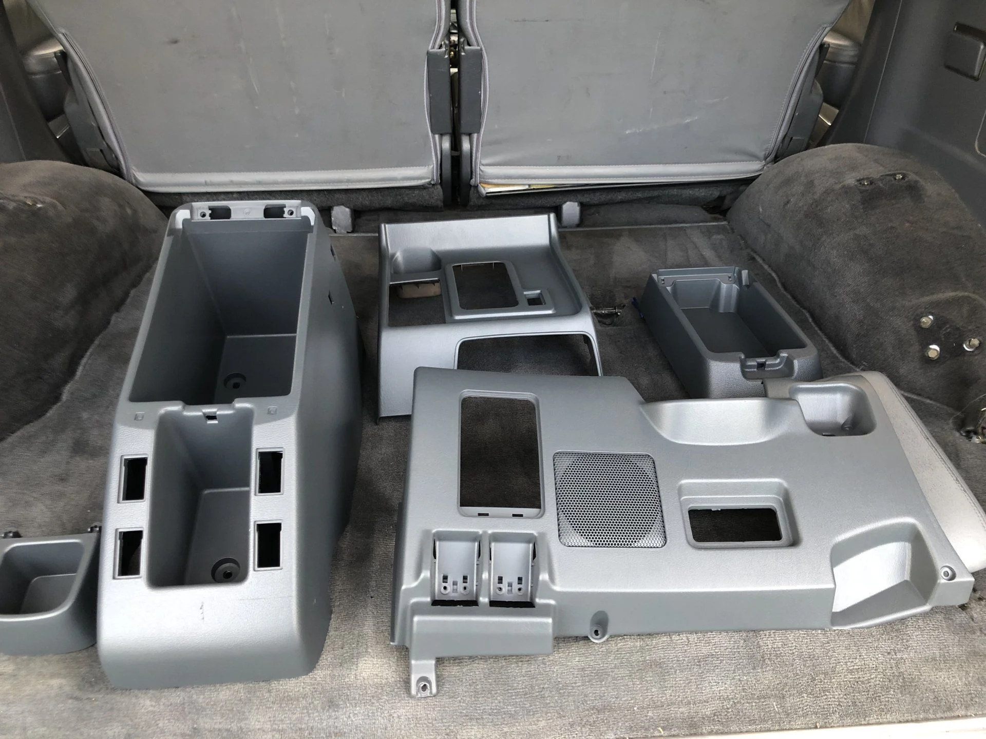

Man... that looks great. It should hold up well because of your meticulous prep work. Here are my results using the same color on my 80 Series.
Rock on! Thanks again for the tip! Yours look brand new. I now know, for future builds, that we can grab pretty much destroyed consoles, plastic weld the heck out of them, sand, prep, then paint with SEM and they will look as good as new.
