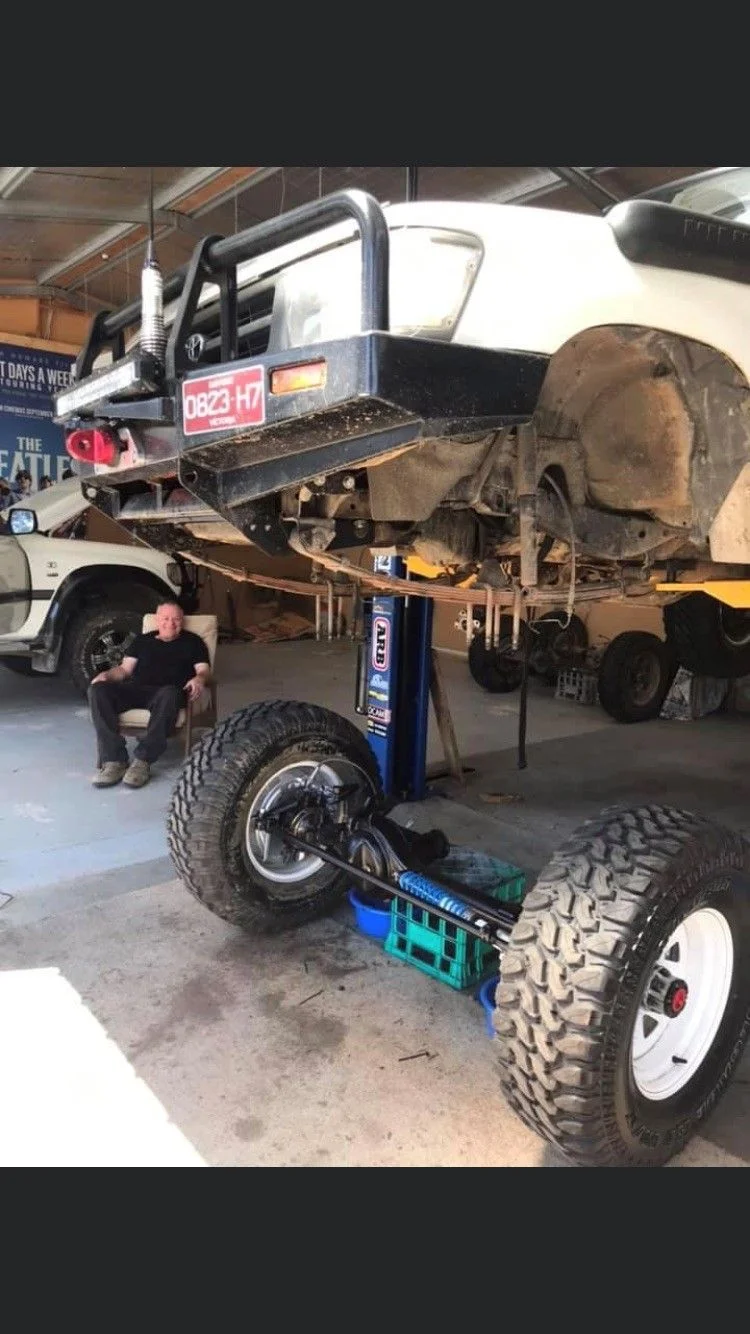

Me too = lift car, wheel out old axles (left the wheels and tyres on) then rolled the new ones with 4.88's (for 33's) and e-lockers under took 2-3 hours
You can see the old axles in the background :)
Me too = lift car, wheel out old axles (left the wheels and tyres on) then rolled the new ones with 4.88's (for 33's) and e-lockers under took 2-3 hours View attachment 2510772
Awesome! I’m still looking for a solid front axle too. Either SAS or donor 1984 or 1985 4Runner.

I am working on it. I want to build a full spare axle with e-locker, disc brakes, full float, and drive flanges. Then swap the whole axle assembly at once.
Smart man. That’s exactly what I did. No down time
