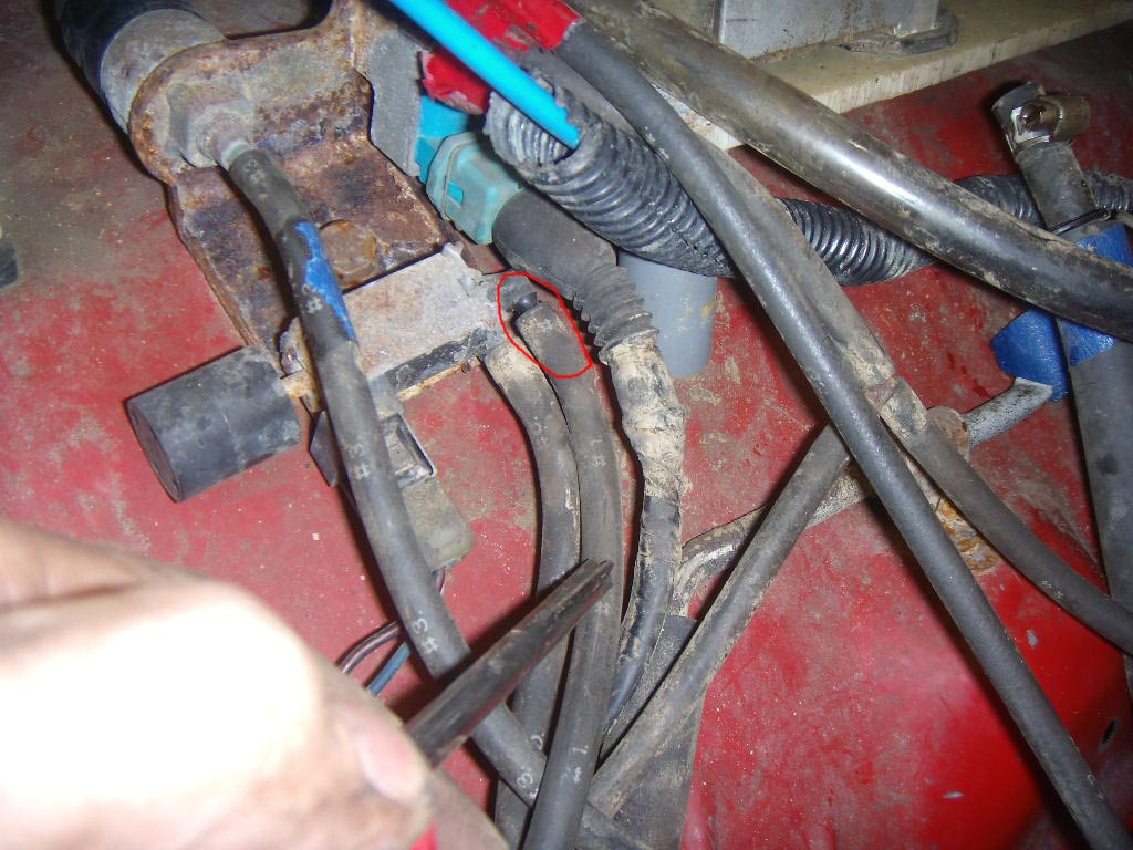

I just swapped an 86 22r into my 85 and it's sooo close to firing up...
I have a feeling it has something to do with these 2 vacuum lines.
Passenger side of engine bay. I don't even know what this sensor is, couldn't find it in the FSM. has a #1 on the line, about ~12" long
As on pass side, bottom edge of the air box. Had a ~6" line on it, so I know it wasn't the line in the first pic.
Ok, I figured out that the line on the bottom of the air box goes to the second line from the top on the VCV :)
However, I now have another vac line with no home.
It is the line right next/below the circled one in this pic:
I can't even find this sensor anywhere in the factory service manual for my 85 truck. I have stripped the 86 truck that the 22r came from but I don't see that there was ever a sensor like this on that truck.
Does anybody know what this sensor is? It has a little charcoal filter one one side and 2 vac lines on the other side. I need to know where those 2 lines go.
There's a 2-wire plug going into the sensor with a blue and a back/red wire.
Hopefully this truck will be starting today :bounce:
looked again at pics I took before I toook it part and figured out that this sensor ran inline between the vcv and asv. got everything hooked up nw, but still wont start. if I pour gas in carb, it will fire up and run if I keep giving it gas. I'm about to give up for today....:mad:
