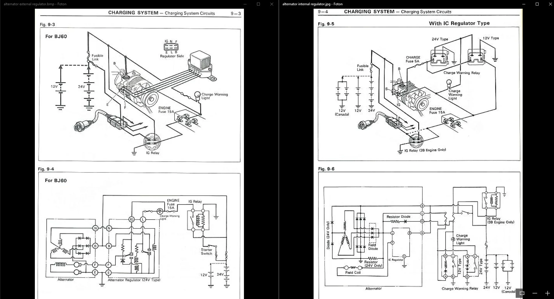

Whole experience makes me realize I've no idea how the alternator is connected to the car.
I've cleaned connections, also tried grounding different things together with a jumper cable just to see if anything helps but nothing makes a difference.
I've studiously ignored the wires under the dash. Seems like a bad ground under the dash? What do I look for?
Does anyone have a diagram of how the dash charge light works?
