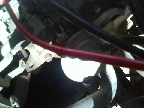

How do you check the egr valve? Will idle at high com's but not lower than say 1200. Went thru half a bottle of carb cleaner and could not find a vacuum leak.:mad:
If so it checked good.
