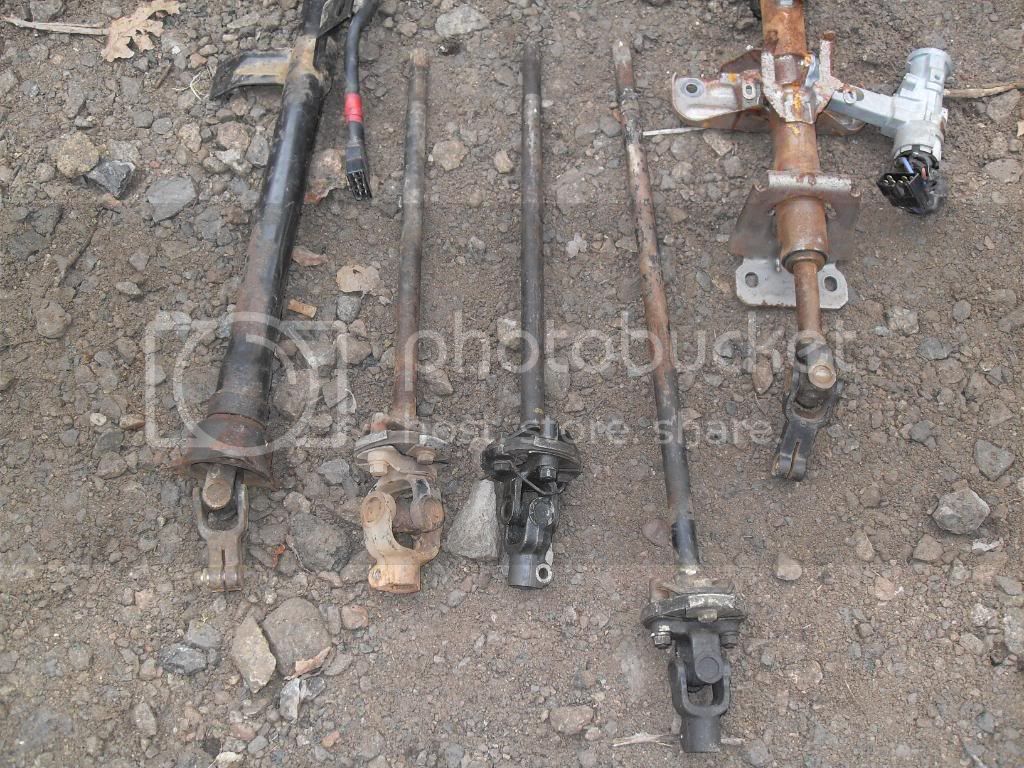

you'll know by now i'm in real time with this project and my next job is the steering. i know i will be coming onto a few issues with this in the near future but the main problem for now is to connect the old steering shaft to the 'new' 70 series steering gear.
as you can see from the first pick i have mounted the unit just in front of the shock tower (which i moved back a little-more of that to come in future posts though).
i have installed a bearing to replace the bush at the base of the steering shaft and now need to connect. the distance between the 3/4'' plain shaft to the 3/4'' 36 spline shaft is 550mm.
i'm guessing i need two ujs and some sort if slip shaft???
can anyone help-i think downeys do something but it is pricey and the wrong side of the pond.
hiluxonian, do hiluxes have a similar arrangement and if so can you source parts??
any help much appreciated

I'll have a look tomorrow (sunday 11th) and get back to you. You may be able to make something up out of 2 shafts I've got a few laying about mk2 and 3 hilux models. Looks the same fitment
Mk2 and mk3 shafts the shorter one is 535mm end to end and the longer 665mm knock a bit off for coverage
Hope this helps
