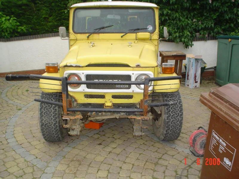

got some time now to post some piccies. i bought this in summer 08.had a 45 in the past (and an lj70) but always wanted a 40, and getting a diesel means big fun to come in water!:). this is how it looked when it came to me

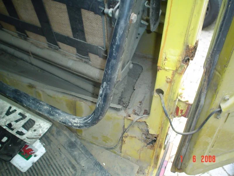

truck was in very poor condition and had not been legal on road or serviced for a very long time.apart from being a rot box it had lots of oil leaks. engine,gearbox and steering box all leaking badly.po had also cut through wheel well to weld chassis. poor descision and poor outcome. anyway i knew it would be a frame off so here we go..................

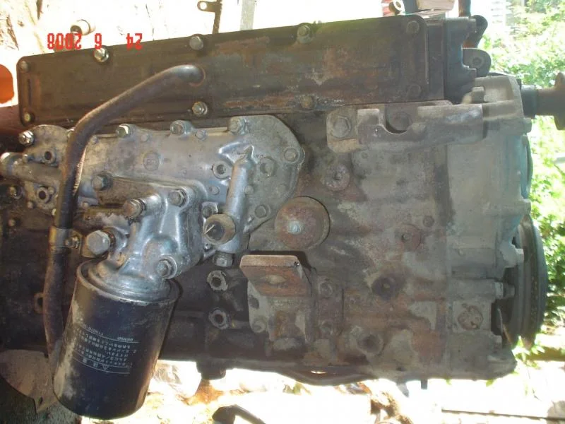

And that looks like a 3B engine rather than a B engine. (I'm looking at the 3-bolt exhaust flange.)
(Here the BJ42 got the 3B engine whereas the BJ40 got the earlier B engine. --- And a B engine has a 2-bolt exhaust flange).

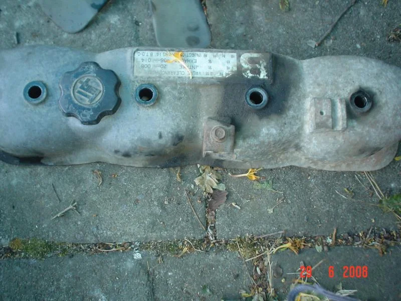

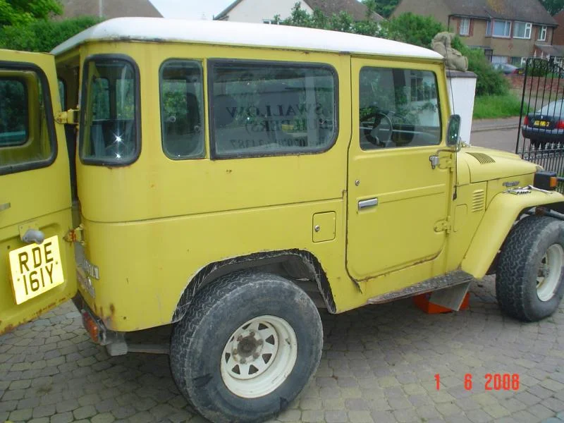

thanks for the info malc-looks like i'll have to drip feed piccies 'til i get me a star.let me go back to the beginning. this is the truck as it came to me.it wasn't registered on these shores 'til 2001.it's declared build date is 1983. frame no. is bj40-059619. someone may be able to pinpoint it's birthday from that??.defo b engine,h41 box and drums alround (ironically the only things that worked properly on it).more info and pics 2moz.

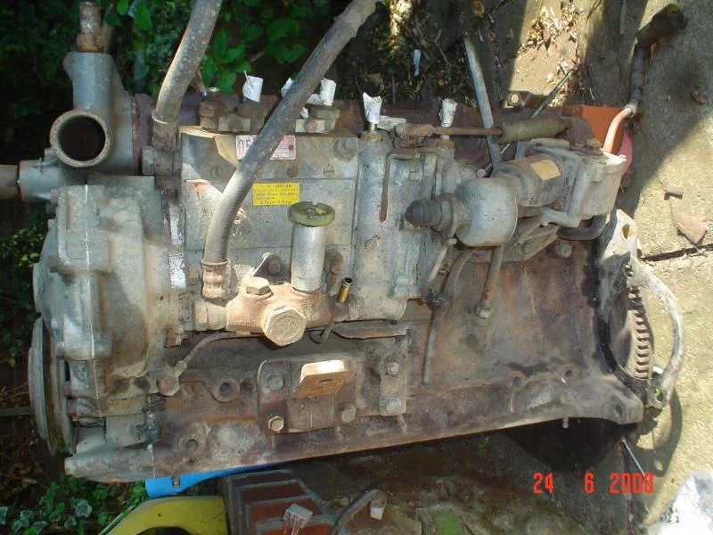

....defo b engine...........
So you are saying you have a "B" (and NOT a 3B) cast into your engine block behind your EDIC motor just like this:
Sorry - It is just that I feel sure your engine would be called a 3B in this part of the world. .............Hell - It even has the 3B-type of oil cooler as far as I can see from your photos.

vin plate also gives engine as b and 2977cc. b is also cast in block and stickered on valve cover. many daihatsu logos on engine parts also.vin plate also states bj40.

Well up until seeing your engine I had been convinced that an "alloy oil cooler" and "3-bolt exhaust flange" were NOT features of any 2977cc B-diesel (but instead were features of the 3B engine).
And I also believed the B-powered BJ40 ceased production around 1980 to be replaced with the 3B-powered BJ42. Now I can only assume that this was just what happened in the Australian/NZ market (and that B-engined BJ40s continued in production for the European market).
Ah well. - I'll have to revise my thinking on this.
Anyway here are some photos of mine to show the 2-bolt exhaust flange and non-serviceable (cheaper) oil cooler:

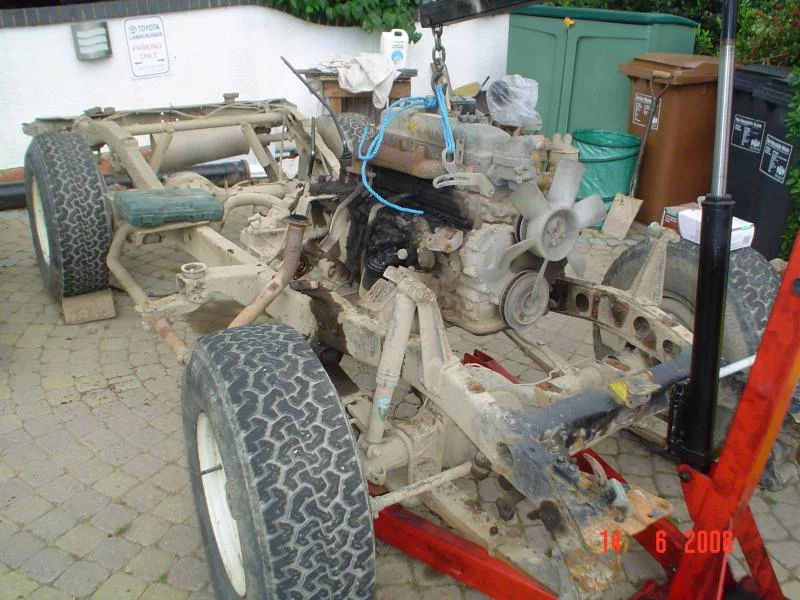

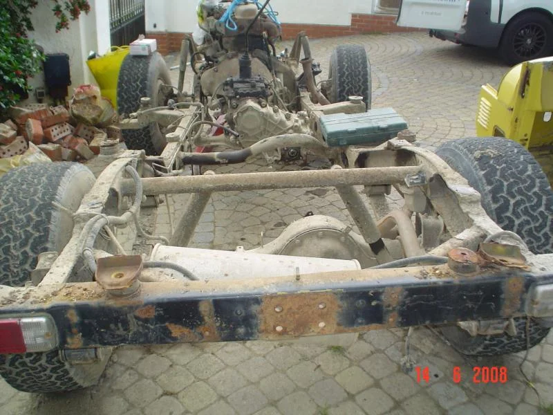

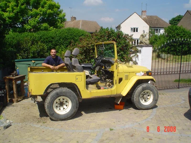

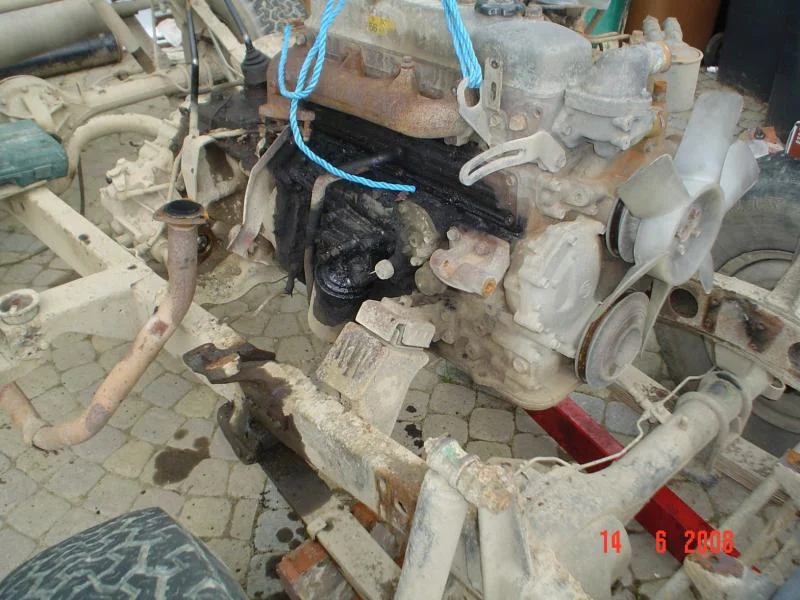

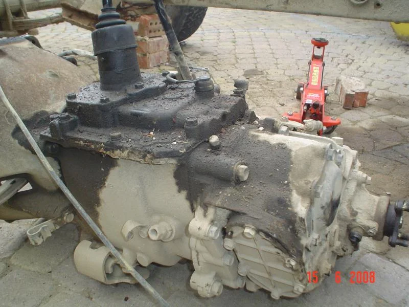

the trucks body and chassis while on the face of it looked ok (i bought this truck via ebay,unseen btw) is actually in a very sad state.more detail to come after blasting,but for now the tear down.note in the first picture the po had cut thrugh the wheel well to weld the chassis. (badly i might add). don't know who the ugly git in piccy three is;)
Should be enough there to keep you busy Rob.
Interesting way that the blinkers/sidelights are mounted to the guards too! :D
:cheers:
(Looks like the UK climate is probably even more conducive to rust than the NZ climate.)

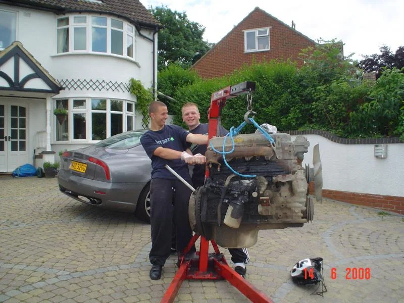

it's certainly keeping me busy-not the engine though-that was sent off to my toyota mechanic mate 'round the corner for new rings and shells as it was 'breathing a bit heavy' as he put it :rolleyes:
the lads are one of my boys and his mate.the b engine is some lump!
note the bits of body left at mounting points on the chassis.

tom, yes your right about the rust -the hollow bolts that mount the indicaters/sidelights were obviously rotted away as was a good part of the fenders, but more of the bodywork to come over the next few days. on my pevious fj45 i hollowed out a couple of coach bolts which worked really well.this time though as someone has mounted them directly to the fender i ordered a pair of pillars and gaskets from sor so they are good to go when the time comes.in the general scheme of things this is a minor issue but multiply all the minors up and you get a major:frown:.-your truck looks nice and clean btw.
