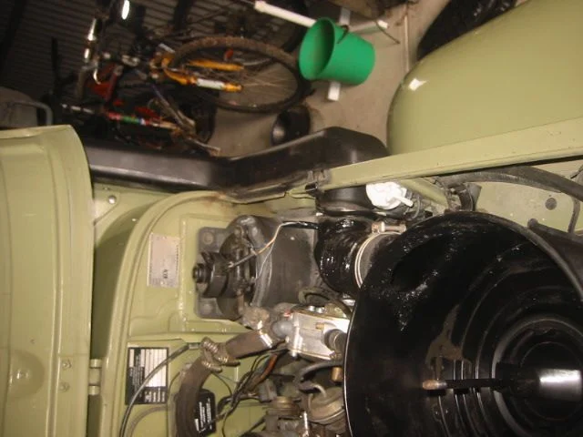

Here's how I put my snorkle in. The primary purpose of a snorkle is for cleaner, cooler air. I think you'd have to get a factory air cleaner to set up a snorkle.
Josh

That came out great but is that giant black cylinder your airbox? Is that factory? Could just be the photo angle but it looks gigantic! The snorkel pass through is nice and clean.

That is the factory non-smog air cleaner. The smog-equiped rigs from the US and from New South Wales had an air cleaner which sits on top of the valve cover. Yours likely had this kind and was from NSW as your power steering pump is on the left side of the engine on smog rigs in Oz. Non-smog power steering pump is on the right side of the engine and has the large cylindrical air cleaner like mine.
