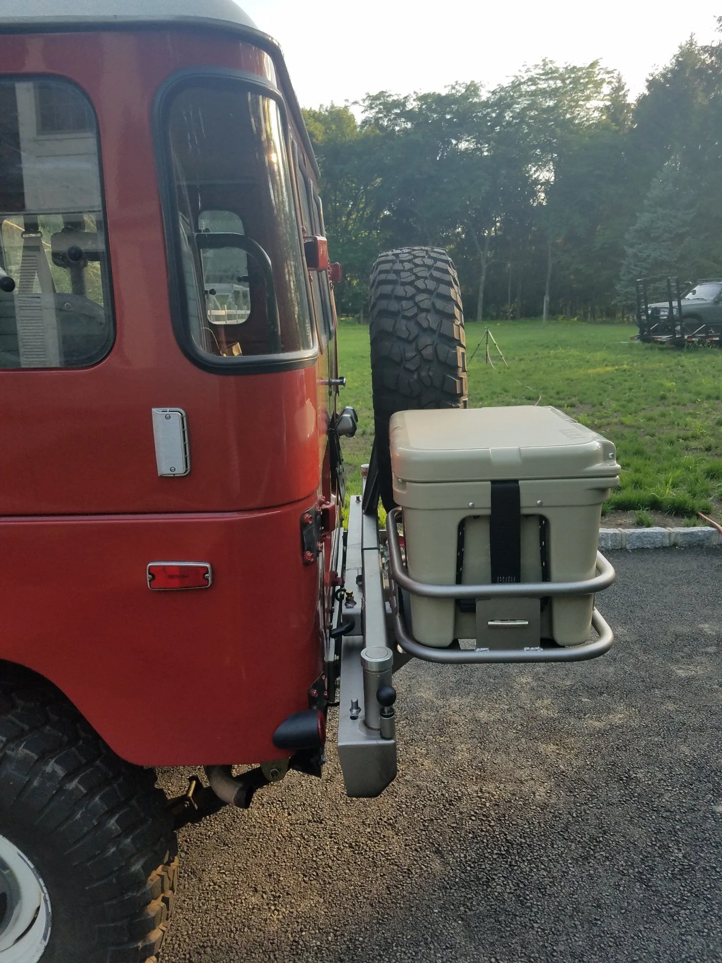

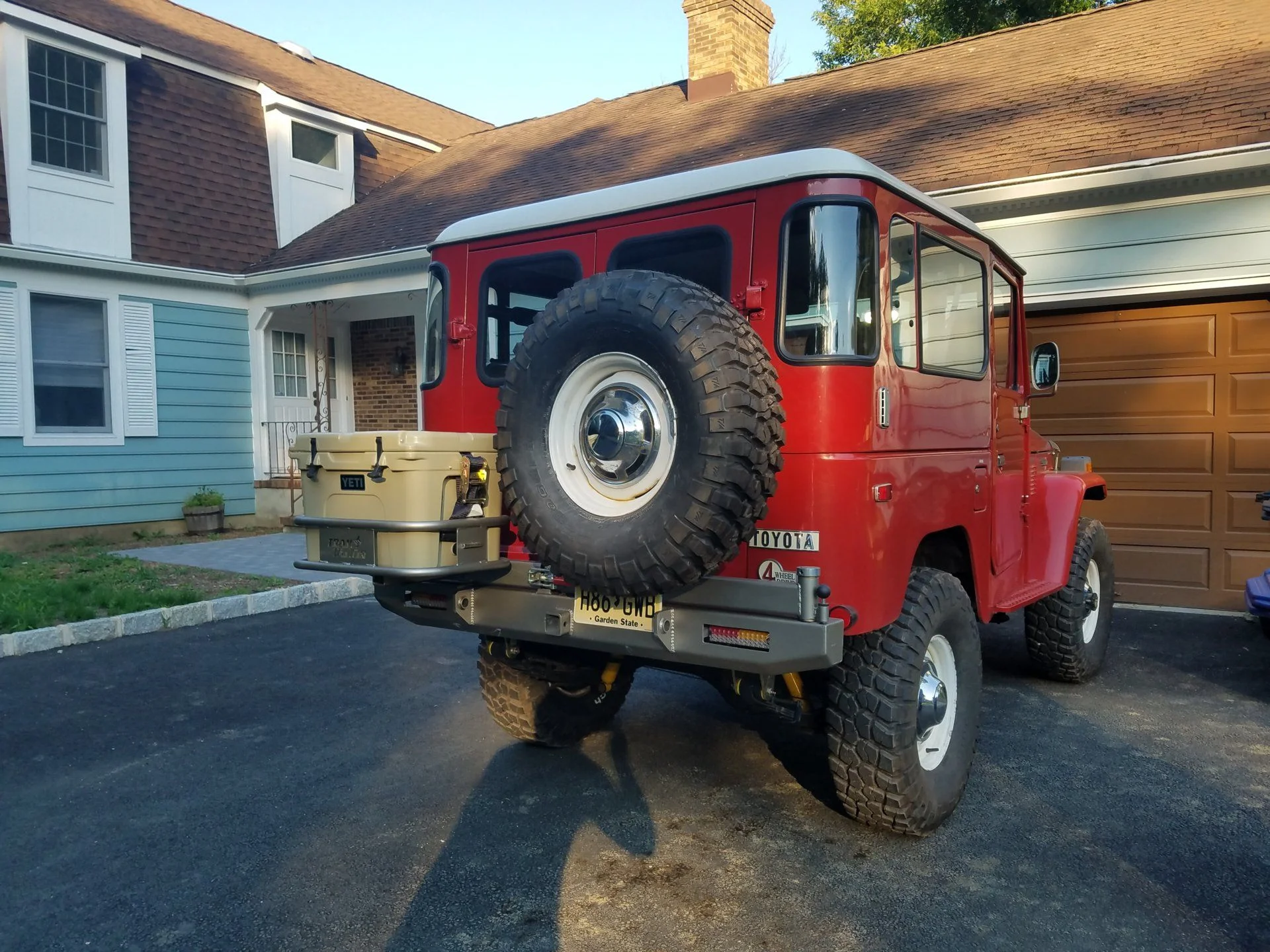

Finally wrapped up the install of the custom @reevesci Trail Tailor rear bumper. I love it.
Jason built a removable basket designed to hold a Yeti 35...which also holds 3 cans if you want to extend range to about 500 miles.

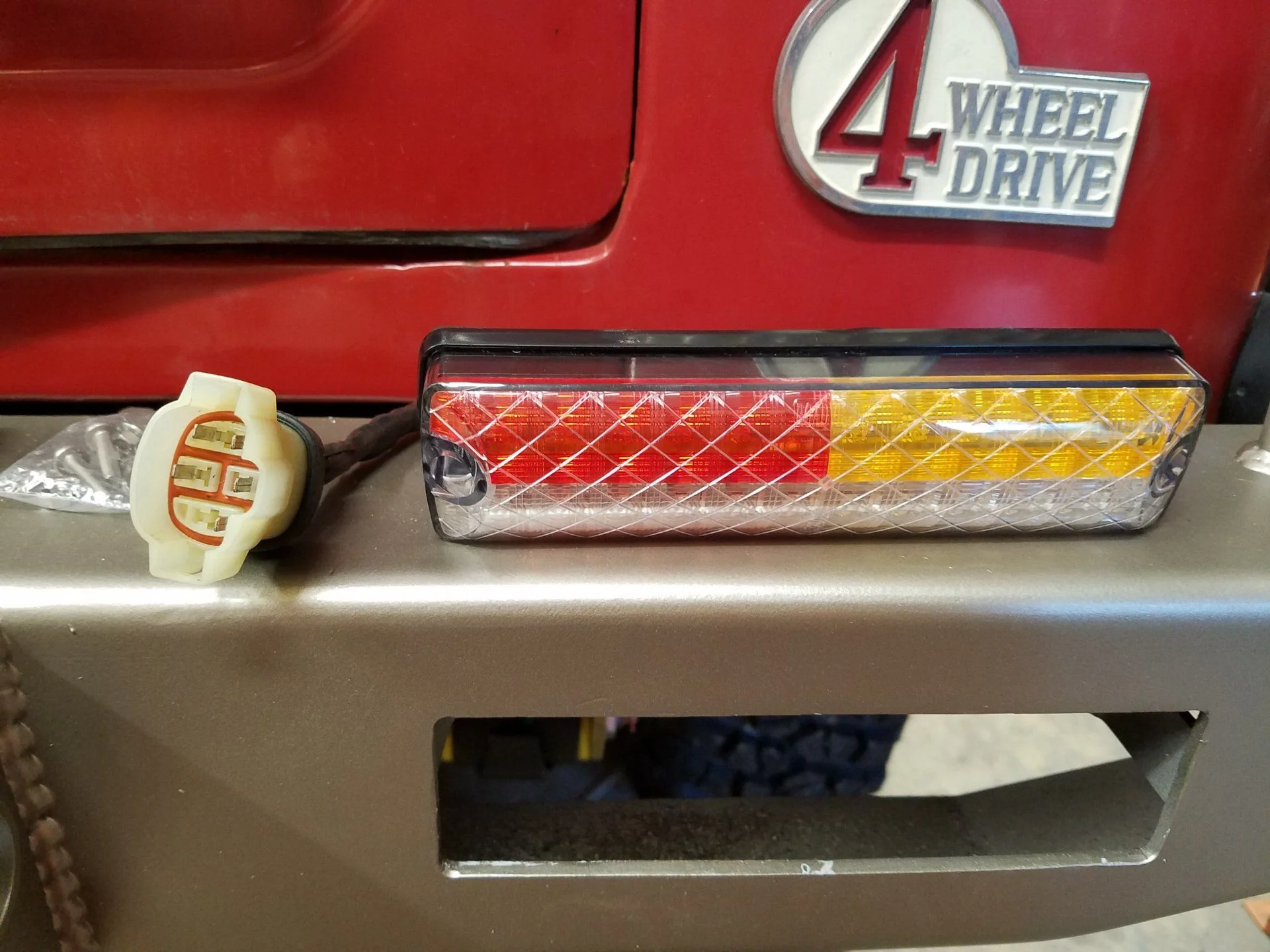

I opted to have recessed LED taillights added to the bumper. I sourced an after market plug from CCOT that is plug and play with the factory wiring harness...wired that plug into LED's and then replaced the OEM flasher relay with one designed to work with LED's...works great.
The Yeti placement is at the perfect height...got to test it out this weekend at the Coal Mine Cruiser Classic.

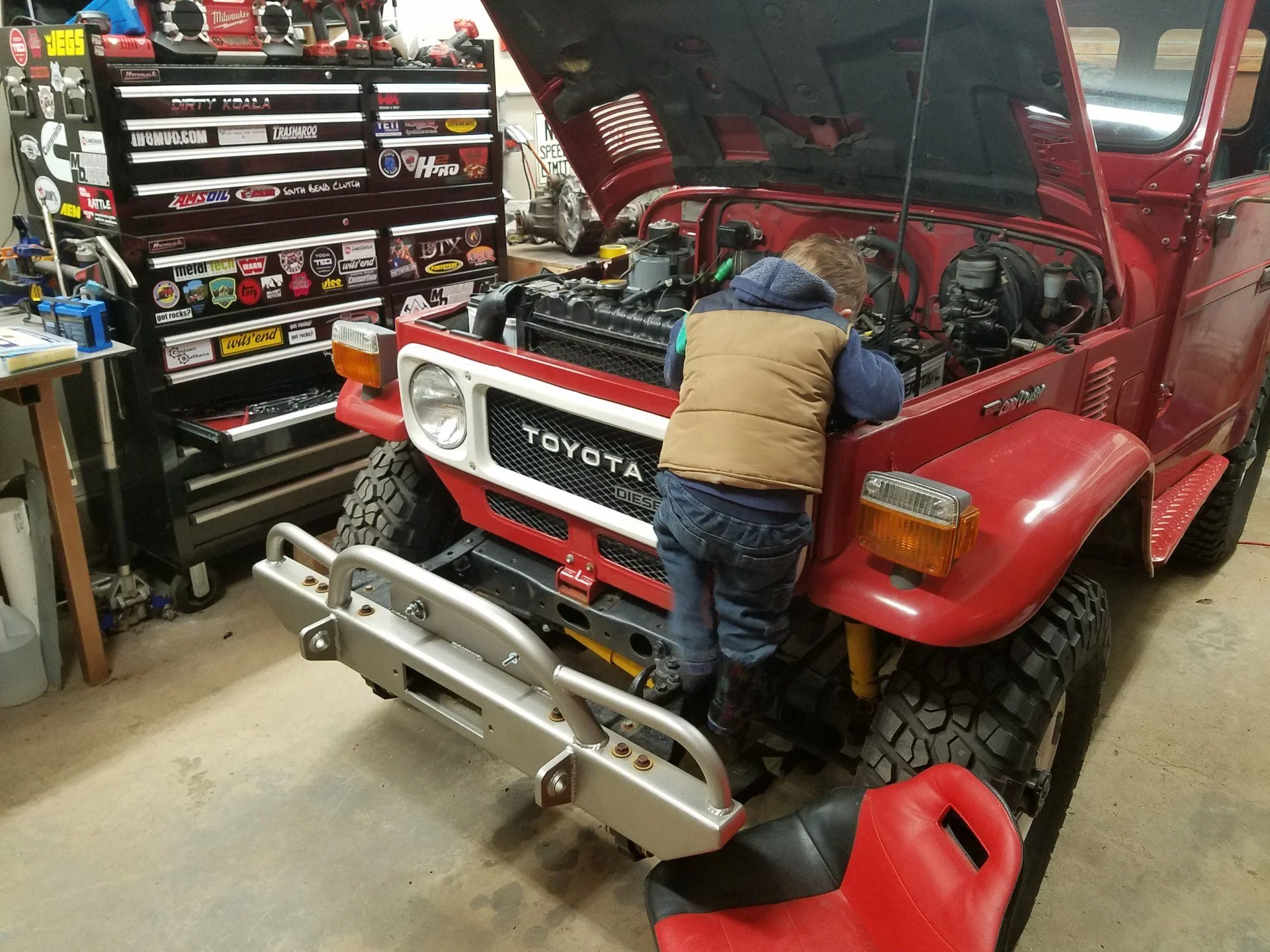

This past weekend I was tinkering with the alternator and power steering options on the 3B and my little apprentice was also hard at work for about 8 hours working on every 10mm and 12mm bolt he could find in the engine bay.
The theme of the day was "Dada, my wrench no work"...10 seconds later "There you go, Dada my wrench work" happened every time he found a bolt that fit his wrench's and sockets.
I eventually gave him some dedicated bolts on the bumper to work on...needed to limit the chances of a fall off the bumper...the boss wouldn't have been pleased if she saw him precariously perched on one foot on the tow hook hanging over the engine with tools-in hand.

Man im digging your rear bumper i think ill go that route when i do my tub next winter. The less holes i have to put in it the better haha.
Yep, no holes in the body, bolts right to the rear cross member. Jason @reevesci built it for me.
