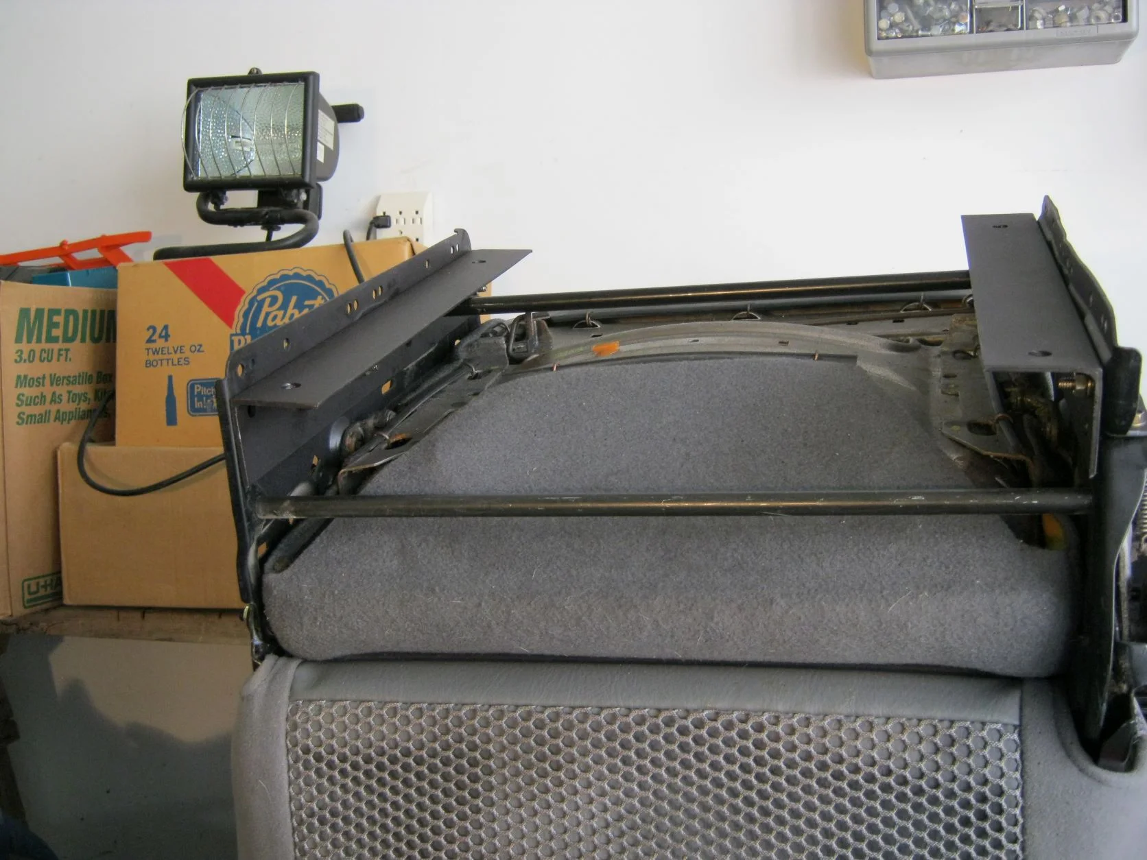

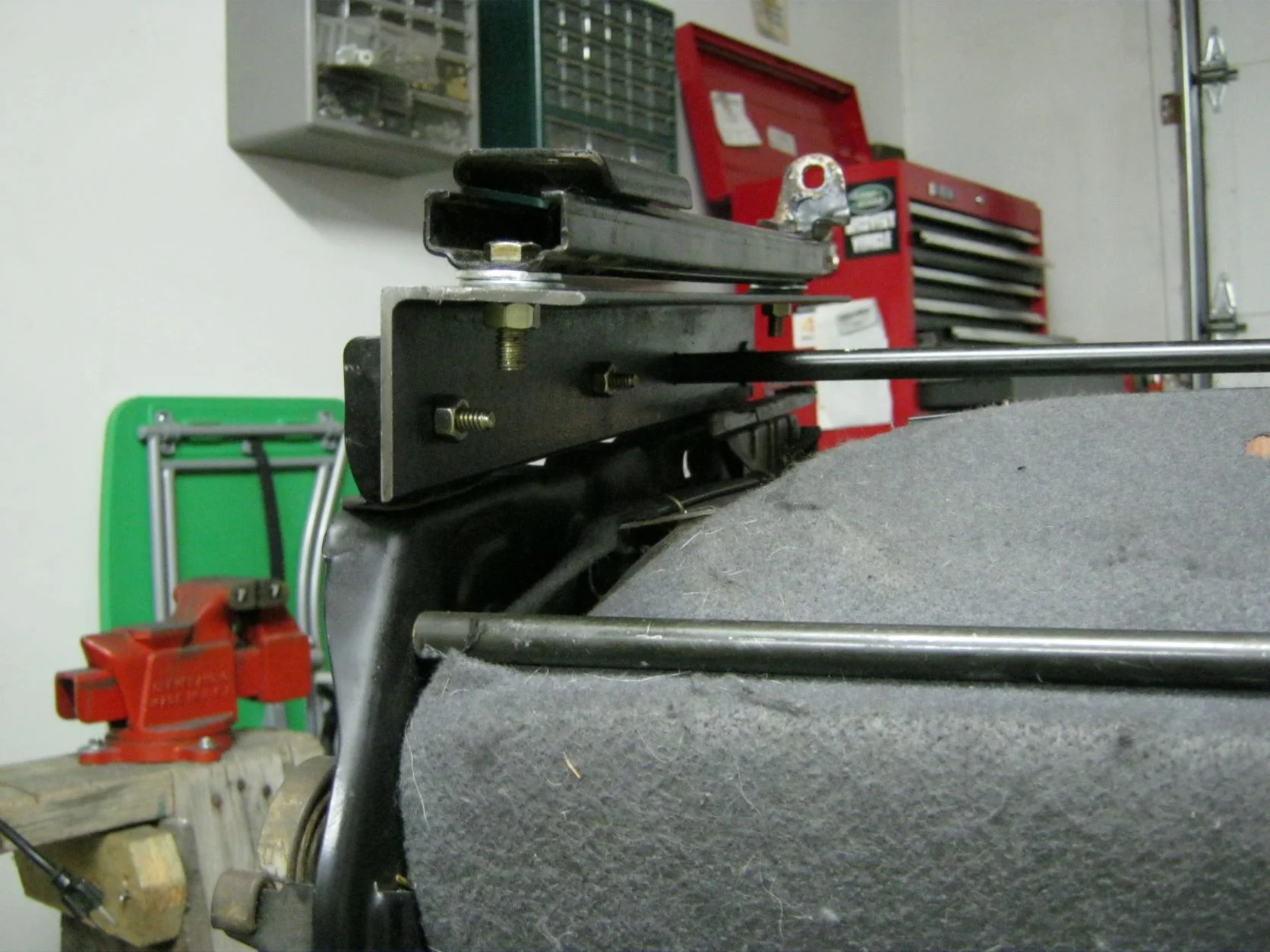

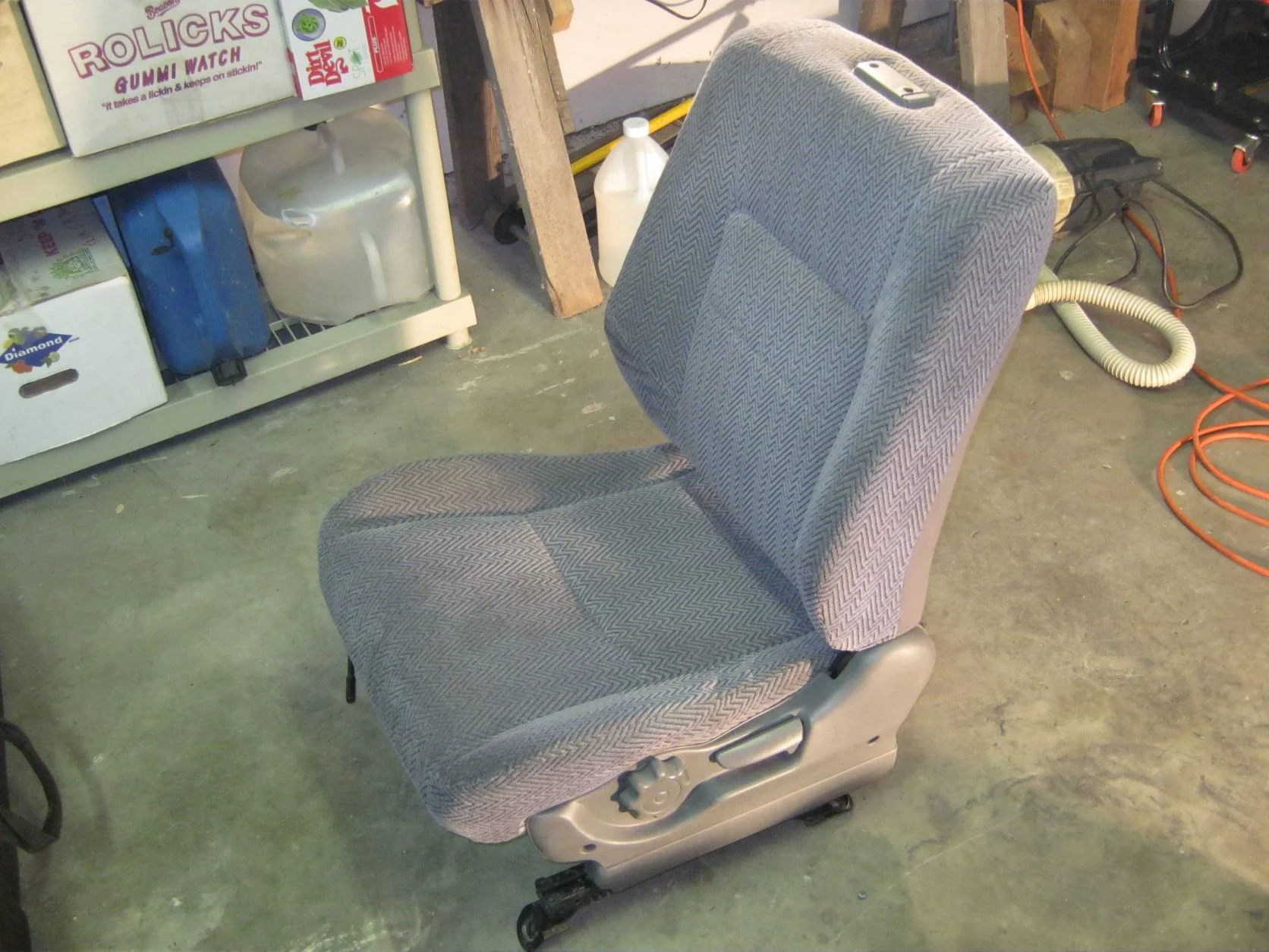

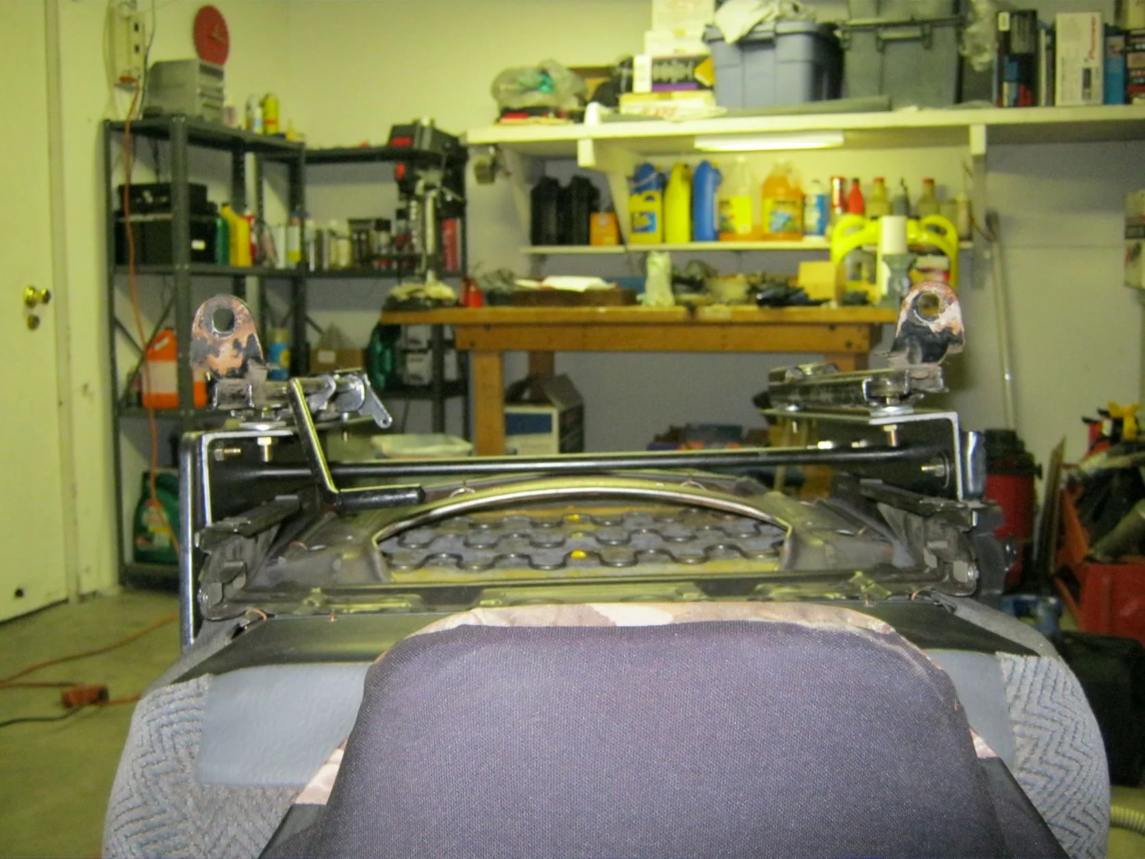

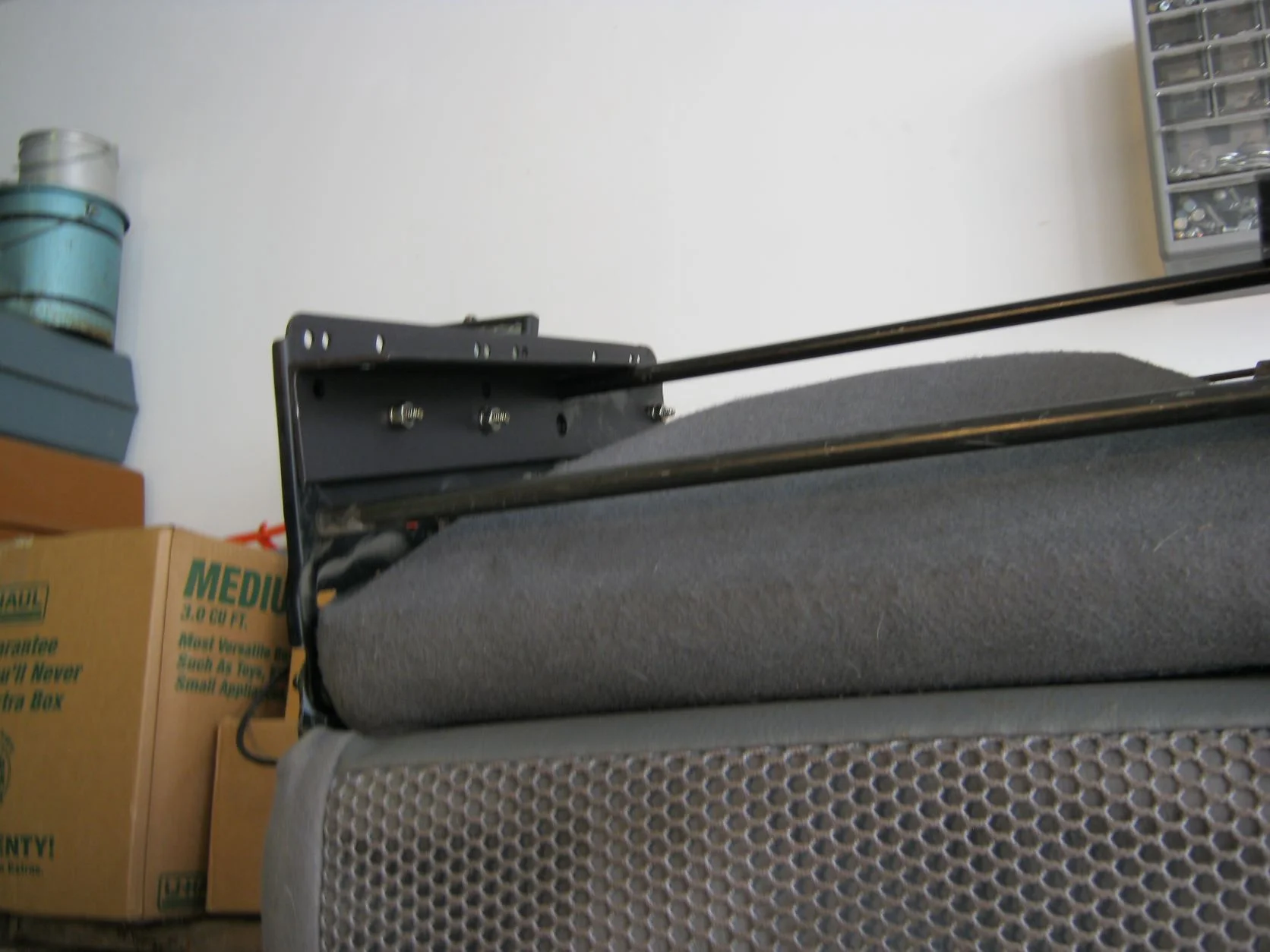

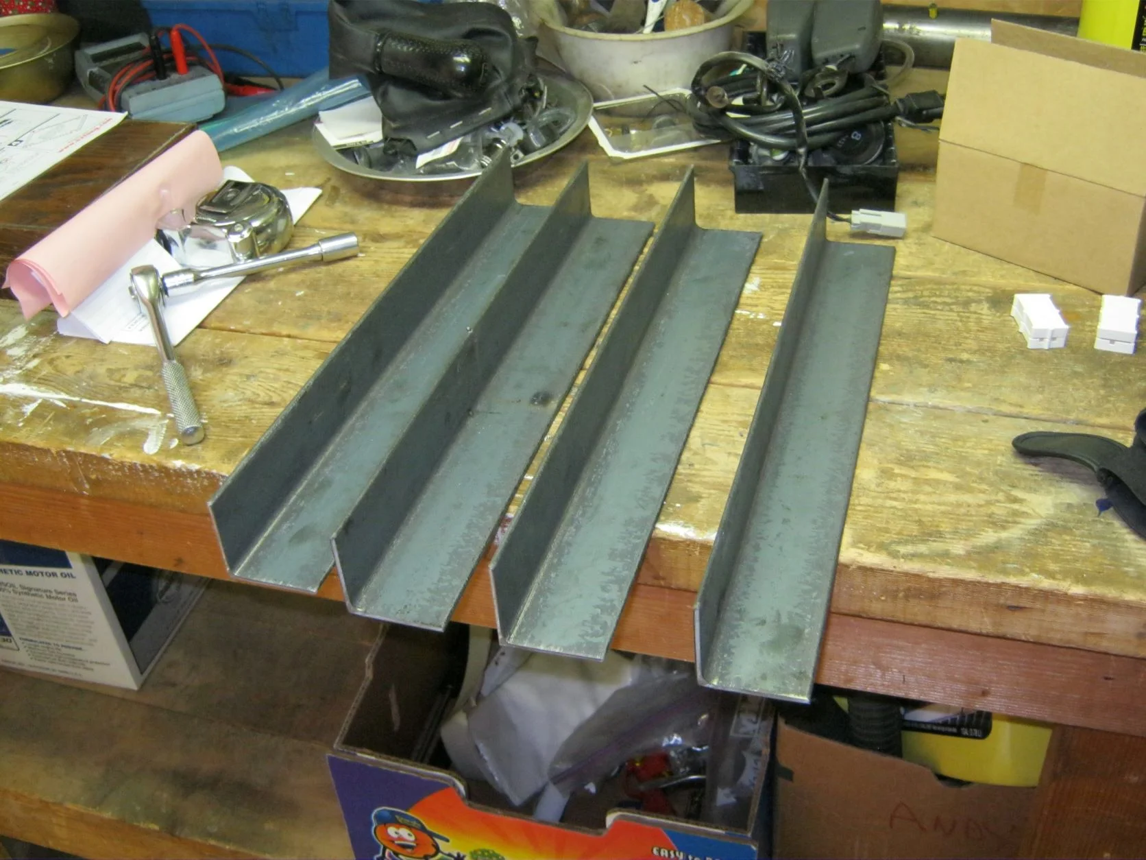

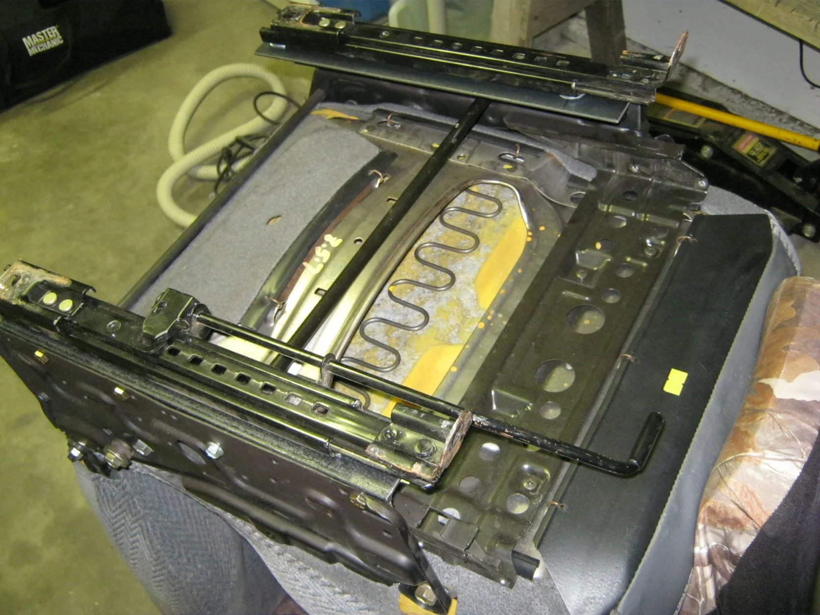

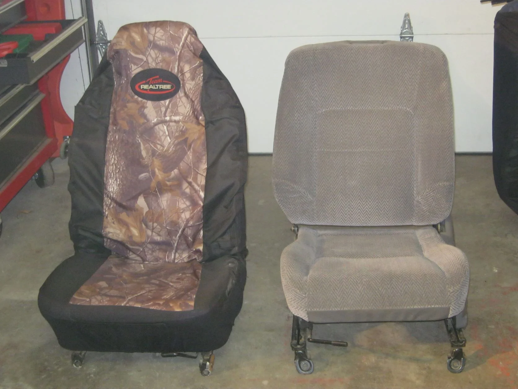

Well, I got some bucket seats out of a '98 Honda CRV at a U-Pull-It last week. Did some quick measuring before so I thought they would come close to just bolting them in. Wrong:rolleyes: - I'm having to modify the bases of the new seats and it's coming along well. I'll post some pix when I get the chance. These seats are well made and solid. They should hold up well. The seats were $50 and $30ish for angle iron and hardware to fab up the mods. The original slide brackets will bolt to the mod I'm doing to the seats. I can't wait to test drive it when they're installed. :bounce:

Here's a comparo pic - old on left new on right:
The angle iron - $7 worth :hillbilly: :

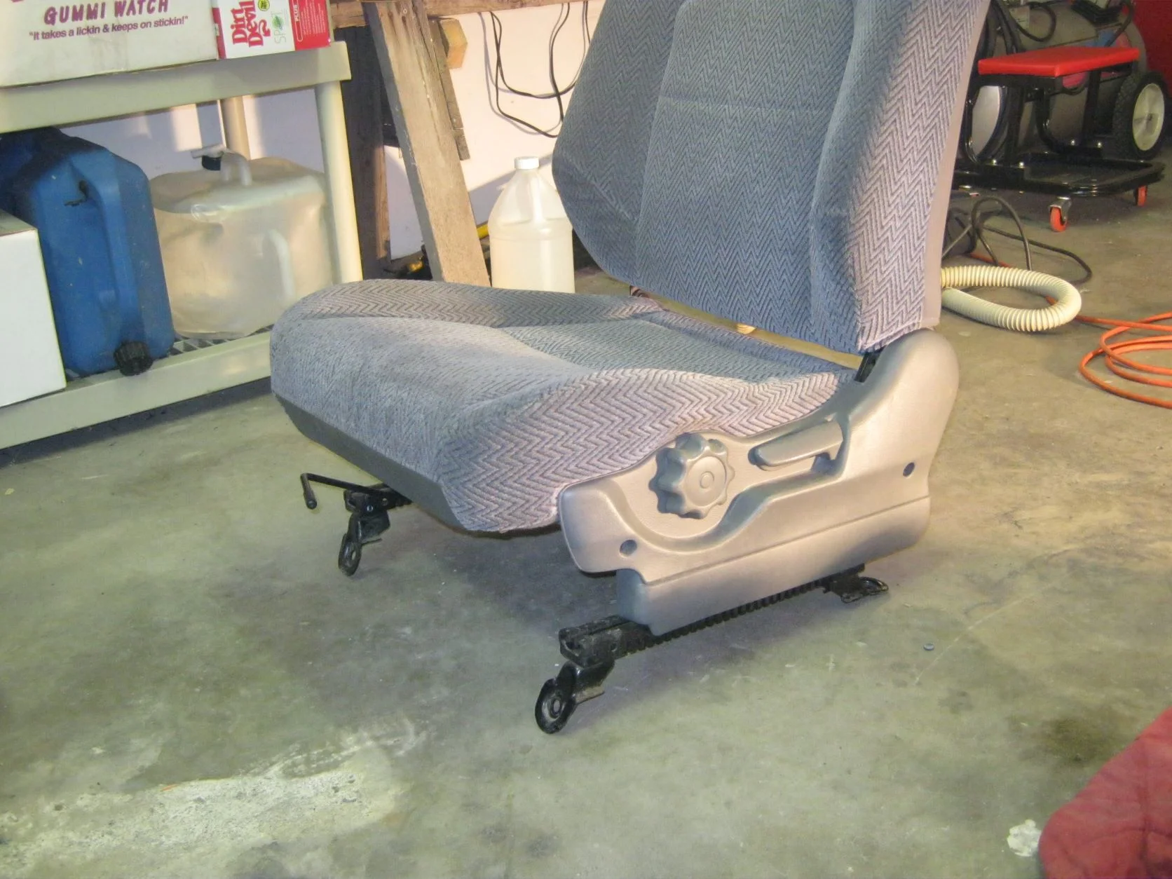

Couple of the new(before mod):
The PS side complete, except for fitment check (in rig) and painting the bare metal angle iron brackets (The new seat is setting upside down on old seat just to hold it off the floor):
I'm pleased at how well and solid these seats seem, compared to the 30+ yr old OEM buckets and anxious to test drive them. Should have this done this weekend. Then I get to start on replacing my radiator in my 80 series :rolleyes: - always something else when it comes to your rigs......

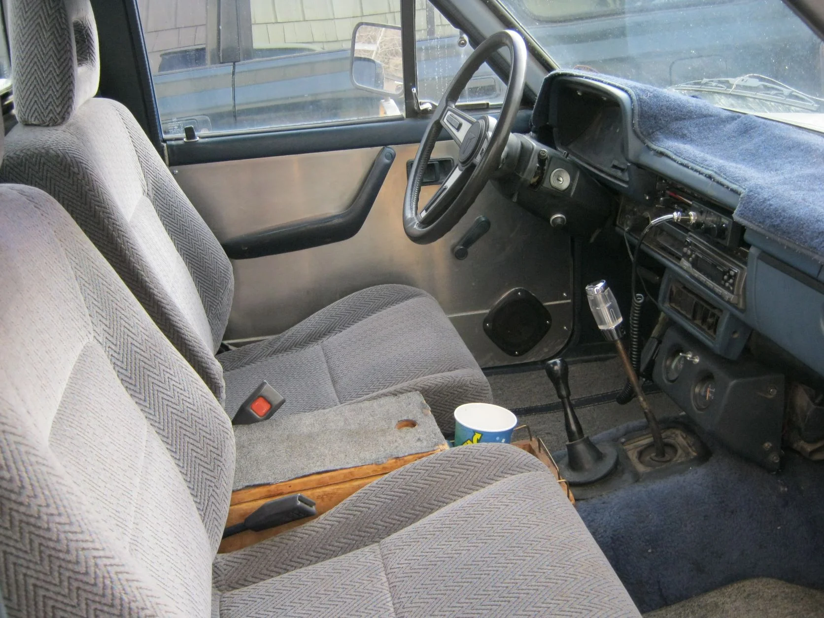

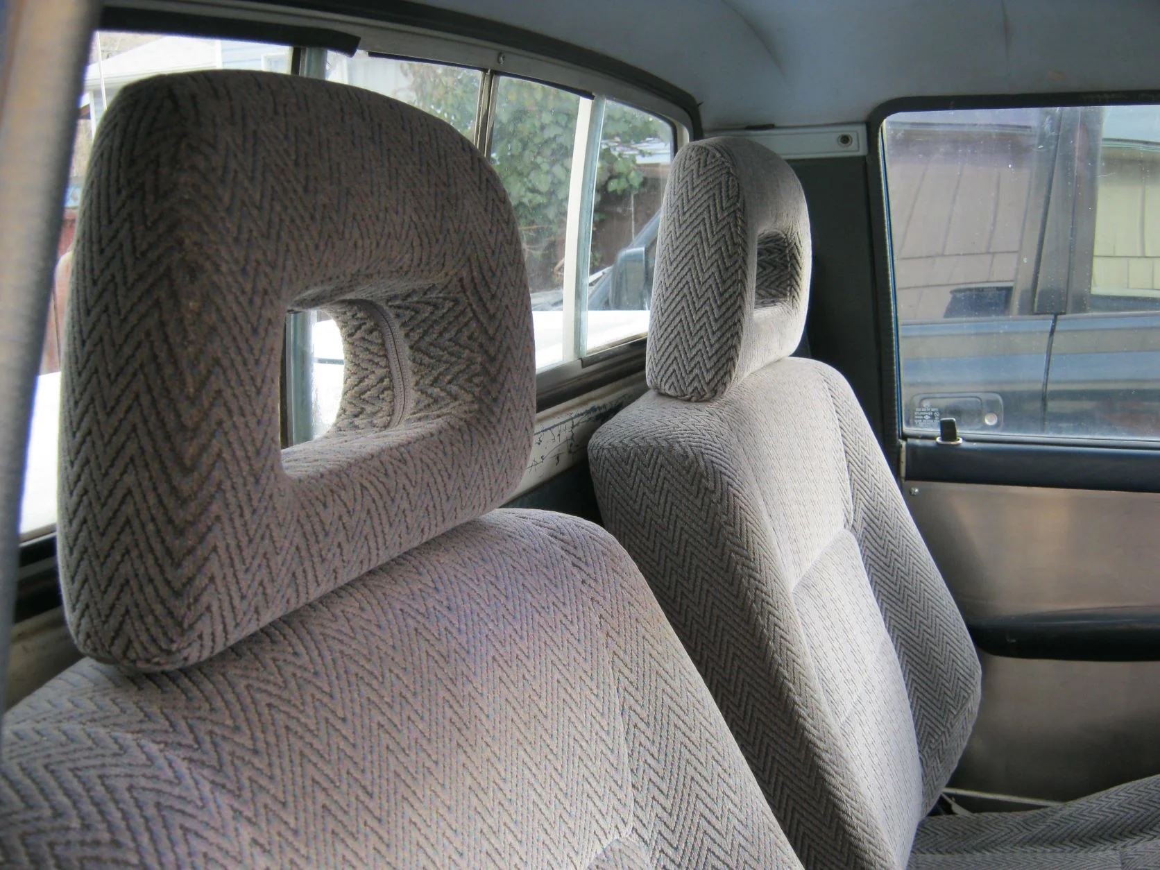

Well the fitment and test drive showed that the mod worked great and the ride was superb. The seats are solid and absorb the bumps much better. But, one glaring problem - I was riding too high. So, I pulled 'em out and studied it for a while and realized I could lose about 7/8ths of an inch in height. Re-drilled holes and dropped it as far as the cross bars allowed:
Put the OEM slides (seat brackets) back on, installed seats and could not believe the difference 7/8" made.
For me, they're just right. These seats look great, and the backs fold forward for stowing stuff behind them. Glad I took the chance.....Anybody wanna buy some old worn out Toyota Racing Buckets? :lol: 'cause I'm pitchin' 'em!
Thanks, Chad! The cushions on these seats are so much thicker than the OEM buckets, tall people will be cramped because there's just not enough space to accommodate both comfort and room - at least by my standards :rolleyes:. I've come to the conclusion that the truck will wear out before these seat cushions do :hillbilly:.
