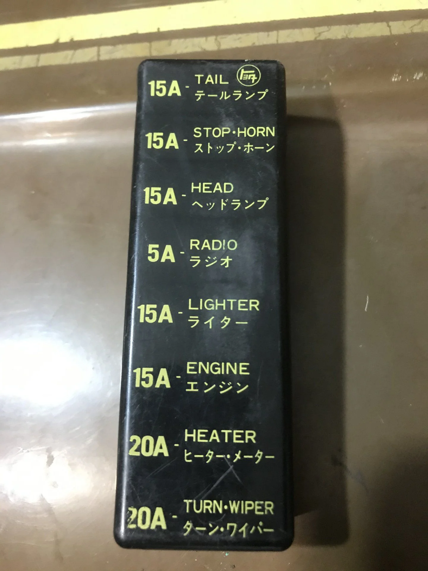

Here is a pic of the box cover from my ‘80. My ‘82 has the same cover.View attachment 2501429
Thanks @Otis That’s what my (limited) trial and error had shown from the few I’d removed and then checked to see if it did in fact disable what I thought it would. But the order they had them listed in the manual confused me.
