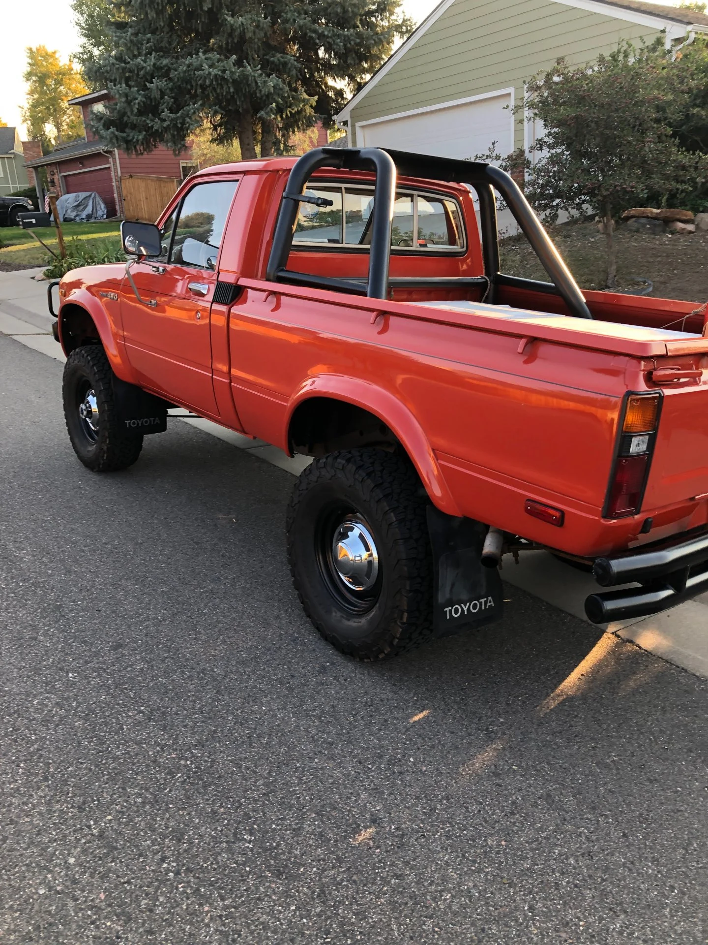

Well it’s been almost a year to the day since I bought this and I’ve procrastinated long enough. I have been wanting another project and have done too much to this truck not to write a thread. Hopefully I can help someone else going down this rabbit hole.

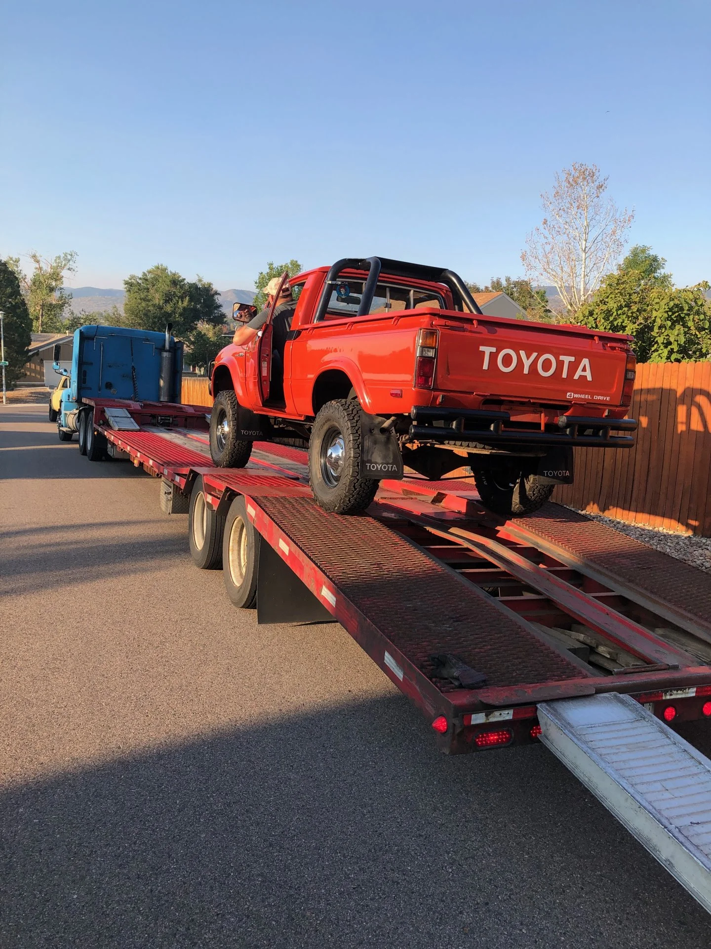

I found this little pickup from another mud member. It’s been well taken care of and spent most of its life in LA. The body and frame are in impeccable condition with no cancer anywhere.

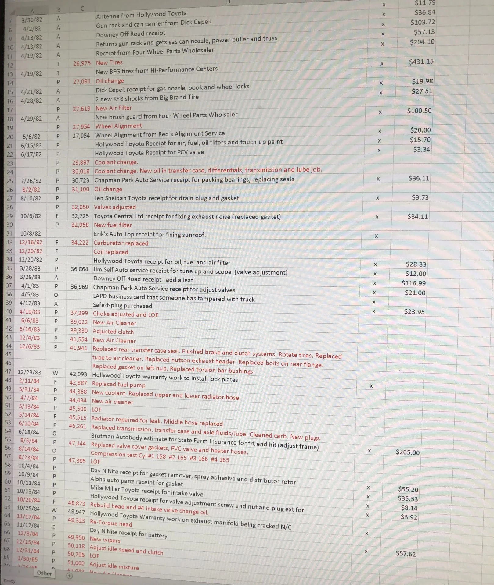

The maintenance records have been kept on an Excel sheet dating back to January 1980, in which I have continued from here on out.
Since the body and the frame are in such nice condition, my plans were to make it run and drive like a new truck but keep it as original looking as possible. No rock crawler here.

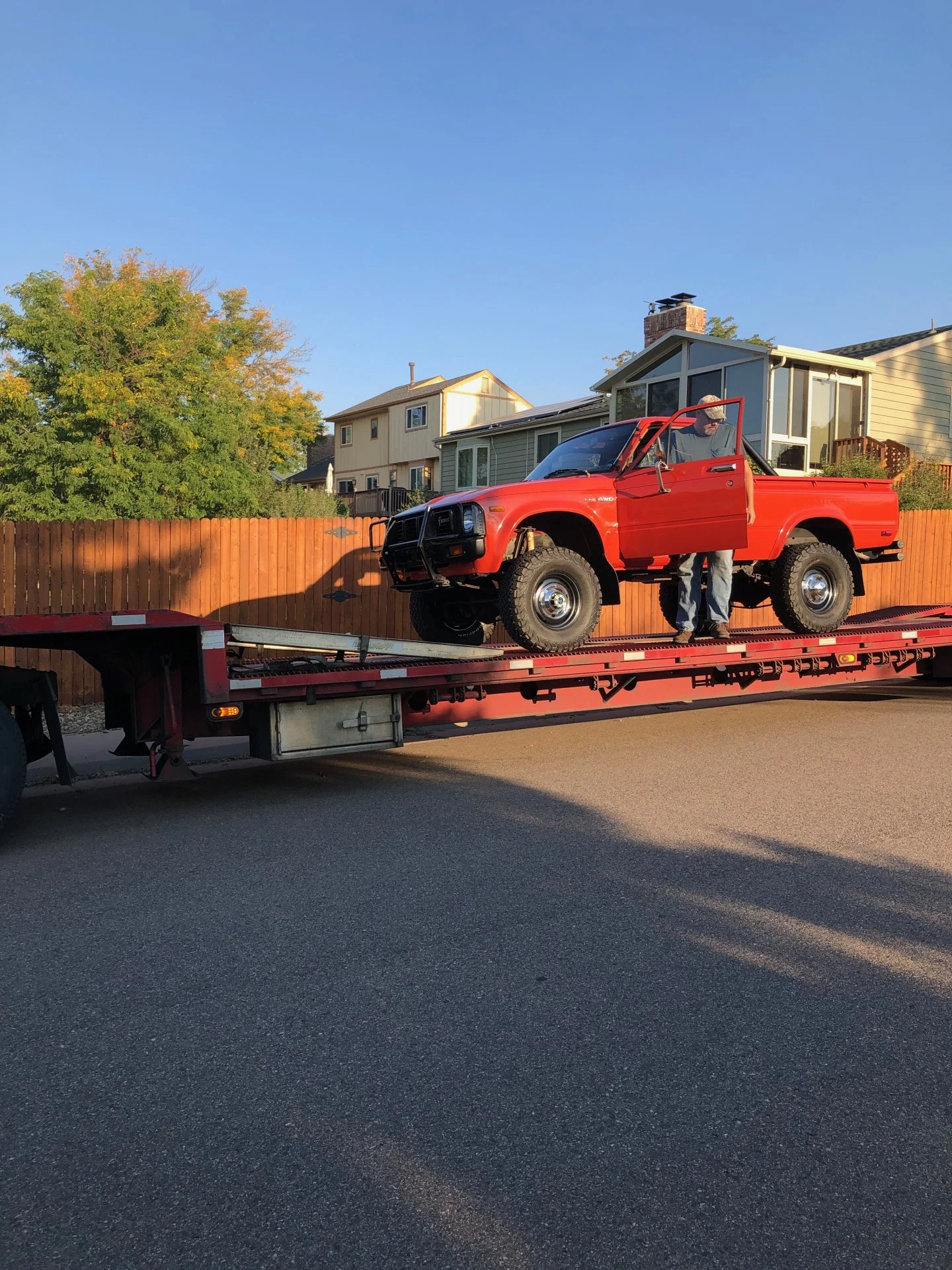

Here are some pictures of it being loaded onto the trailer prior to arrival.
Wow very cool truck. I love the period correct brush guard, the steelies and hubcaps. How's the interior and engine look? BTW here's my 1980 4x4...

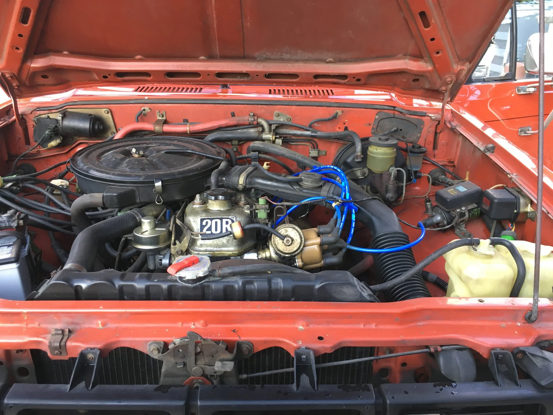

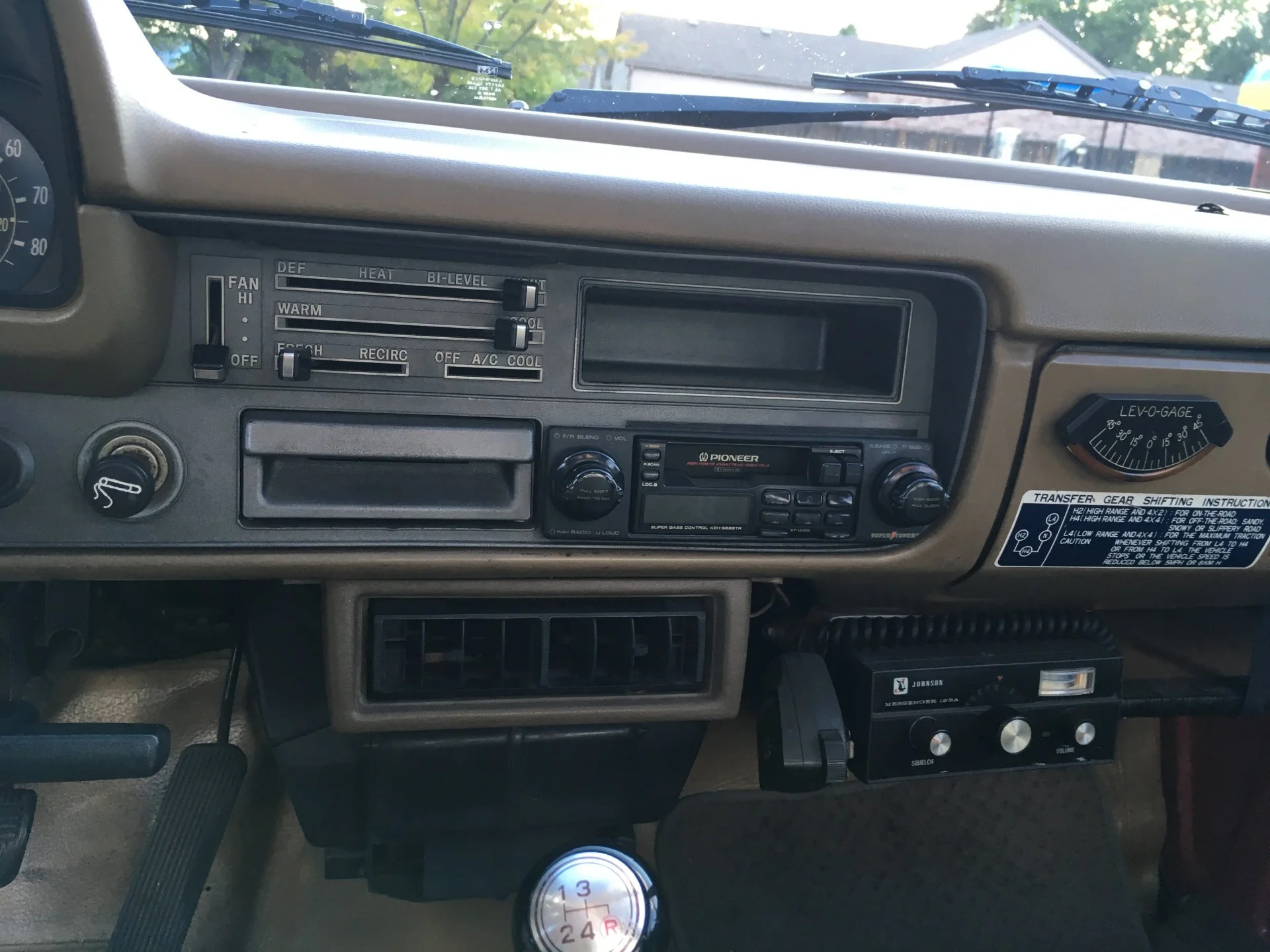

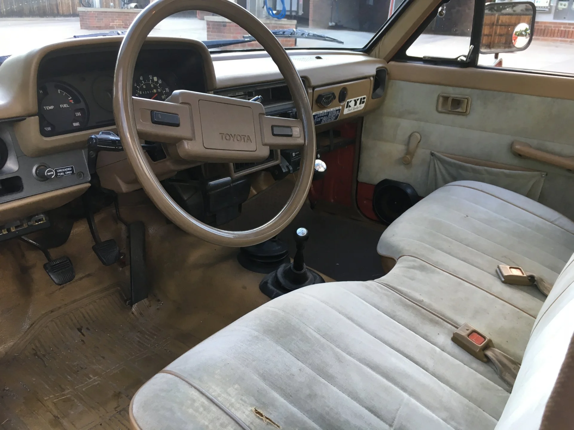

Here are some more pics of what the interior and engine bay looked like when I took ownership.
The interior definitely needed some love and unfortunately the dash had been cut.
Here is a picture of how the maintenance records have been kept. Down to every oil change, light bulb and air filter. I wish more people did this with their rigs.

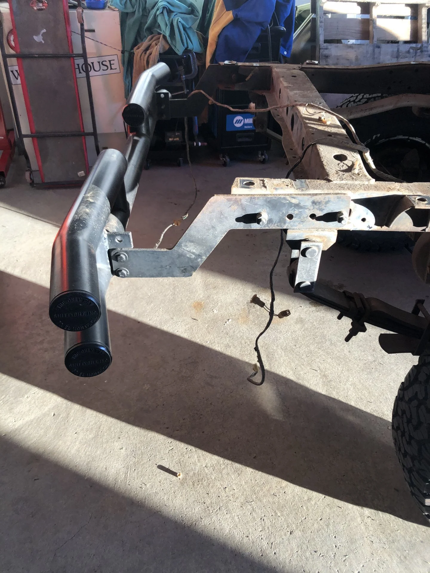

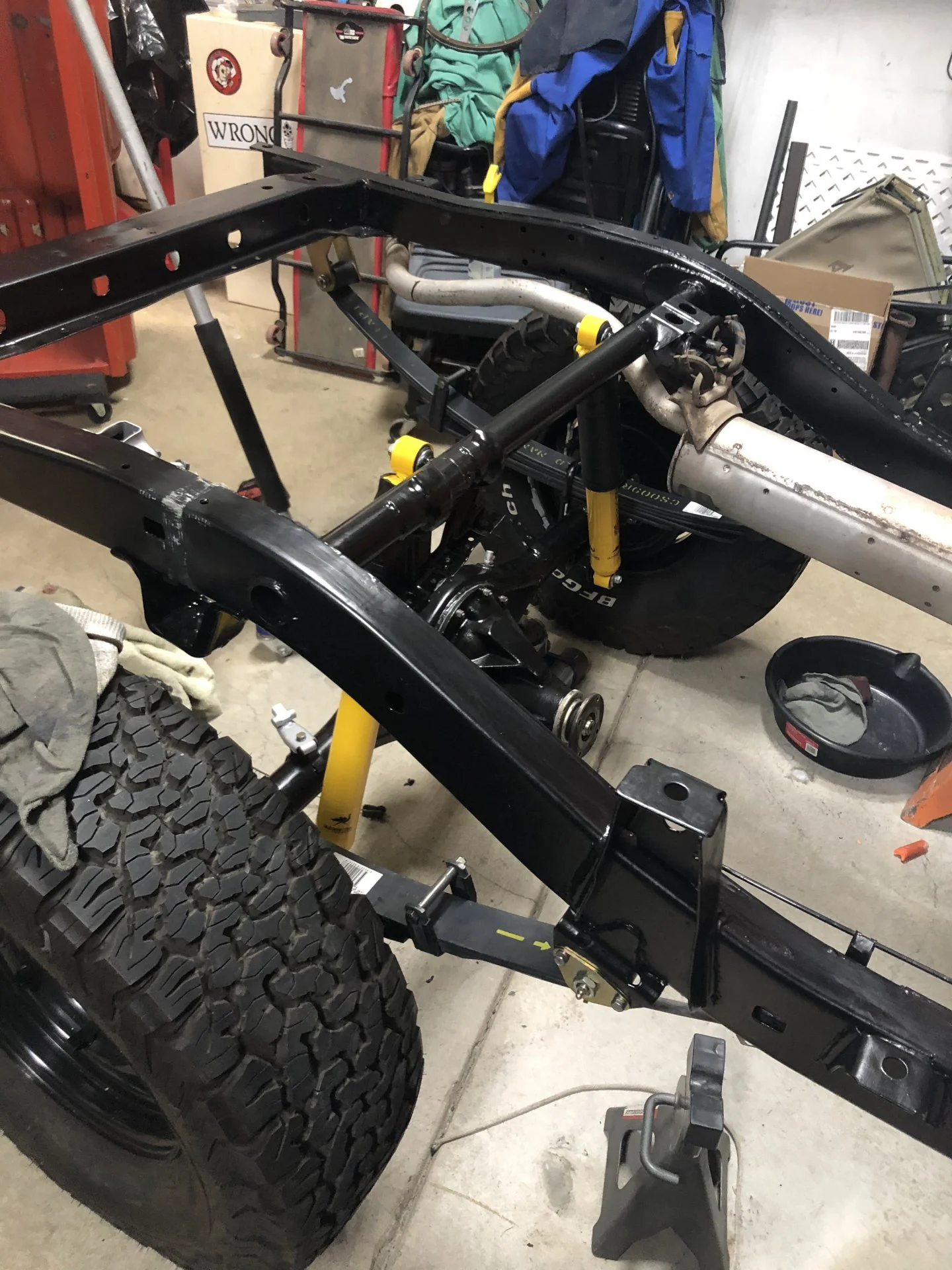

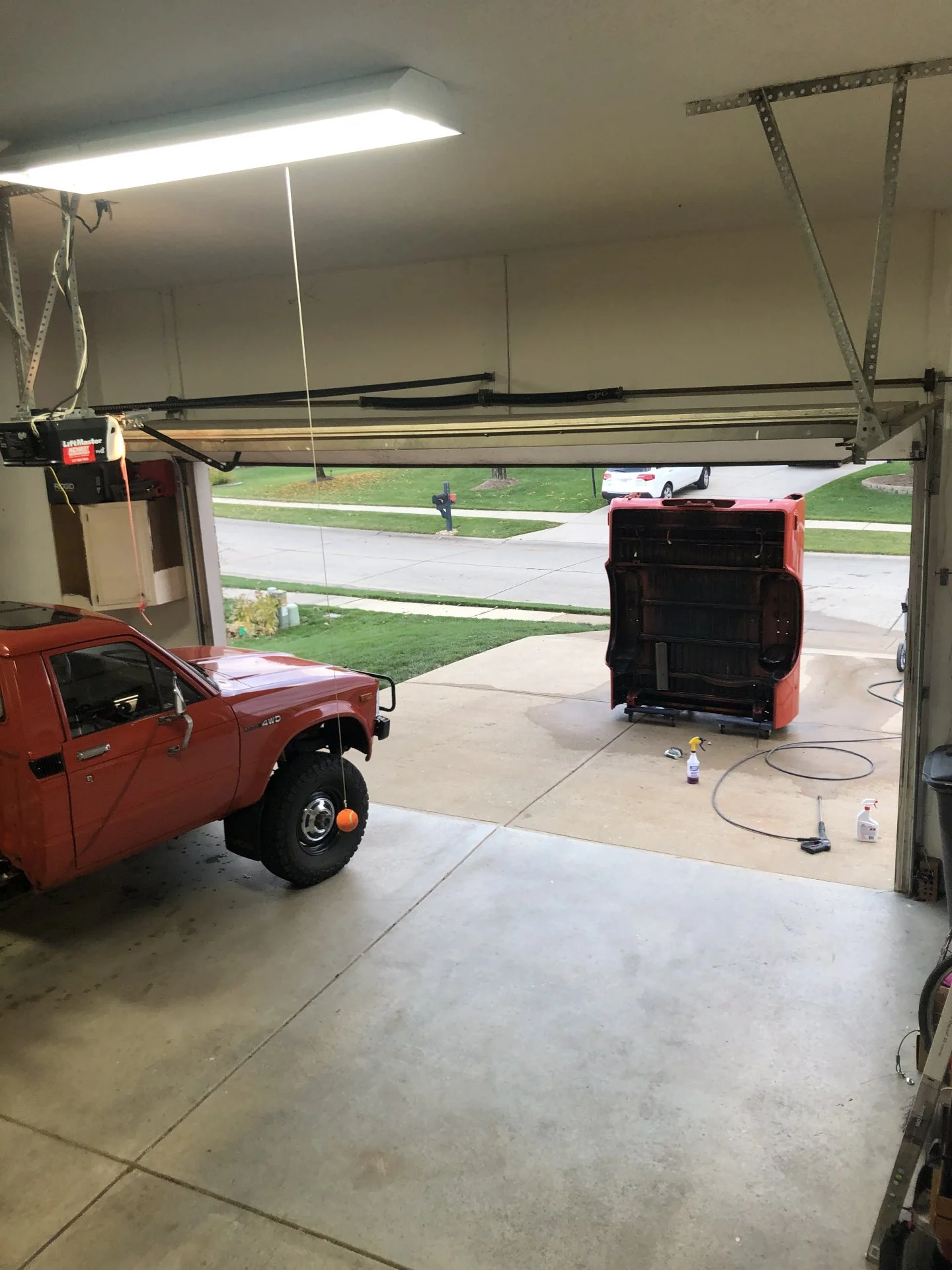

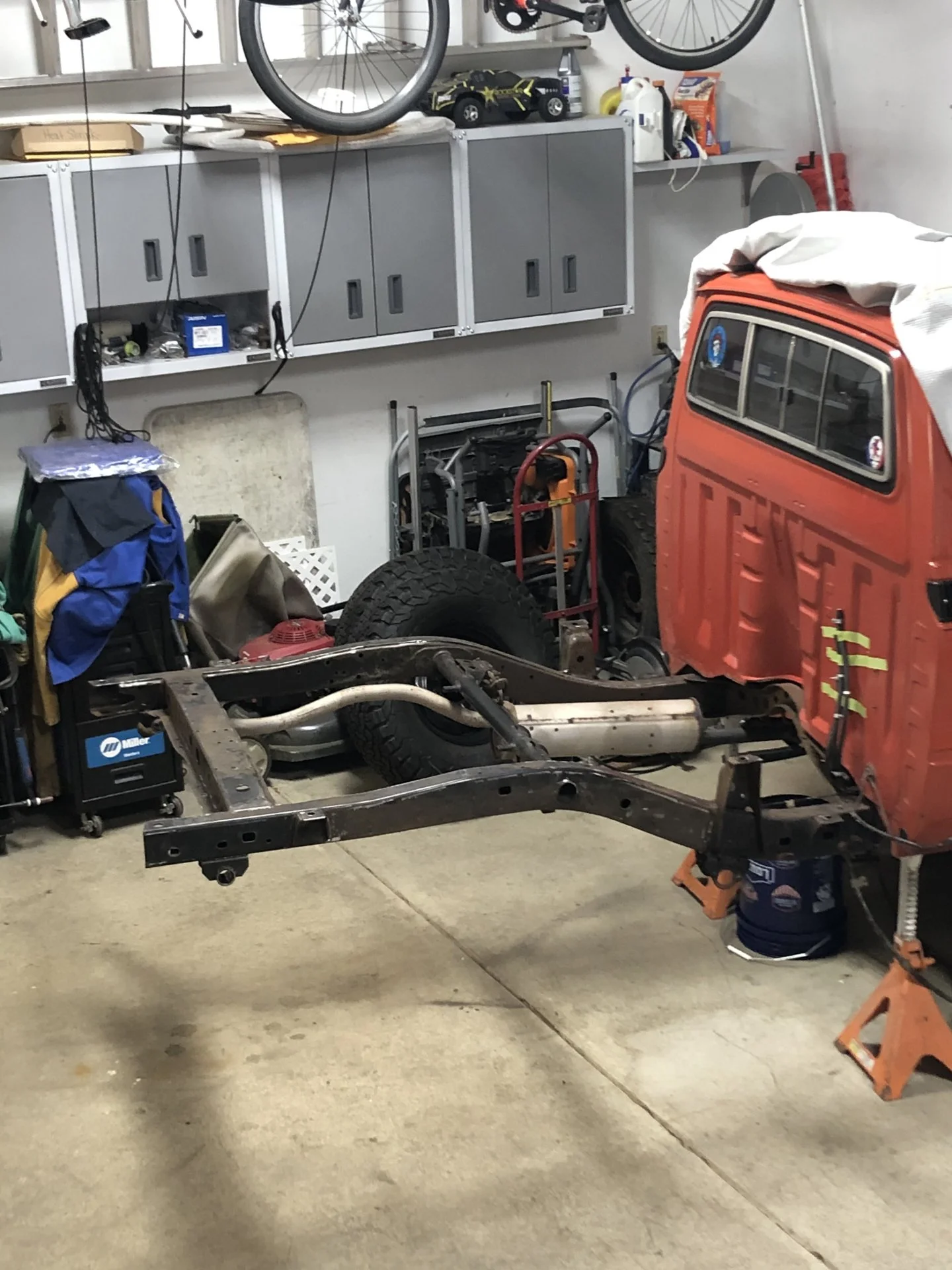

First, off with the bed and rear bumper.

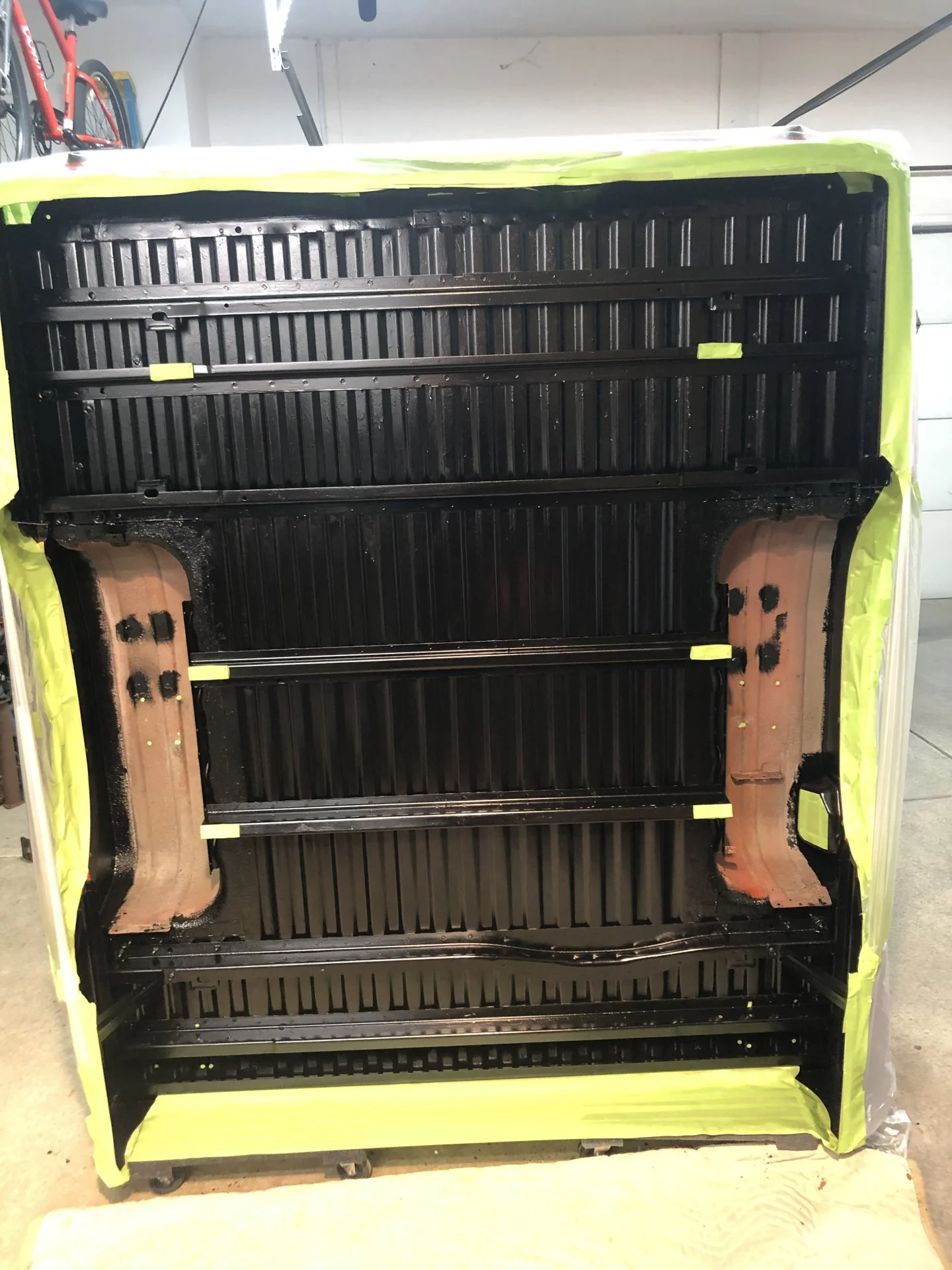

Then pressure washed the frame and underneath the bed.
For some reason I started at the rear and worked my forward.

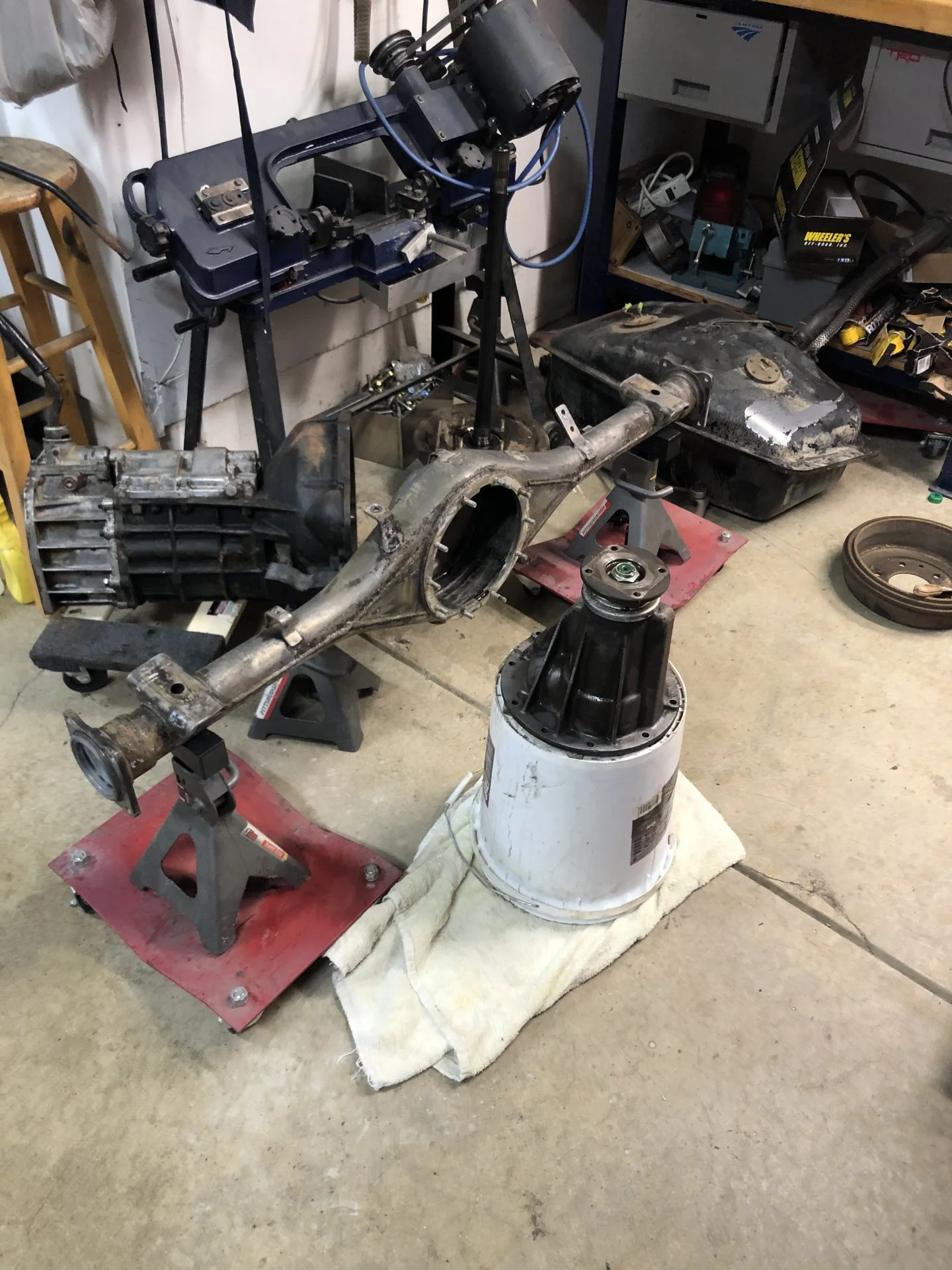

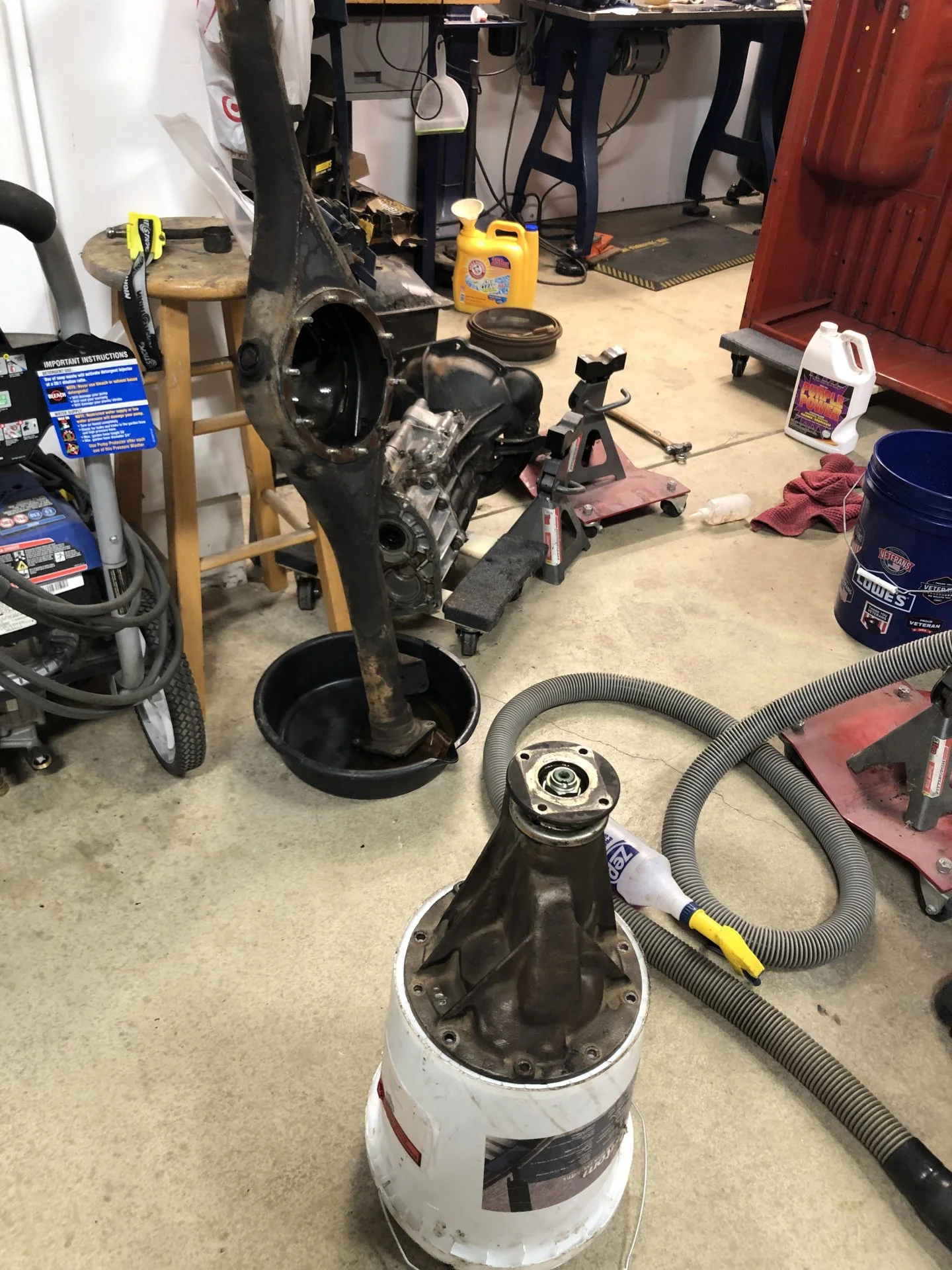

Removed the rear axle and fuel tank.

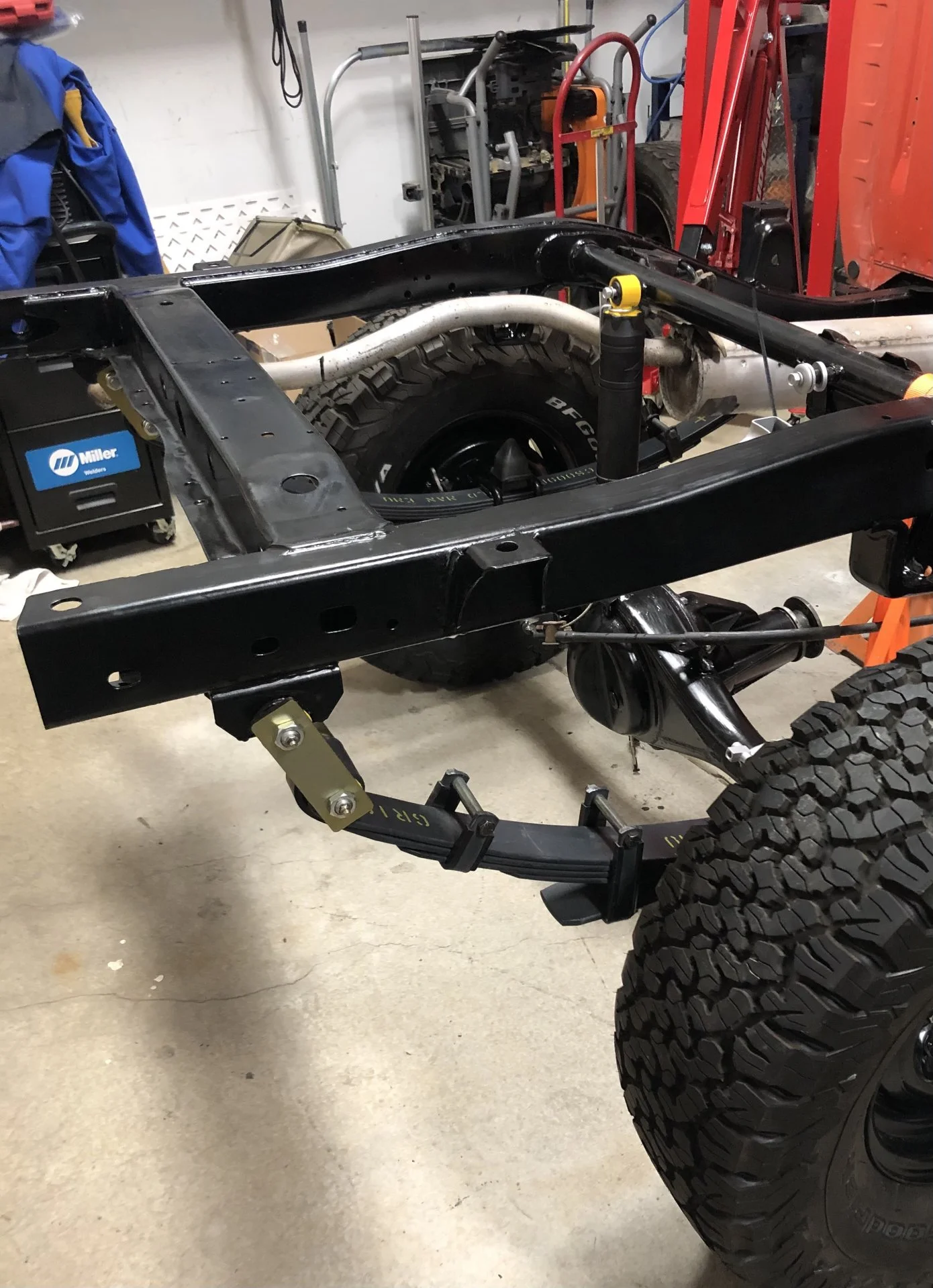

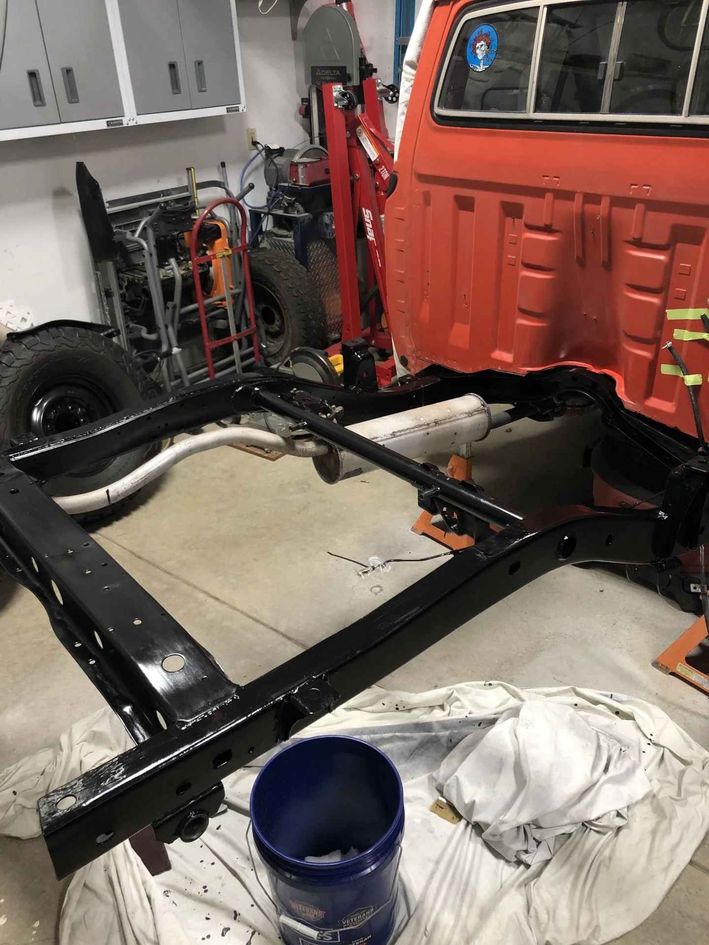

Even though the frame was in near perfect condition I needed to remove the 40 year old surface rust.

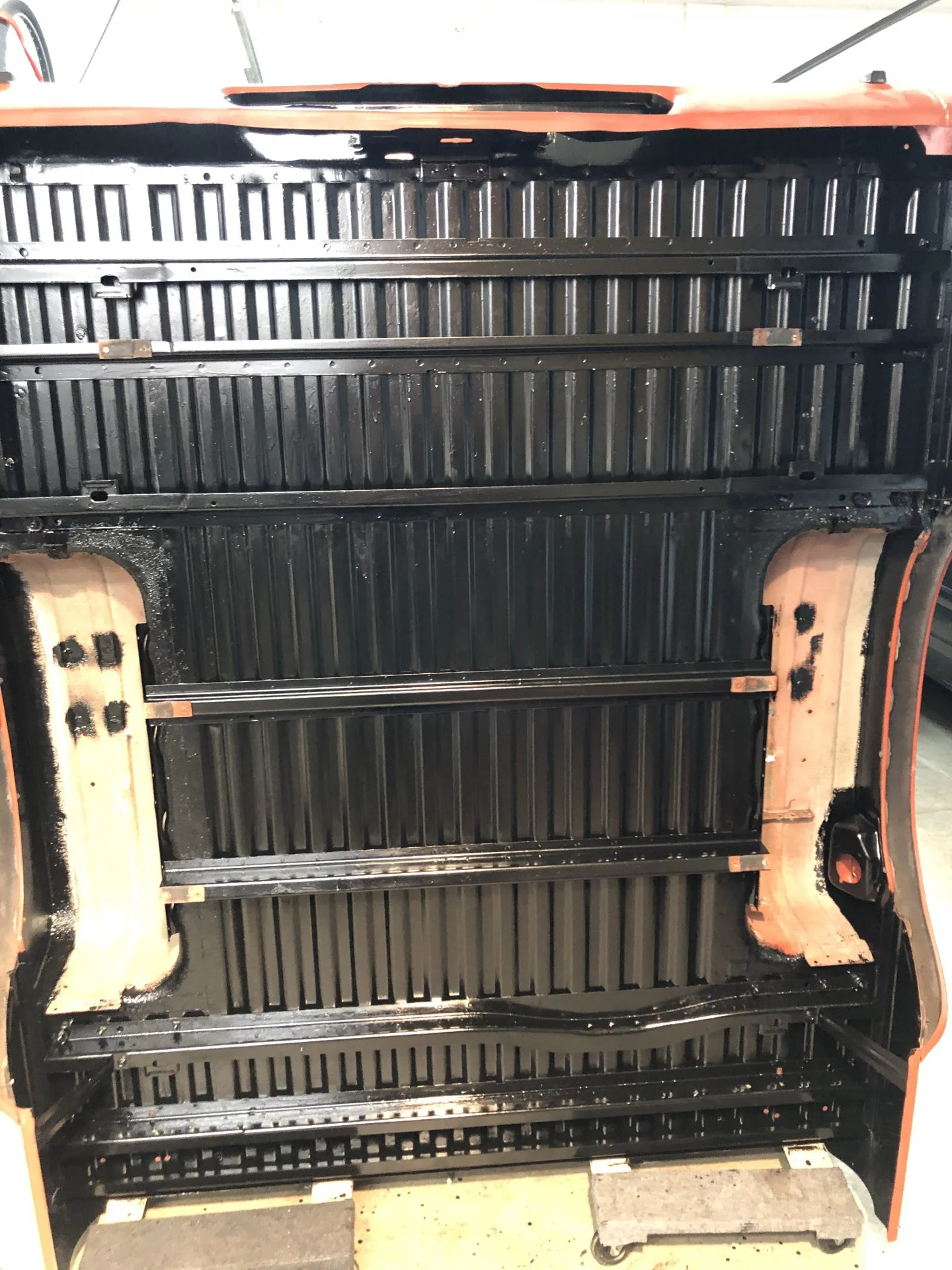

I decided to use the KBS coating rust prevention paint system.
At this point, everything from the cab back was treated with KBS rust blaster, KBS Rust preventer paint and then top coated with KBS chassis black.

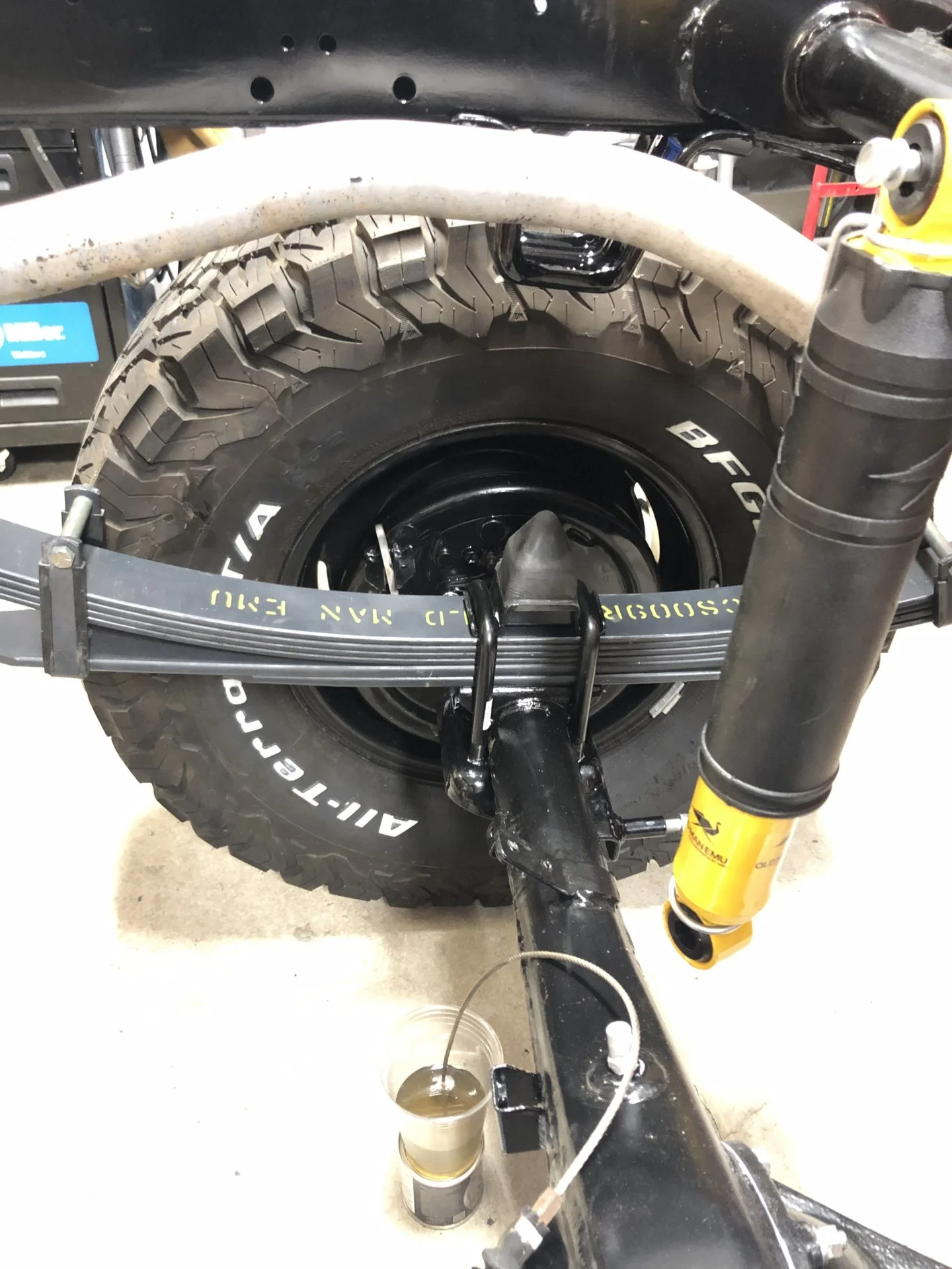

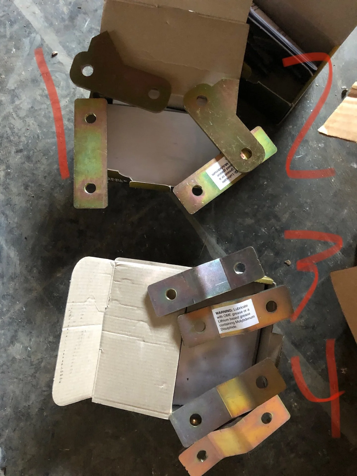

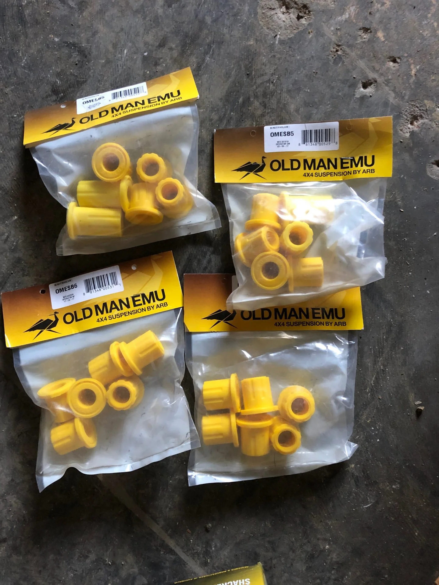

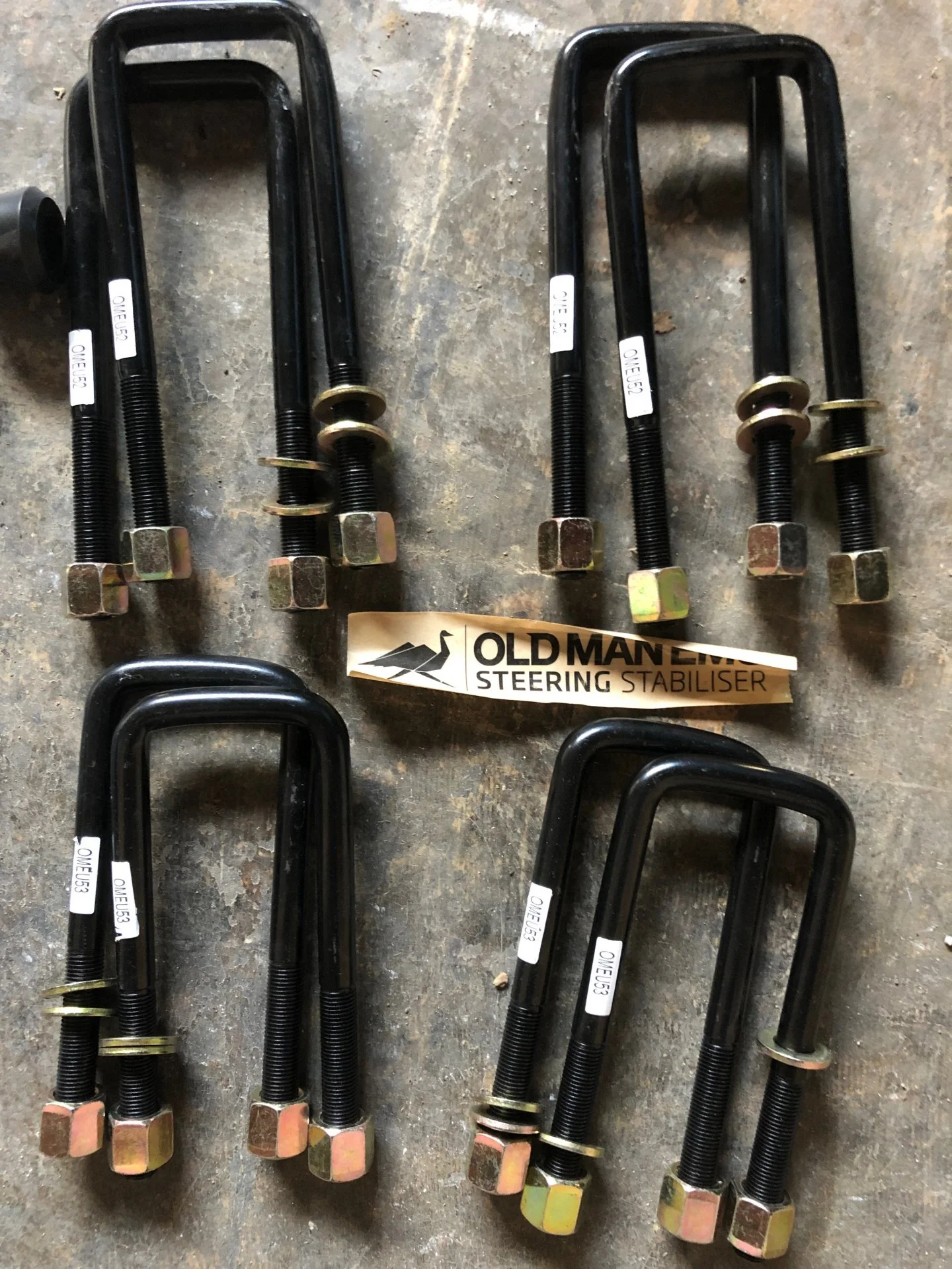

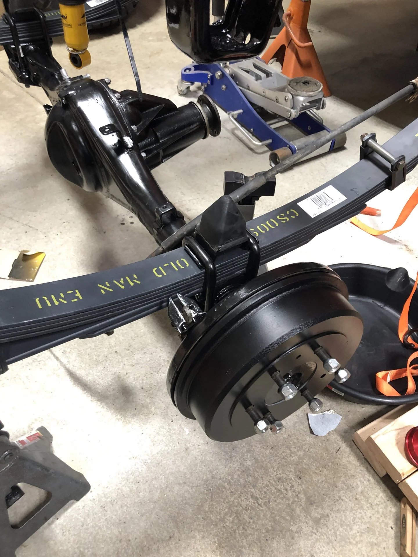

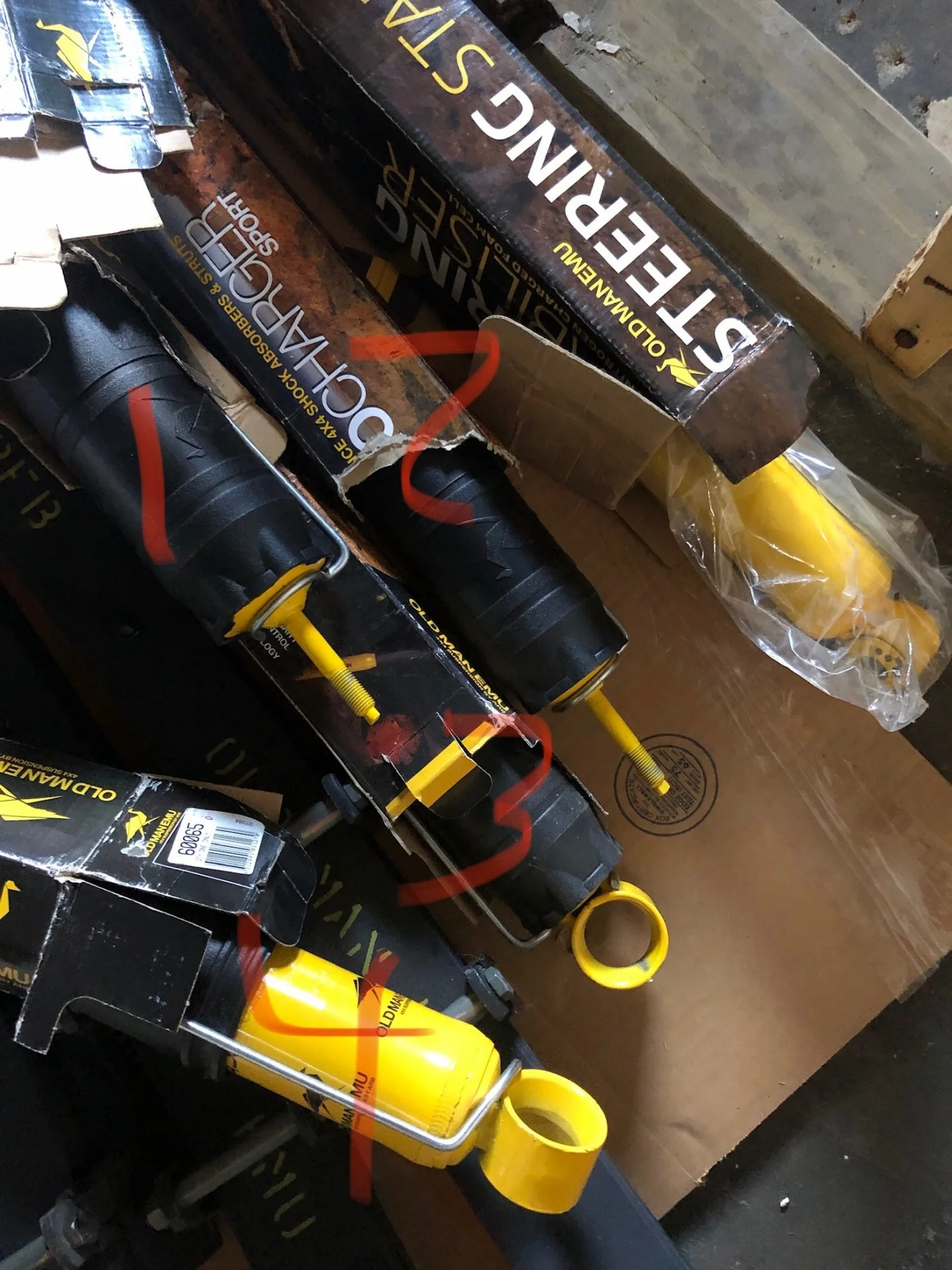

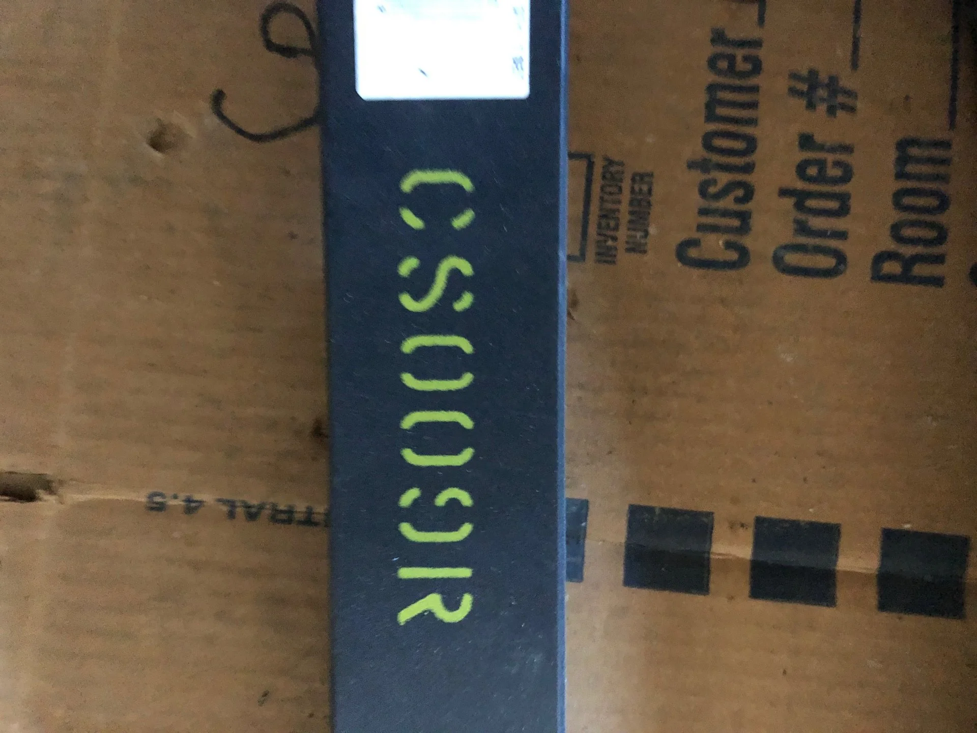

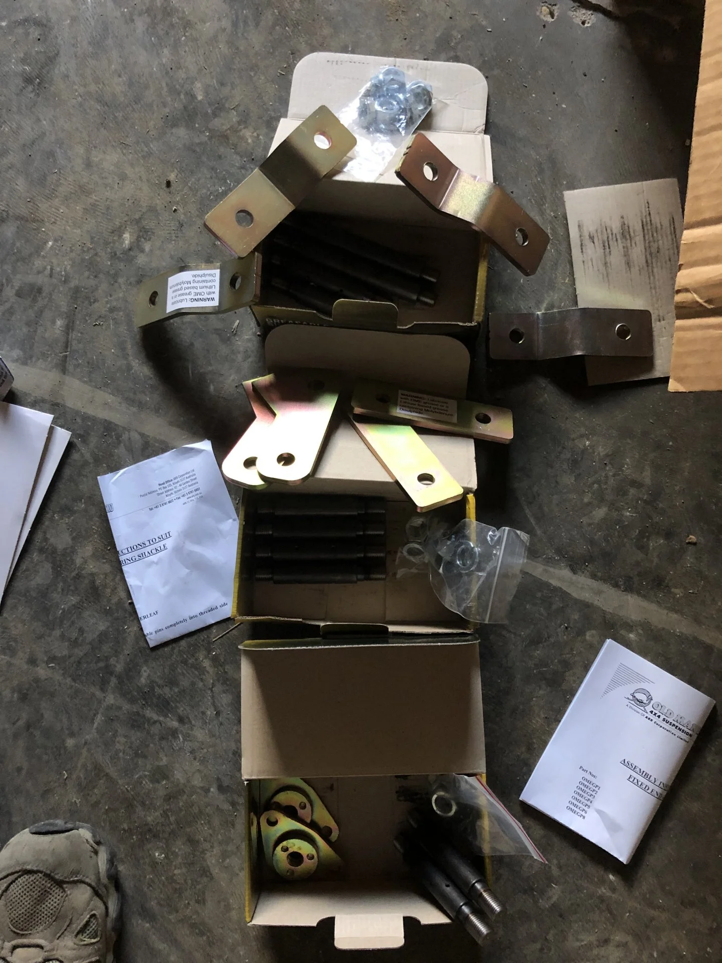

New Old man EMU suspension arrived.

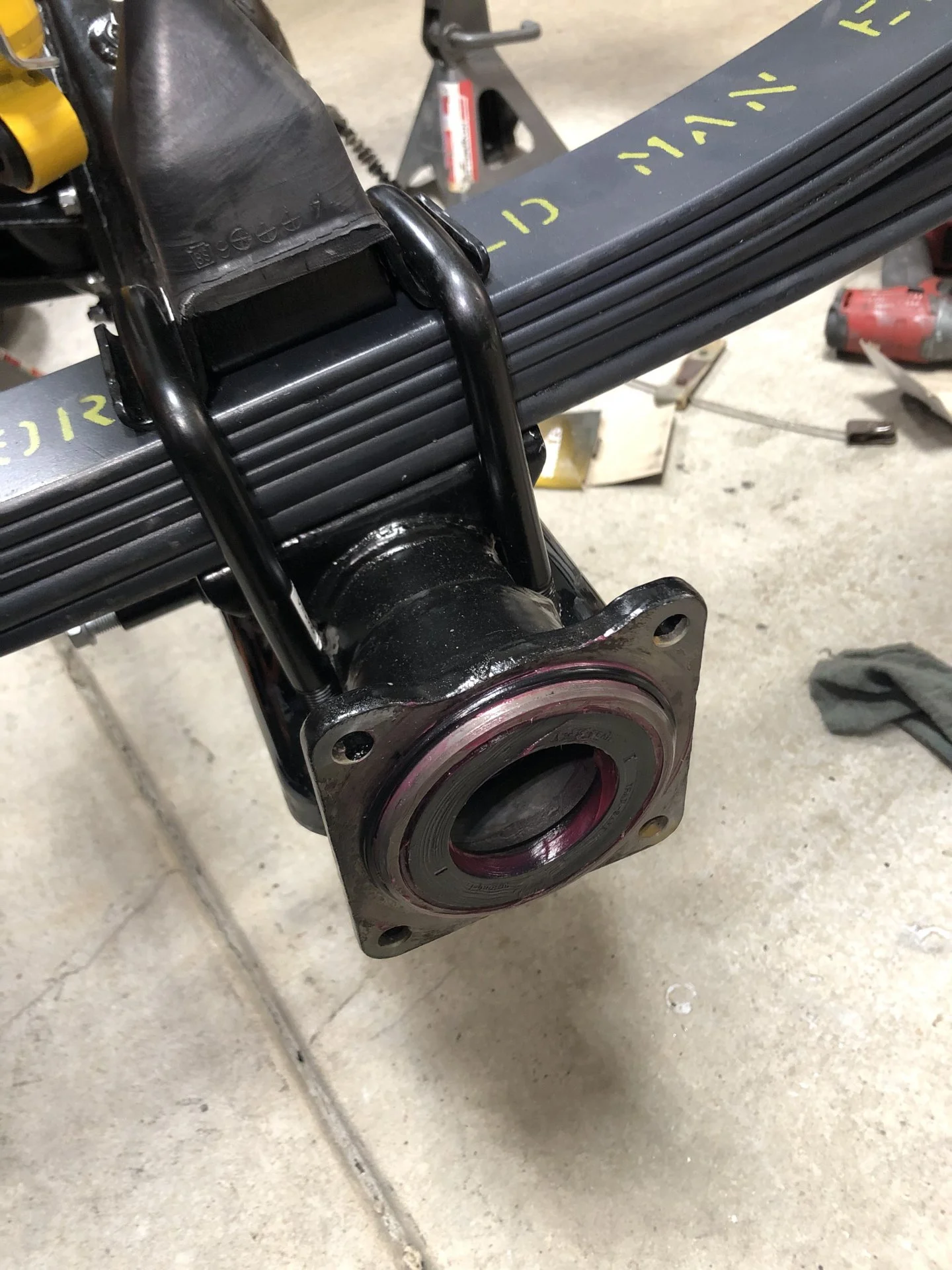

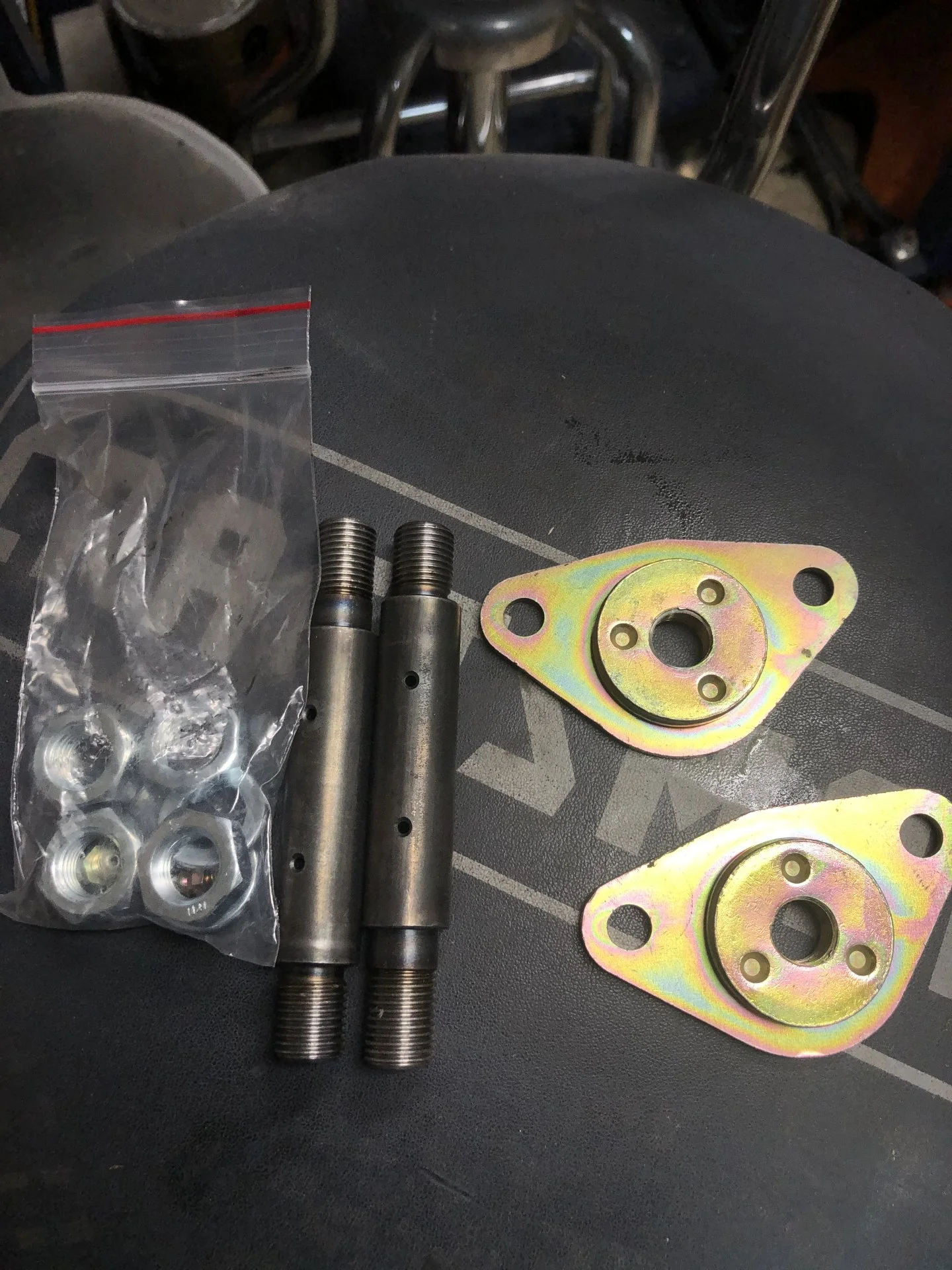

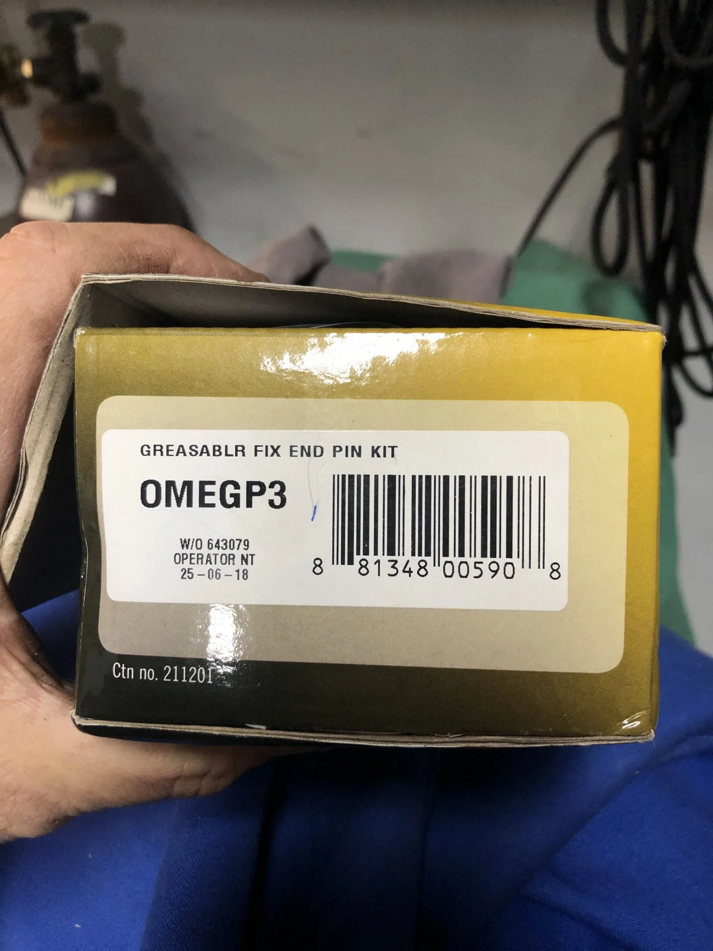

I had order an extra set of these greasable pins. For some reason the kit only came with one set.

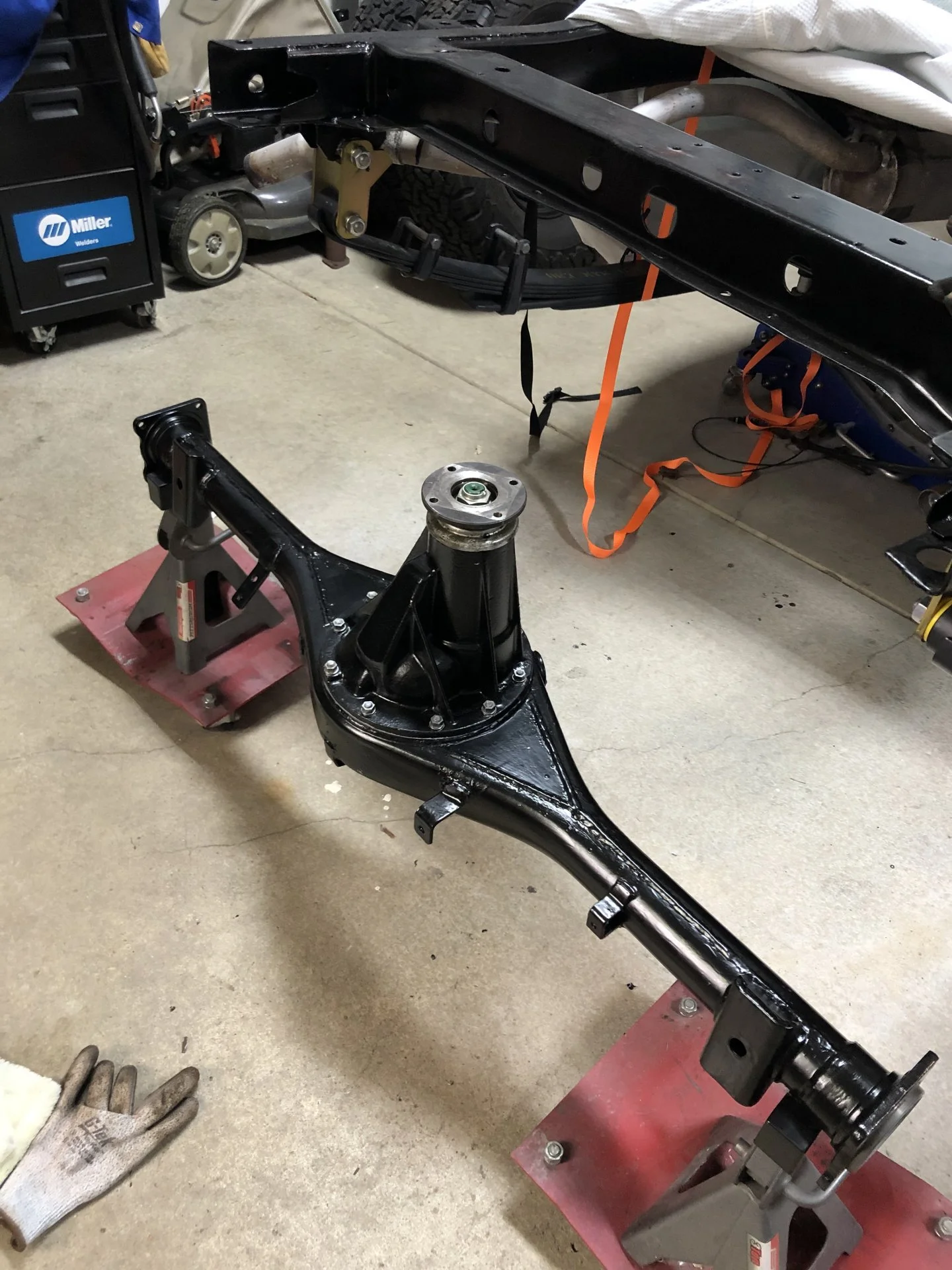

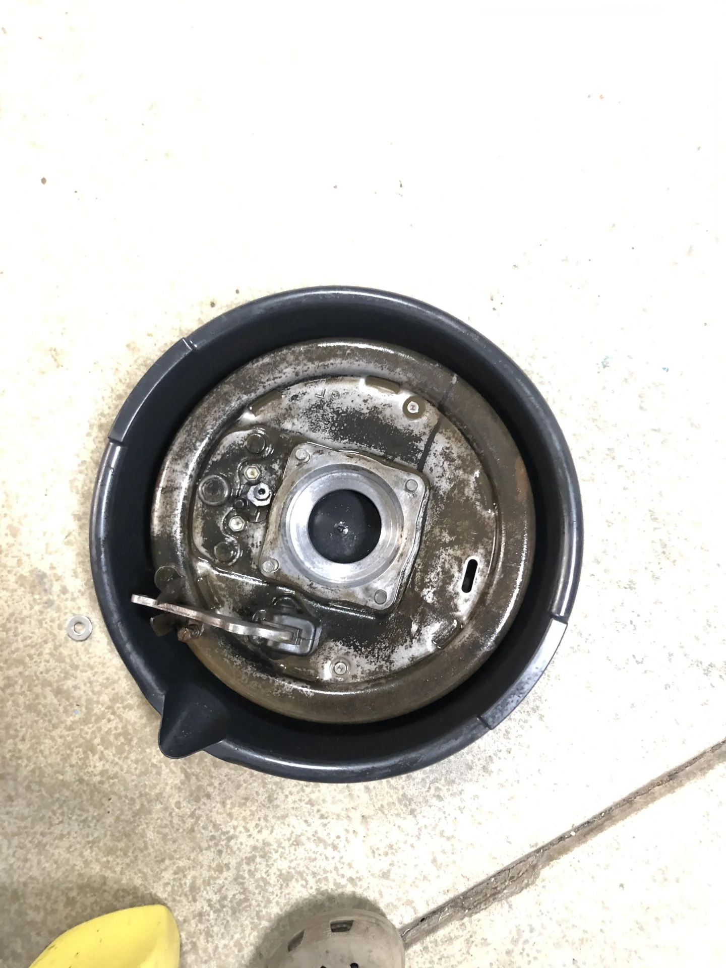

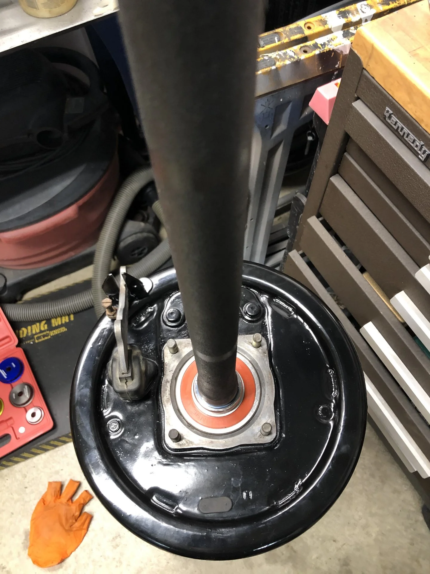

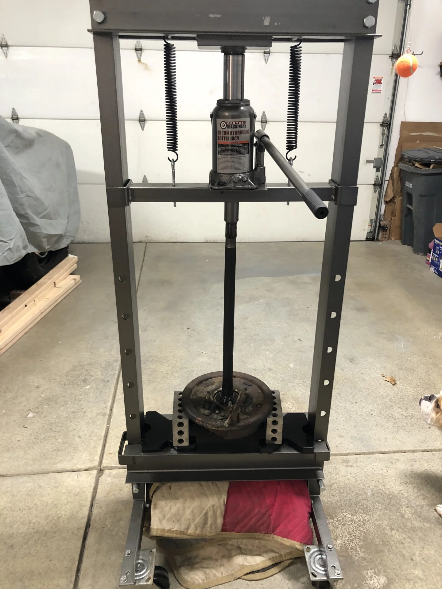

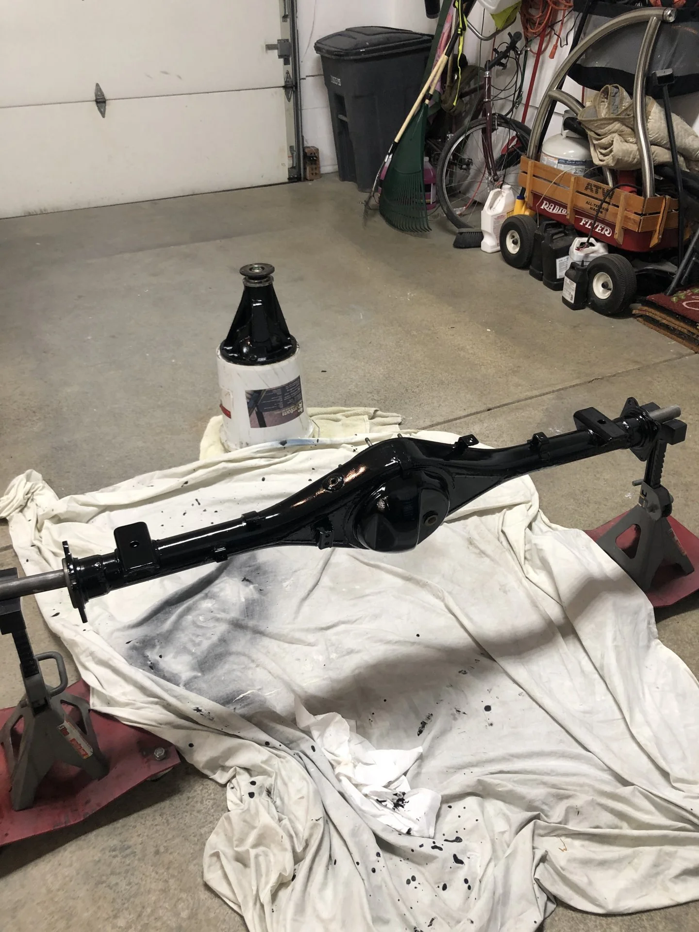

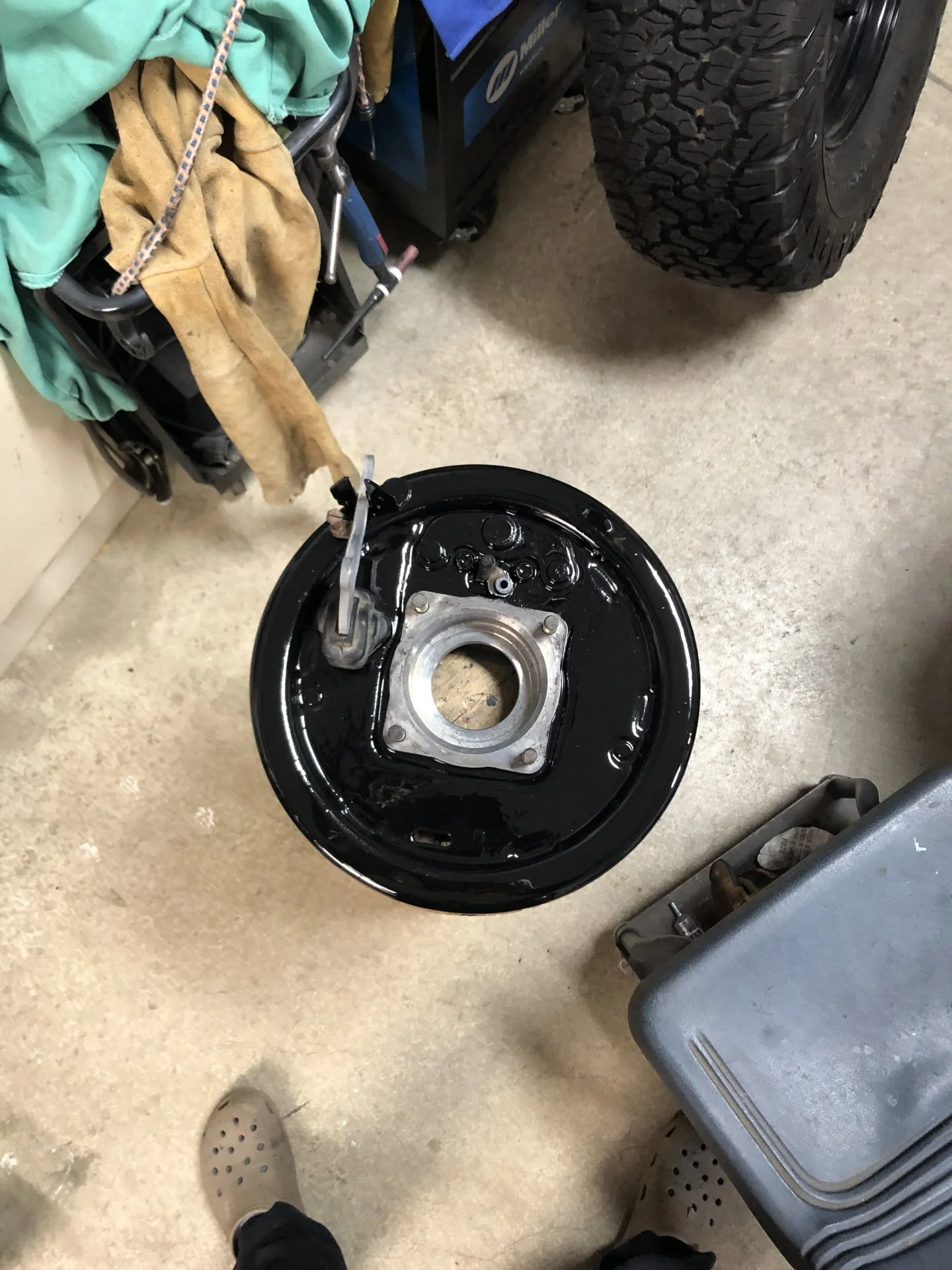

All rear axle seals and bearings where replaced. And backing plates painted with the KBS system. Some day I will switch over to rear brake disc.
Wow. I mean dang. Love it. Can you expand on the KBS treatment? Never heard of it before.

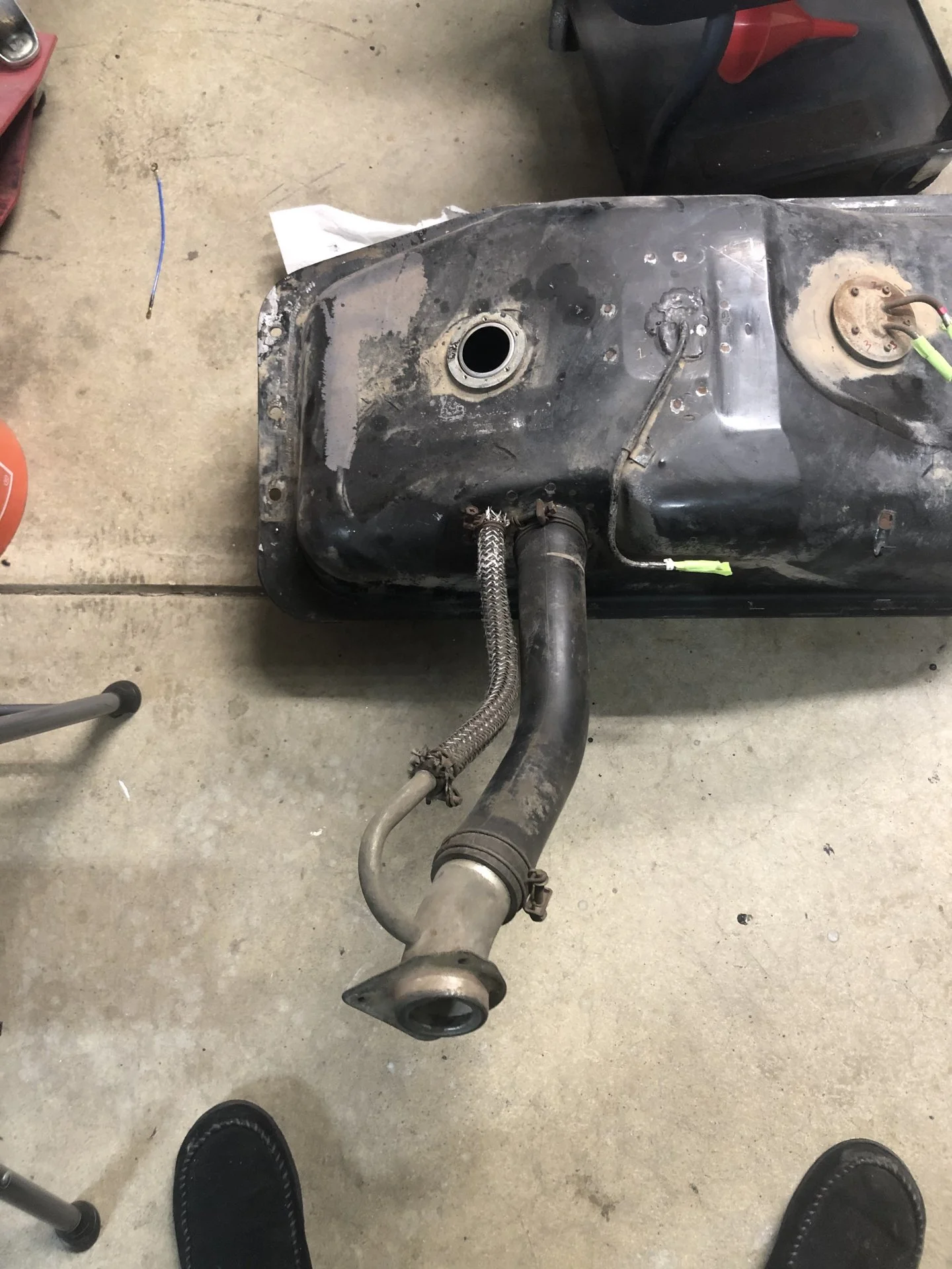

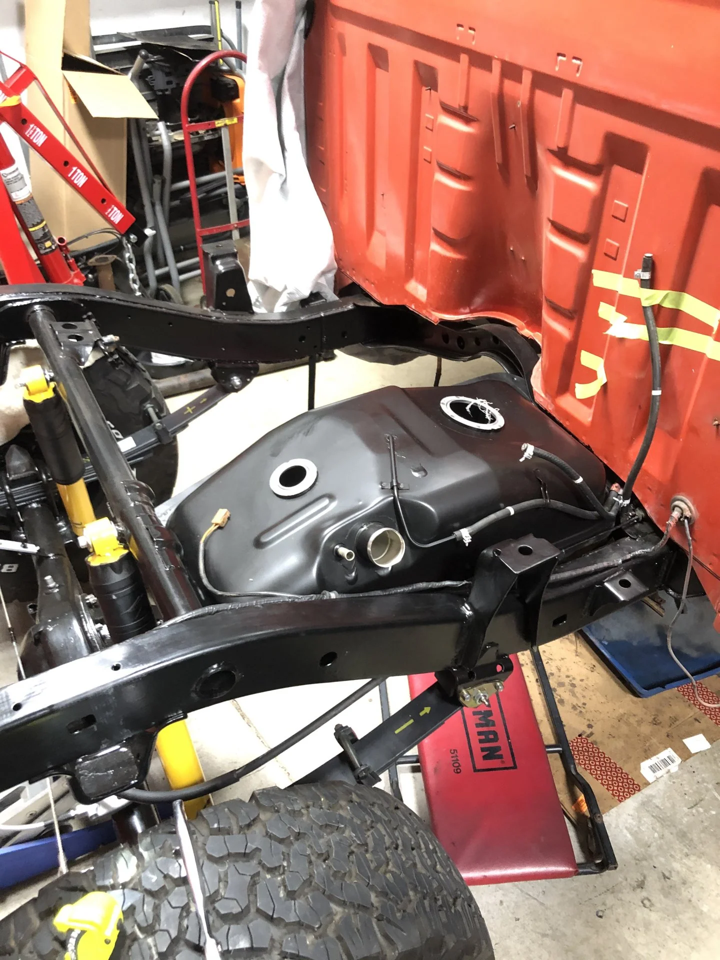

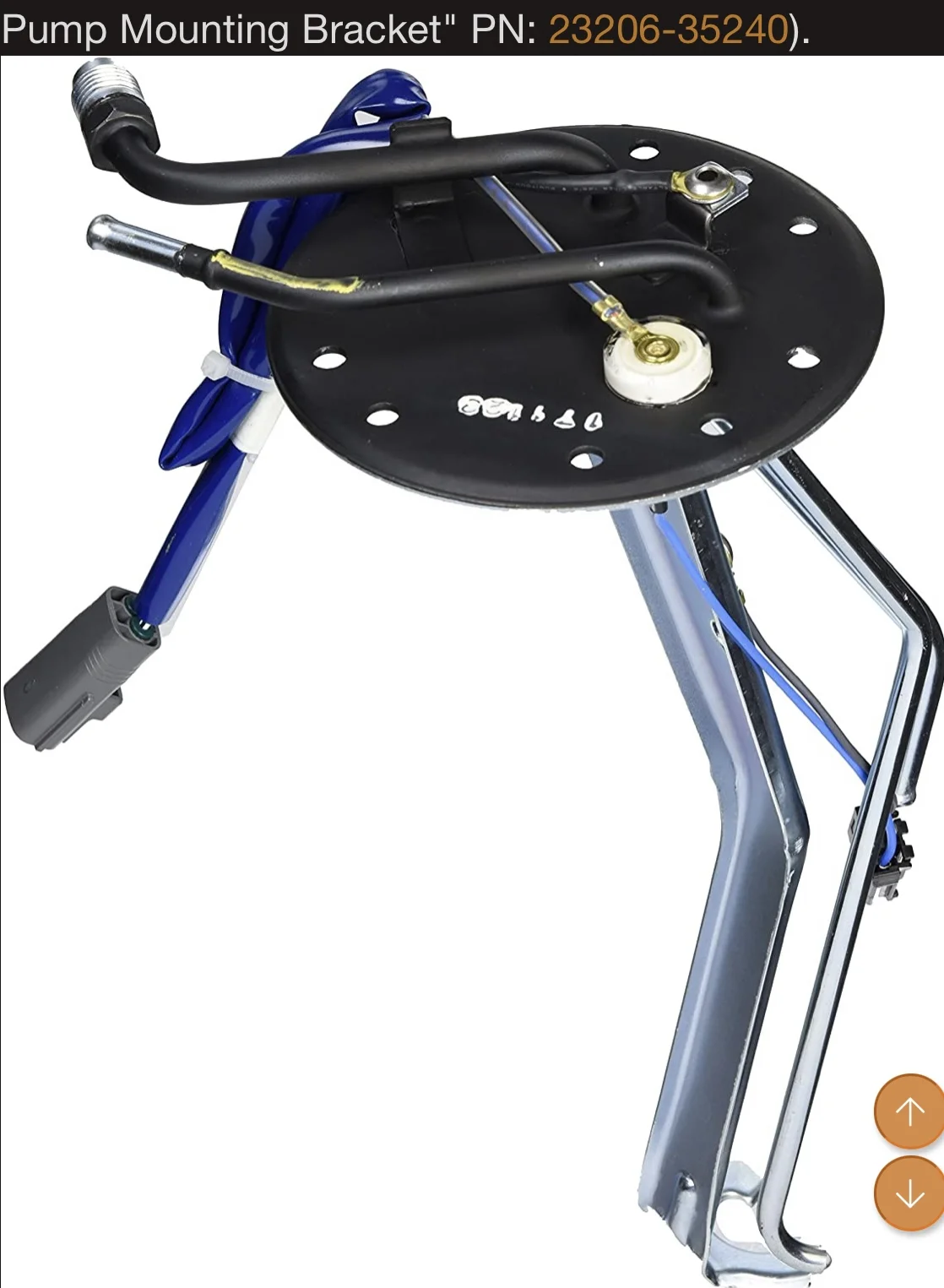

I knew from the beginning that I wanted to go with a Holley Sniper EFI. Because of this, I wanted to run an internal fuel pump for cooling purposes and noise reduction.
The original tank was in good shape, but doesn’t have the ability for an fuel pump hanger. After doing some research, I picked a a new fuel tank for a 1986 standard cab, which is the same size as the original (13.7 gals) with the provisions for a fuel tank hanger bracket. Rockauto PN# 576-214
I also ordered a OEM fuel pump bracket PN# 23206-35240
The new fuel tank and skid plate was powder coated and reinstalled.
Old Tank
New Tank
Fuel Tank pump bracket with Holley fuel pump.

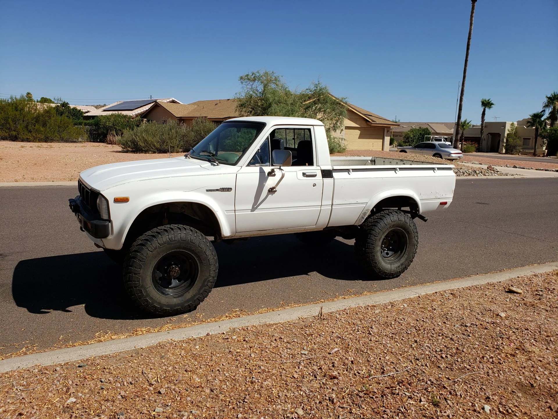

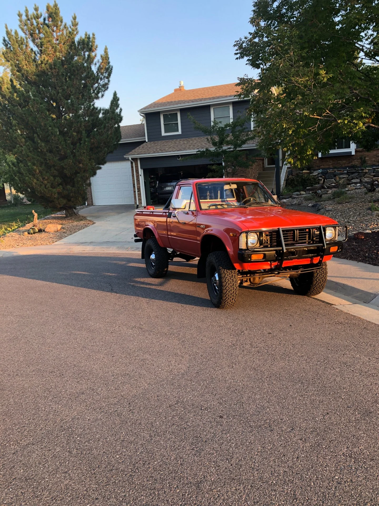

@SMG This is such a rad truck. Are those the factory FJ40 wheels and hub caps? Or were those the factory minitruck offerings? Not much of a mini truck follower. Those wheels look terrific on the truck! Staying with same size tires with the new lift kit? Thanks for sharing!
Thanks man! Yes, Factory FJ40 wheels. I do believe you could get them on a pickup as well.
Maybe it was an option, not 100% percent sure.
Currently it sits on 31’s I would like to move up to 33’s at some point.
LOVE this truck - and what you're doing with it! You can NOT post enough pics.
Pretty sure the trucks got similar wheels but never with tabs for hubcaps. I sourced the NOS FJ40 wheels for my '84 from Toyota.

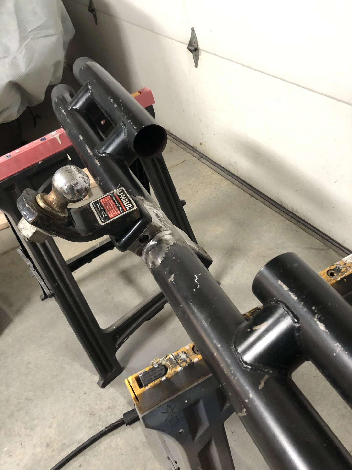

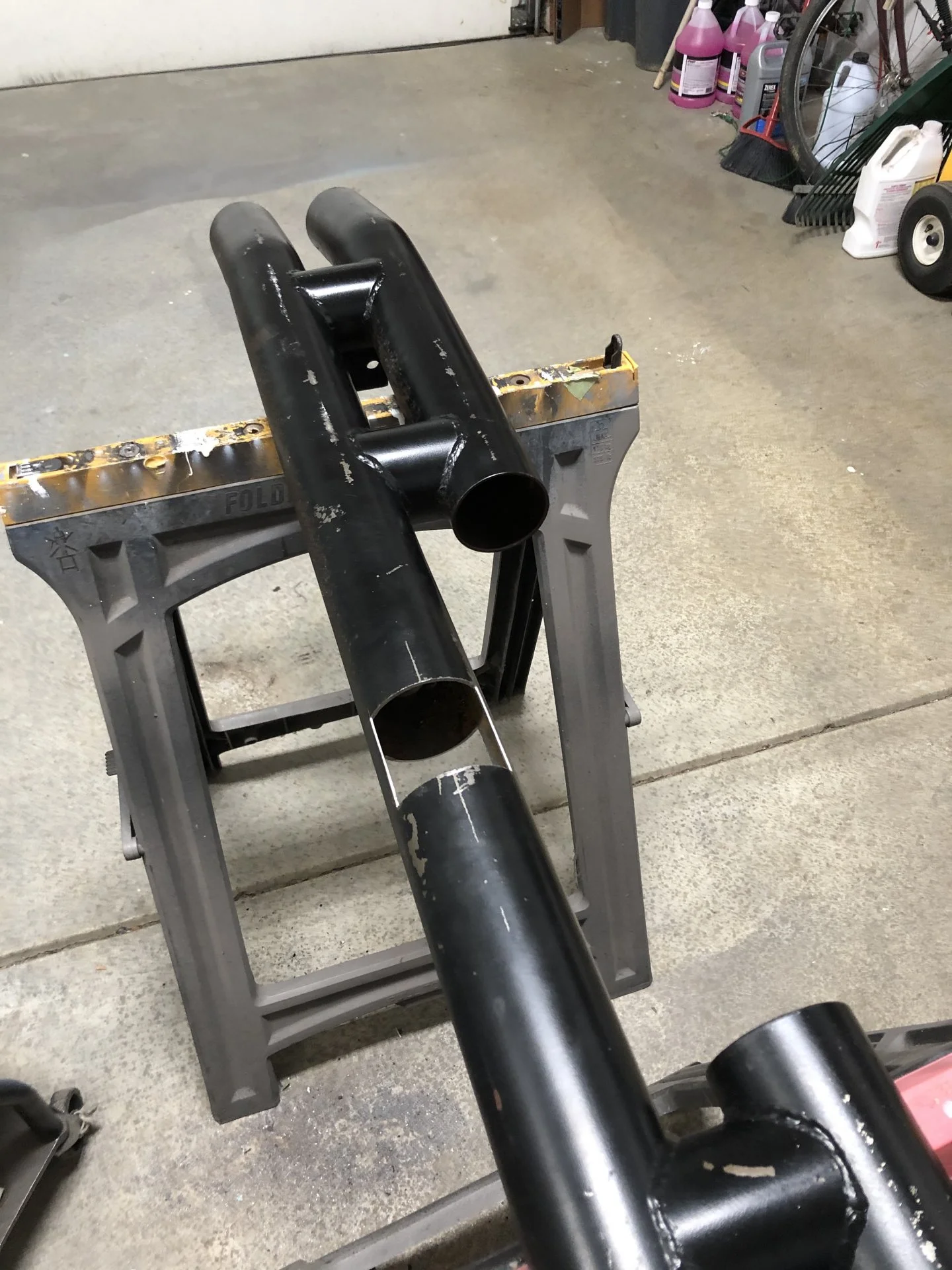

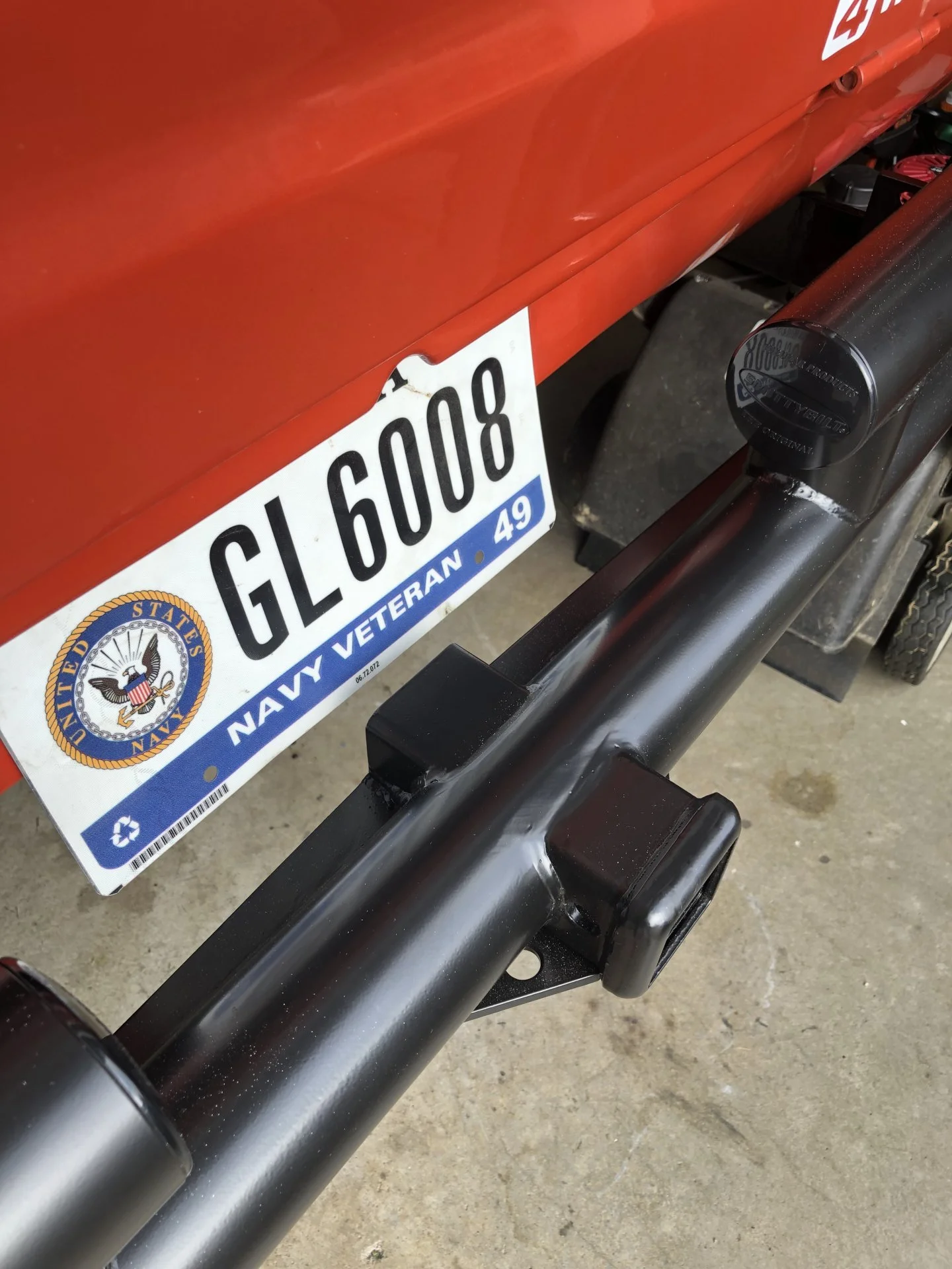

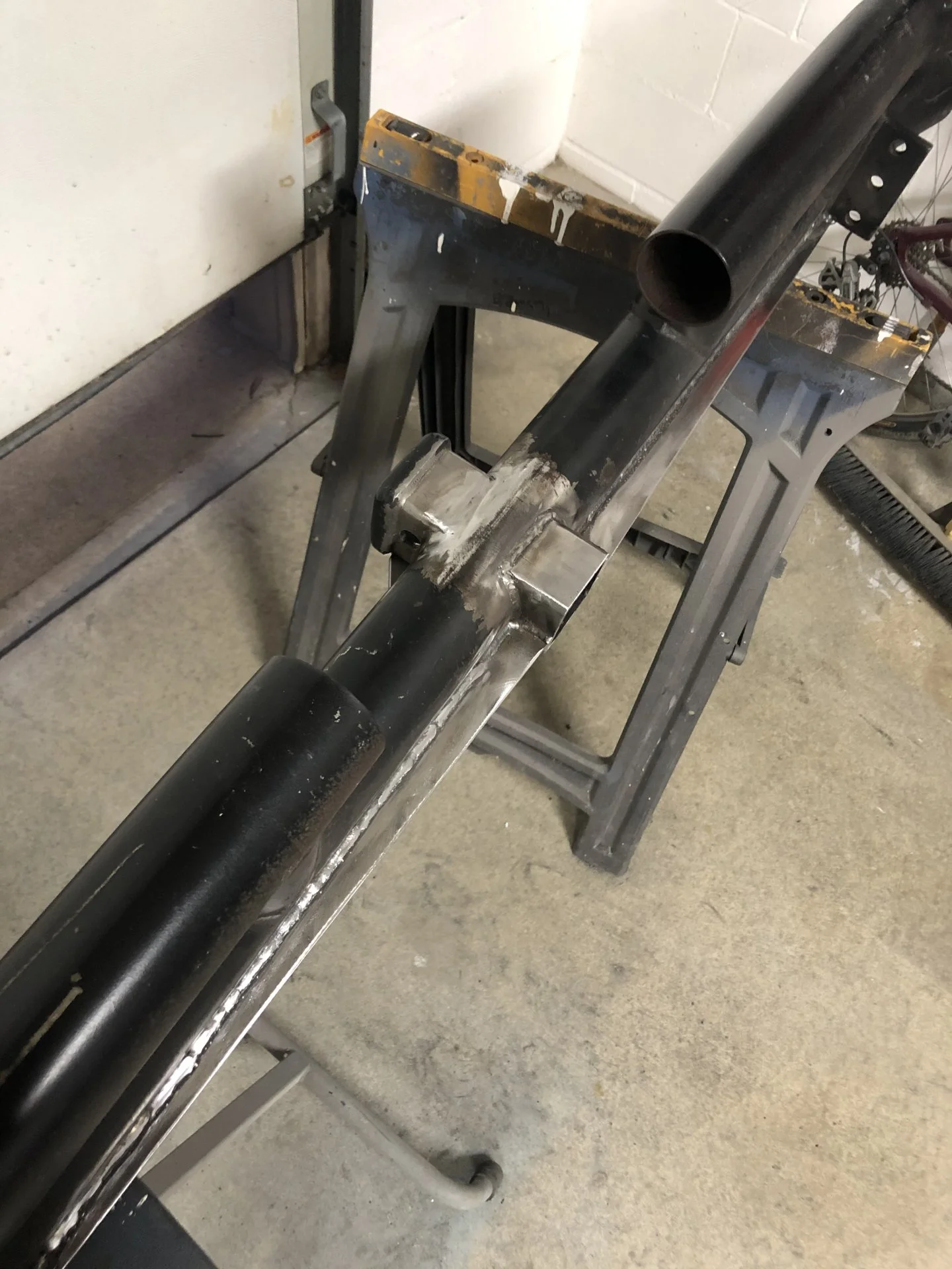

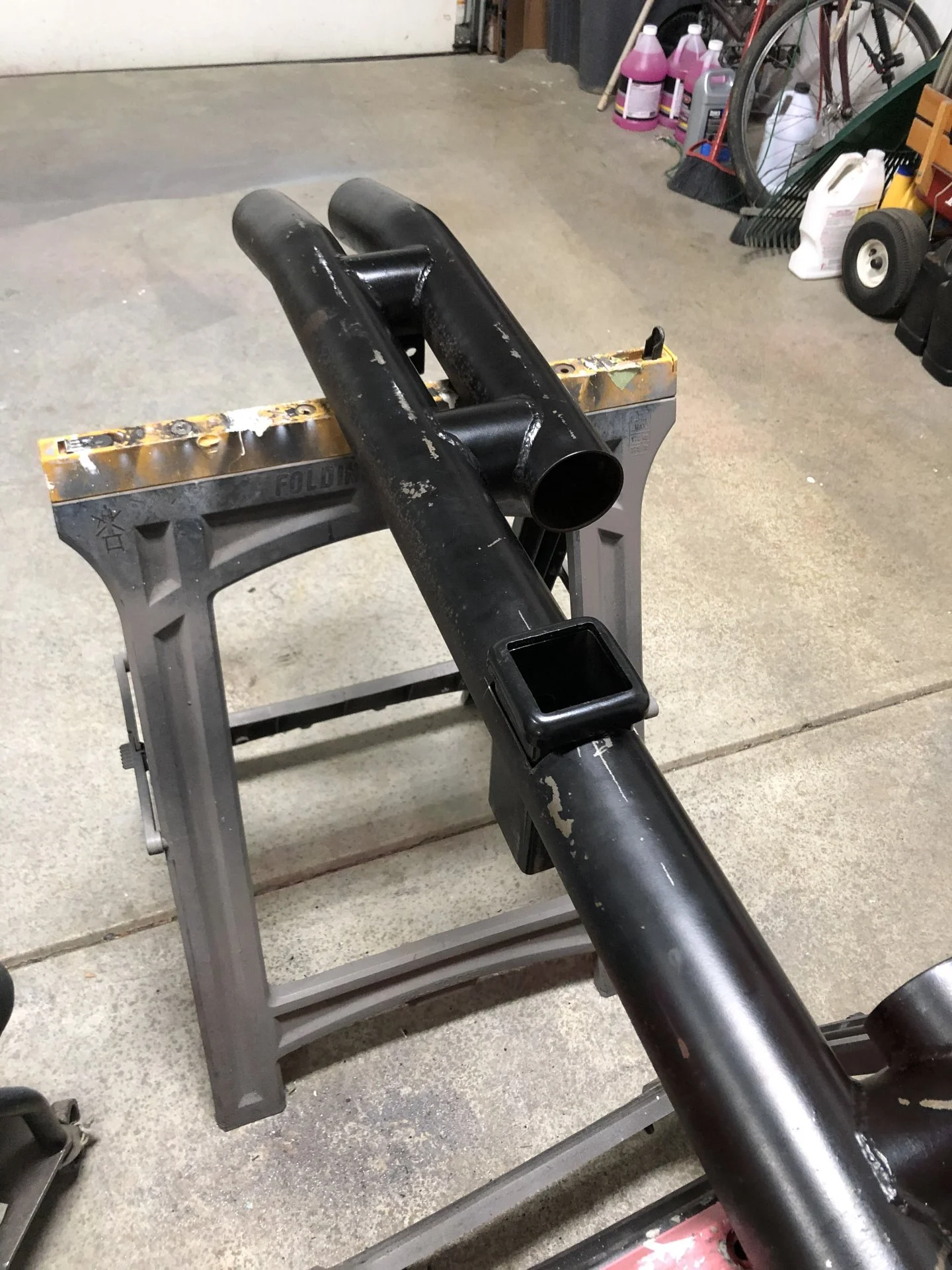

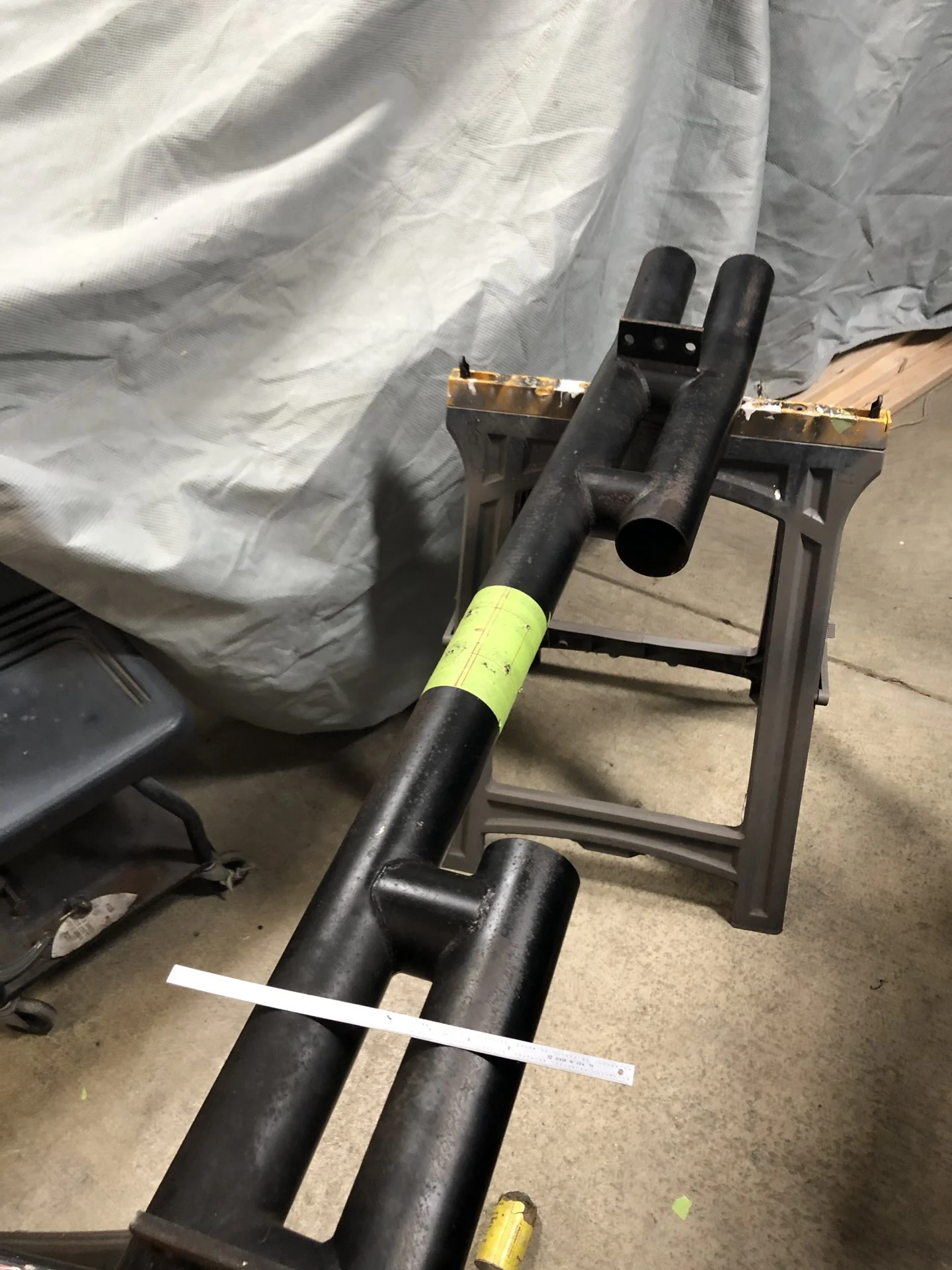

You going to run stringers from the receiver to the the frame? If nit, that tube won't hold hardly ant load. VOE here.
