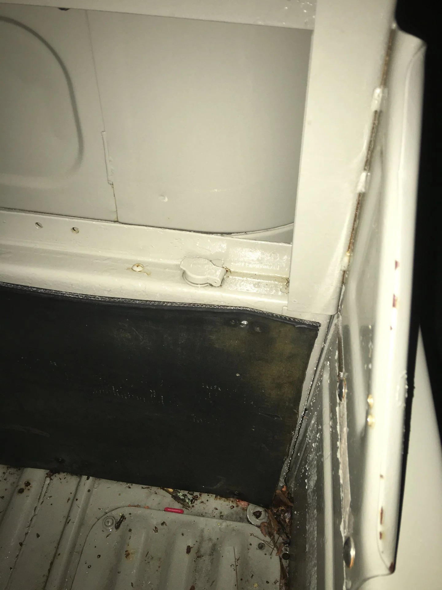

This is just behind headache rack. What plugs in here?

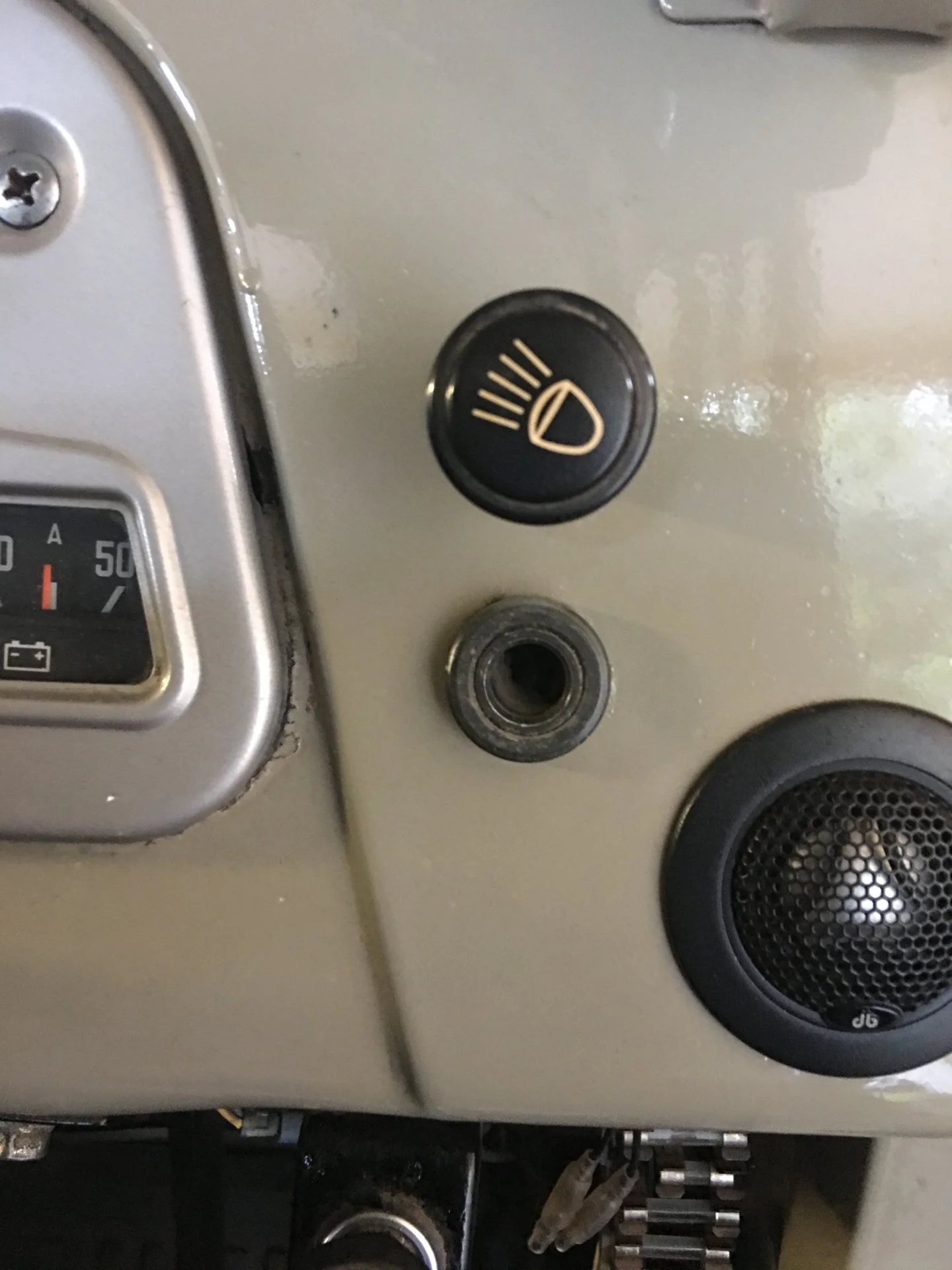

This one on block. Near oil dipstick. Is it a glow plug sensor?

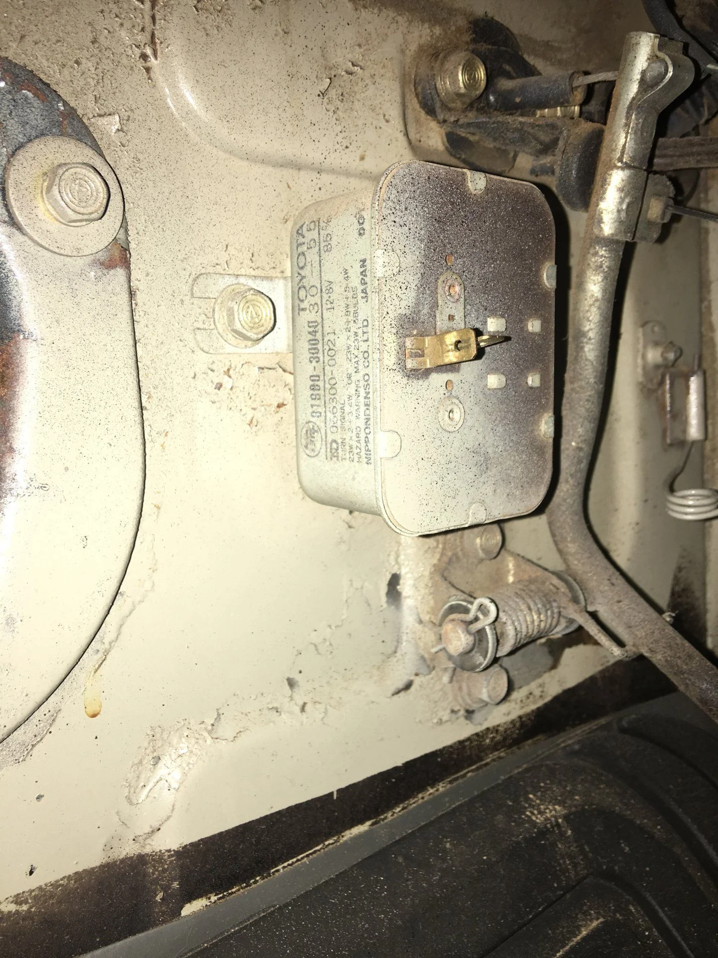

This says flasher. Under dash. Not hooked up. My turn signals work. What is it for?
I think the first item is an add from the PO. I don't believe it is stock. The last unit should be the turn signal relay. If your signals work then someone has replaced it. Look above the pedals for something with the same connector as the relay. It will probably be a small round relay. It is very common to see the relay replaced with an aftermarket flasher.

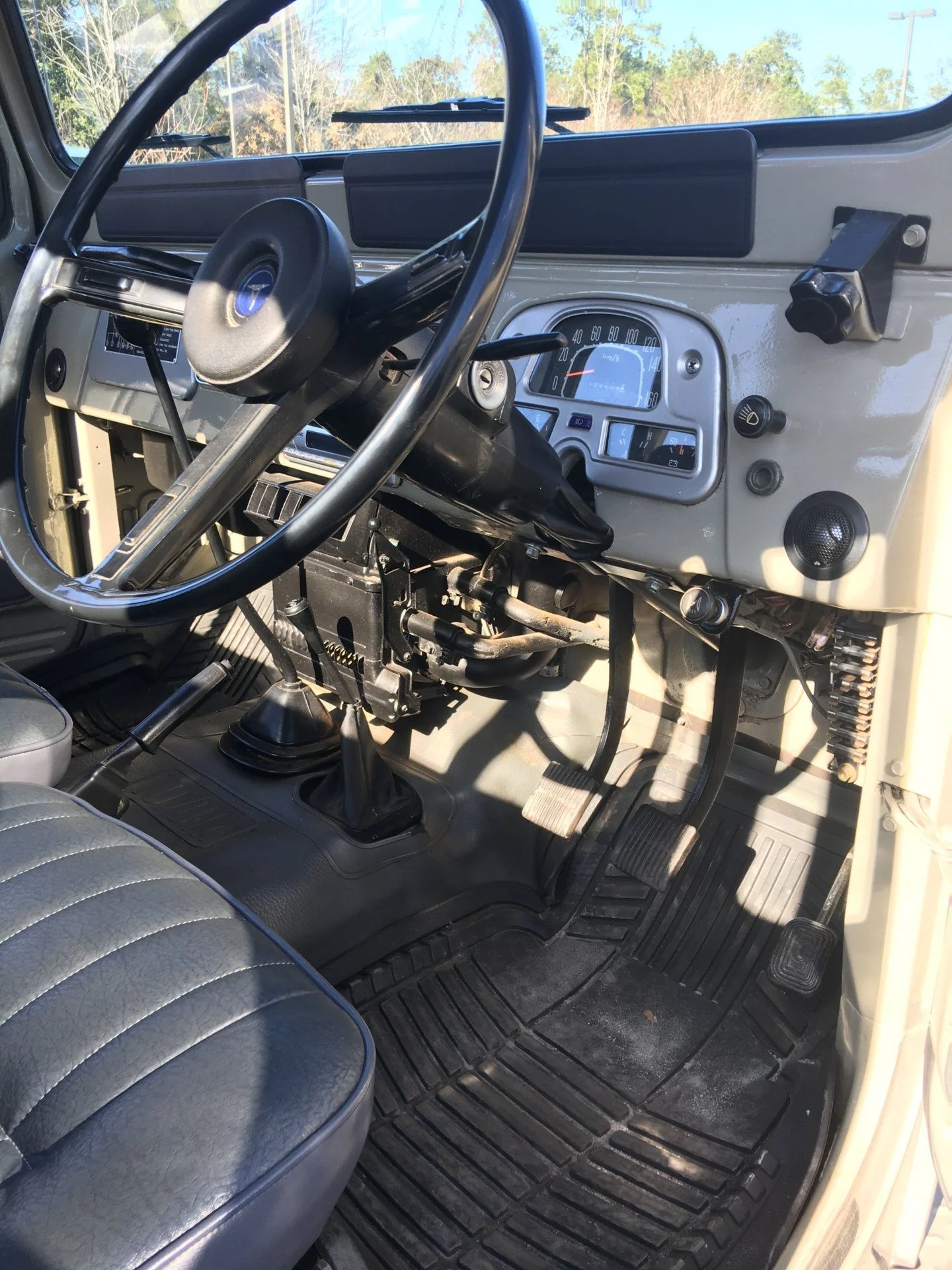

That is a Throttle knob. Used Offroad to set the engine RPM ie if you were using PTO winch or towing a trailer on a farm loading hay. Some refer to it as “Cruise Control”. That is not a good idea.
Ah cool. Didn’t realize it would run the truck while in gear.
This truck not going to be garage queen. It’s going to a farm we’re developing in NC mountains. Trying to get an idea how much it can tow ie. Tractor on a trailer??
The H motor will generate enough torque to move heavy equipment. But keep in mind these trucks don't weigh a lot so controling a load can be difficult, even with trailer breaks.
