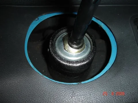

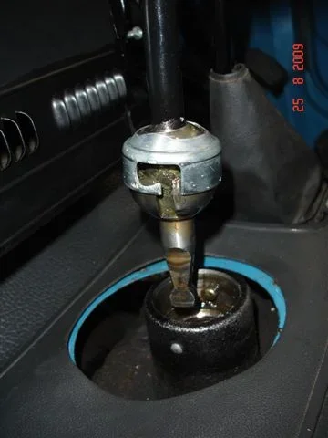

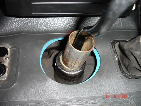

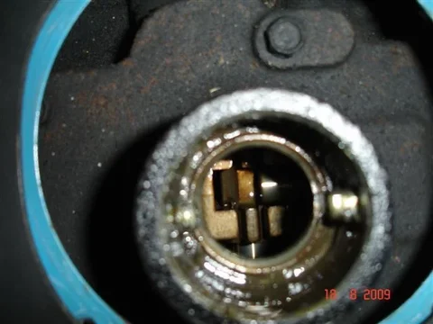

These pics may help you remove your transmission lever Canarias:
Here I have a short section of tubing as my special service tool. I push down on it and rotate it clockwise:
And when I release the pressure, the lever just pops out. Voila!
PS... Have it in neutral first...
