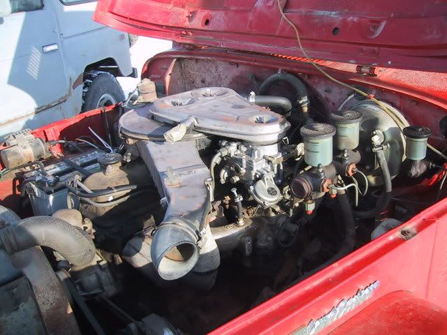

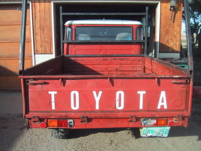

Hello all, Thought I'd post to get myself motivated to start working and of course ask some advice. A couple years ago I found an old FJ45 in a farmers field. It was "one of those" stories. It hadn't been registered for over 20 years and that would support the odometer reading of less than 24k miles. We were able to get it running and driving and more recently I have spent even more time on it. We've done the basic tune up stuff and have also carb kitted it. Here is a couple pics of it. I dont have any recent ones but not much has changed...
So the basic plan isn't to agressive. I want to tear id down and clean everything up. Address any big issues like leaks and creaks. Fix the body work which isn't to bad for its age. The box needs on support underneath but otherwise it very solid. The tailgate is bent a touch but not bad. I think I'll buy new fenders since they have the typical rust. Bib and cowl are good. Winshiled frame need some work. Rood has some dents but they should come out.

You should be able to put 33"s under that already as she sits. Nice truck, and it's my fave color too!
I've got a set of Cooper Discovery ST's on my '45 and they're advertised at something like 33.2" tall in the specs. The size is 255/85-16 and I've got them on 8" wide aluminum rims.
They fit great and look even better. The tread is under the body and a little bit of sidewall sticks out. I don't think they'd have fit very well w/out having replaced my suspension though and the truck currently rides on 2-1/2" OME Dakar springs.
What size tires and rims are on yours now?
4. If I leave the truck overnight I need to crank it for 1-2mins to start it. No fuel in the bowl. Where do I look to fix that?
After turning off the engine removed the top cover of the airfilter assy and check if the carb is leaking into the intake. If it's leaking you may want to keep an eye on the oil/replace. Clean out the carb comes first to mind but and it's probably best to have a carb kit on hand in case your break a gasket or seal. I bought several carb kits from JimC in past and rebuilt my carbs with no problems. Since it's new to you and had been sitting out in the field for 20 years, your best best is rebuild your carb or have JimC or someone on this board rebuild for you.
