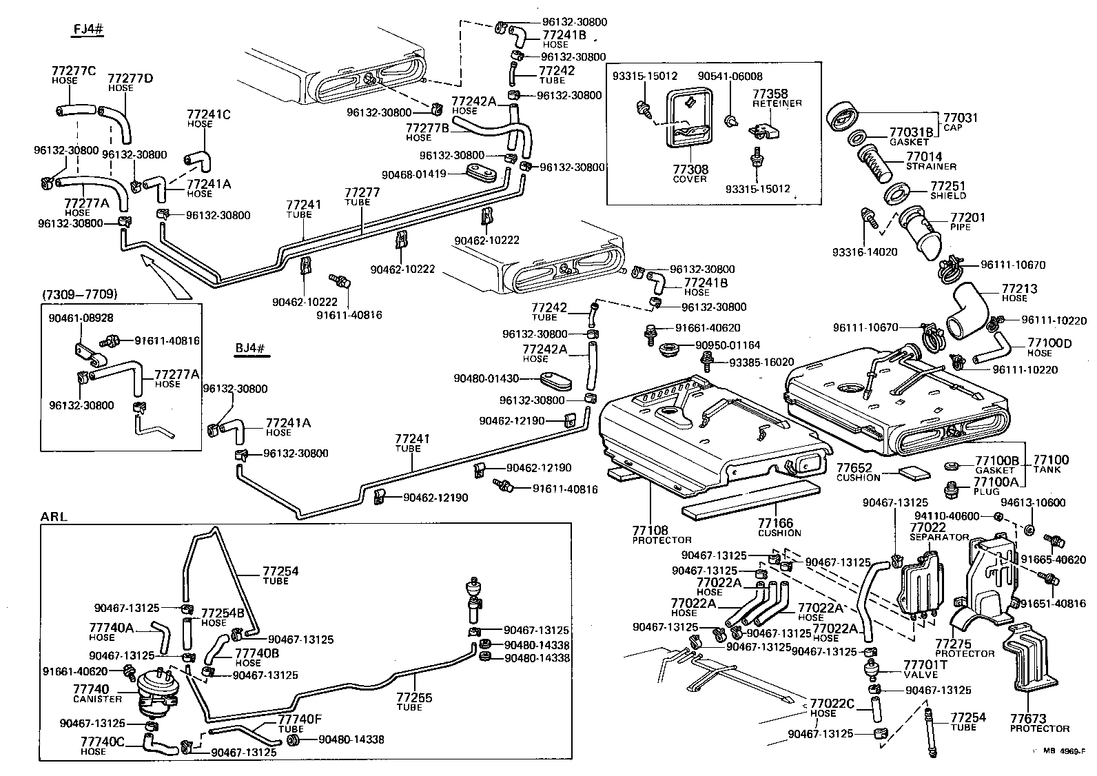

No love from uncle T on the under cab tanks for 79+ anymore? Can’t find the OEM version for sale anywhere. I do think that OEM drain plug is pretty neat, would hate to give it up going aftermarket.
My local dealer can get 77100-60042 which appears to fit FJ40 1/75-1/79. Has anyone purchased one? Here is link on TPD.
But TPD shows it fitting ’73-‘74 models? Does it also fit others through ‘79?

Aside from the extra evap lines on these tanks, is there any reason it wouldn't fit into an early (65) cab? Struggling to find an OEM tank for anything older than a 68. Thanks!
