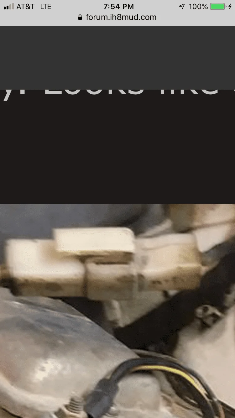

This (your second pic) looks like a fusible link... is the black burned or just the pic?
All the underhood wires and connectors look like that. It's just old and grungy. Frankly, the whole wiring shooting match needs replaced.

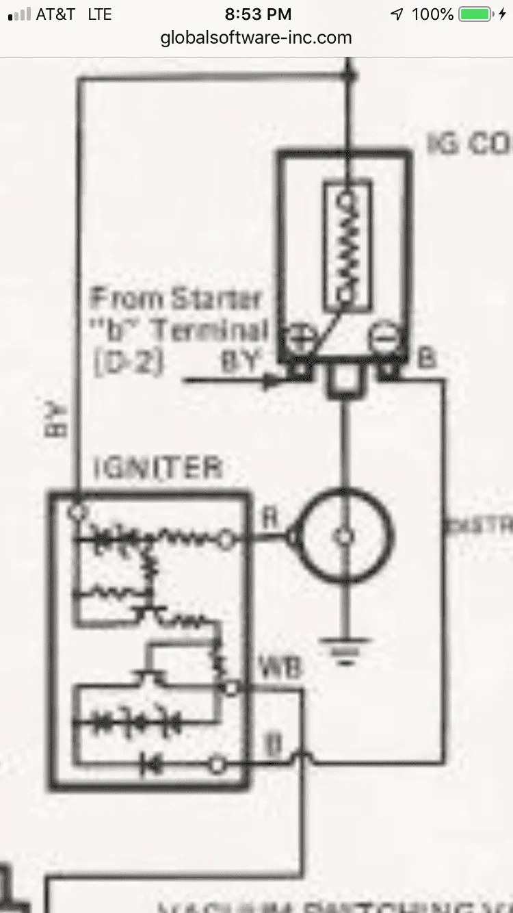

It’s Pig Latin... I thought that was appropriate.
You stillrecognize a bullseye, right Drew?
That the distributor. ;)
The round thing, about a foot and a half away from the word "distributor?"
I have to admit, I simply don't understand electrical schematics.
They don't even remotely resemble real world wiring, and most lack contextual information that would make them understandable.
