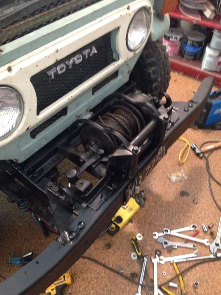

Finally got around to making up the pto shaft for my FJ45. The winch gear is out of a 60 series so I cut the three piece shaft down to two. Had to adapt the mount under the radiator but that's fine.
Tonight's job is to mount the winch properly, it needs lifting by 8-10mm and the mountings reinforced.

All mounted, not perfect but don't think it's going anywhere in a hurry.

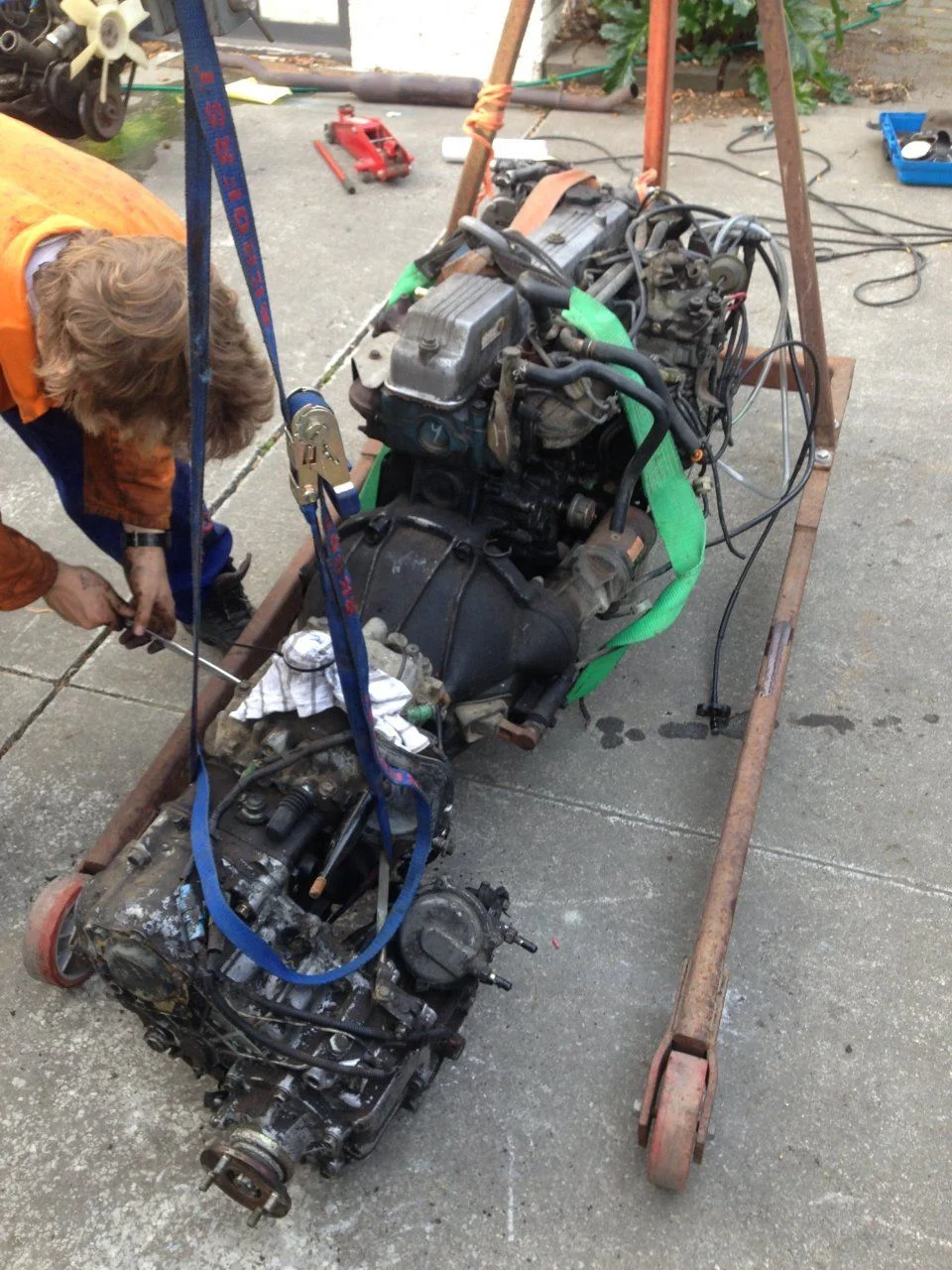

It been a busy few days, first drove 700km in the fj45 back down to uni, the main reason was the 12ht swap. So the 2f came out today, 12ht in. added a few pictures too. Made lots of proges today, and should get the motor in tomorrow, will be hopefully driving the 500m back around to my place. But will be jump started, front drive shaft and a jerry can for a fuel tank....
Last time this 2f is in my truck, will probably end up in a mates cruiser as it still runs mint.

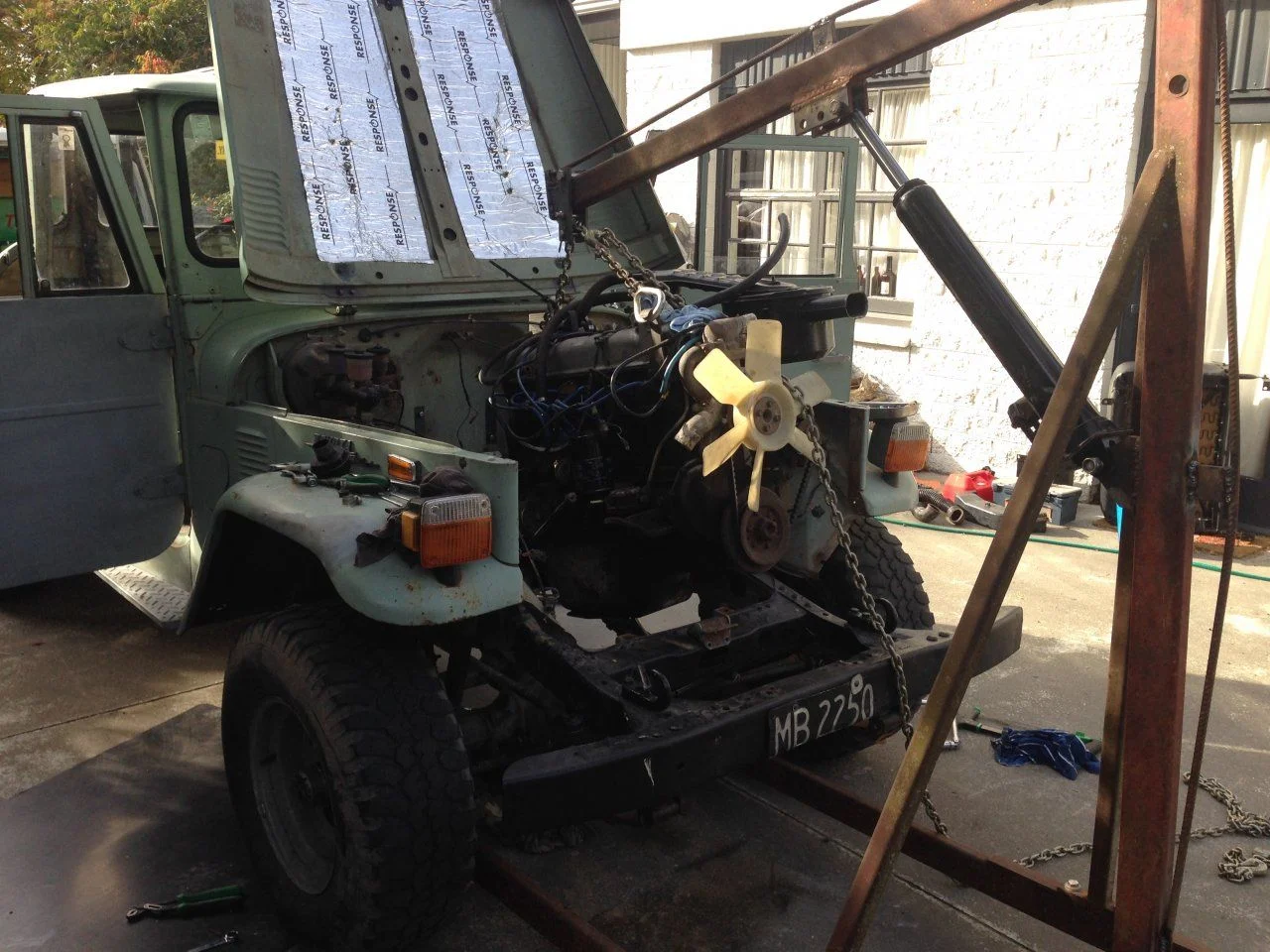

Took till lunchtime to disconnect everything and pull the 2f, lots of finicky s***
Cleaned the engine bay up a bit while the engine was out, a bit of paint on a few places and then added sound proofing behind the engine which should help
The 12HT and 5 speed that is going in, had a good mate help me out which speeded things up.
So at the end of the day the engine is roughly in place, gearbox cross member is bolted in. So the job for the morning is engine mounts. Can start to see a few problems I am going to have with drive shafts and possibly the radiator fan. Plus the 12v to 24v switch.

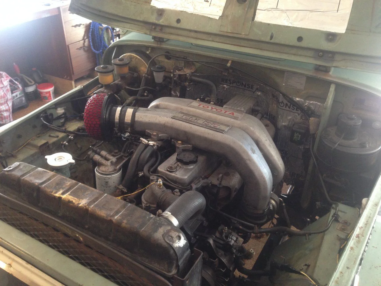

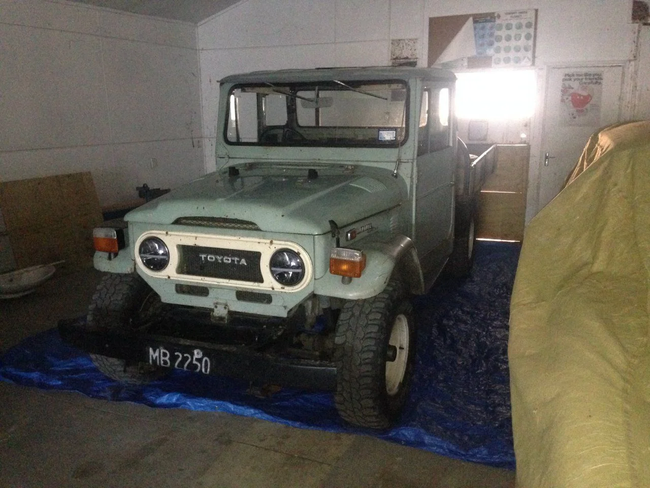

Ran my fj45 home last weekend, 750km with 700kg of spare parts on the back and only used one tank of fuel. The 12ht ran mint, but have work to to with a few oil leaks that need to be fixed. Great power up the hills, finally have a truck which I can overtake people uphill and not break the bank every time I use the throttle. Installed a oil pressure gauge before the trip to, 25psi hot idle, 65psi hot 100kph so looks like my engine internals are good.

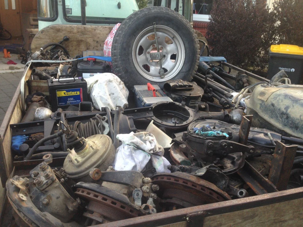

Its surprising how many spare parts you can build up, I finish uni in November so had to move all of these bits home, most are destined for the 45.
Been a few weeks since I drove my truck home, 750km and only used 70l :) But did have a few oil
leak problems.......
Engine ran mint apart from the heater springing a leak a day before the trip, 45's gone back in the shed at home for a few months,
nice and dry
Will be back home early November when a full strip down and continued restomod will take place.
