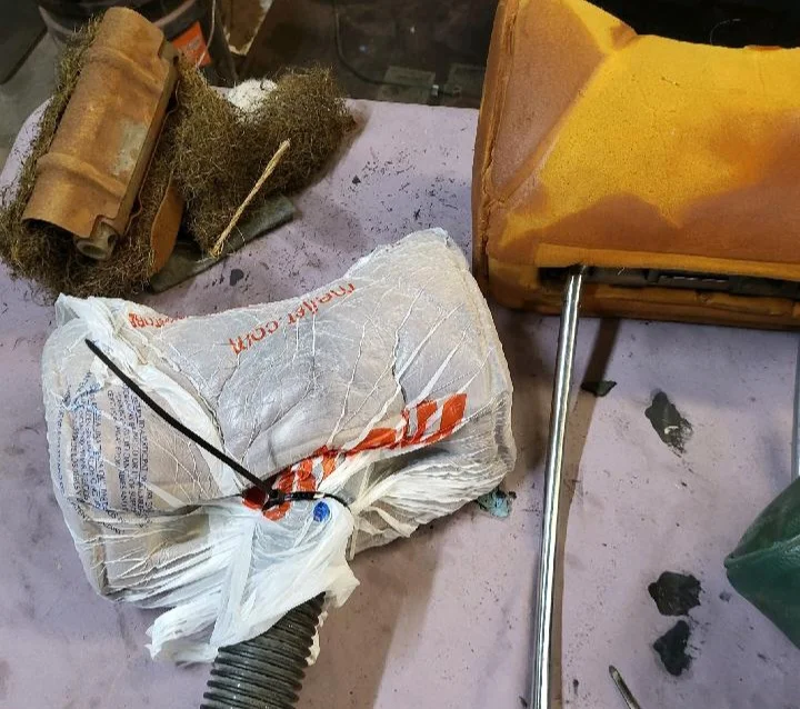

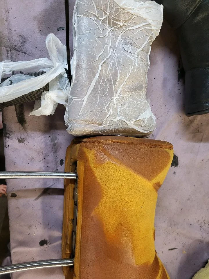

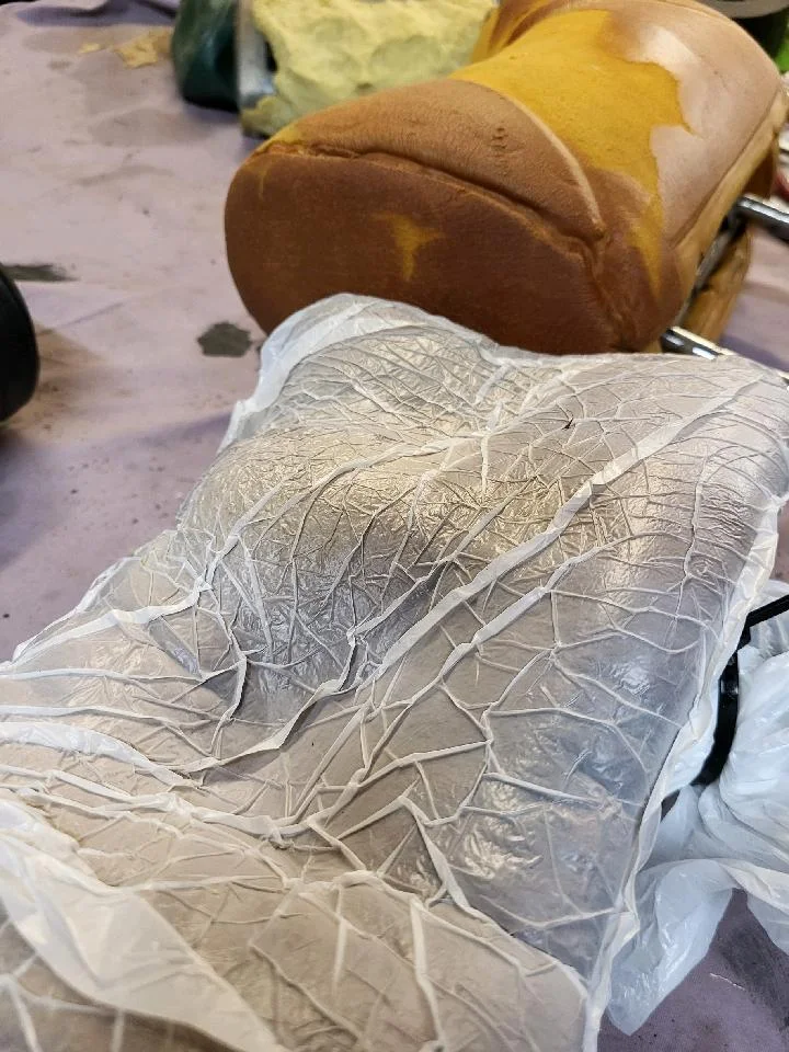

I was today years old when I learned how to install headrest foam into a cover. Pulled the inner frame out. Sucked the foam up with a shop vac and a plastic bag. Squashed it good with my hands and the vac held it squashed. Slid right in the cover. Which I dint take a pic of.
The horsehair mess was from the 73. The foam ones are 78. Both are early headrests with the ears.

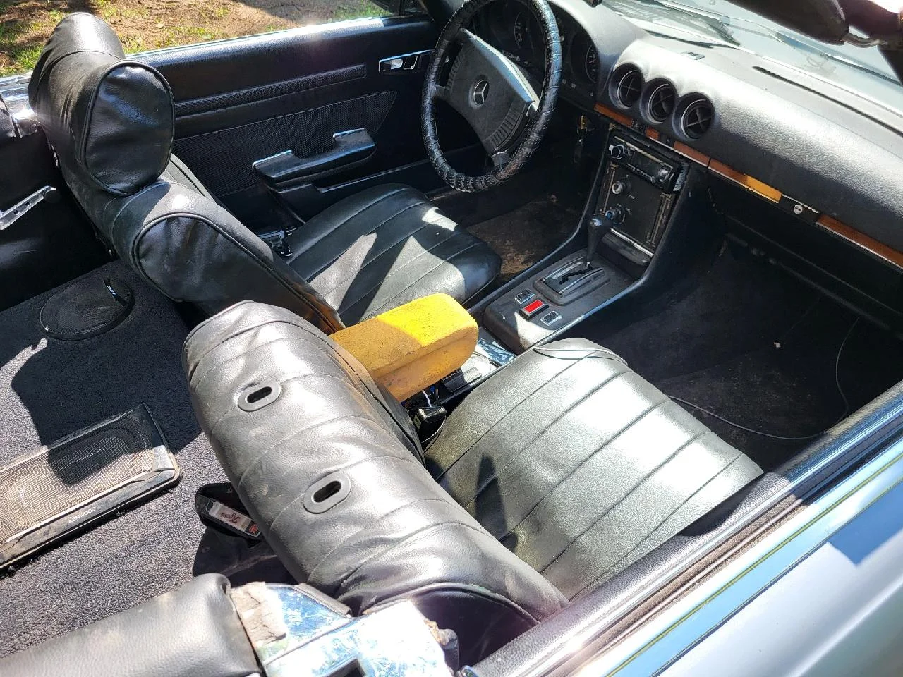

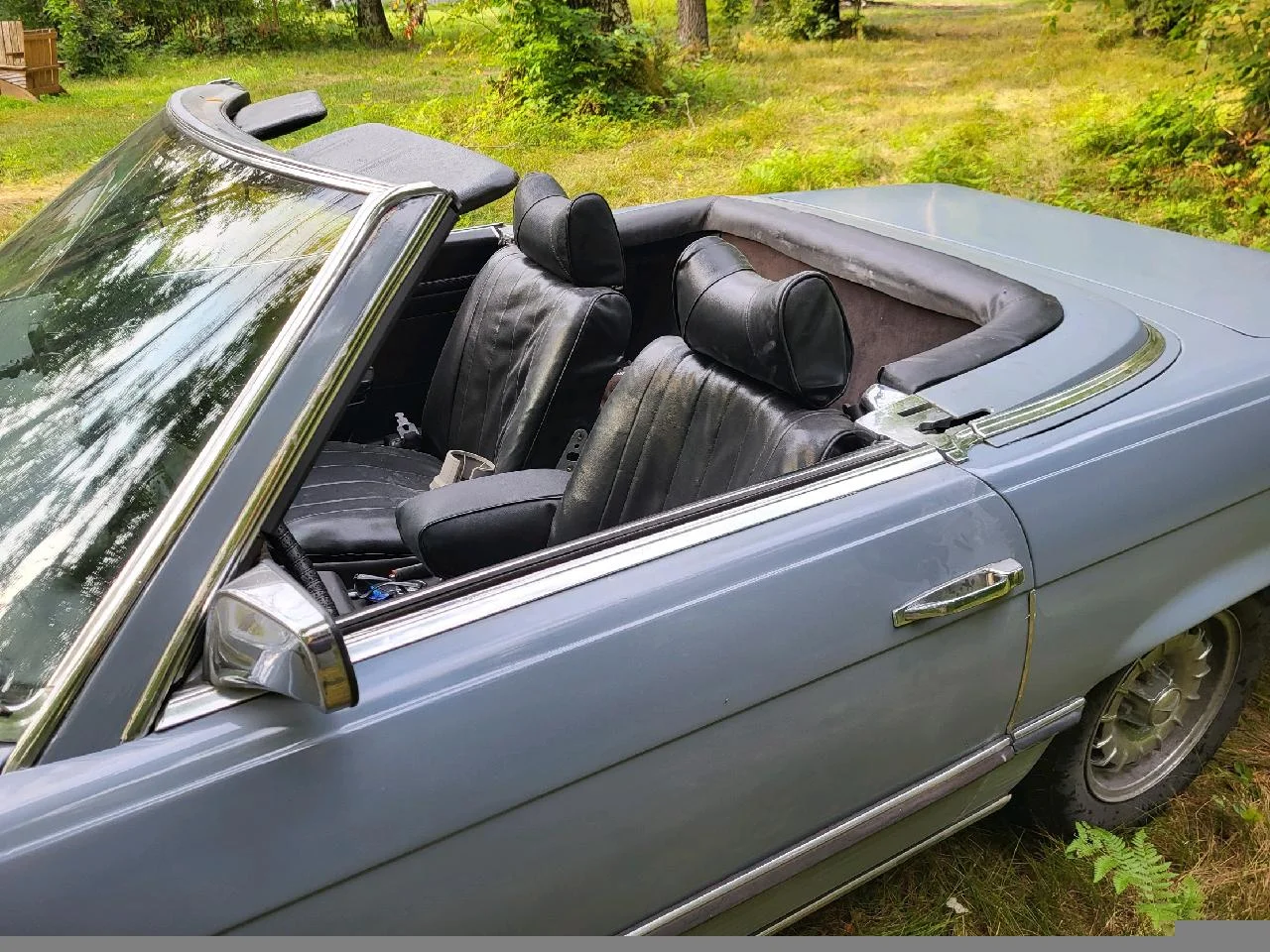

Installed them in the car. They fit nice, as they should. Look correct. Slide nice. Are pretty OK comfortable. 1960s comfortable. A good inch lower. Armrest is great, but I lost my cupholders
So... nice looking comfortable wrong seats, or kinda poor fitting dyed covers on right seats? 1st 2 pics are benz seats. 2nd are Audi seats.

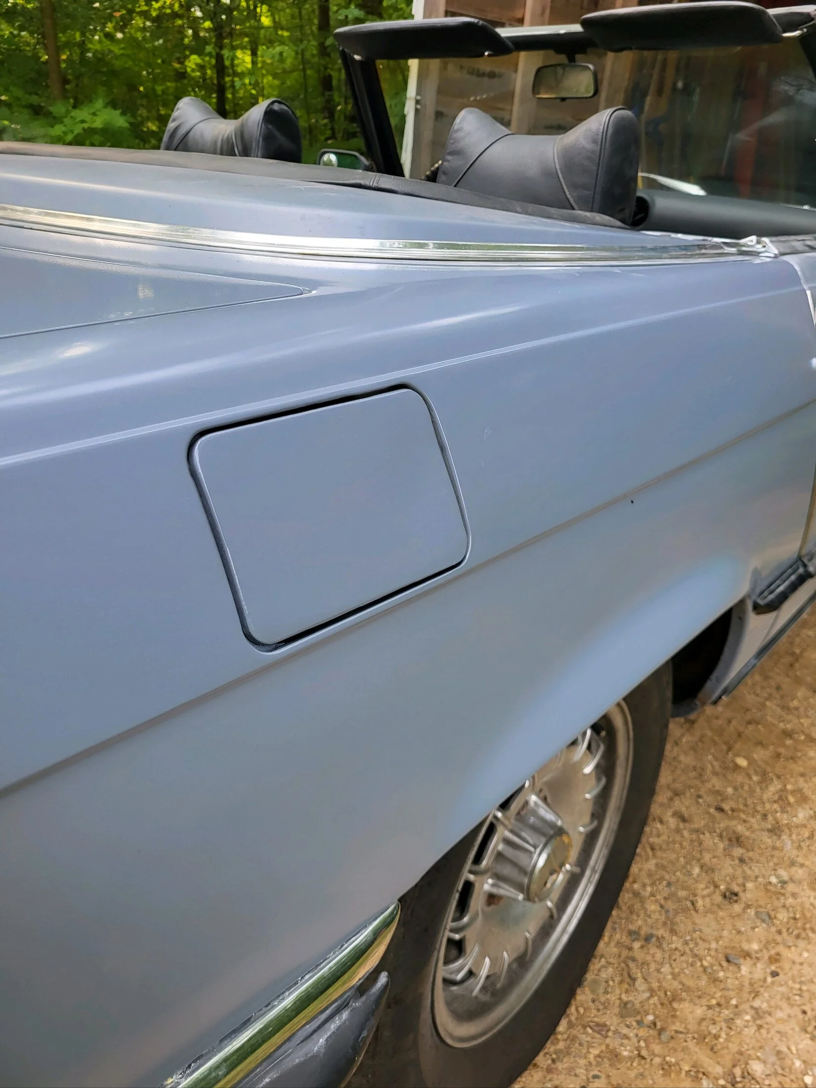

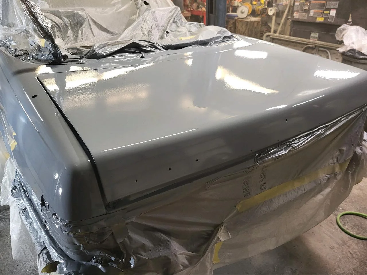

I started on the last metal repair. A set of 1/8 holes from the bad old days of slide hammers. Ran across the body line at the lower front corner of the filler door down aboutn6 inches. I welded the holes shut. The metal was actually pulled out very nice. A thin layer of Upol fine strand and some thinned filler made the repair go away.
Things got out of hand and I blocked the whole tail, sprayed it with Slick Sand, blocked the high build, and hit it with 2 coats of sealer. It cleaned up a bunch of dings, scratches and grinding marks.

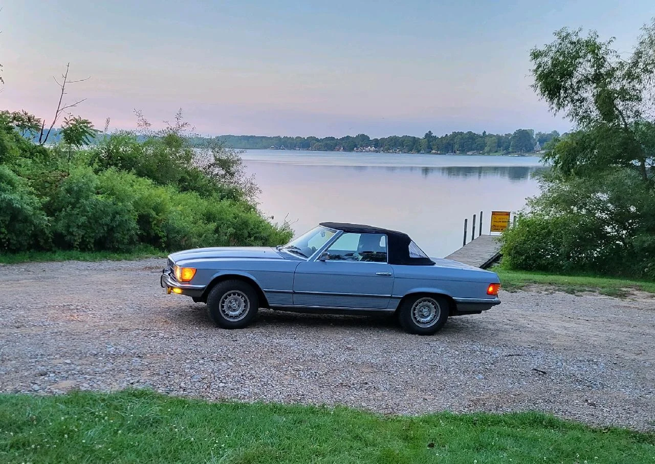

Took it for a drive to buy a set of 15" hubcaps for steelies. Wall art right now. Runs great.
Stopped in at a boat launch Monday morning because the light was nice.

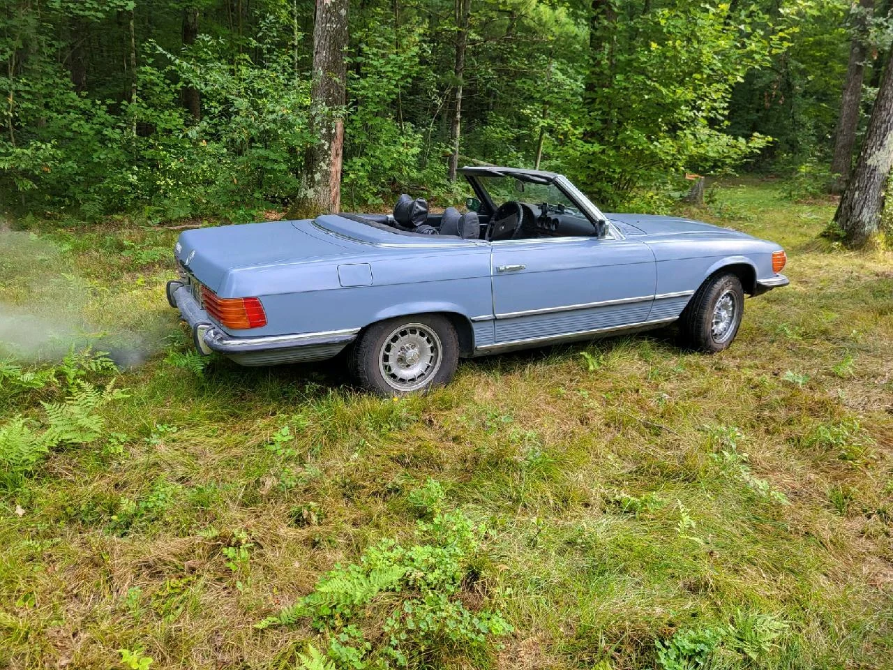

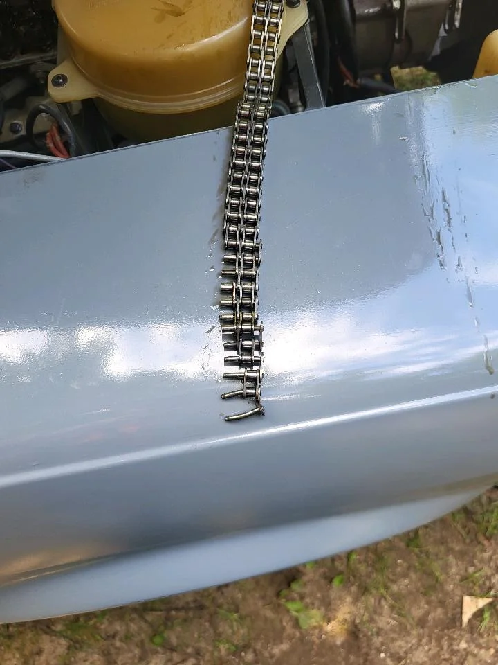

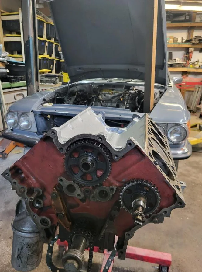

Stopped next to a cornfield on the way home because timing chain had left the chat.

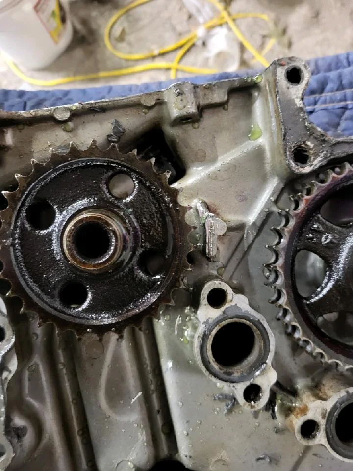

It looks like the idler pulley seized. That's where the shredded chain happened. The upper chain guides look all good.
The valves are all tight to the cam followers so I think they are ok.

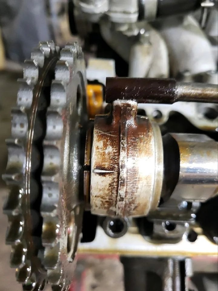

Well, the good news is I found the missing cam gear spacer. It goes between the cam gear and the cam and has the timing mark on it. I saw it was missing when I installed the chain. Couldn't find it anywhere. Stole one off the spare motor.
The really good news is the problem doesn't involve anything seized. A simple chain replacement should be fine. The case got a little scarred.

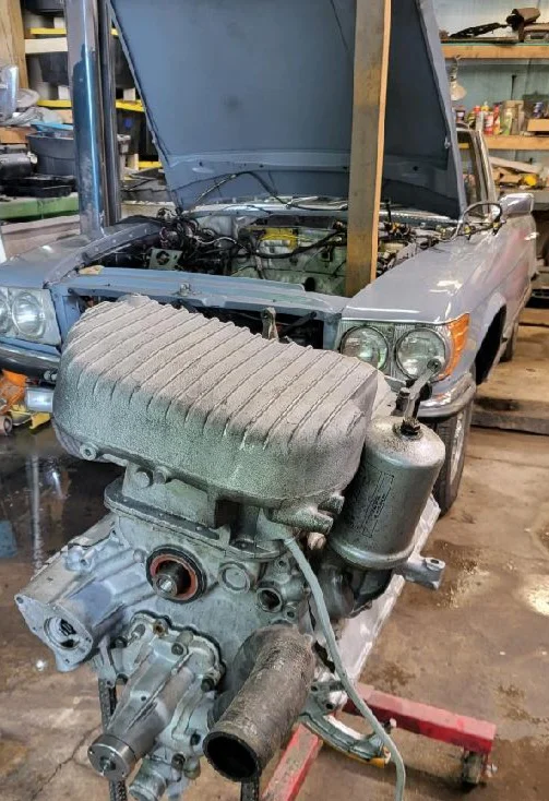

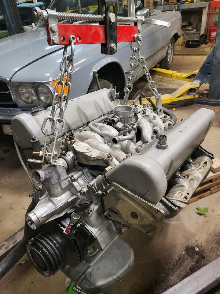

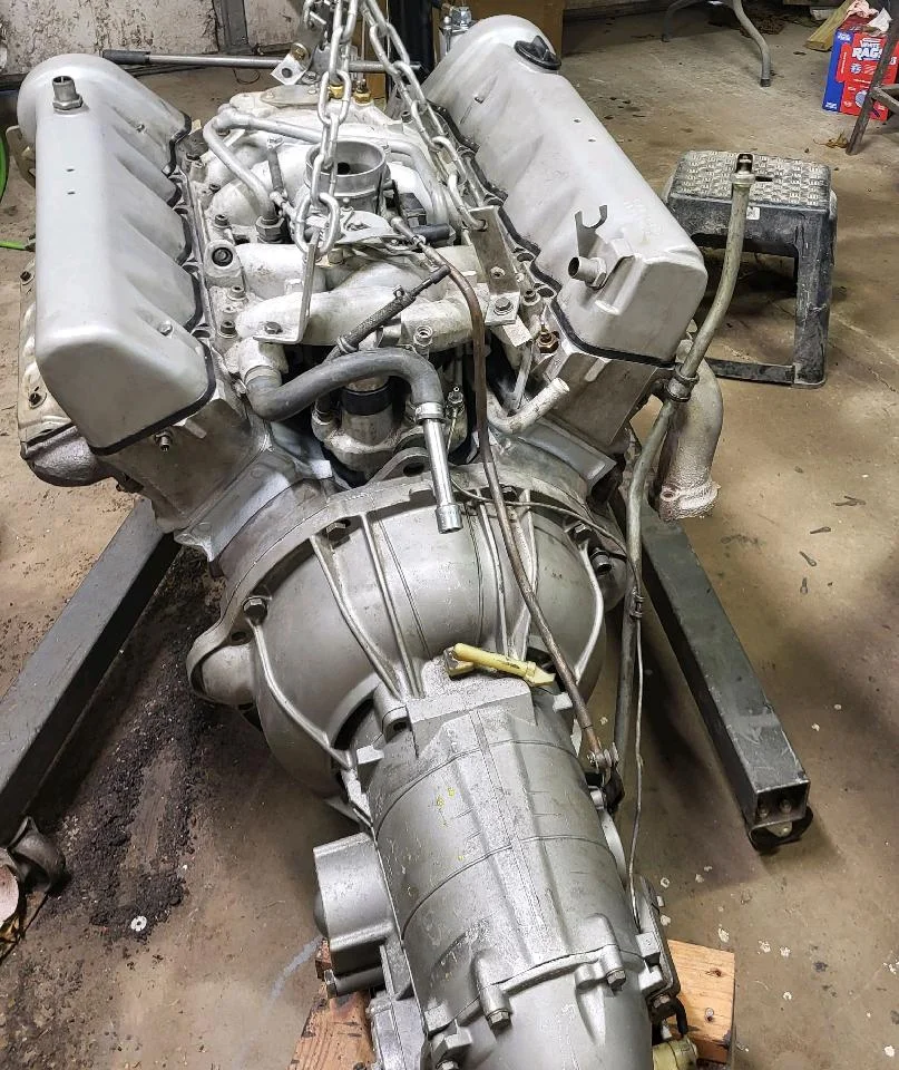

I did pull the motor and trans to pull the cover. The oil pan really needs to come off to pull the cover and it definitely had lots of timing chain in it. The trans needed front and rear seals. If I can find them I'll do shift shaft and kick down shaft too. I needed to re-do the rear main seal on the crank too. It looks OK, but it's leaking. It might need a speedy sleeve.
Chain sprockets all look ok.

I ordered a new firewall insulation pad too. While the motor is out.

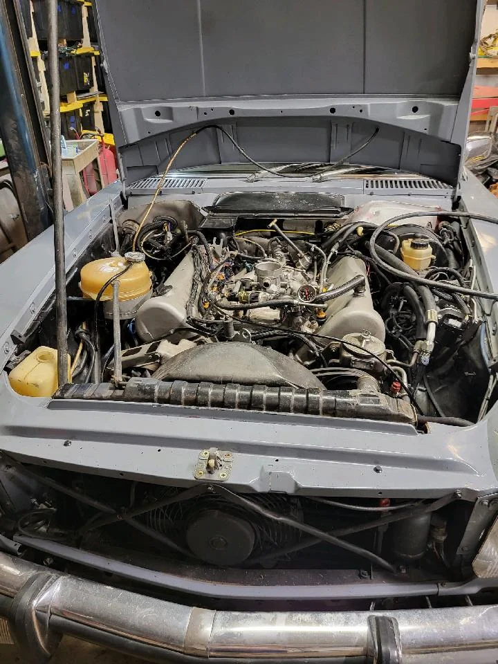

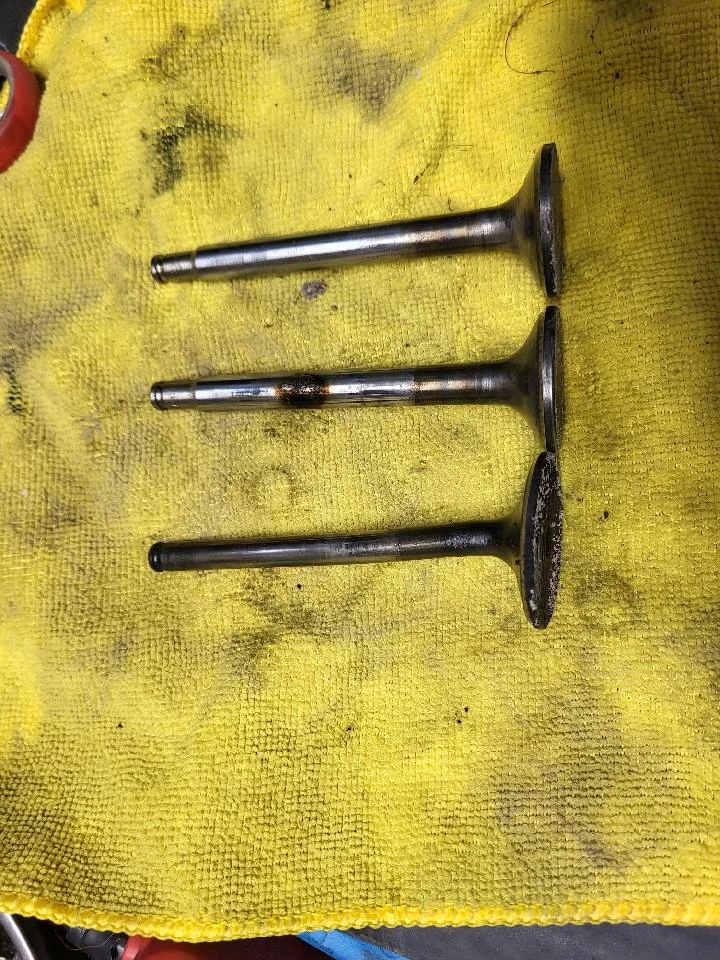

Installed the new chain. Went to check valve clearances and #7E was about 3mm. Put some air to it and had 100% leak down out of the exhaust. #6 had about 40% out the exhaust. Of course, one of the intake valves was bent on the other head. After i pulled the heads i filled the combustion chambers with acetone. Those three were the only that leaked. You can't hardly tell the exhaust valves were bent. Even rolling the stems on a table didn't show much. I chucked them in the drill press next to a square and you could see they were tweaked.
Pulled a head off the spare m117 and pulled the 3 valves. Found the valve seals I had ordered before. Did all of those while the heads were off. I've got a week before the closest head gaskets get here anyway. 73-75 only. Right side from TX and the left side with intake kit from DC. That doesn't happen with an LS. They got LS head gaskets at the Walmart.
Cleaned the block and painted the intake valley. It's dry so paint is OK. MB painted the front and rear with the red. It hasn't flaked in 50 years, so I figured it could stay.
Test fit the front cover. There's a lot of timing cover parts to line up with very little clearance on the chain path. Also, the oil pump gear chain needs to be installed on the crank gear as the timing case goes on. Blind. The plan was to test fit before putting Right Stuff on it and maybe I wouldn't look like Al Jolsen when I was done. You know what Iron Mike said about plans. I think I got most of the smudges off the front cover and block. It'll wear off my skin eventually. Good thing my pants were black. You can hardly see the spots.
Put the cleaned out oil pan back on. All the parts of chain were whole. One chunk of aluminum from the boss on the head.

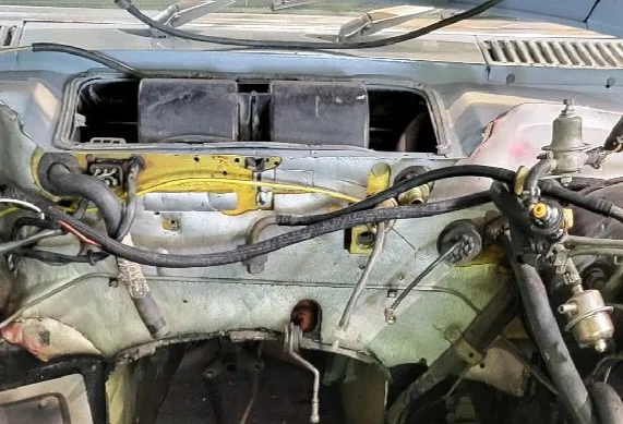

I got to looking at the work to strip the engine bay just enough to replace the firewall insulation and decided it was a problem for final paint Gum. I masked and painted the few yellow spots that were showing and decided I could live with red overspray.

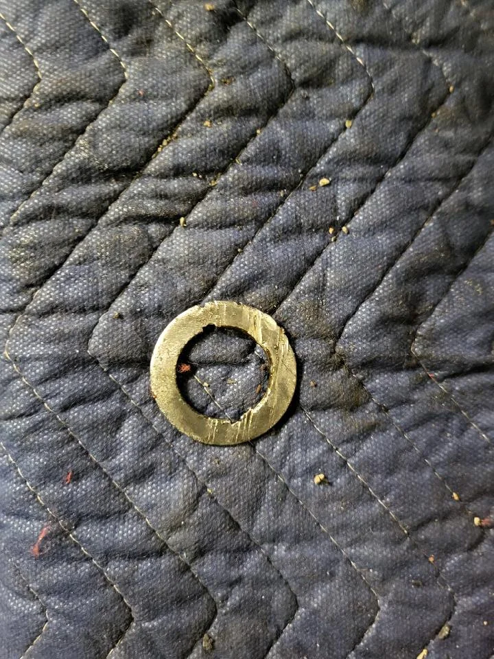

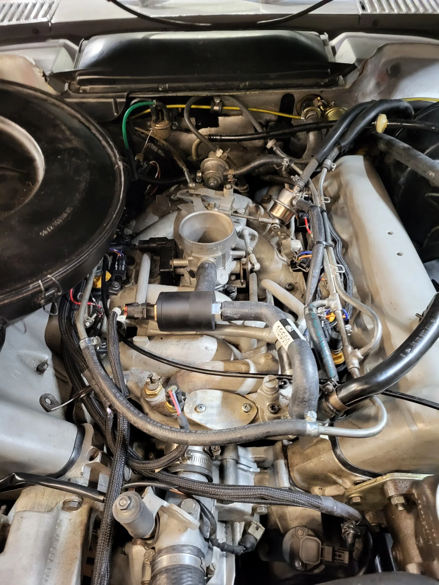

Spent a bunch of time looking for the trans input seal I had ordered and forgot to put in. Turns out a 5vz cam seal is really close. 1mm too tight on the ID. Fount the correct seal before I did something stupid. The rear seal is the one leaking. Fortunately that one did not fall off the shelf and between tool cabinets like the input seal. So i could replace that one. Cept it turns out it needs a special 4 toothed socket to remove the output flange nut. So that's on its way. After Labor Day weekend it will be. Presumably.
Repaired, resealed and reinstalled. Little bit of buttoning up.
I need to find or fab a new hold down clamp for the cam sensor, fill it with fluids, and some minor tidying.

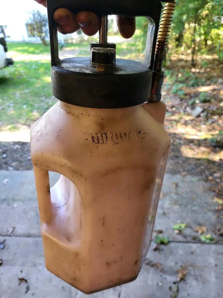

Spent some time figuring out why I had no oil pressure on the gauge. I spent the week going out to crank the motor with the plugs out and valve covers off. It's about all I had time to do. Got nowhere. I was worried I had a leak at the timing cover that was dumping pressure.
Dropped the oil and stuck an endoscope up there. The chain drive oil pump was turning. I know the roll pin was in and held in with the proper flanged bolt.
Pulled the oil filter and it was full up into the housing with oil. Suggested the oil pump was working. Pulled the housing and verified the oil was pumping into the filter housing. The pump was primed just fine.
Threaded a barbed fitting into the oil filter housing with a chunk of heater hose over the oil ports. Used my Mighty vac pump that I bought for tundra transmission fluid to pump fluid under pressure up into the distribution system. No oil to the cams. When the pump ran dry I heard the gurgle from the front cover. Pulled the two plugs out of the timing cover. Oil was coming out of the threaded hole behind the top plug. Checked the other engine. Pulled the oil pressure regulator out of that one and installed it into the one in the car. A few cranks later and oil was coming out of the cam oilers tube.

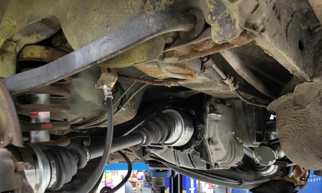

One of the CV boots was leaking old ass grease juice from the cracks in the CV boots, so I replaced the shafts. Cleaned up the diff. New axle seals. Kinda crazy how they come apart. POR-15 on the cast iron housing. Clear on the aluminum cover.

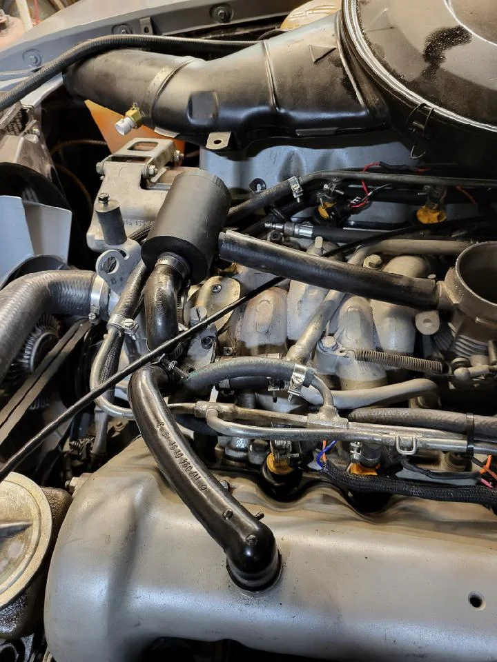

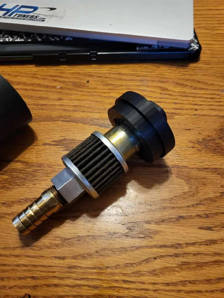

I had used a idle air control valve from car depot. I don't know it was the best choice, but it worked. I wanted to use a GM stepper motor that I was familiar with and would always be able to get.

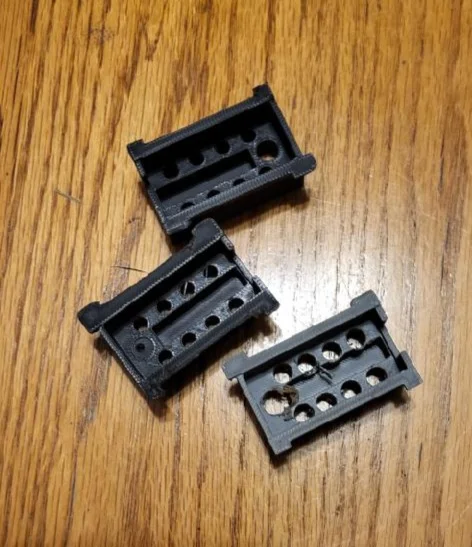

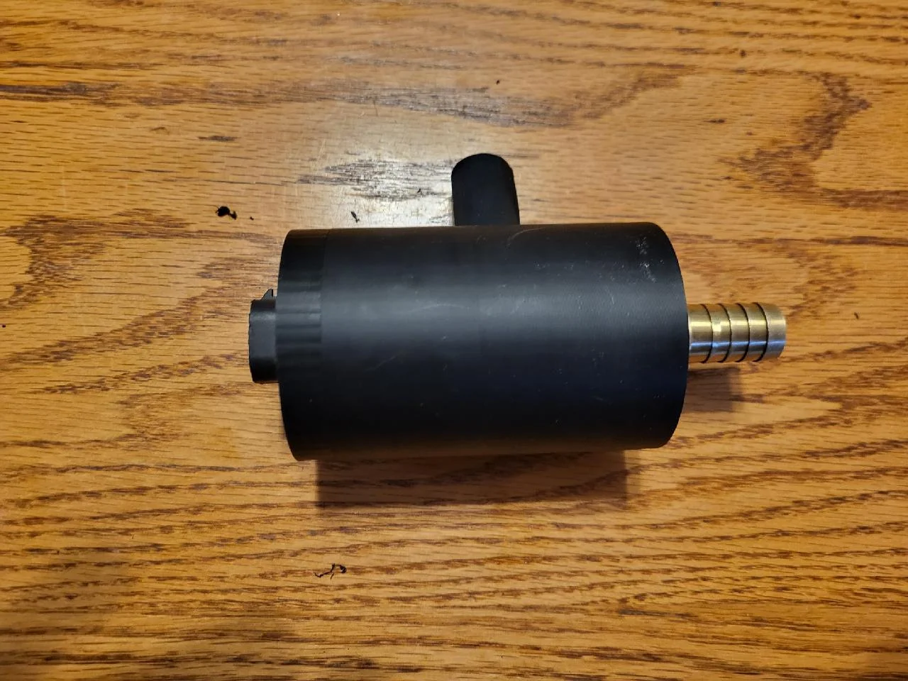

I recently bought a 3d printer. A Bambu Labs X1C. I bought it to print car parts. The Lincoln needs a driver armrest. The Benz needs the center console support stuff rebuilt. Unobtainable stuff. Like 1st gen skinner A pillar hard to get. Now, theoretically, I can print all that stuff, although I think I'd need a scan of the pillar trim.
My first car part I've built from a blank screen on FreeCAD is a cover for the IAC filter. Maybe one more version to tweak it. Version 1.3 works pretty good. 1.4 will have a different angle on the filtered air tube and will be out of PLA-CF. The hiss from the IAC is gone. The little filter should stay way cleaner, or I could print a spacer to eliminate the filter.
Re-printed the IAC cover to fit under the air filter. Ordered a curvy hose to reposition it.

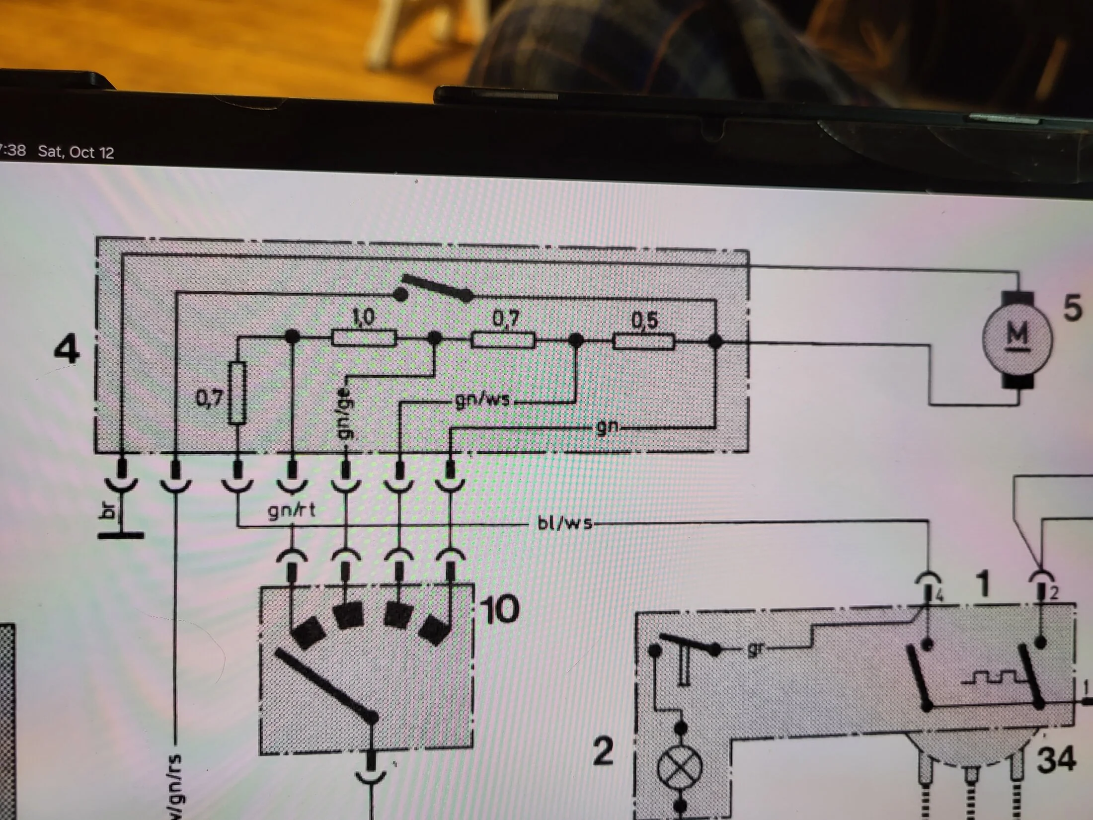

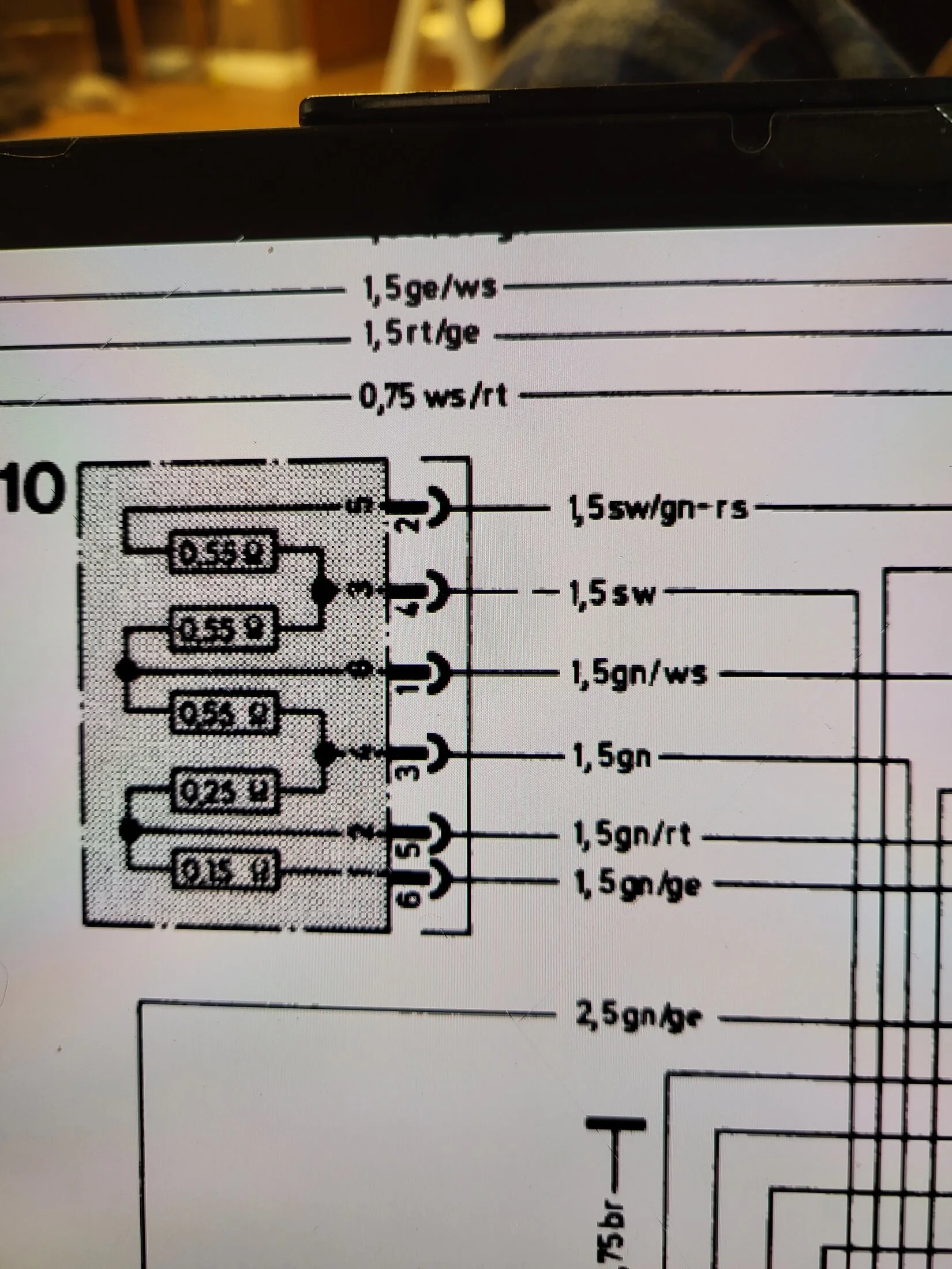

I had to make a new harness from the blower switch to the blower resistor and blower motor, but I am blowing warm air through the defrost vents now. A ride for ice cream in 50 degree weather let us try it out. It worked well with the top and windows down, windows up and top up as the drive took longer than expected and included some rain.
Today's math problem - how to get roughly the same resistance from the 2 resistor blocks. The goal is to use switch 10 with resistor block 10 to run motor 5 at more or less the same 4 speeds.

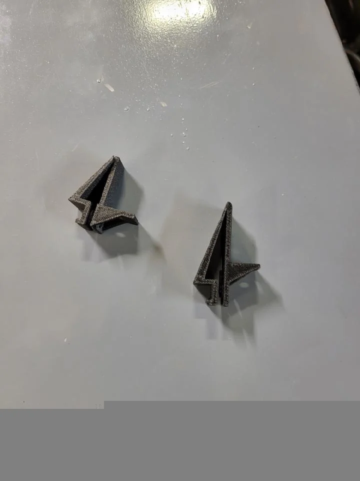

Both grille spears have now broken off. Another 3d printer project.
Print 8 was the magic number for the plug that worked. It's pretty nice to get it to a point and then print a copy. Then modify as needed. It fits tight to the resistor block with just enough clearance for the pins. The OEM cap snaps on.

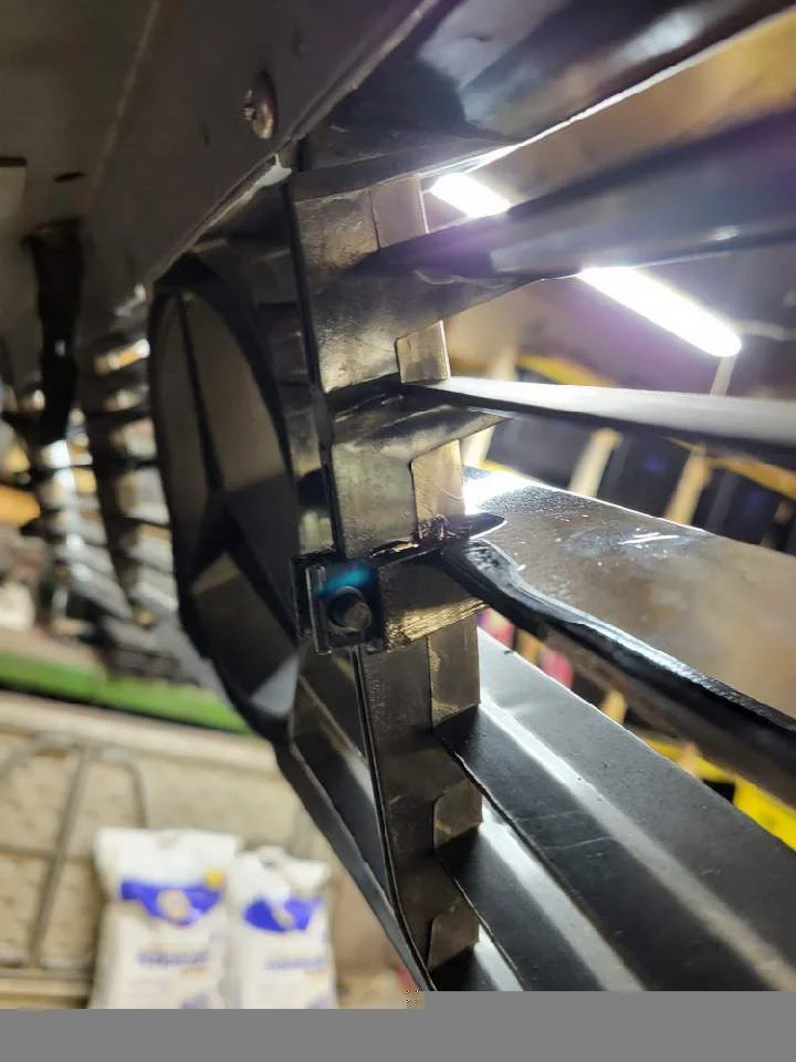

I also had to fix the tabs on the grille. The aftermarket grille had broken off three of the four tabs that hold the chrome plated metal spears. I looked at the OEM one I had. It had broken tabs as well and a broken slat as well. Gluing new tabs on wasn't enough. I made parts that wrap around the uprights, bolt together and were strong enough. I glued them before clamping them down.
