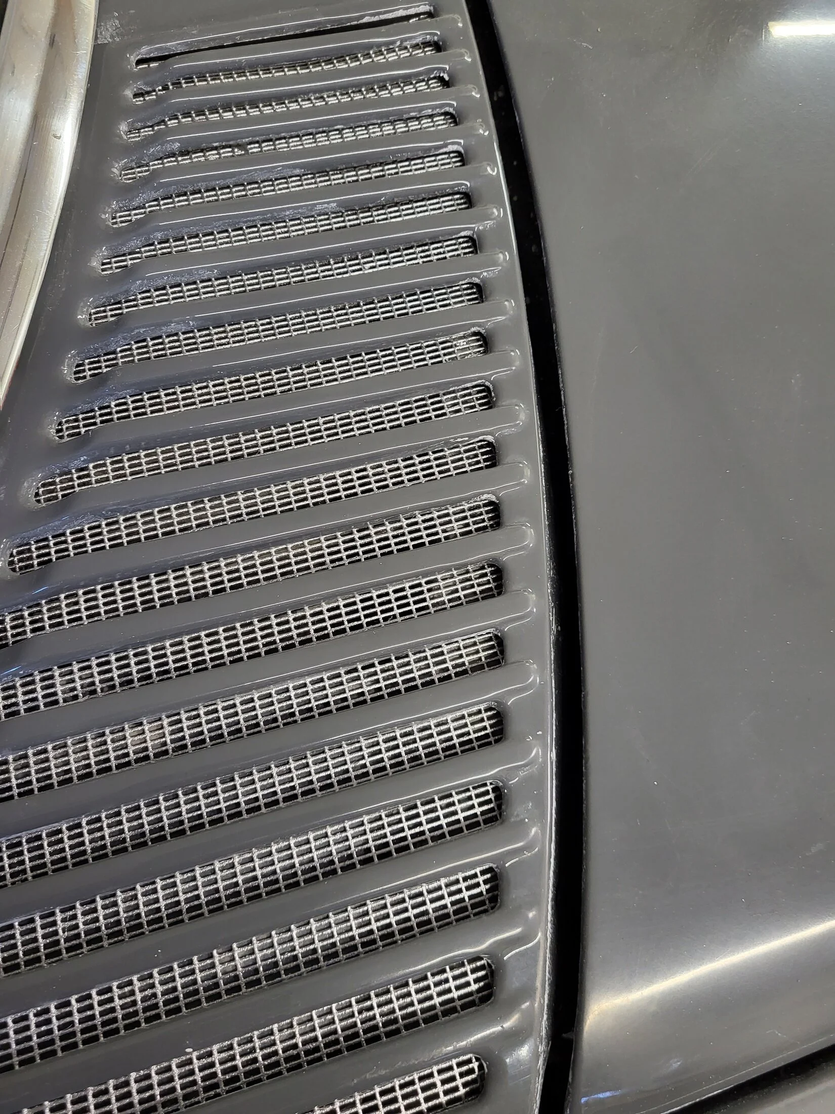

Vent grills were painted black on the green car and oversprayed red on the 78. The 72 still has the factory rivets in the grills. They are silver on that car so I painted them silver and will rivit them in place as soon as I source some 6mm rivits. Letting the tonneau cover vinyl rest in the sun. I have a new cover someplace.

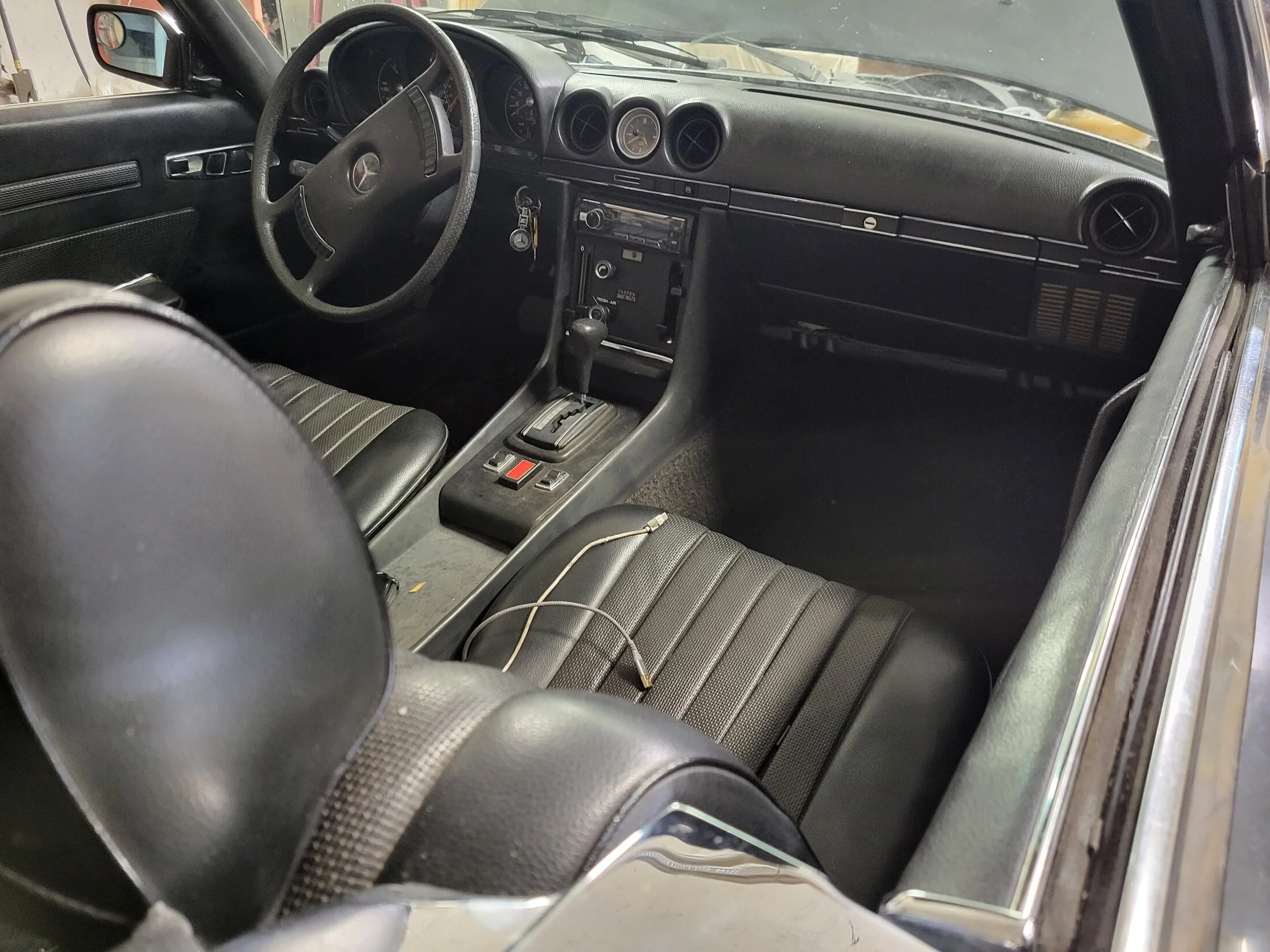

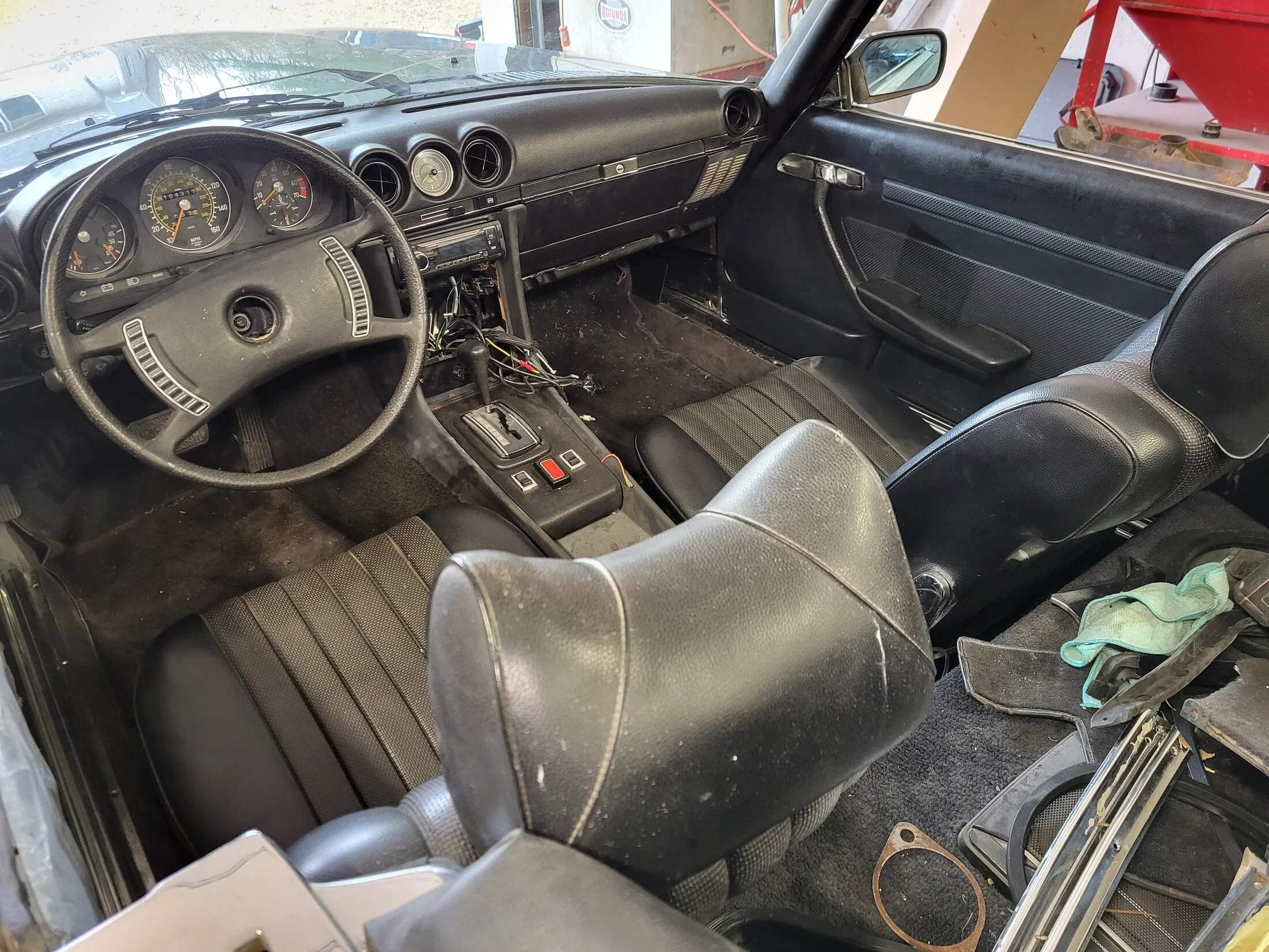

Got a lot of little stuff put back on. Dash and center console are all in with a lot of HVAC stuff to hook up yet. Right door panel is all on. A pillar trim on. That sucked. Trim under the headlights and under the rear bumper are all painted. Getting pretty close.

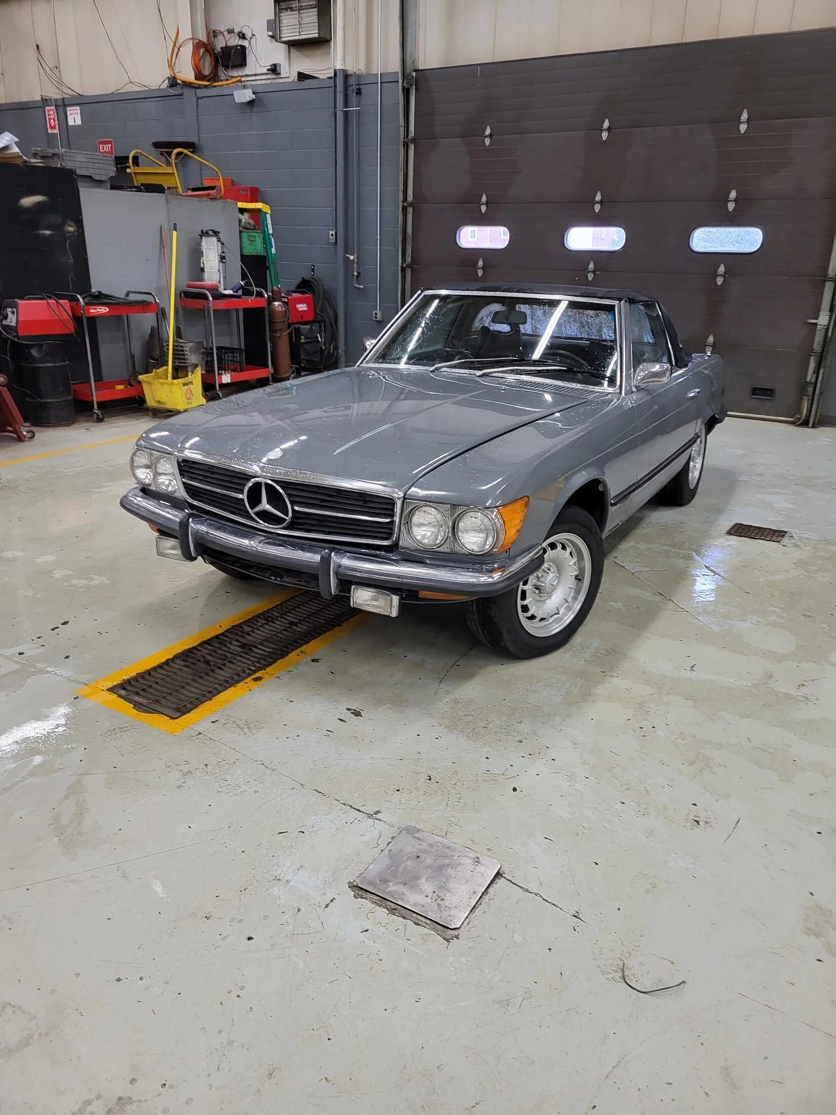

Busy weekend on R107s.

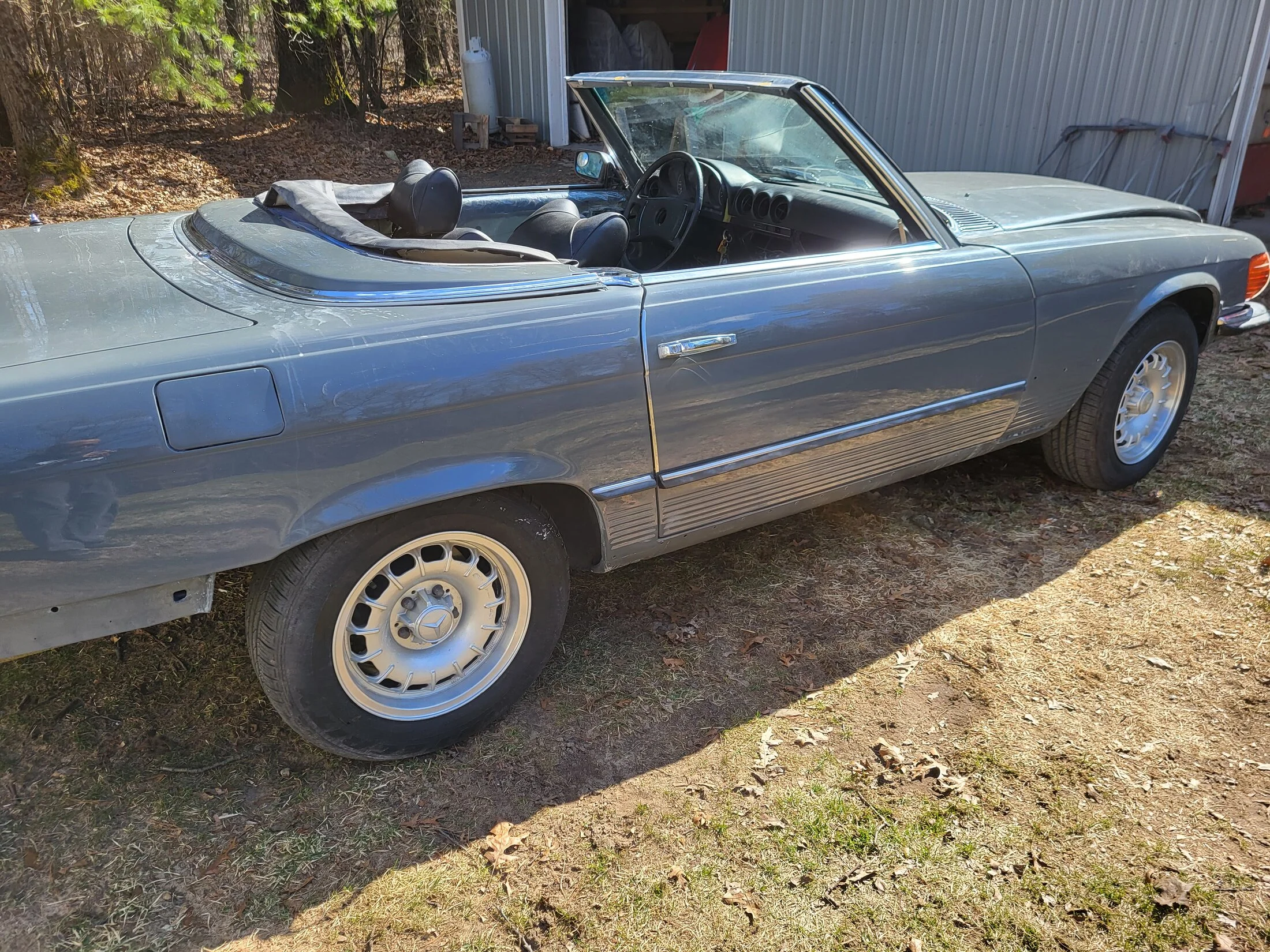

The 78 is about done. It's been almost entirely converted to an early model. 72 interior is all in. 73 HVAC conversion is done. 78 HVAC is in the bin as should happen with chrysler parts. Most anything identifiable as late 450 is gone.
I saved enough 73 parts that the 72 can live on, I think. It'll be an unfinished driver if it can be done cheaply. Maybe always with the hardtop

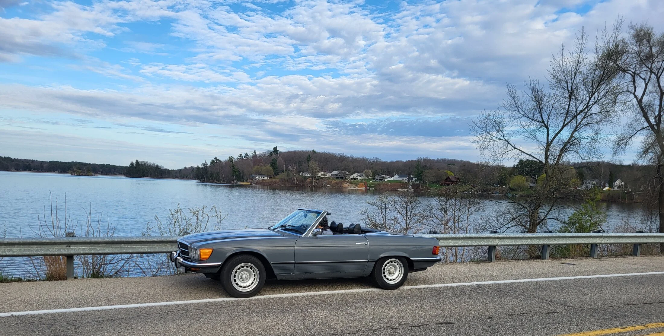

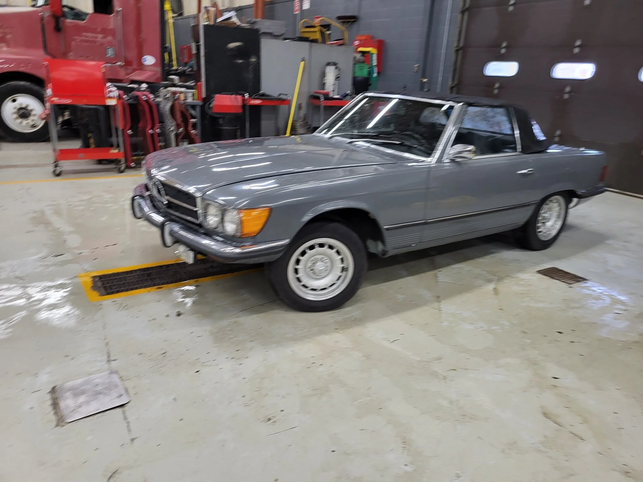

1st day driving it to work again. 40 miles each way. Hope it's not too much of an adventure.
New Project Binky!
It's making me think bad, bad thoughts about my center vent clock to be converted to an analog AFR gauge. Maybe not taking two years to do it though.
Been driving the car daily. About 200 miles. 10.5 mpg, about the same as the Tundra towing the trailer with the 450 on it.
Haggerty got the insurance. Best coverage for the best price. They did me right when I crashed the 45. They even sourced the parts. And they're right up the road. I'm not sure i would buy it for $25k, but that's what they say it's worth and I'm good with that.
Drives great. People dig it. Only one roadside repair during Mondays 50 degree morning commute with the top down. Windows up and heat on full blast because I just got the blower switch re-pinned. The fuse melted to plastic slag. The filament never did blow. Chinesium plastic versions of the worst fuse design ever. I have a big box of spares in the car. Unfortunately, I took the ignition feed to the PCM relay from the left over HVAC nonsense that went into the bin. So the heater and engine quit at the same instant. Swapped in a new fuse and flipped the hoodie hood up.

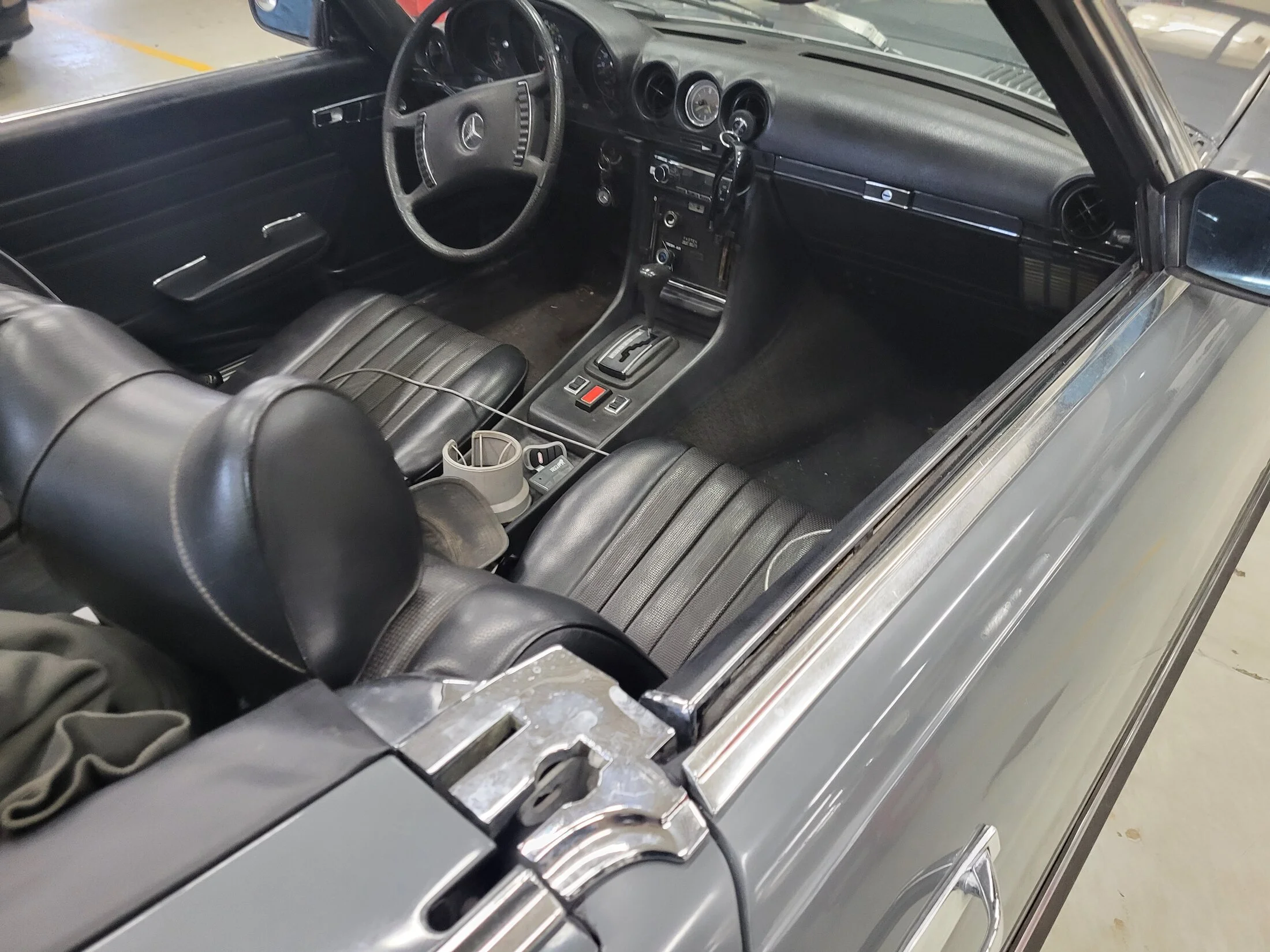

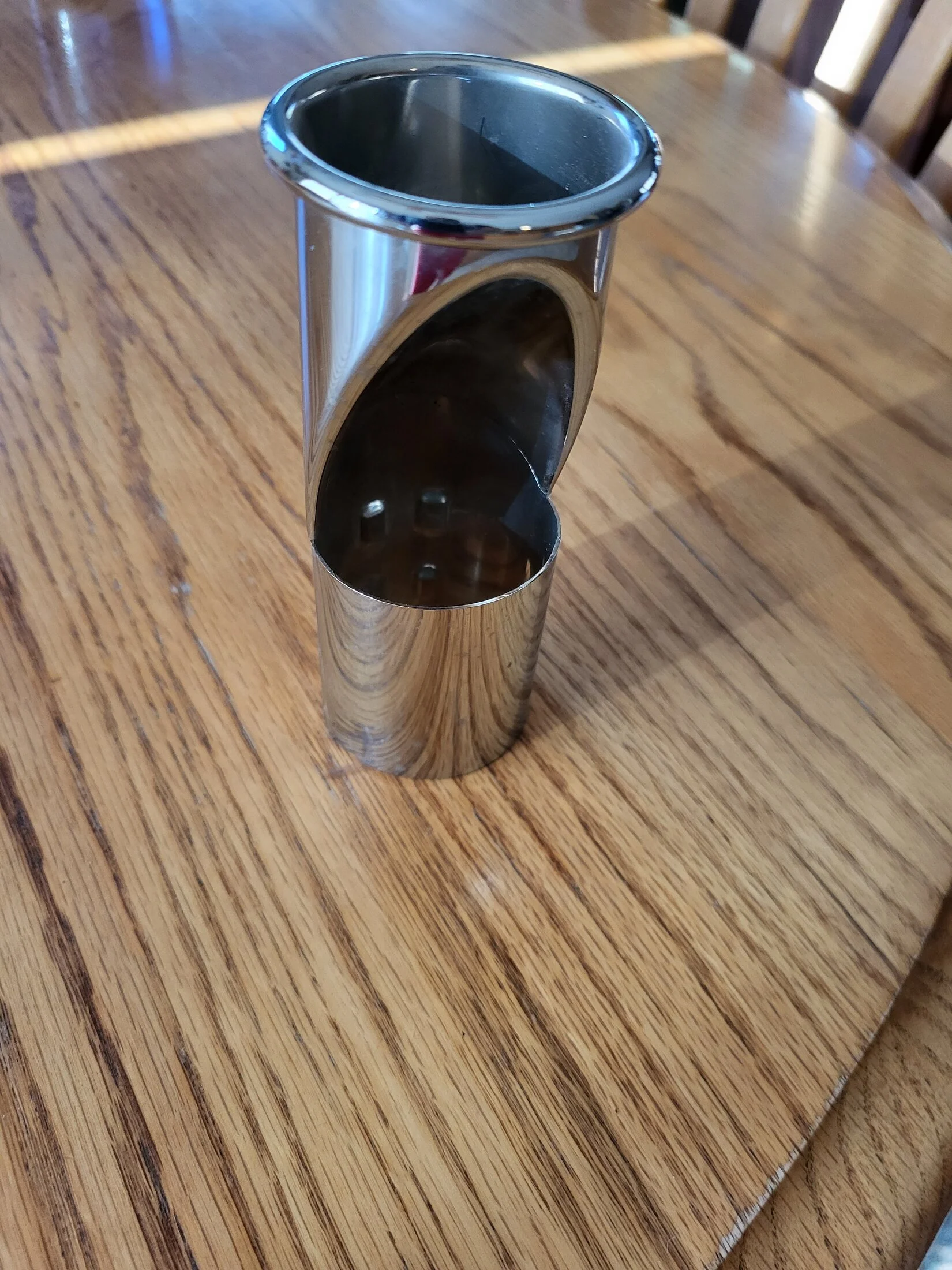

Back to the widebase cupholder. The Autozone one that fit so well with the 73 seats will not fit with 72 seats as the tilt knob is on the inside. Writing that makes me wonder if the seat backs can be swapped so the knobs and rear access levers can both be on the outside. I miss the awful looking center arm rest from the 78 seats.

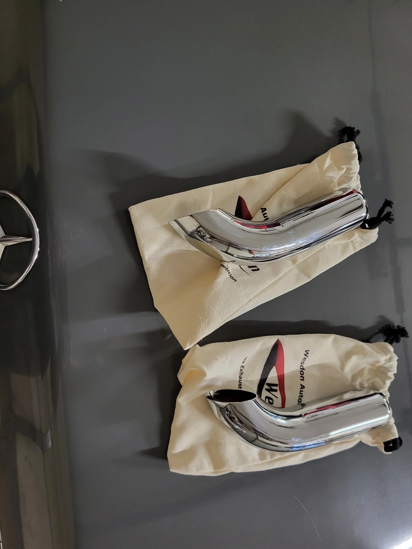

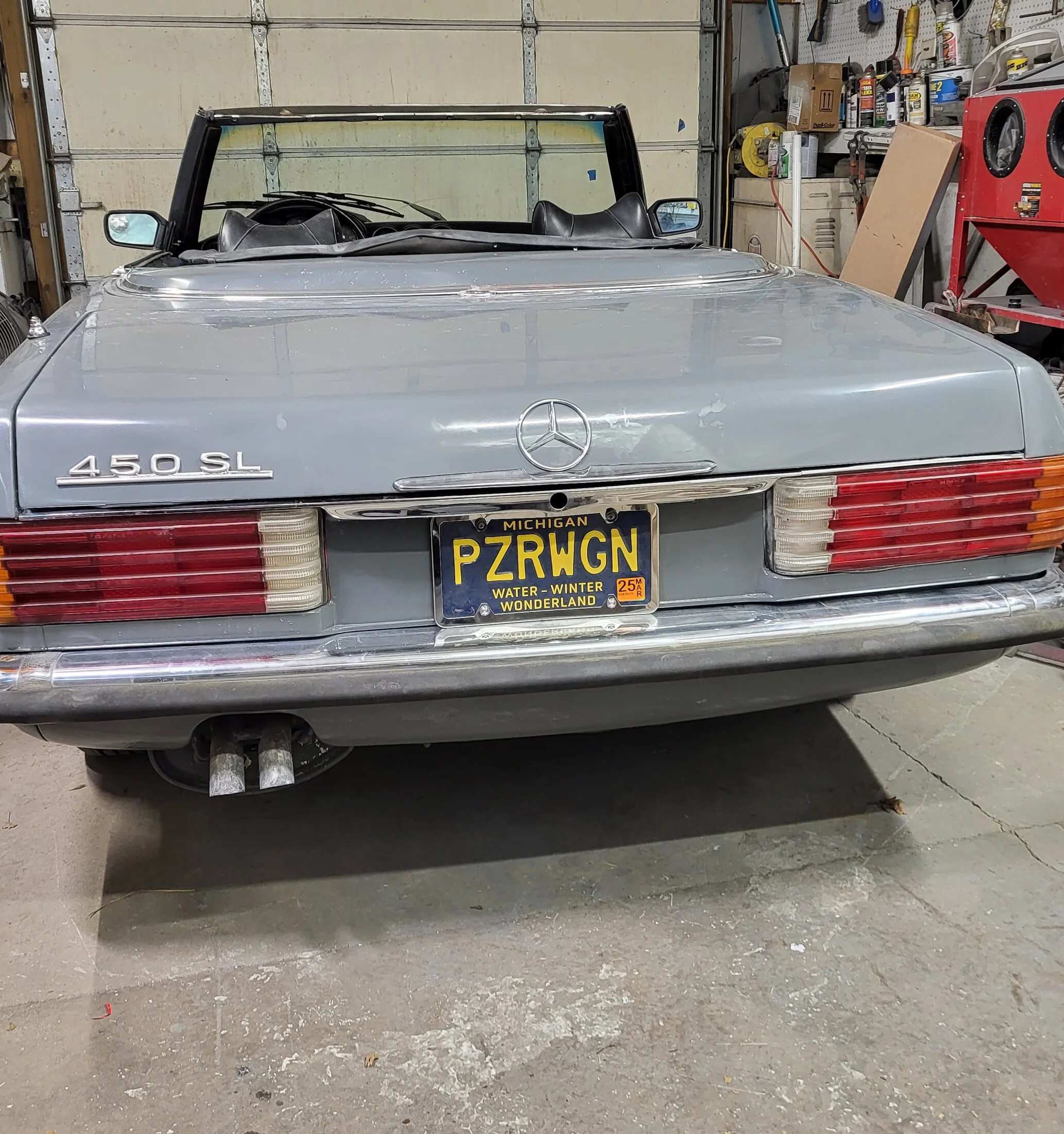

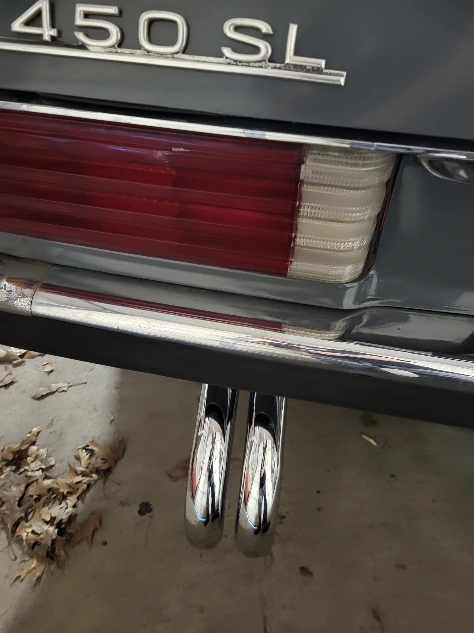

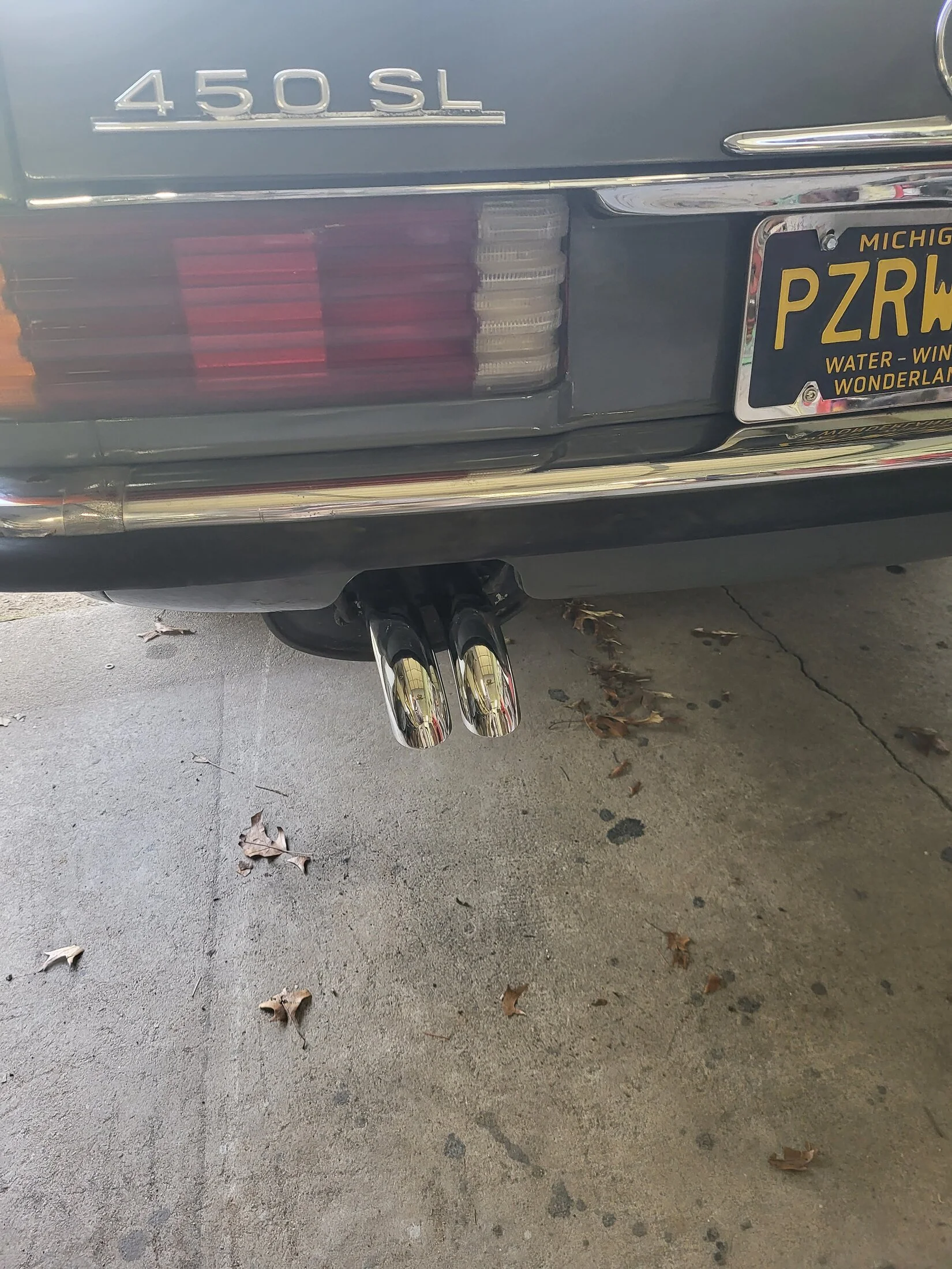

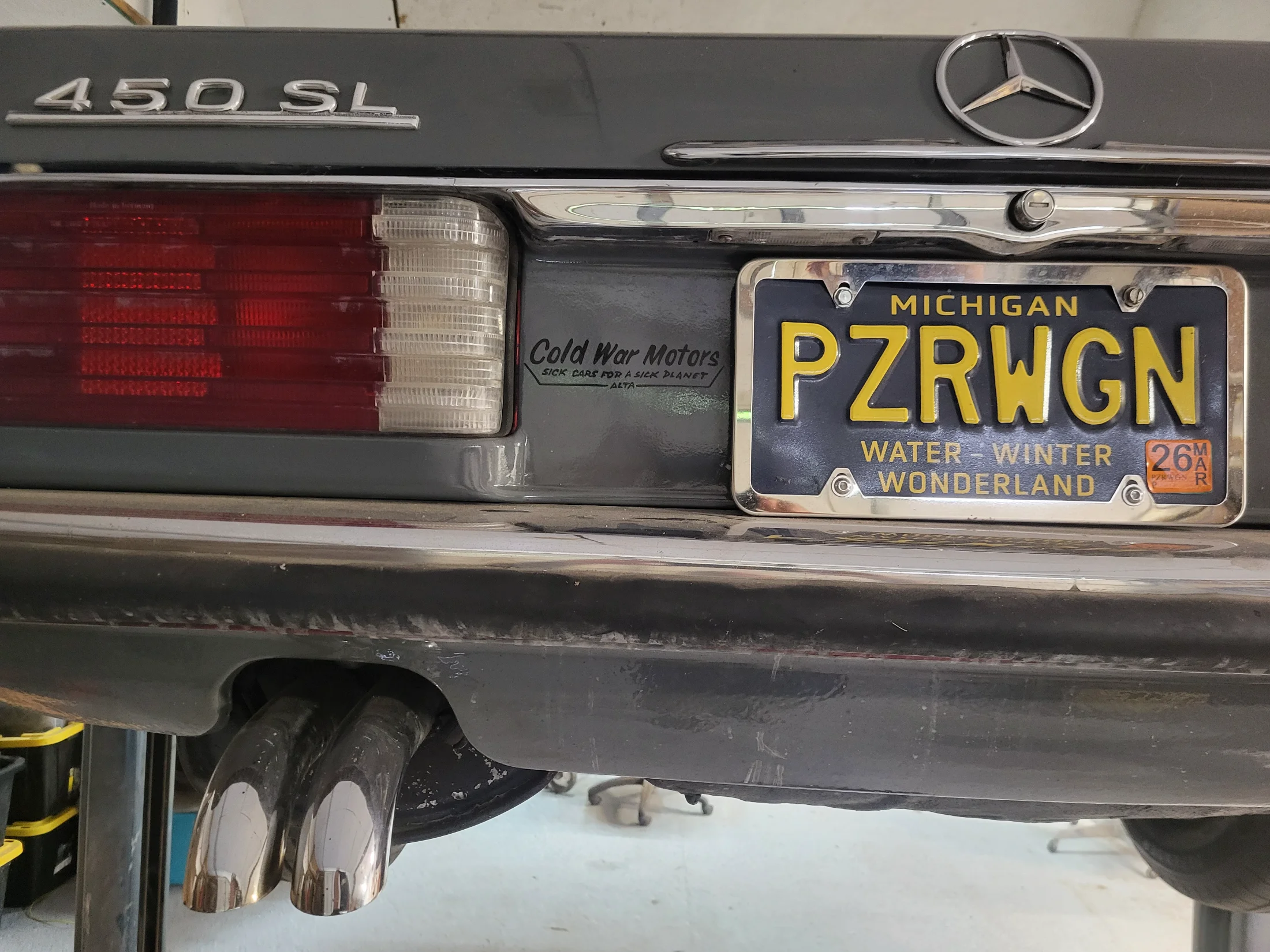

Fixed the exhaust leak which made it sound better and run better without a huge air leak north of the wideband. New exhaust tips came in. Gonna have to fab a mount to get them tucked in nice.

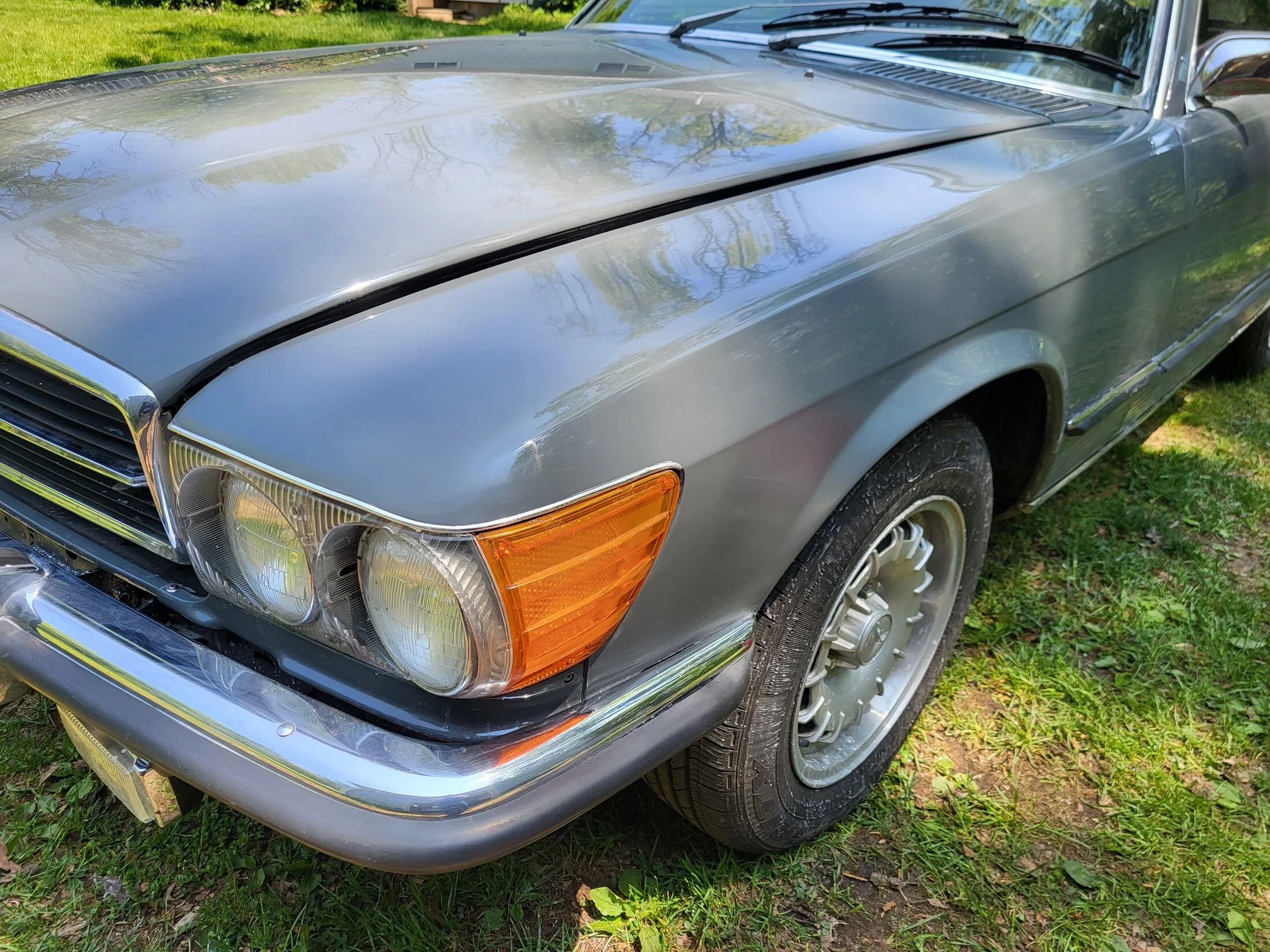

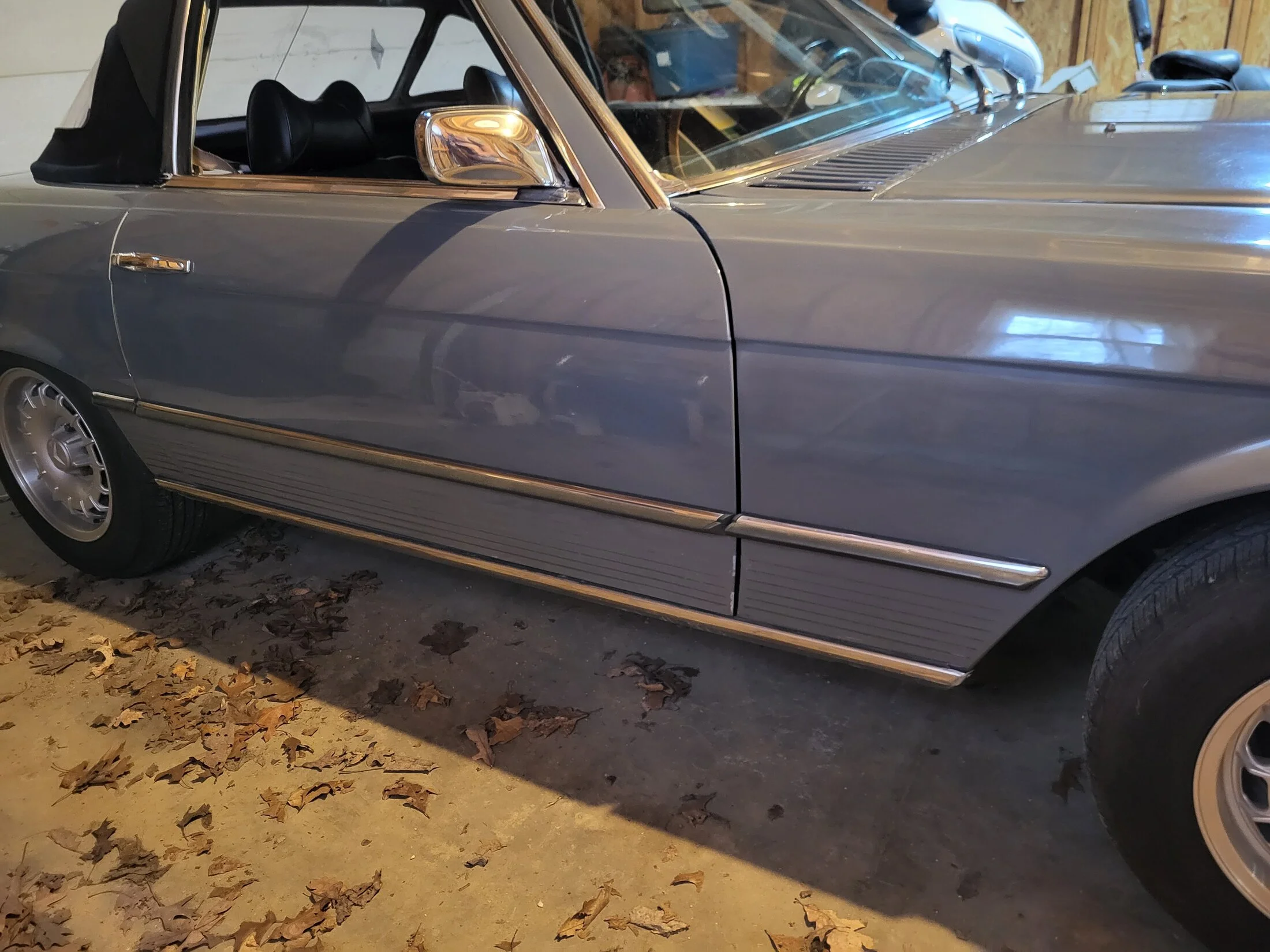

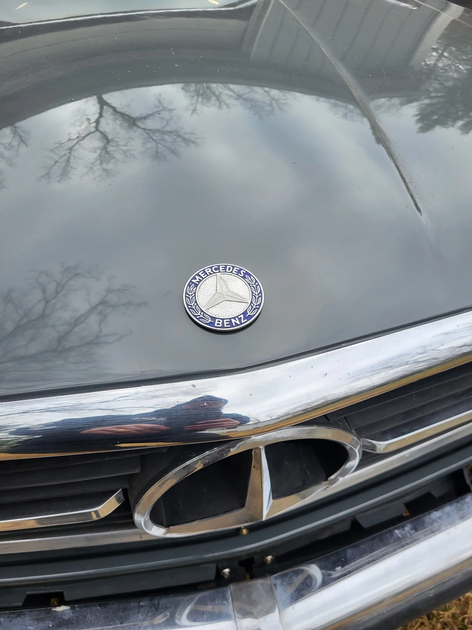

Exhaust tips, headlight brow and cleaned and sealed top. Decided to throw on the rocker trim and not do Raptor liner, although I have to do something to replace the stone chip guard I ground out where i had to patch the rocker. Thinking about replacing the pinstrip on the beltline.

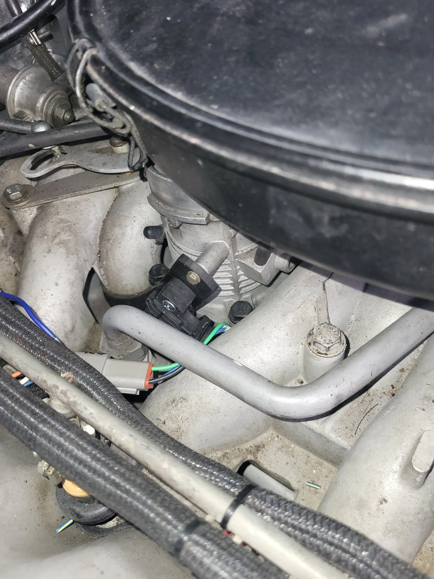

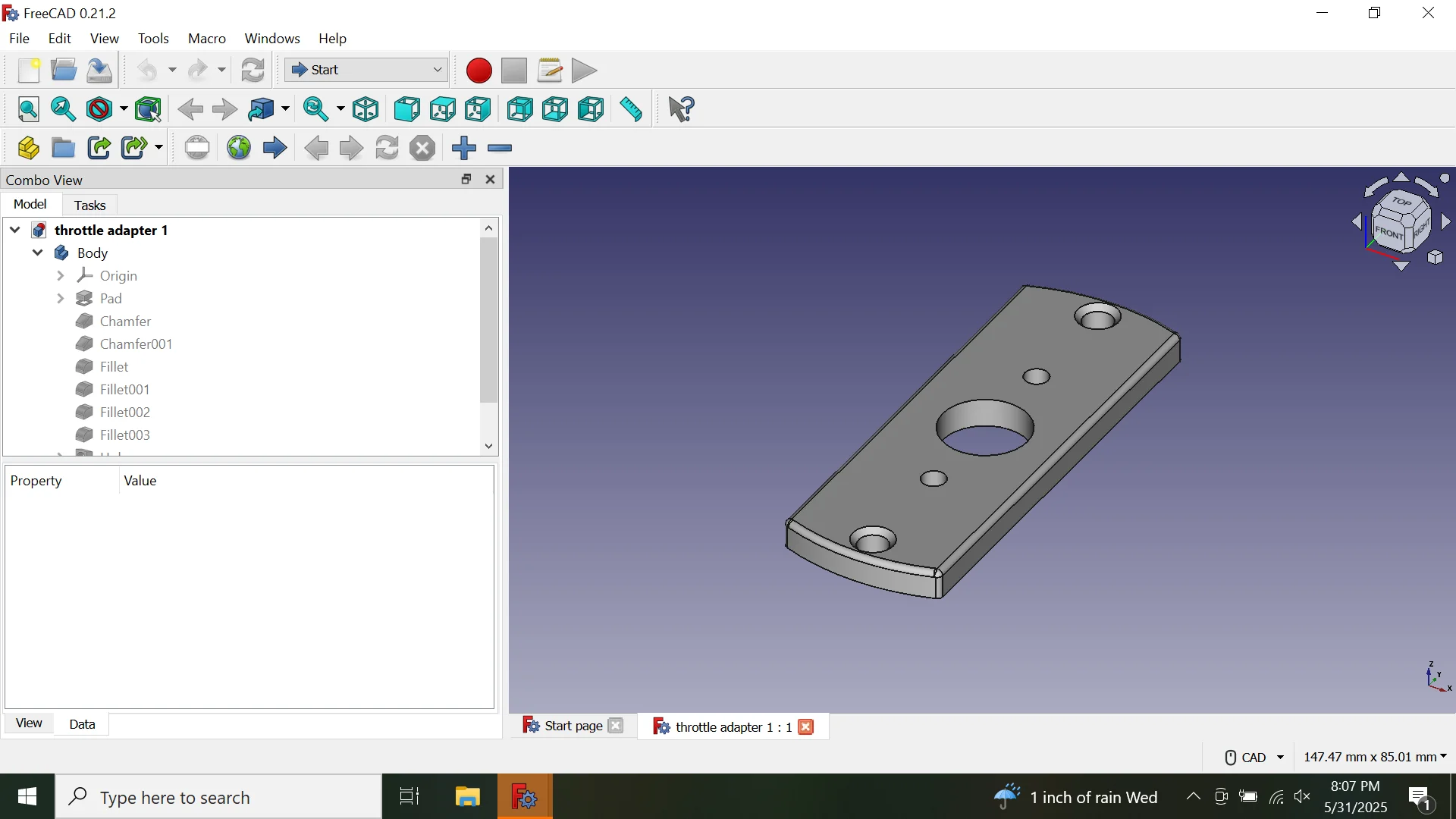

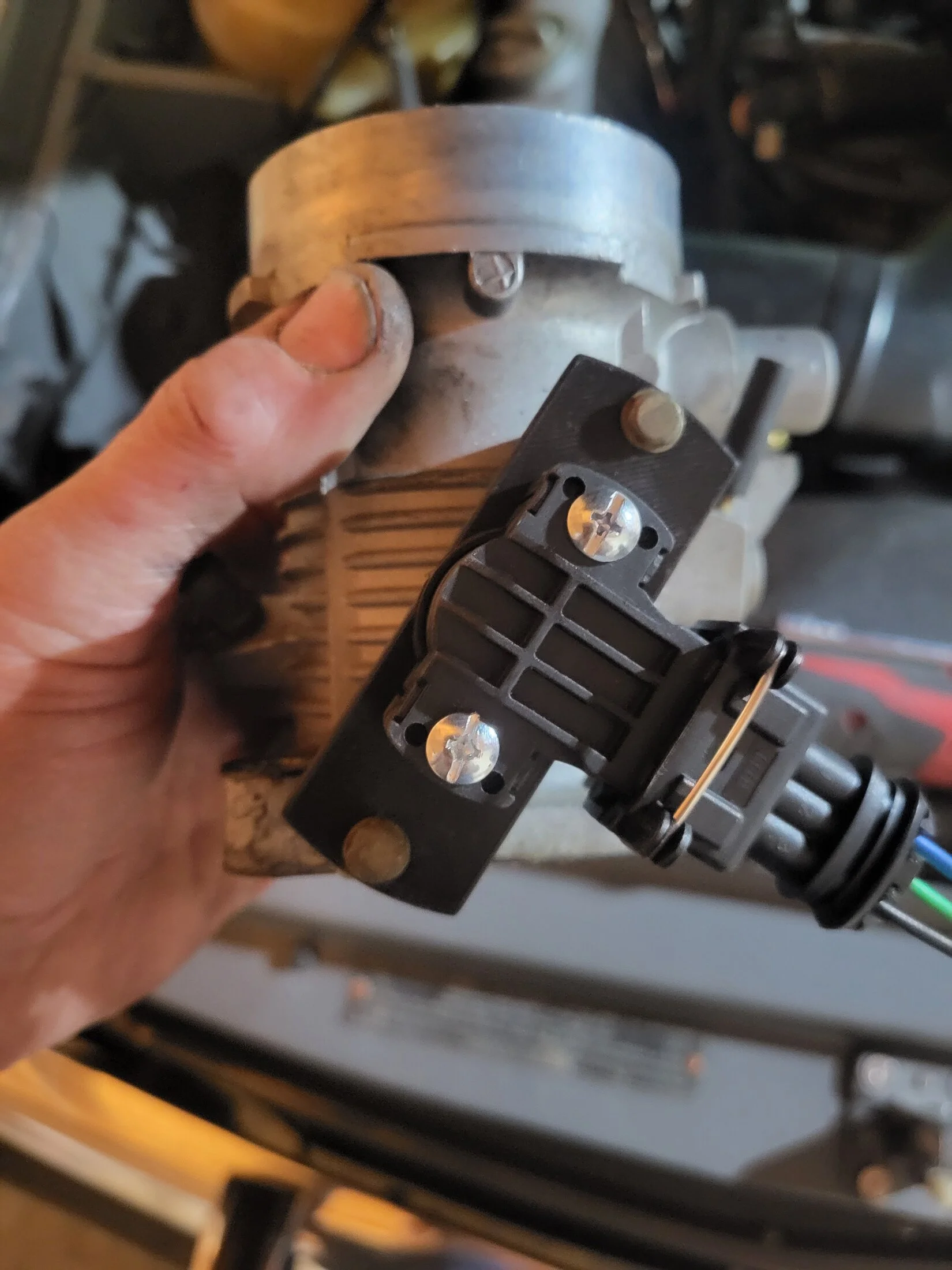

I thought my mercury Capri tps had died. I didn't like using a part that was old and completely unavailable, even if it fit as a bolt on. I went with a Bosch TPS found on BMWs. Part number 13631726591. Easy to find a pigtail for it too. It uses a 3-wire EV1 connector.
Took no time to draw up and print a 5mm thick adapter plate. The E30 TPS has the same 8mm half moon socket for the throttle shaft. I cut the end of the shaft down as the new TPS sits a lot closer. I printed threads for the TPS bolts. Worked great. If they don't hold up, they make threaded inserts that go into PLA plastic when heated with a soldering iron. I can try that. Turns out when wiring it up I found the sensor wire was broken. The angle it has to sit at makes the EV1 connector impossible to get to without removing the throttle body, so I installed a Deutch connector.

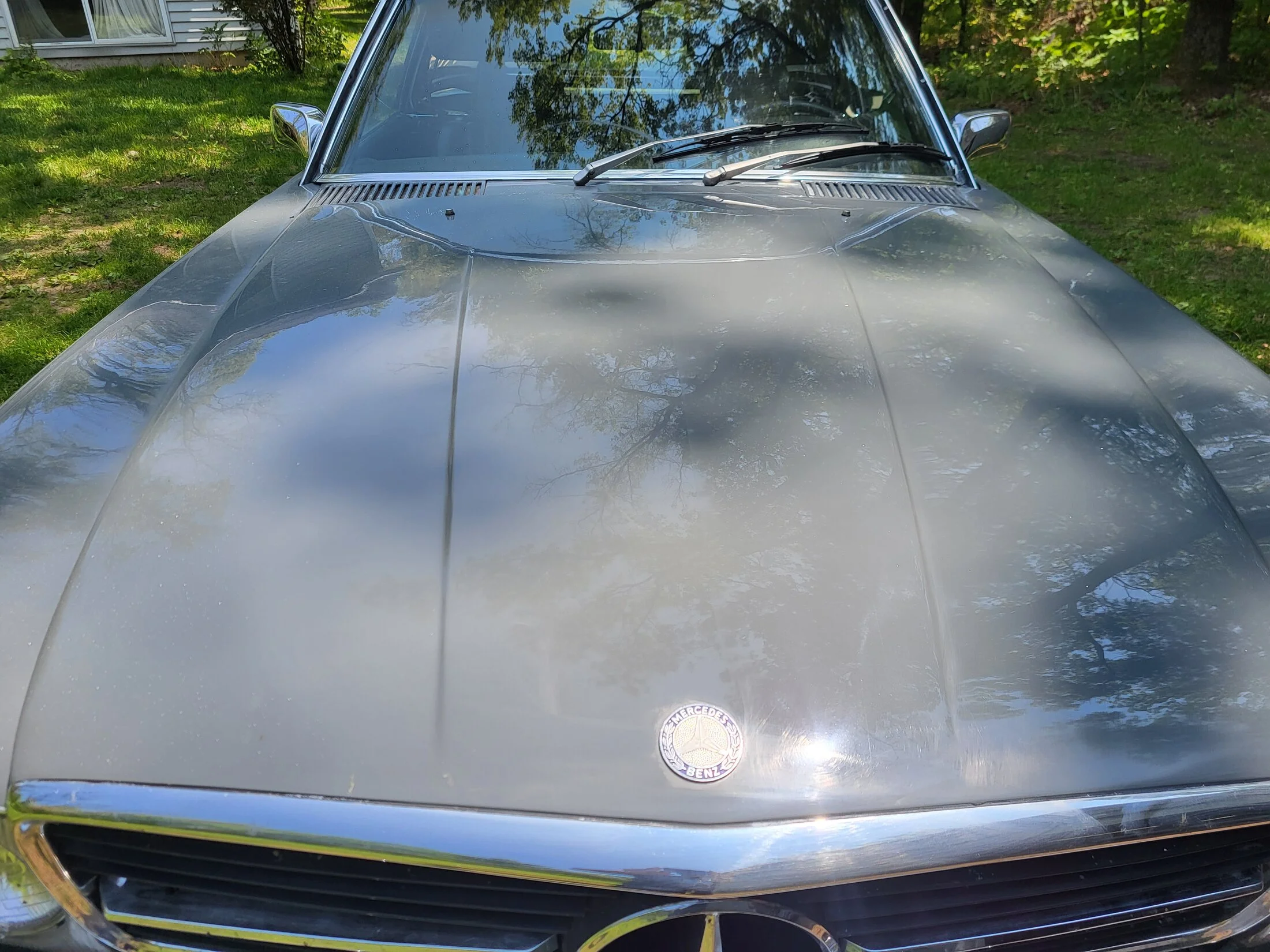

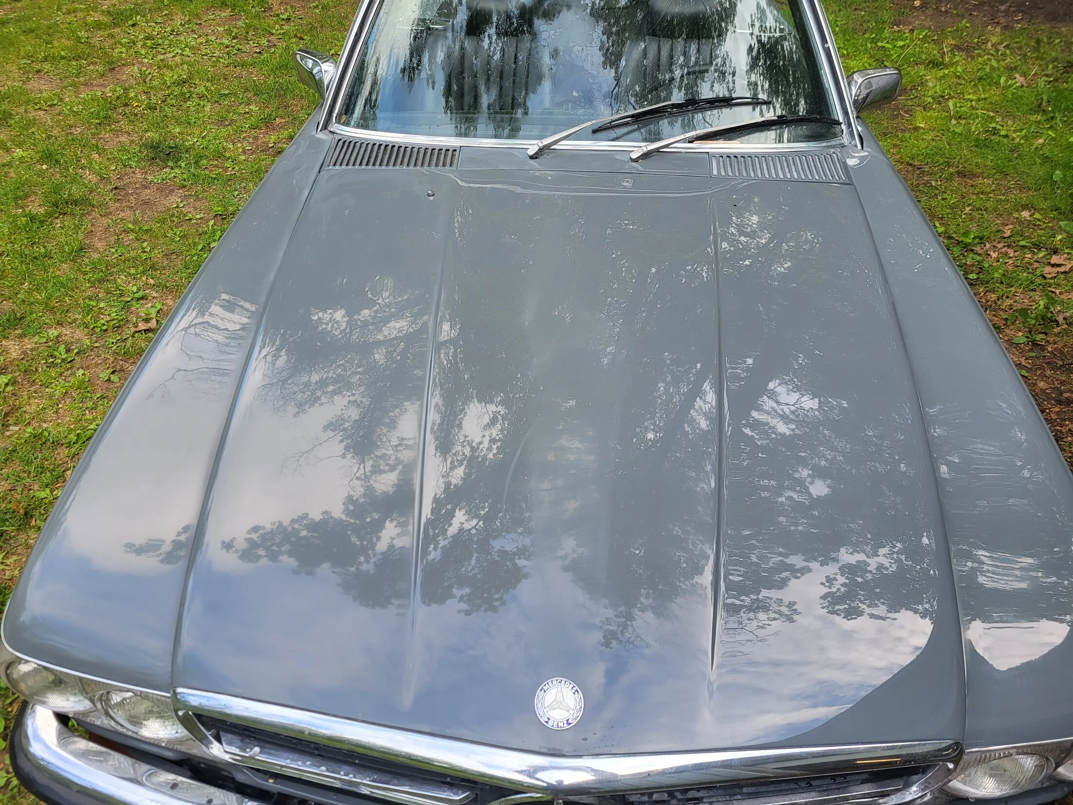

Started a second try at a cut and buff. I wasn't happy with the first try. Too many swirl marks and I was timid with the DA near edges. Blocked it by hand this time. Duke and Ralphie helped.

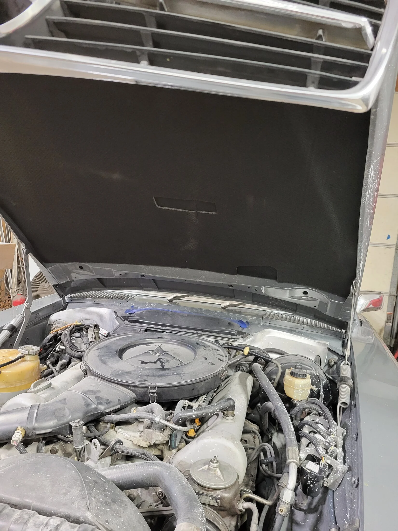

Fuel injection rails 1.0 isn't gonna work, but i learned a lot. Got some new, better blank fuel rail extrusion and the right drill bit to put all the right profiles in the injector holes. In the meantime I replaced all the rubber hoses under the hood with new manifold side seals. That fixed the AFR readings. Runs pretty flawlessly now.
Brought in the spare m117 motor to build the new fuel rails on a stand.
