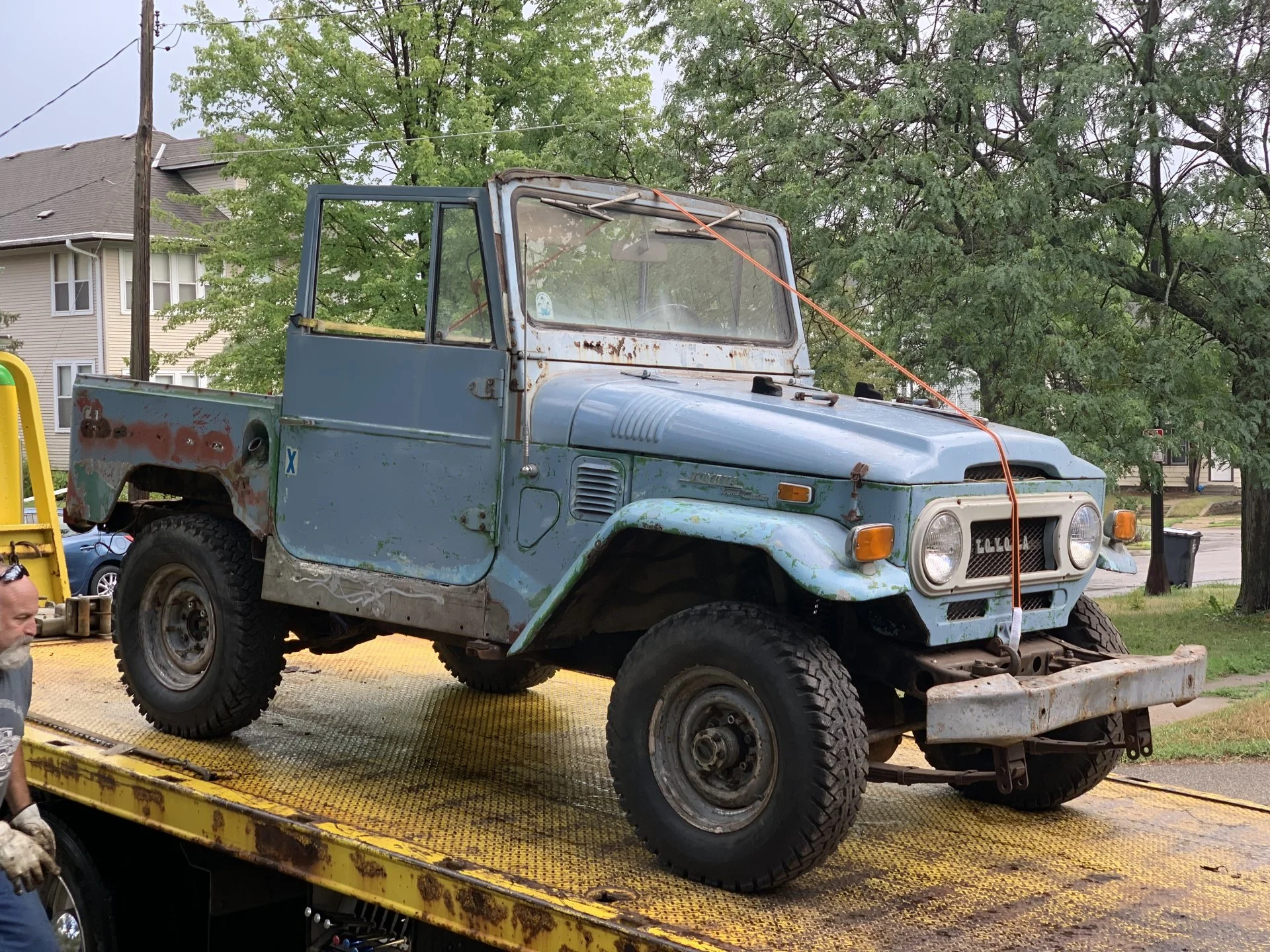

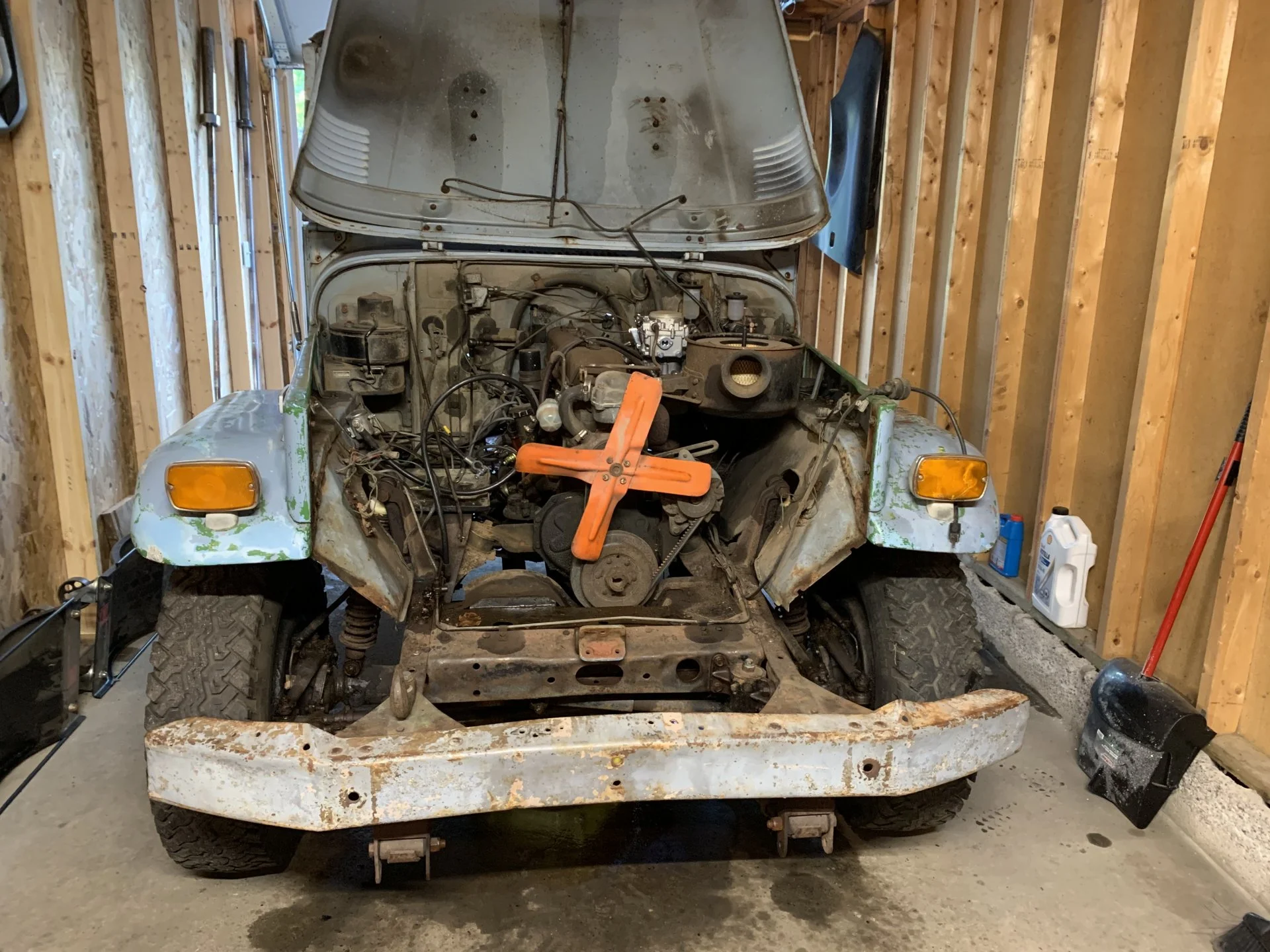

Hey all—Bought this locally from a guy who wasn’t able to complete. Rough but quite original and everything appears to be included, some assembly required. Also came with almost all the needed sheet metal and was a running/driving truck when torn down.
Goal is to put it back on the road in solid condition. Not sure how meticulous I want to be about bodywork, leaning toward keeping as much of the original paint as I can and making it a reliable driver with no further modifications.
I will need some help and likely some reminders not to try to turn this into something it isn’t.

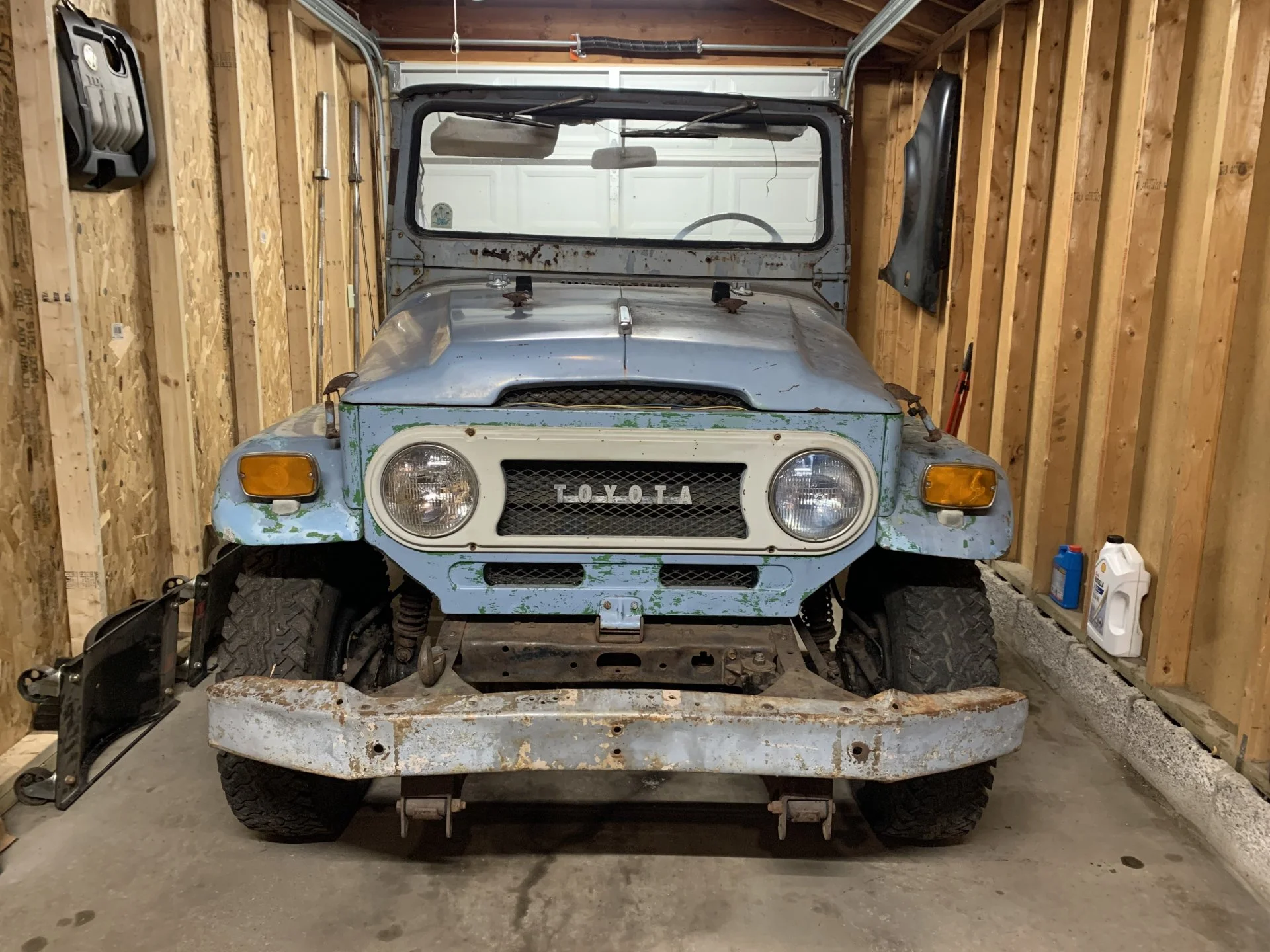

As you can see from the first post, I have the front end apart. I got the bumper off and straightened it in the bench vise. I smashed my finger between a breaker bar and the bumper removing one of the top mounting carriage bolts--it let loose on me and the bar moved at approximately light speed, stopped only by said finger and the steel edge. Haven't had anything hurt that much working on junk in a long time.
First question: what in the world is this handle on the dash? There was a plow on this at some point based on wiring remnants and a big chunk of steel bolted right behind the front spring hangers (rearward side, it looks to have been done well), plow control? What gives me some pause is that the bolts on it look like Toyota parts to me.

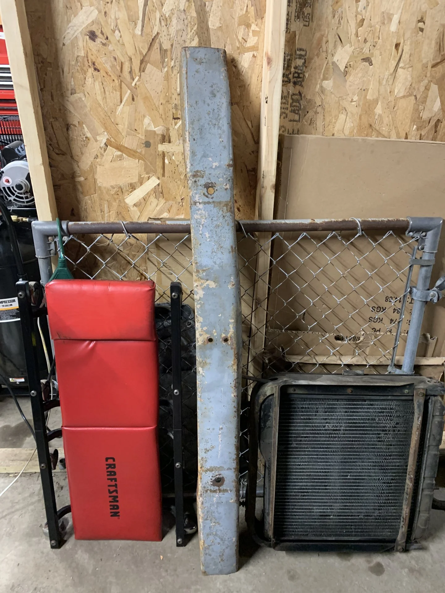

Also a shot of the straight(er) bumper and the radiator, which is in nice shape save for some bent fins which I’ll sort out later.

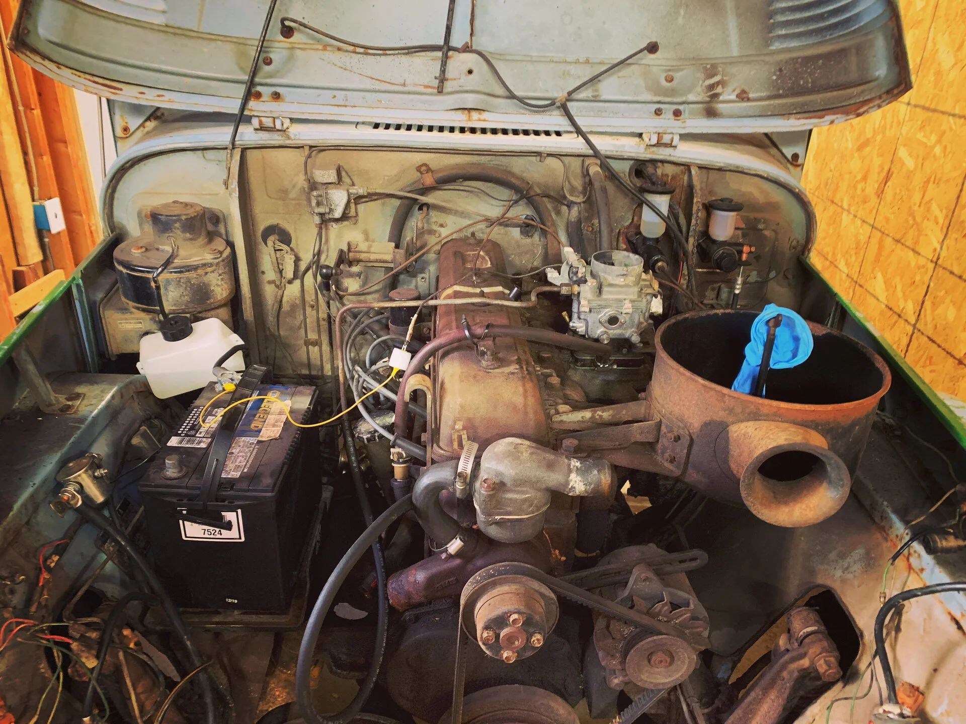

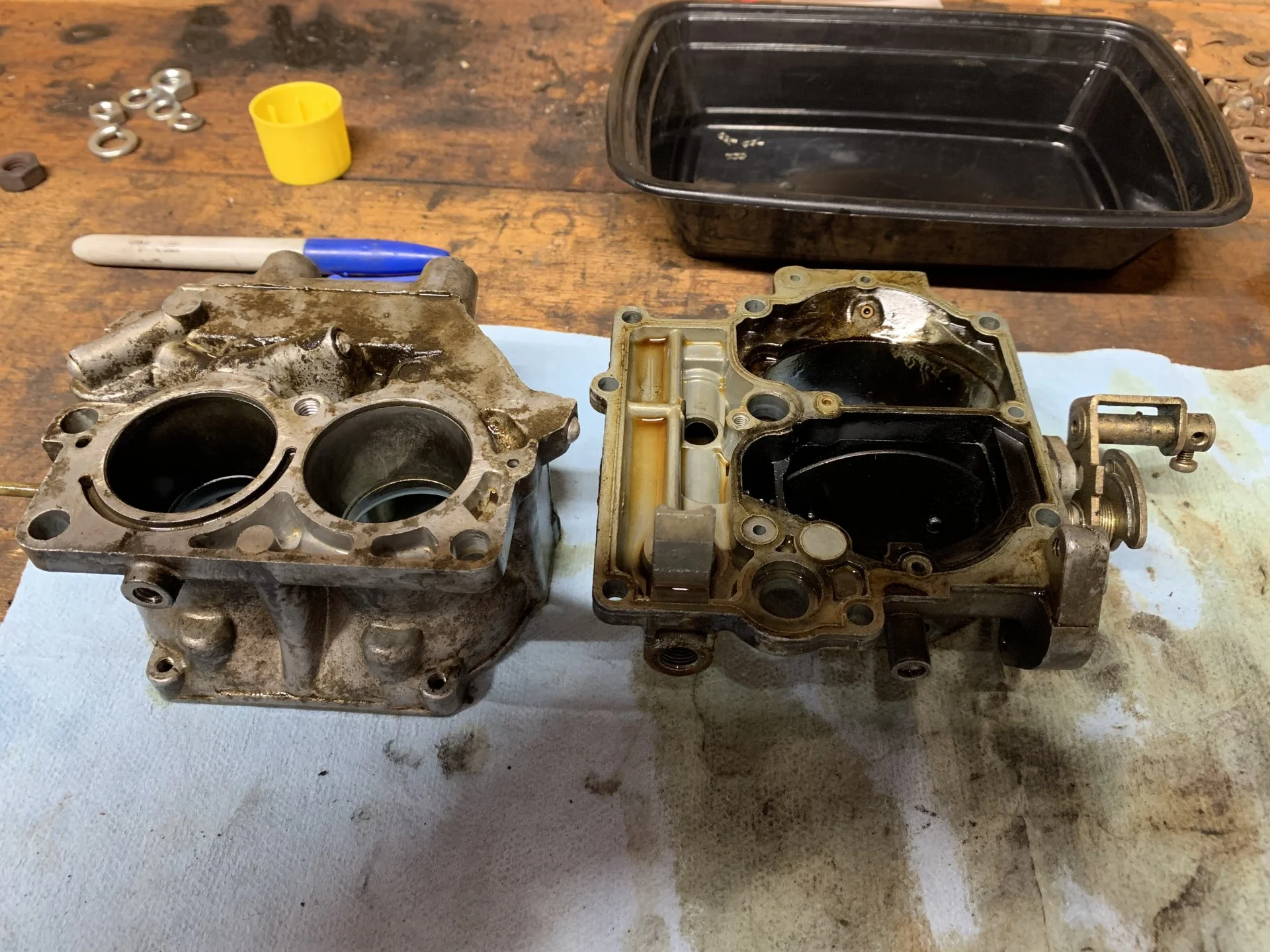

Thanks to @pardion I now have a nice and correct carb which I will start rebuilding tonight.

Rebuilt carb installed. Tiny Amazon small engine gas tank, one wire to the idle solenoid, and it runs. Pretty straightforward.

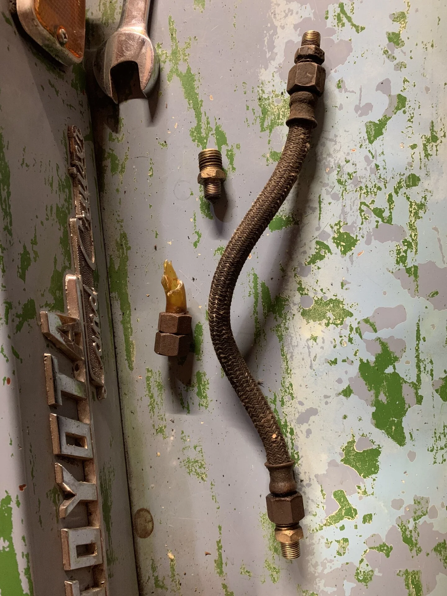

This line came off the supply side of the fuel pump. Glass filter assembly is missing. The other pieces were plumbed in with leaking runber or plastic lines (the plastic looked perhaps factory but it was yellowed and old).
I want to use rubber hose and a cheap later model filter. It appears that the larger threads on these fittings (see solo fitting in photo) match the carb fuel inlet so could be used with the Toyota collar and a ferrule and some 5/16 hardline.
How have others bypassed the glass bowl fuel filters on these old trucks?
Toyota still sells the correct fuel filter, although the glass is replaced by metal-#23300-30012. As for the brass fittings in the rubber hose, you can replace them with a barbed fitting from amazon and put on new hose with a clamp. It's a BSTP thread (I can't remember but I think it's 5/16 BSTP).
When I bought my truck, I found the previous owner just cut the hard fuel line and clamped hose to it (no flare was put in the line) and it worked fine with an aftermarket filter. I have since changed it back to OEM.
