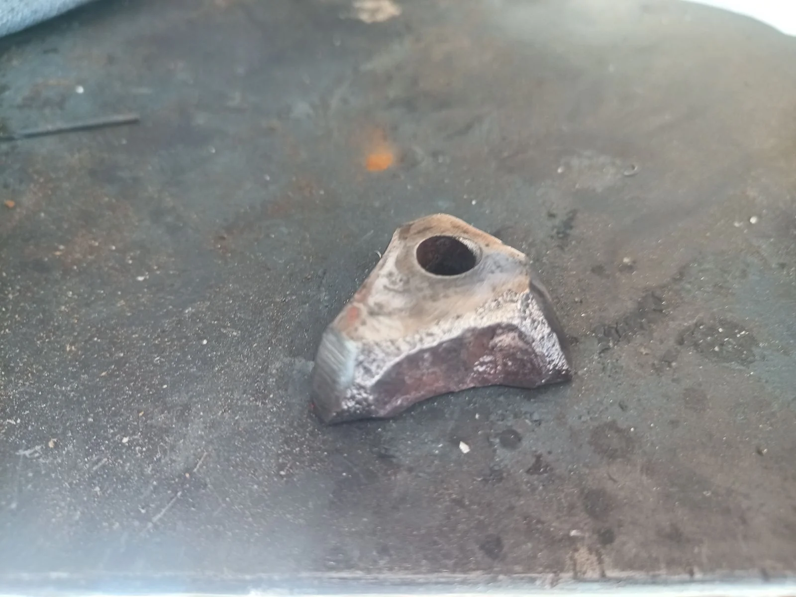

The exhaust manifold mounting flange had broken off at an obvious stress concentration.
The last thing I wanted to do was try to remove the manifold and snap off bolts, so I looked into welding and brazing. I came across something relatively new, MIG Brazing. The silicon bronze wire is a tad expensive, and it requires 100% argon, but what the hey, why not?
I cleaned up the areas to be brazed and beveled the broken flange, and then proceeded to make a boogery mess.
I built up a bit of material over numerous passes to get rid of the sharp corner that lead to the original cracking.
Mostly a success! Not the prettiest, and a little bit of exhaust still escapes between the manifold flange and the downpipe flange where I couldn't get the gun, but it no longer does the pop pop!

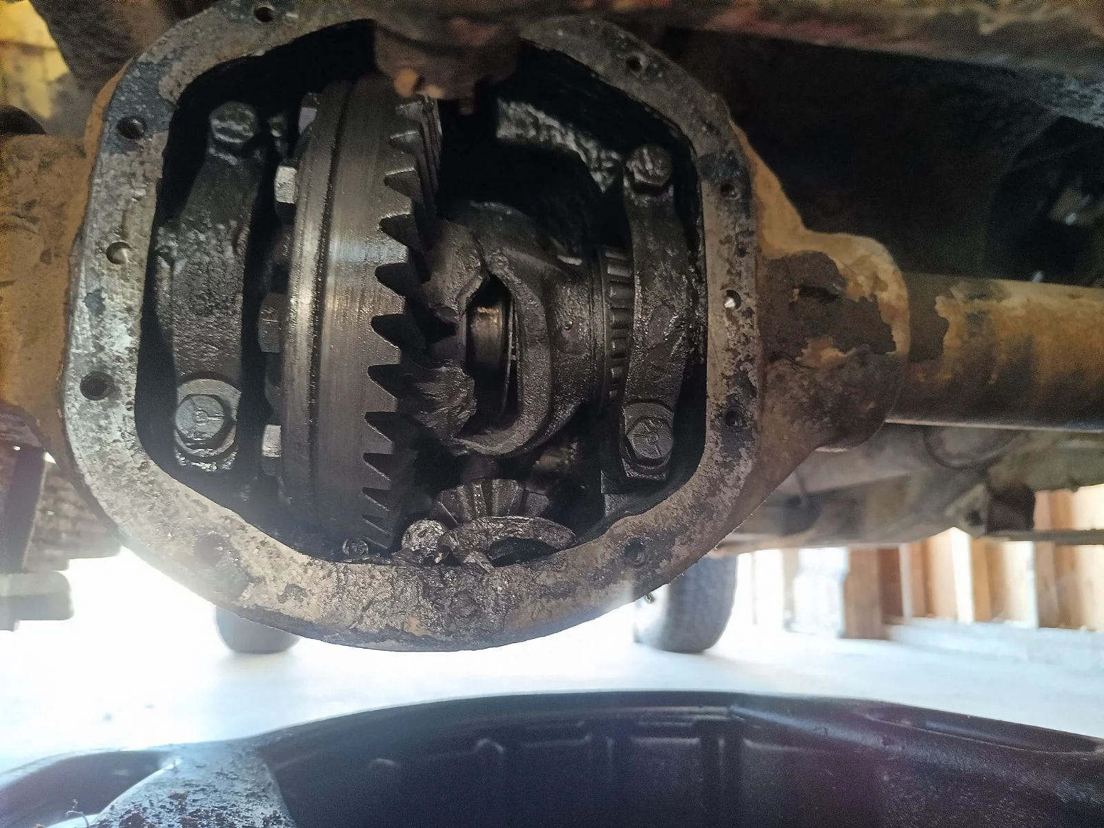

Turns out people saying the Dana 30 is weak are right. It looks like this was done long ago, as it was bone dry.
It also looks like someone had taken off the cover and seen this damage before, as there was only remnants of gasket material.

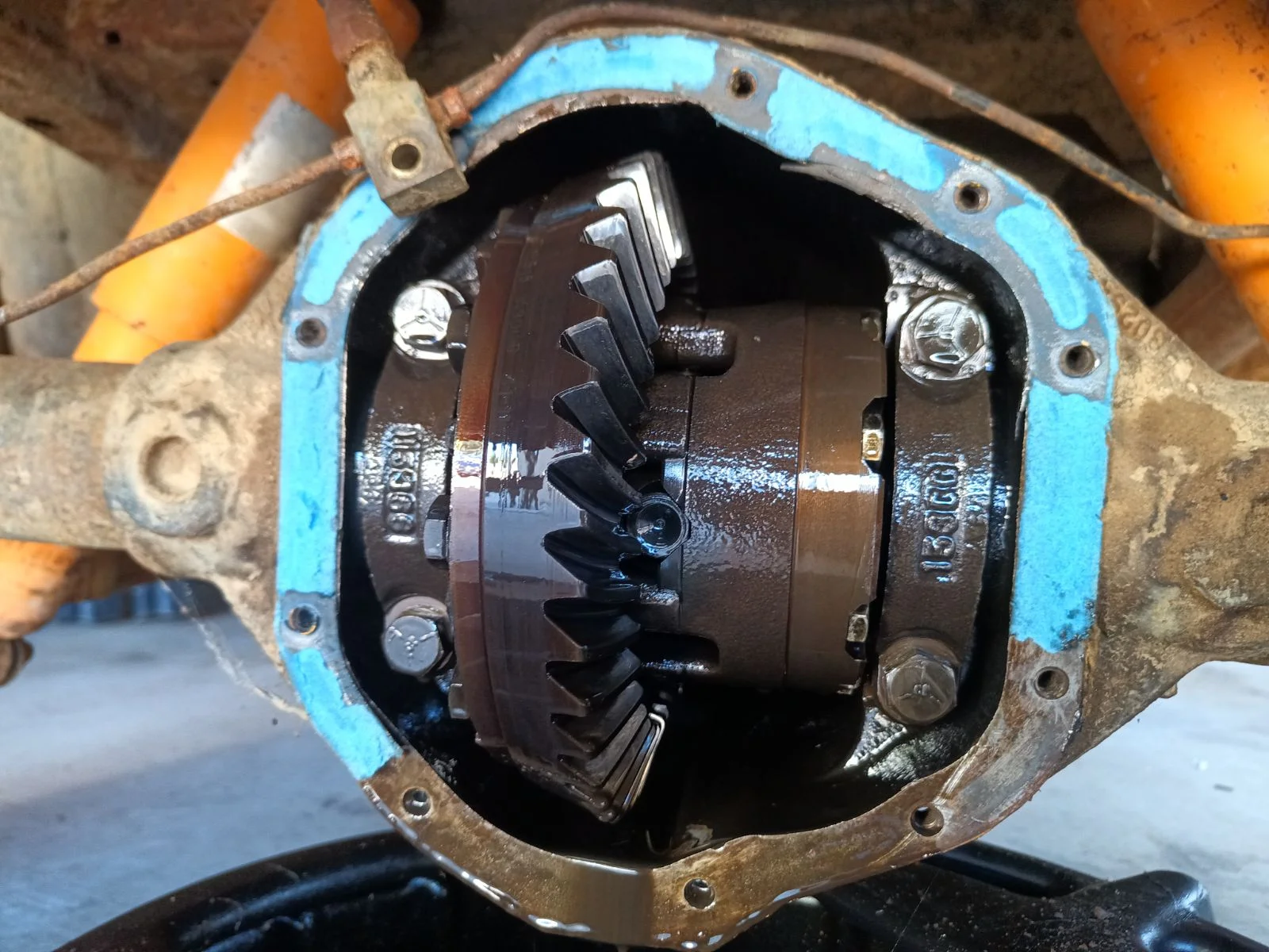

Good news is everything else still had gear oil in it and the rear Dana 44 looks fine!

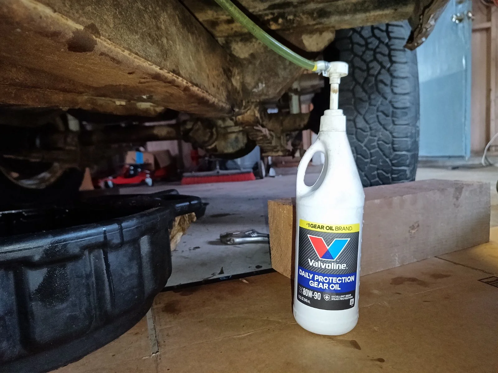

The precious fluid transfer continues...

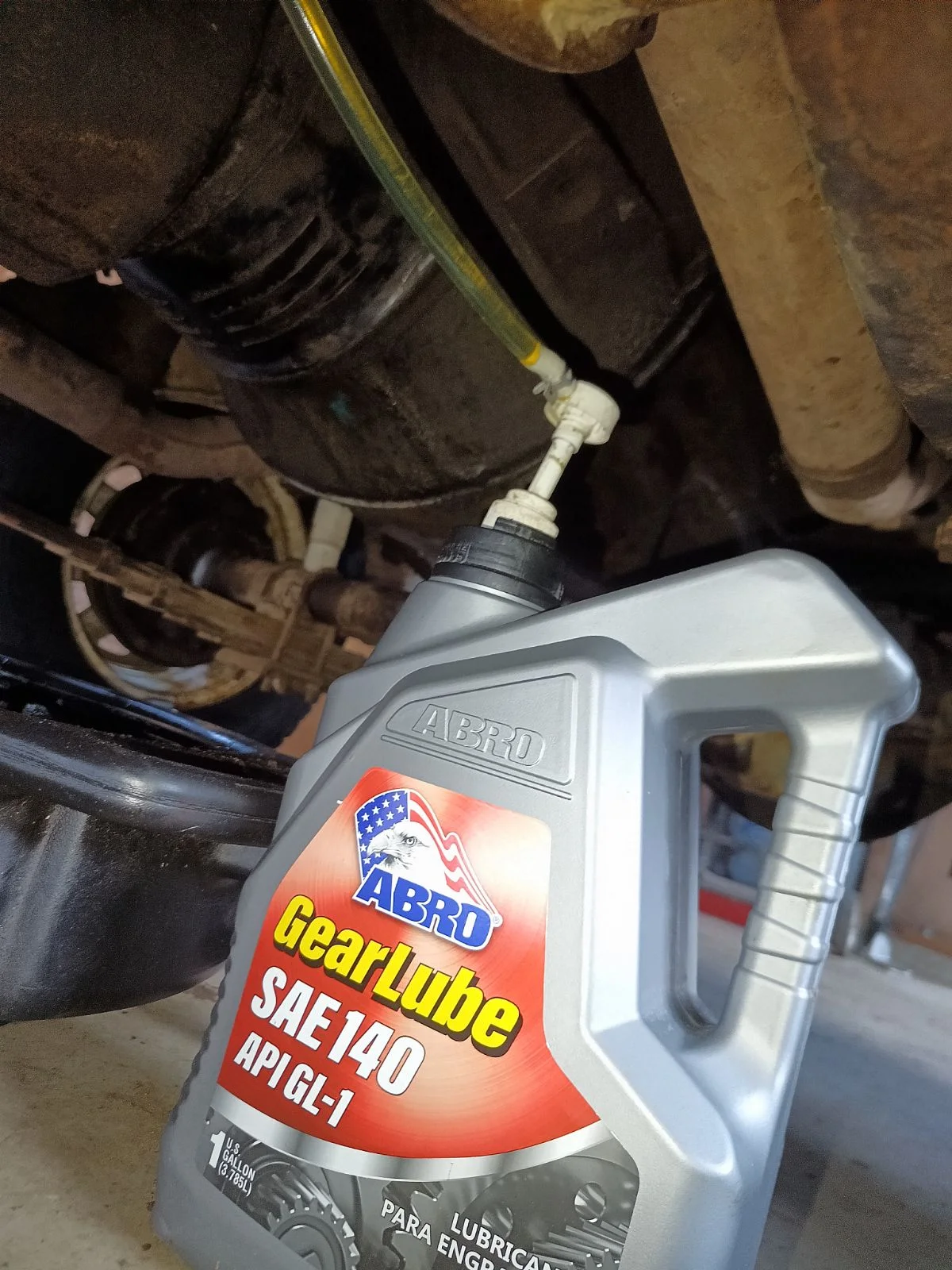

I don't think I've ever seen GL-1 in person, at least not fresh stuff.
