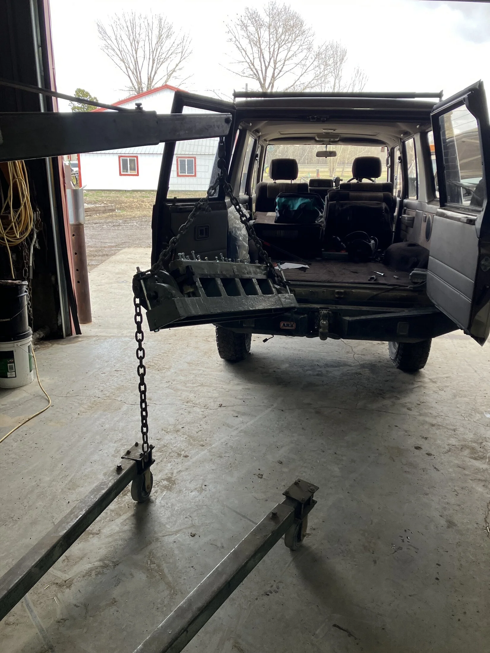

Got the finger brake unloaded from the Prado and mounted to its stand. The stand is fairly large (30"x42" footprint) so I put a shelf on the bottom to store more tools.
Used my landlord's backhoe with bale spears to fork the stand and load it into the back of the Loadstar. Luckily the spacing on the bale spears was just right to get two through the finger brake stand and the other slipped just on the outside of the box.

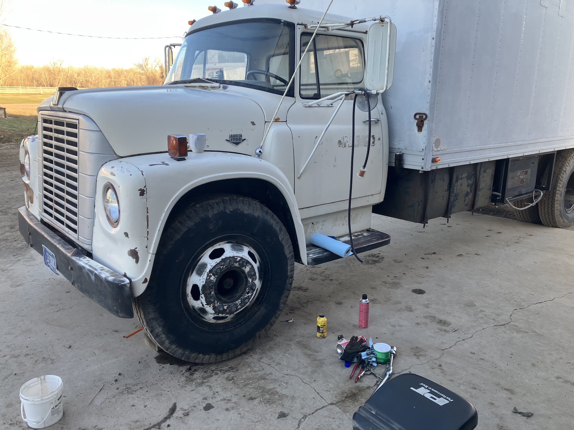

Later in the evening I moved the truck over to the shop apron to jack the front end up and investigate what it will take to get to the leaky front wheel cylinder. Got the wheel off and the dust cap off the axle nut but it was getting late (and cold) and I didn't feel like proceeding any further. Tomorrow afternoon is supposed to be pretty warm so hopefully I'll be able to rebuild the wheel cylinder and get it all back together.

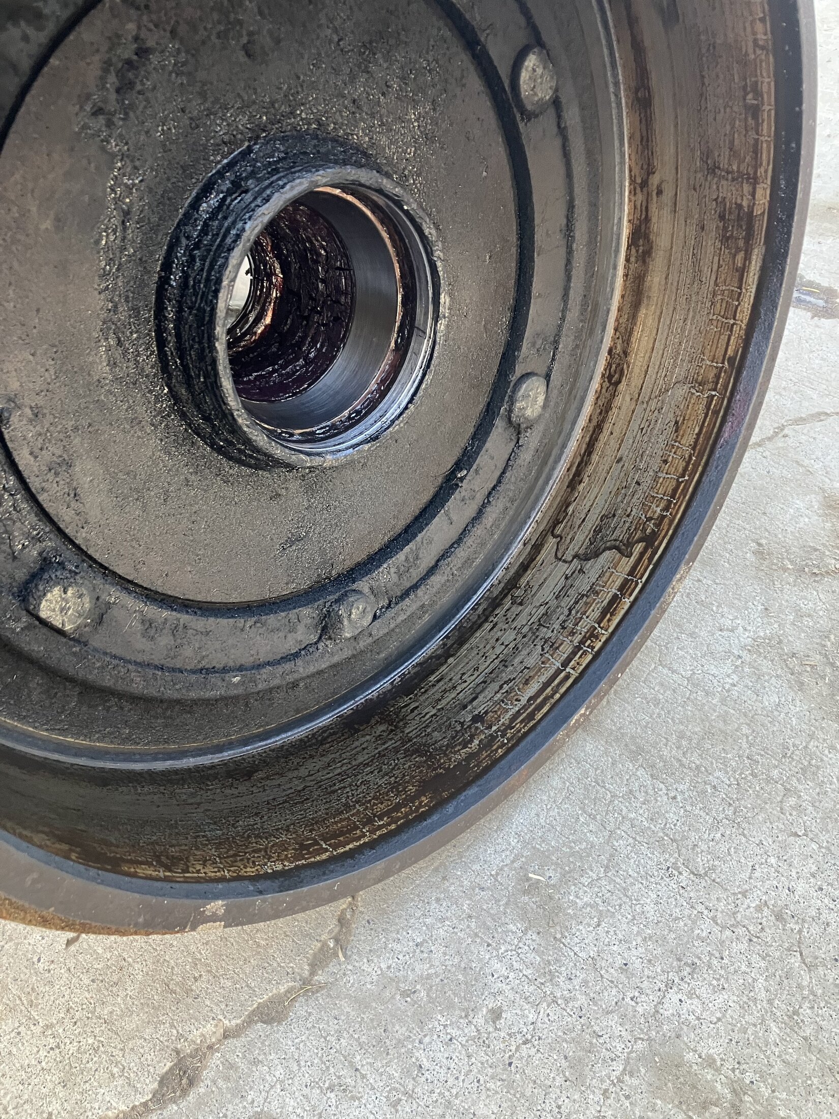

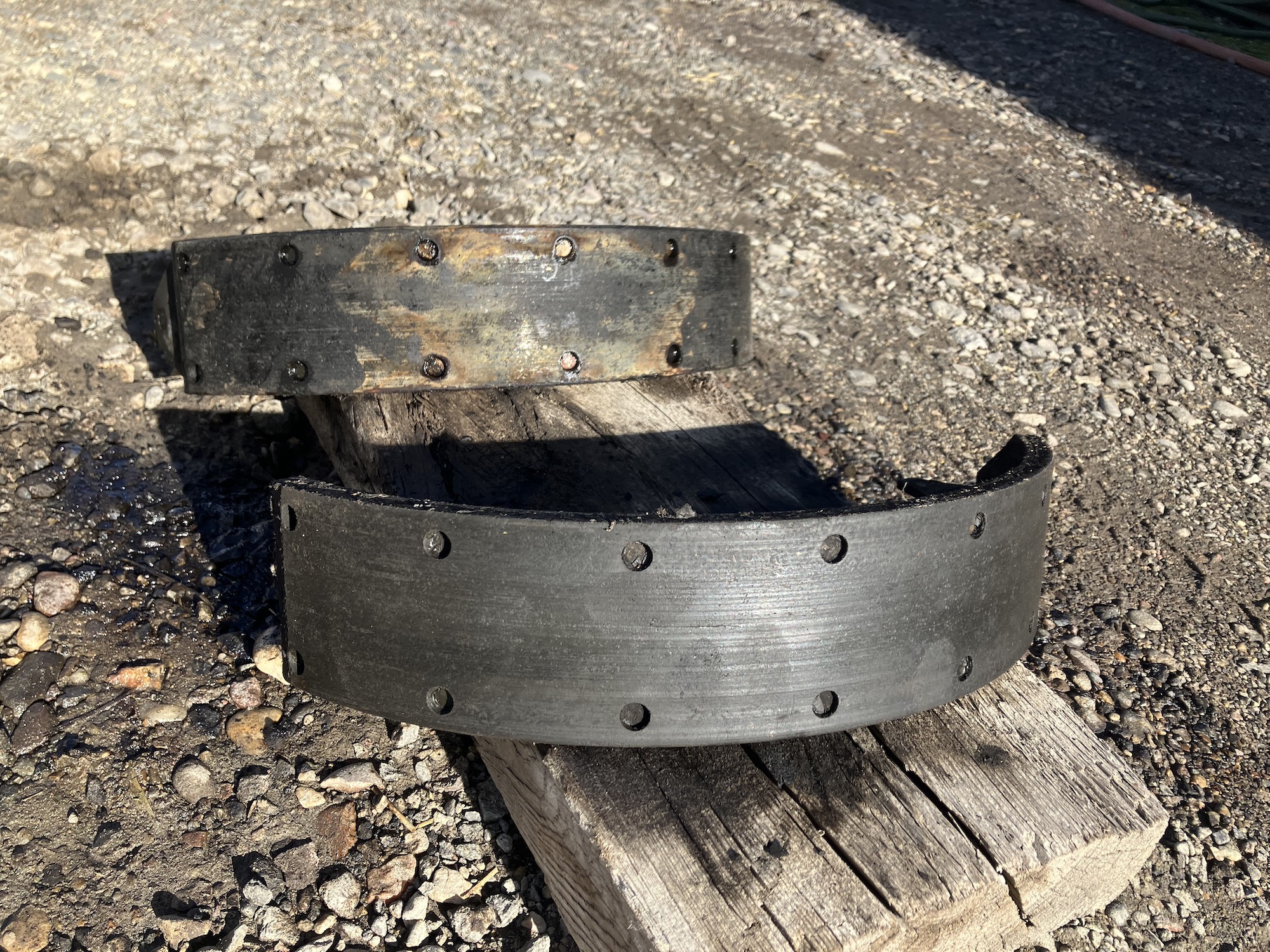

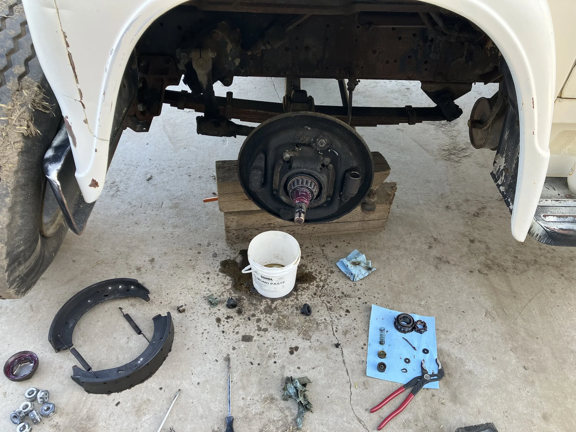

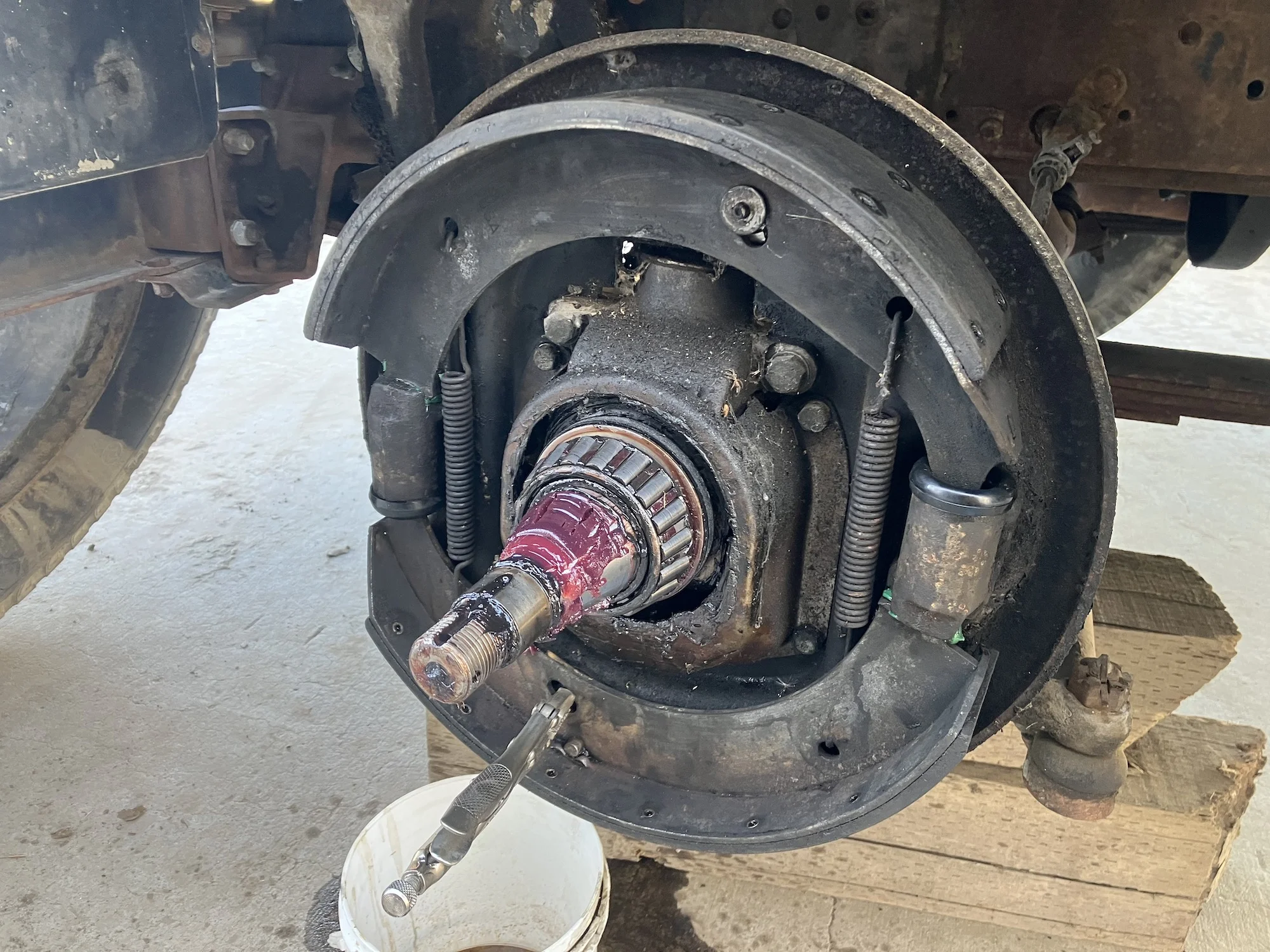

Brake day. I've dealt with quite a few drum brake systems but never one this big. Everything was quite heavy and extremely dirty from all the leaking brake fluid. Getting it all torn down wasn't too difficult though, apart from dealing with the brake shoe springs.
I had planned on only rebuilding one cylinder but had purchased two rebuild kits just in case; once I got the drum off it became obvious that while only one cylinder had leaked, the other wasn't far off. Fortunately both cylinders were ok apart from a bit of crud built up inside, a quick hone cleaned them up nicely. New cylinders are NLA for this truck, so I was very happy to see the bores shine up nicely on both of them. The shoes and drum were both soaking with brake fluid, it took two cans of brake cleaner to clean them up. Overall, apart from the fluid everywhere things looked pretty good. Lots of pad left, the drum was in good shape, and the wheel bearings looked really nice still.
Another fight with the brake shoe springs to get everything back together. I'm not sure if this was necessary but I put a dab of grease on each end of each brake shoe where it rests on the cylinders. I also thoroughly re-greased the wheel bearings before putting the drum and hub back on just to be on the safe side.
Back on its wheels! I haven't bled the brakes yet; thinking I should probably have a look at the brakes on the other side, they can't be too much different and might as well get them rebuilt now so I don't have to bleed the system twice.

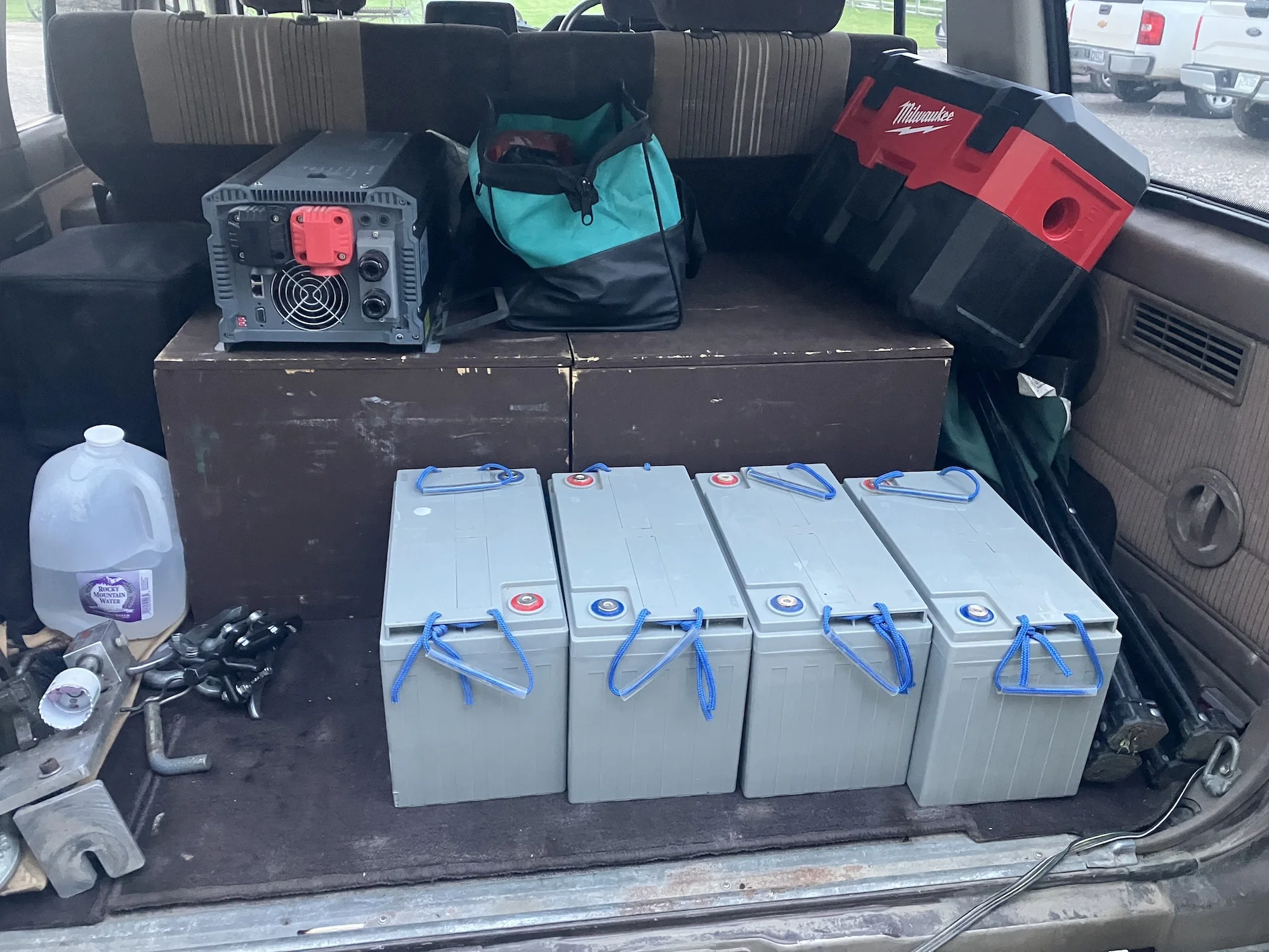

A bit of extra house power for the shop truck. Picked up 4x 100Ah sealed gel batteries and a 2000W pure sine inverter/charger. Will do AC/DC and DC/DC charging. The whole lot came out of a new camper, the owner switched to lithium batteries and sold this lot for $350.
A lift gate would be nice to have on this truck. Great deal on the batteries and charger.

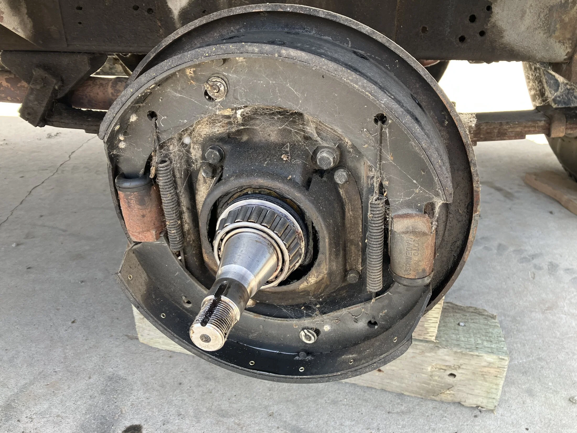

Finally got around to pulling apart the RH front brake, was pleasantly surprised to find the wheel cylinders in really good shape. Looks like they were replaced sometime in the not too distant past (at least relative to how old the truck is). I decided to just repack the wheel bearings and put it back together.

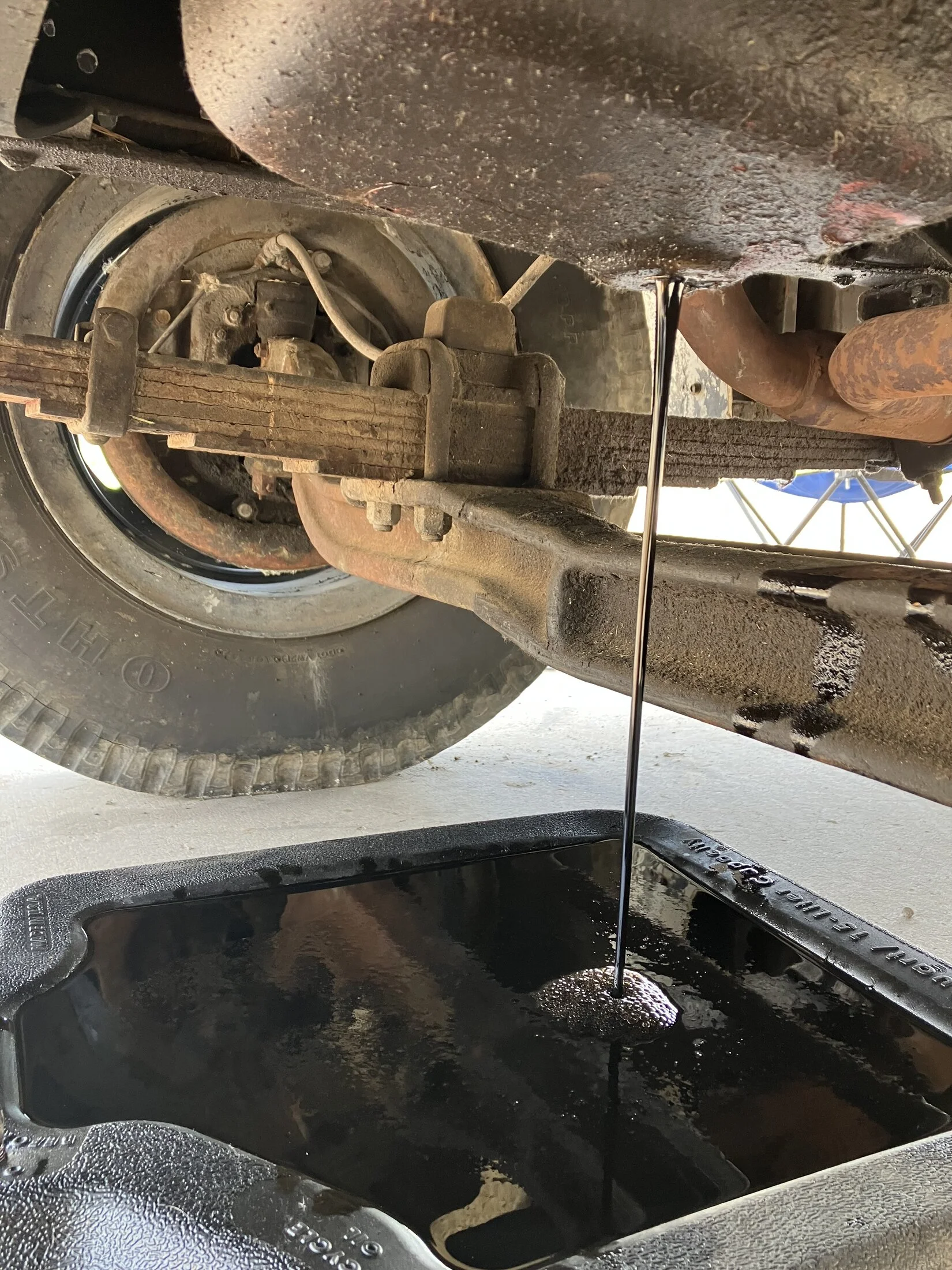

An oil change was also in order. My drain pan very nearly overflowed, but was just able to keep up.
This truck appears to have the larger oil sump and big filter, it took just shy of 9 quarts to refill.

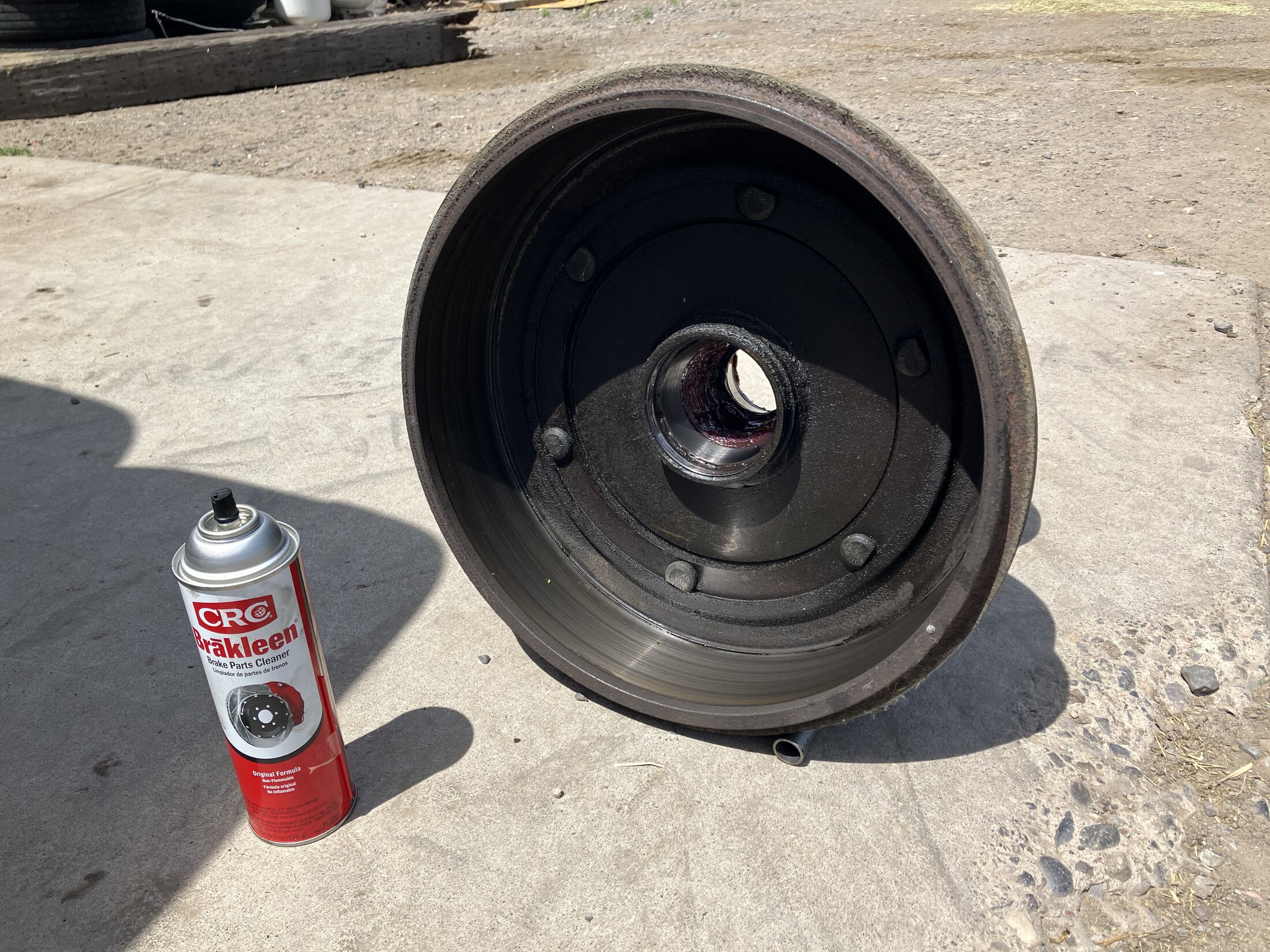

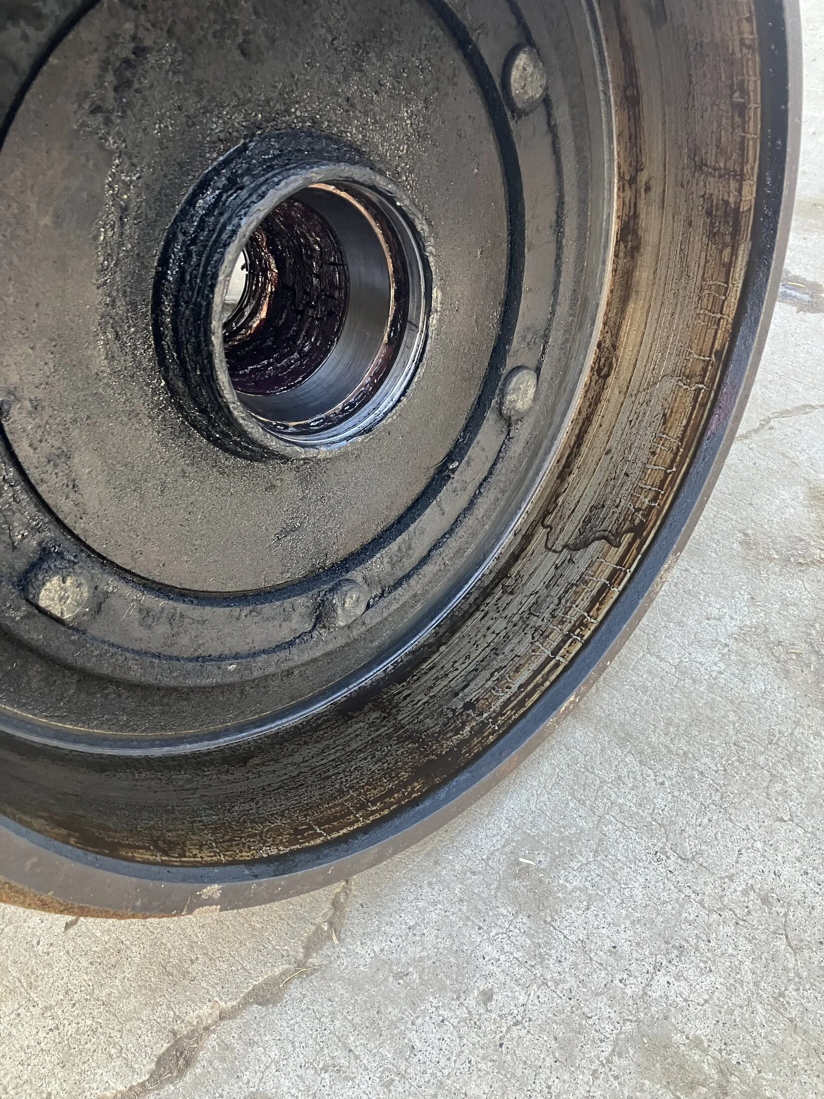

Hopefully you installed new hub seals as well. They were obviously leaking.
Unfortunately not, I didn't have them on hand and needed to get the truck back on its wheels by evening. The seal wasn't leaking too bad, I had just sprayed the inside of the drum and the pads down with brake cleaner before I took the photos, so it looks wetter than it was. Fortunately the truck won't see more than a hundred miles or so per year, so I'll just keep an eye on them.
Generally on these type of things i go ahead and replace everything rubber that contacts brake fluid.

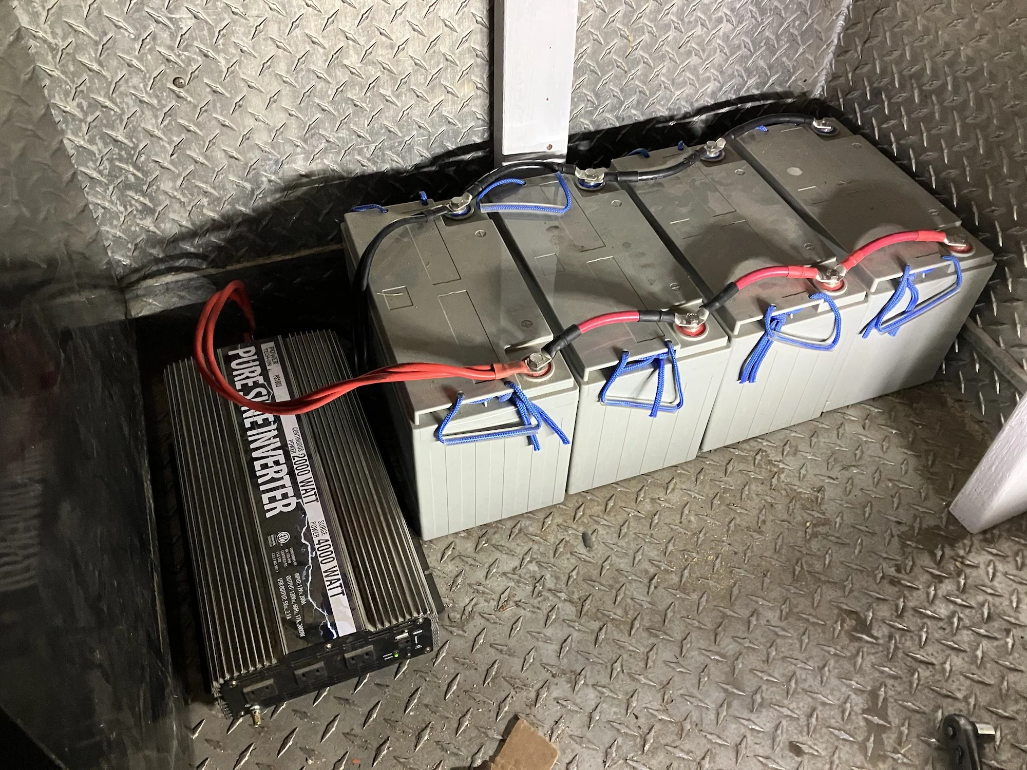

Still need to make a mount for the new generator, but I did make up a bunch of cables for my battery bank. Hooked it up to a 2000W inverter to try out, eventually when I permanently mount the batteries I'll wire up the 50A charger/2000W inverter they came with. I also have a cheap fuse and relay box that will get used for powering lights and any other 12v accessories I end up needing inside.
