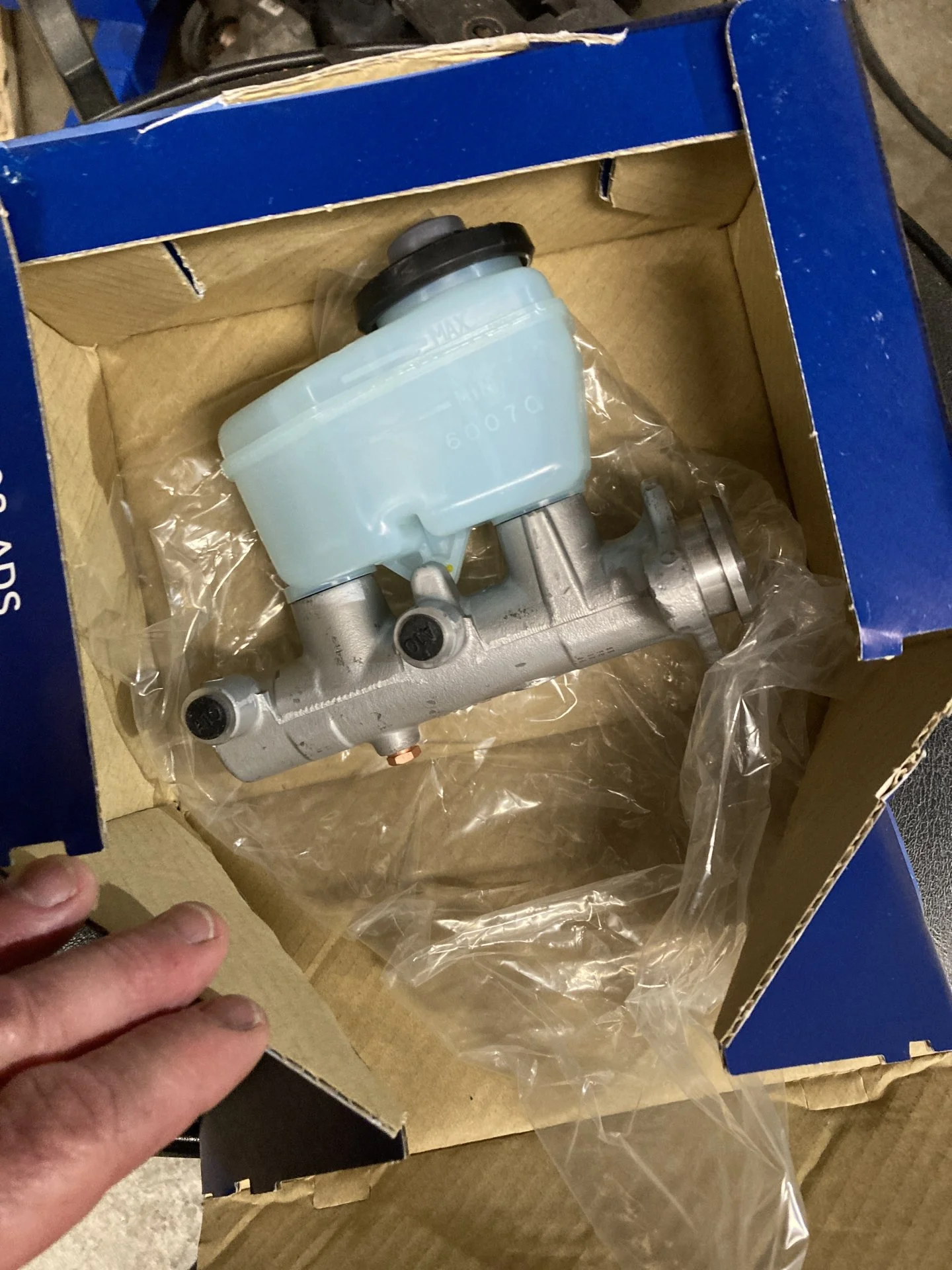

I have been told to just use the FJ80 Non/abs brake master cylinder. I am in the same boat.

I believe that using the fj80 master cylinder still applies in this case. With the master cylinder being on the other side of the rib supports if you were to add a booster plus the master cylinder, it would possibly hit the carb. Somebody correct me if I am wrong.

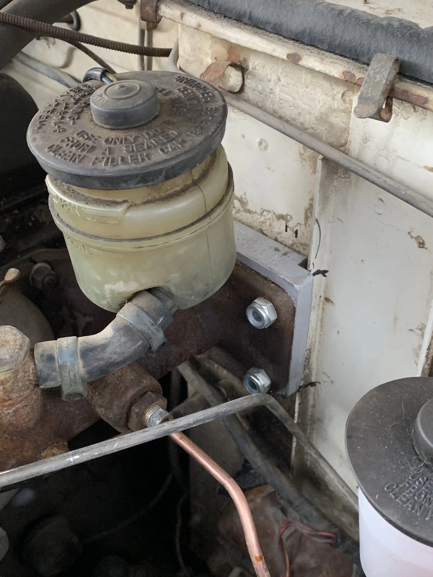

You can add an adapter for a dual brake cylinder
Tandem Brake Master Cylinder Firewall Adapter for Toyota Land Cruiser FJ40 FJ45 – JT Outfitters - https://www.jtoutfitters.com/product/tandem-brake-master-cylinder-firewall-adapter-for-toyota-land-cruiser-fj40-fj45/

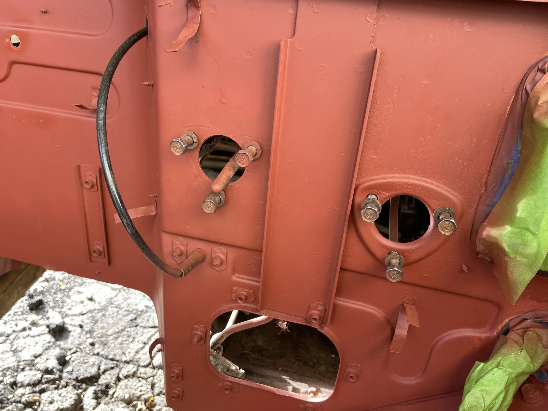

If you want to add a booster, there's a few threads in the 40 section where people have done it. I've done it on some South American trucks, but it always involves some fabrication on the firewall to fit the booster. I know a few have used an early Bronco style booster which angles it a bit to avoid the carb which can be a problem.
JT Outfitters makes a adapter from 3 bolt to four bolt. It will require some modification so that it clearances around the vertical support. I have it in my 68 with a mini truck master cylinder, no booster.
