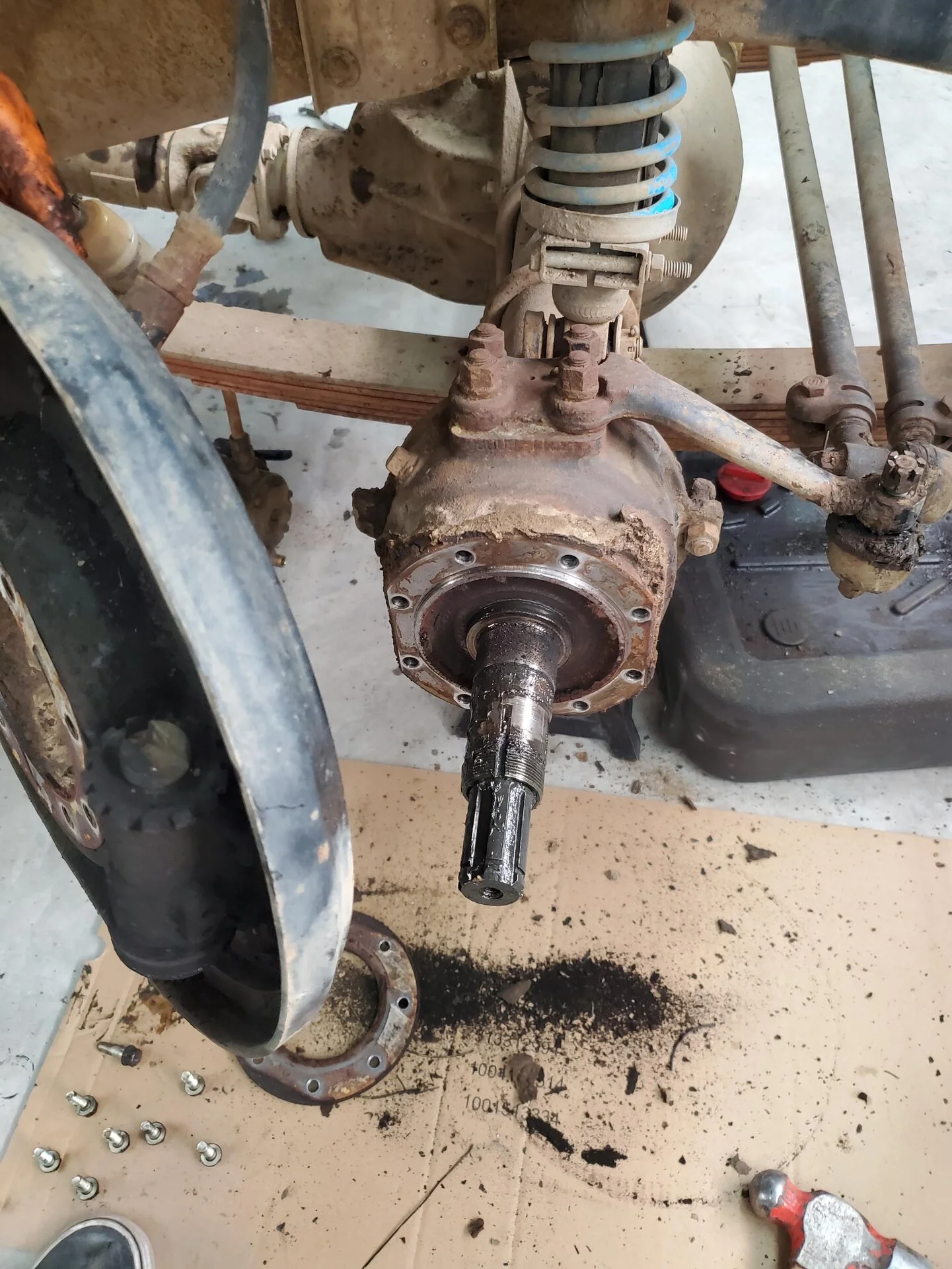

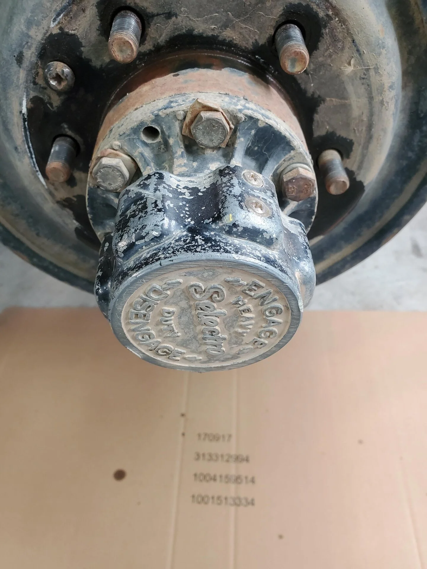

Front axle disassembly in case no one has done an early 40

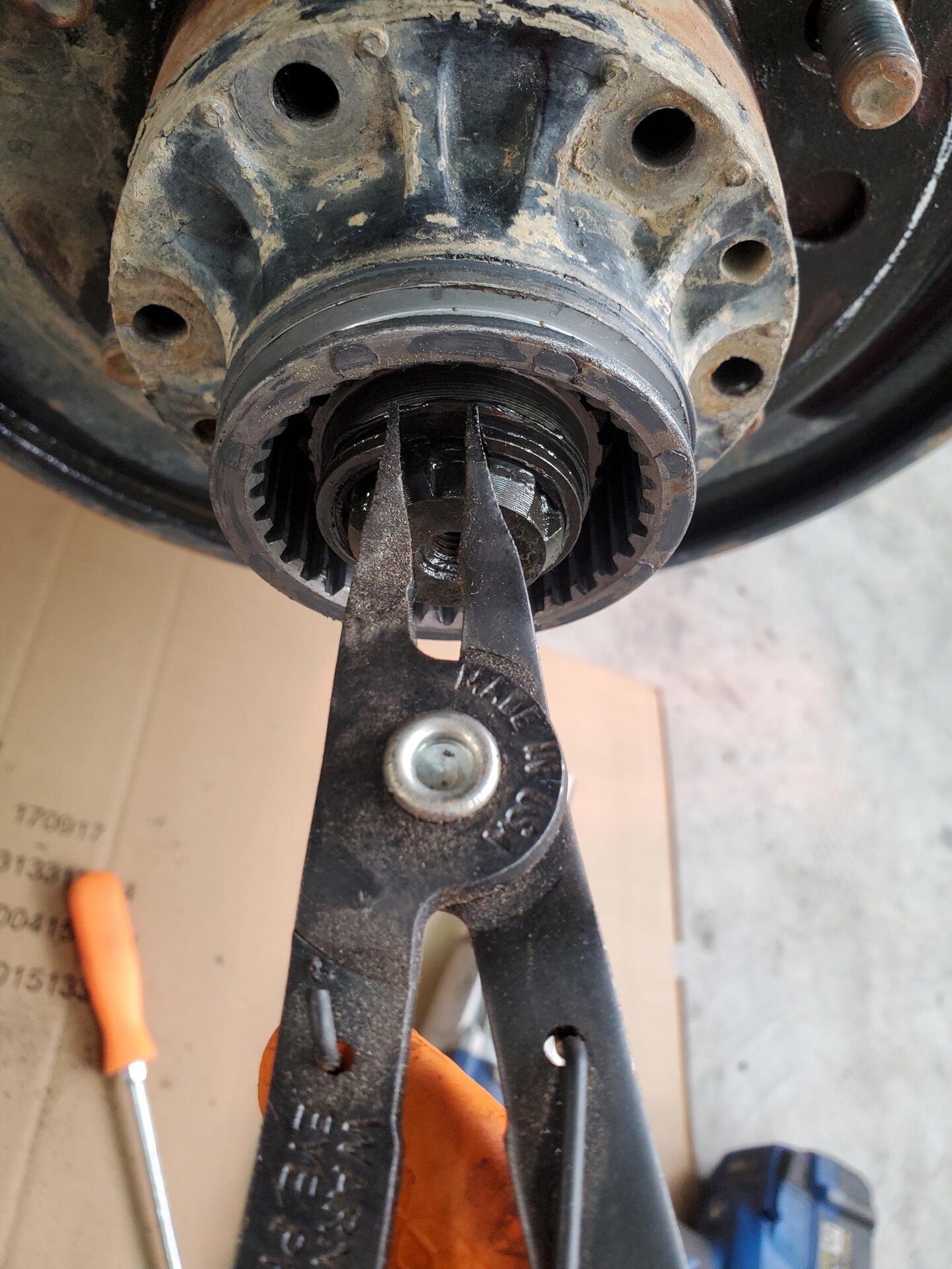

start by removing the INNER 3 Philips head screws on the locking hub. Its so messy you cant even see the outer screw head. You can remove the outers first if you want, but that just disassembles the hub locking mechanism for rebuilding (and I'm not rebuilding these).

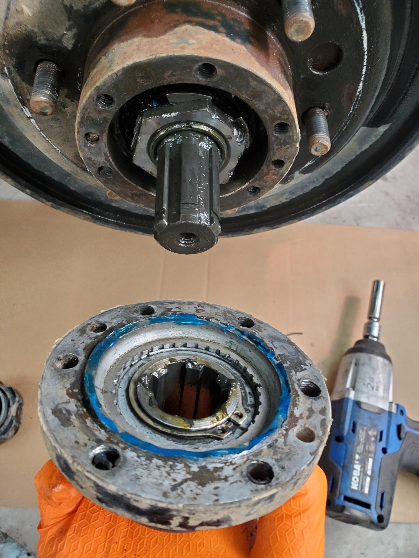

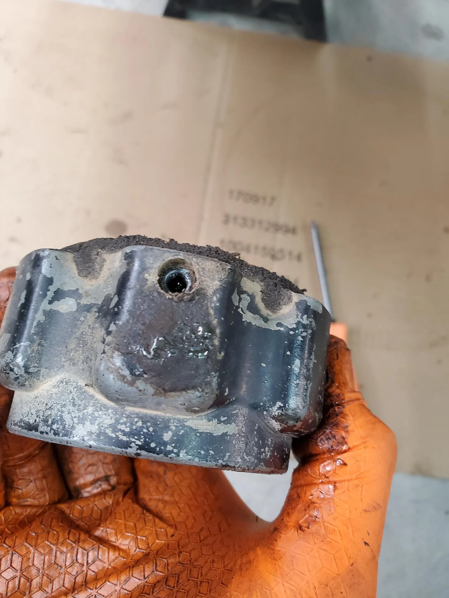

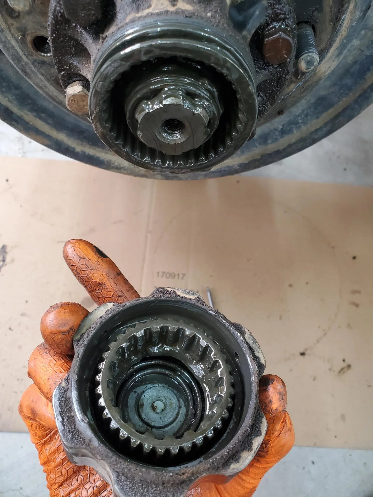

Next remove the snap ring and the 6 bolts holding the locking hub in place.

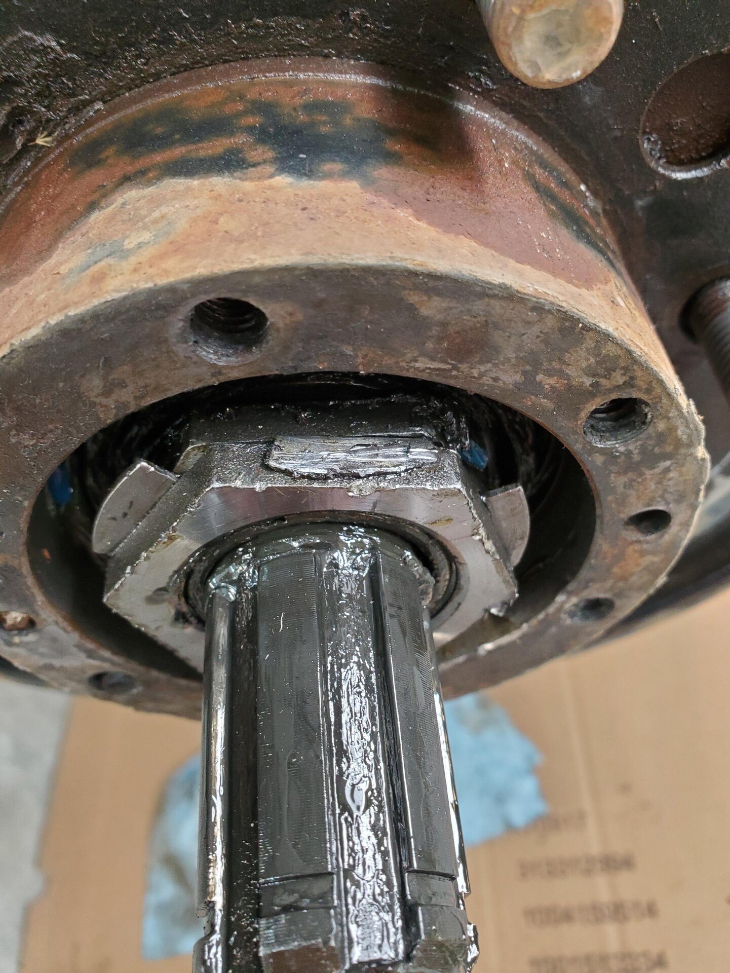

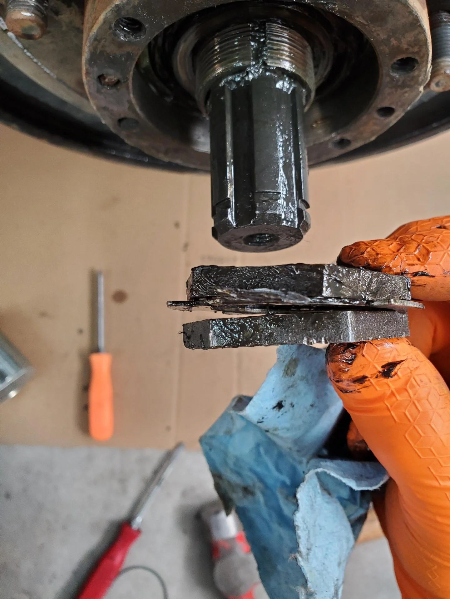

You will see the double nut with locking ring in-between. Pry up the locking tab then remove the nut, locking ring then the second nut.

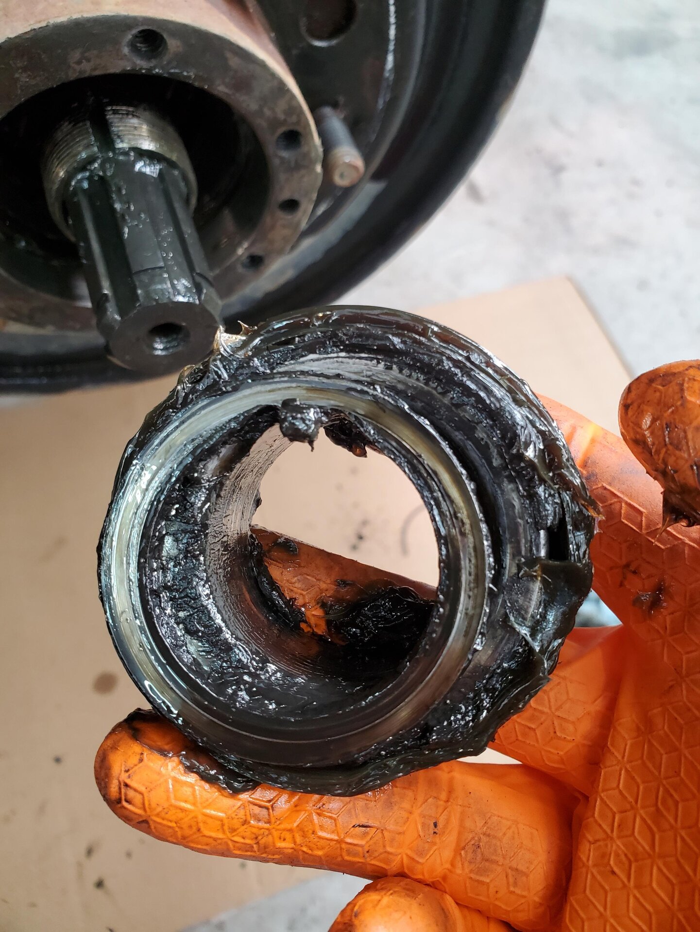

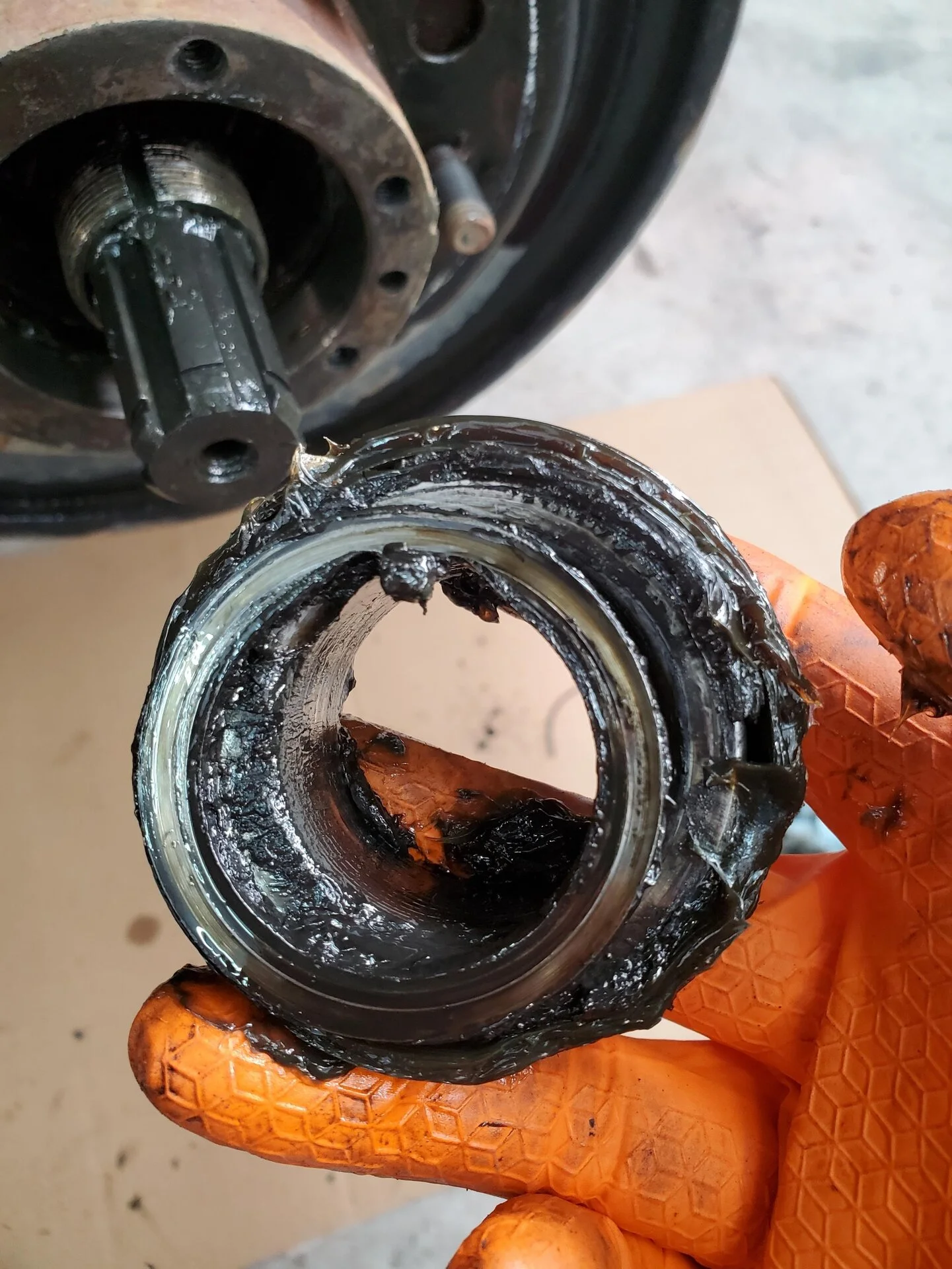

You can then use a pick or whatever tool you want to remove the heavy washer and outer bearing.

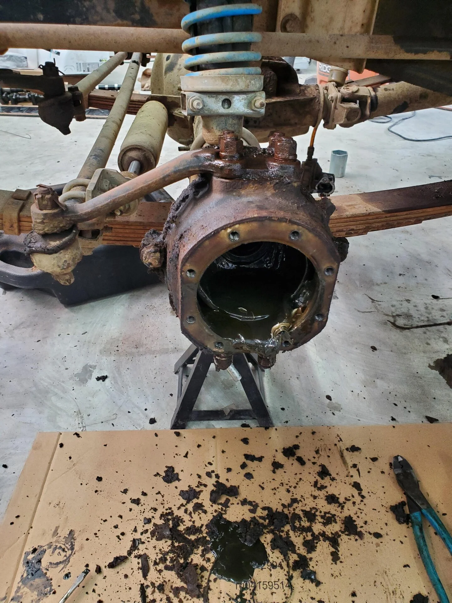

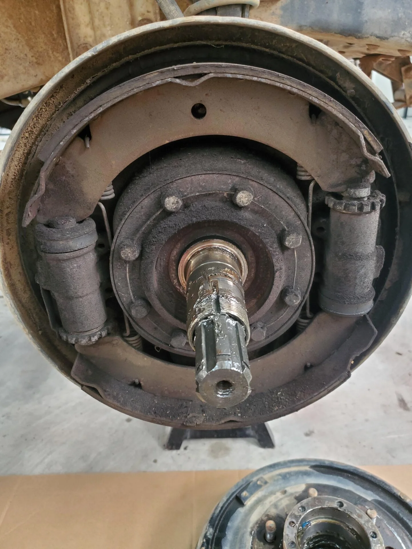

you can then slide the whole hub/outer drum assembly off giving you this view.
I then removed both springs and both drum shoes, clipped and removed the safety wire and remaining 8 bolts.

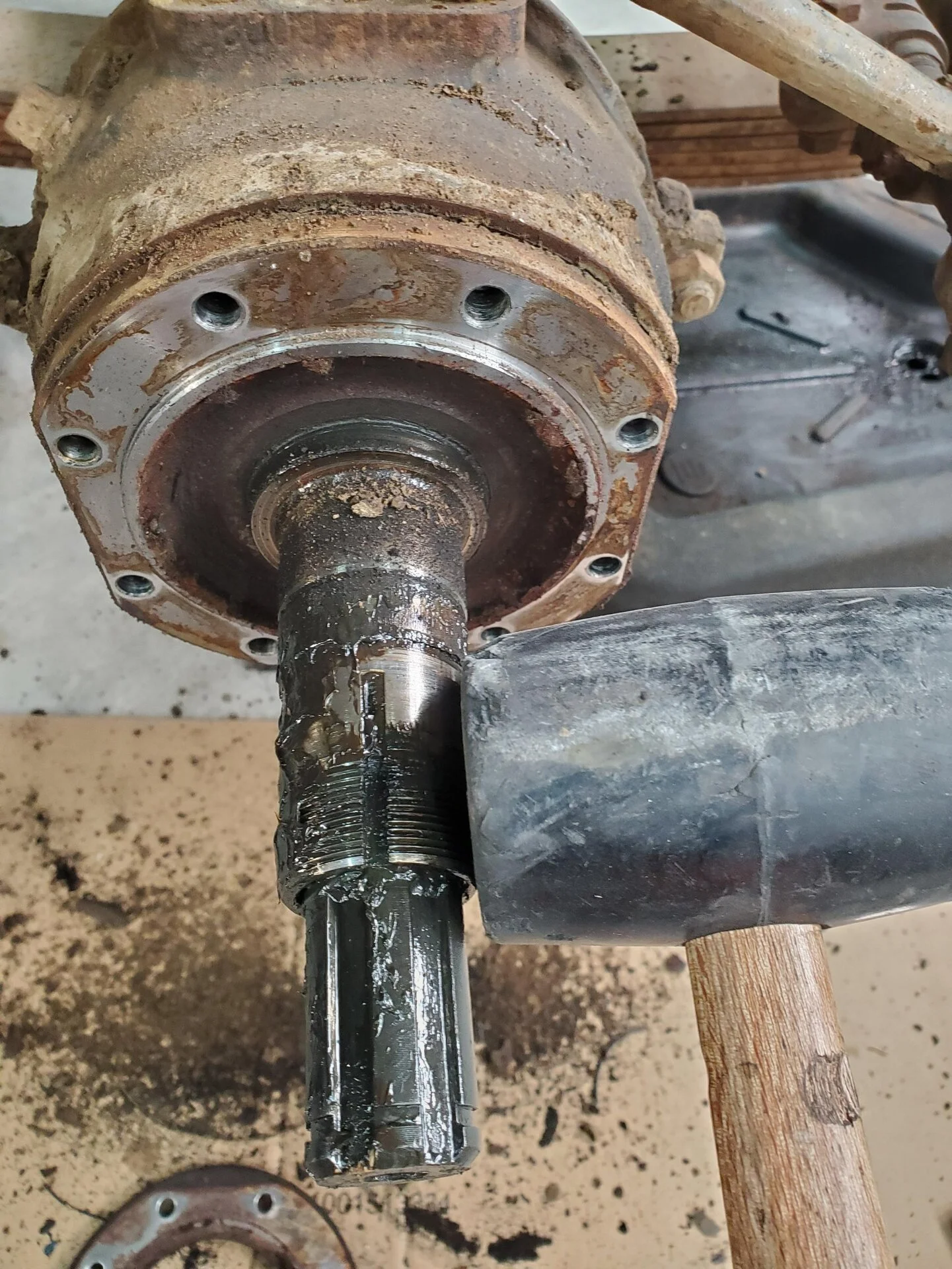

I used a rubber mallet and hammered as shown to remove the spindle sleeve and then gently removed the axle.

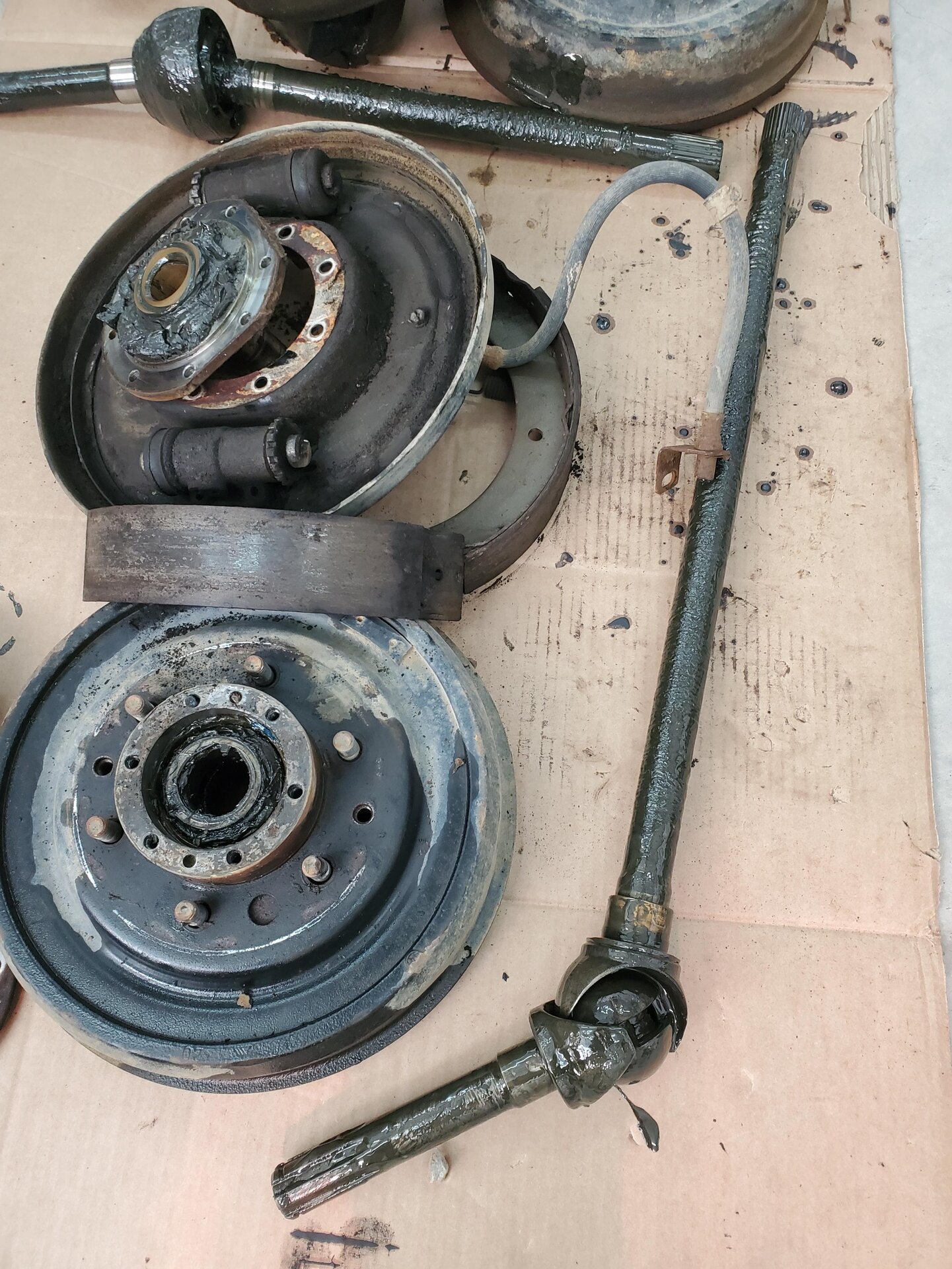

Here are the leftovers.
I assume someone had done some repairs at some point in the vehicles life, because it has one birfield on the passenger side, and a ball joint on the driver side. This sucked because I had to source a birfield inner long axle. Has anyone experienced anything similar finding the two different types of axles in use?

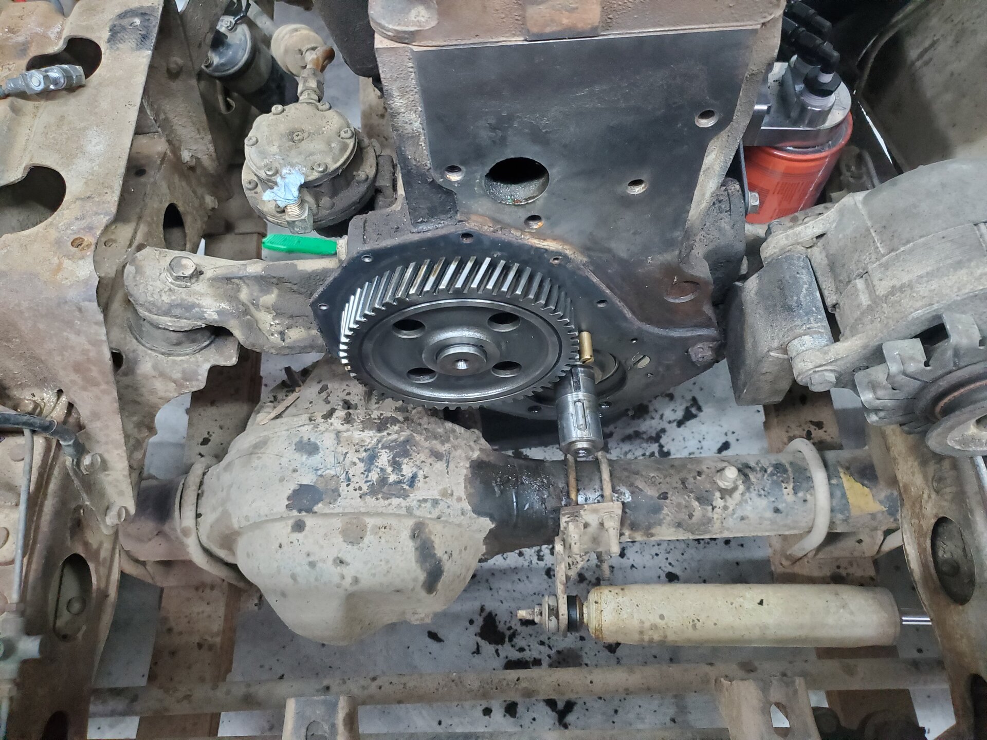

Does the axle housing have an inner seal or a bushing?
Those are some fancy coilovers ;).
Looks like the main steering rod is bent.
I have a complete set of ball/spoon axles if you need them, short and long and both fine spline inner, coarse spline outer. If it’s a 69, should have briefs on both axles.
It does have an inner seal, I have more pictures incoming.
I do believe the main steering shaft is bent, but with the 60/62 knuckles I will need 60/62 tie rod ends and Im not sure yet but also the main steering rod as well. updates to come.
