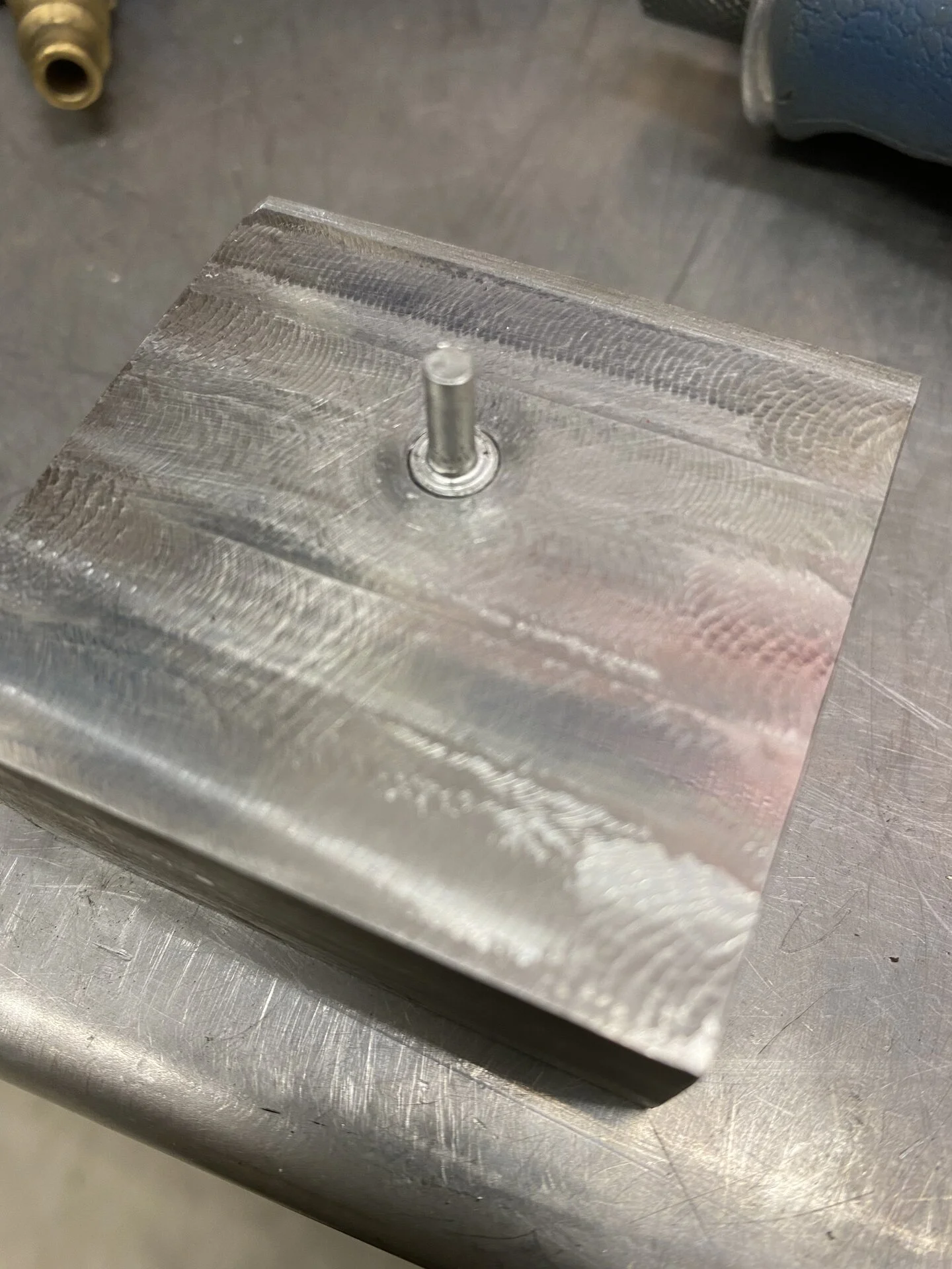

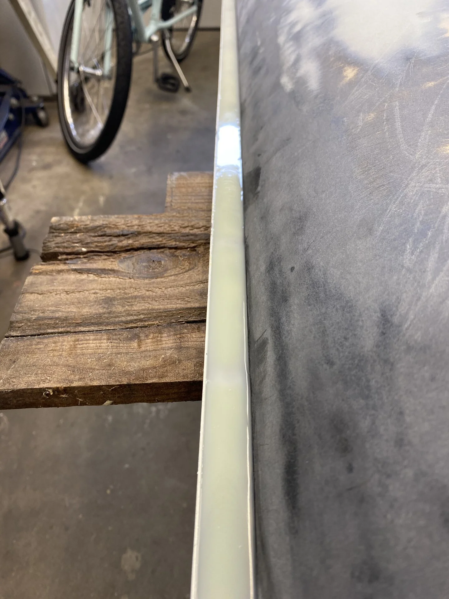

Well I cranked down the air today and machined a backing block that helped keep the shape of the head of the rivet. I got them all in, had to replace a few and found two more I don’t like. But all in all I think it’s nice and secure.
For the ones I had to remove, they were a bear; so that makes me feel like this will hold up well.
I applied the seam sealer to the cap today and was surprised how well it applied. Things don’t usually go better than expected for me. Haha.
Anyway I was also extremely lucky in how much sealer I had. I bought 3 tubes of 3M 08307 and literally had bubbles at the last inch. I was super scared it wasn’t going to make it.
Anyway we’ll see how it cures. Got my fingers crossed.

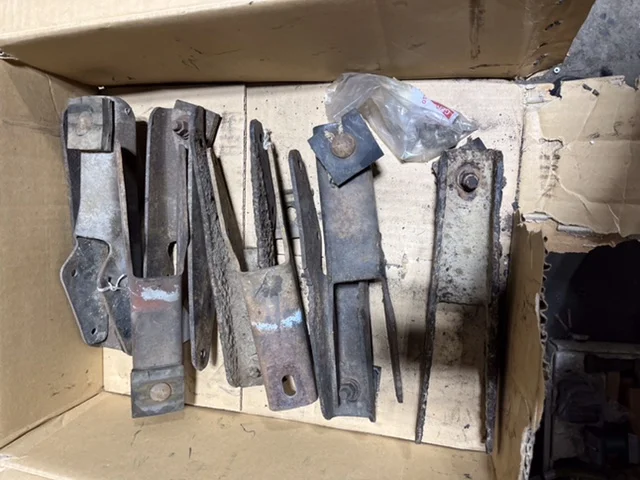

Shane, I found the box! The irony is that I have done so much cleaning before I found it that I have more running board stays OUTSIDE the box than in it!😛 Nine in the box, but at least 12 more on the shelf with the A pillar frame supports.

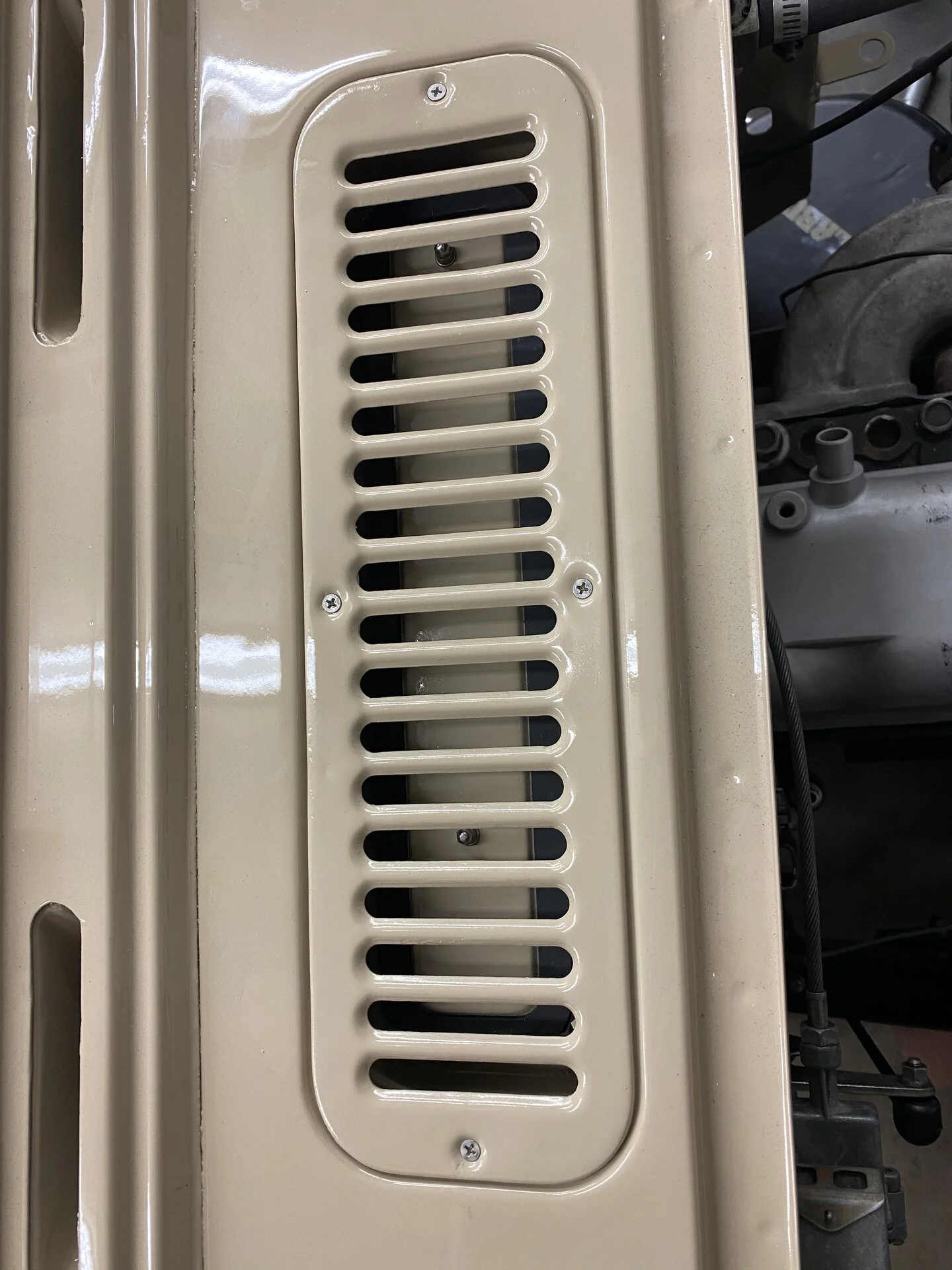

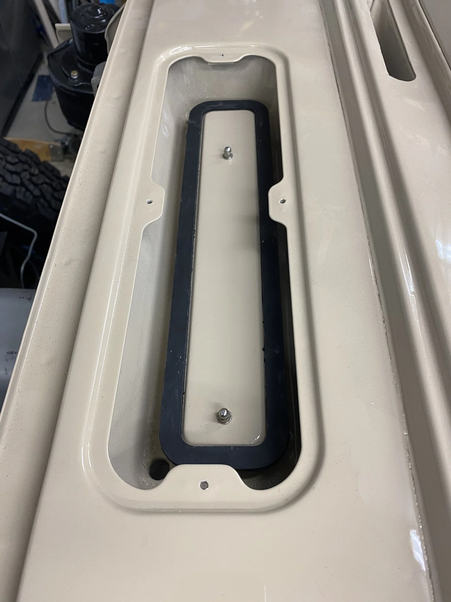

I had assembled the cowl vent and as I stared at the fasteners I said to myself “that will probably rust quickly there.” So I picked up some stainless washers and acorn nuts. Those things were like $3 a piece.

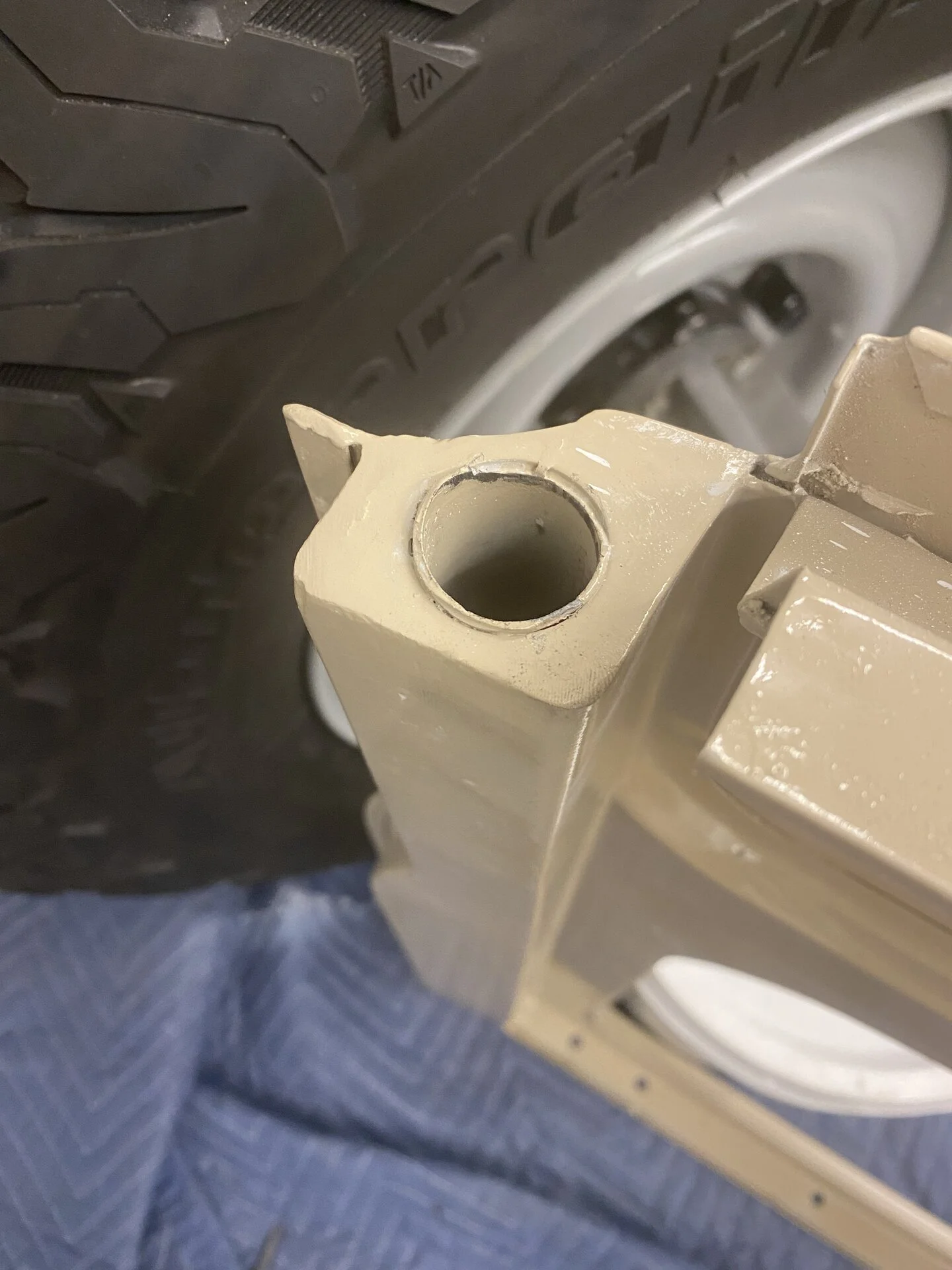

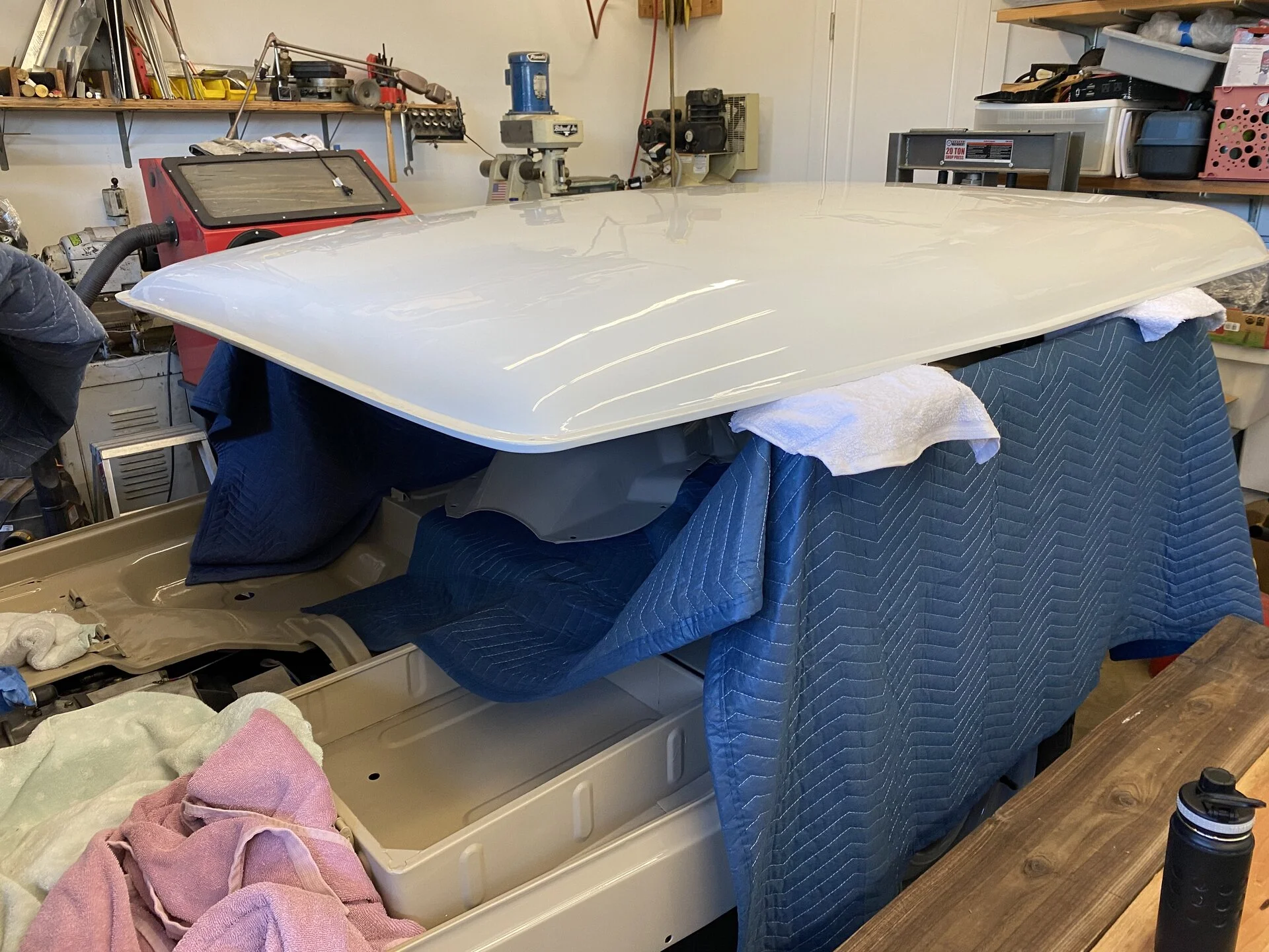

Well I’m trying to get some room in the garage, so I’m putting the top on loosely with some work to go along with it. Had to clear some threads and make a post for the driver side. I didn’t know the side still had a broken off post on it, so had to turn a stepped post to fit. It took a couple adjustments to get the fit right.

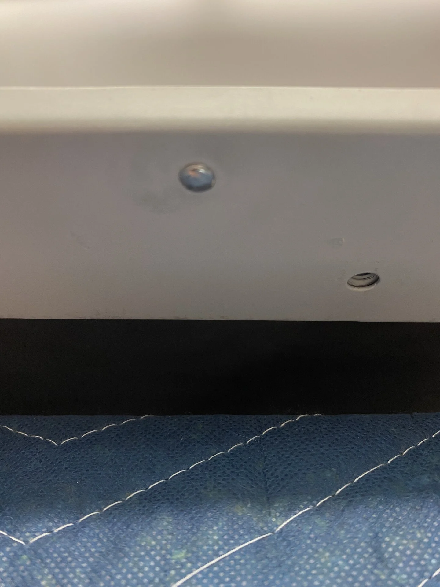

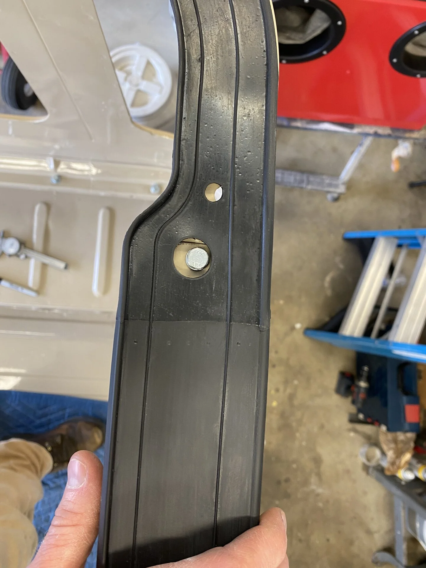

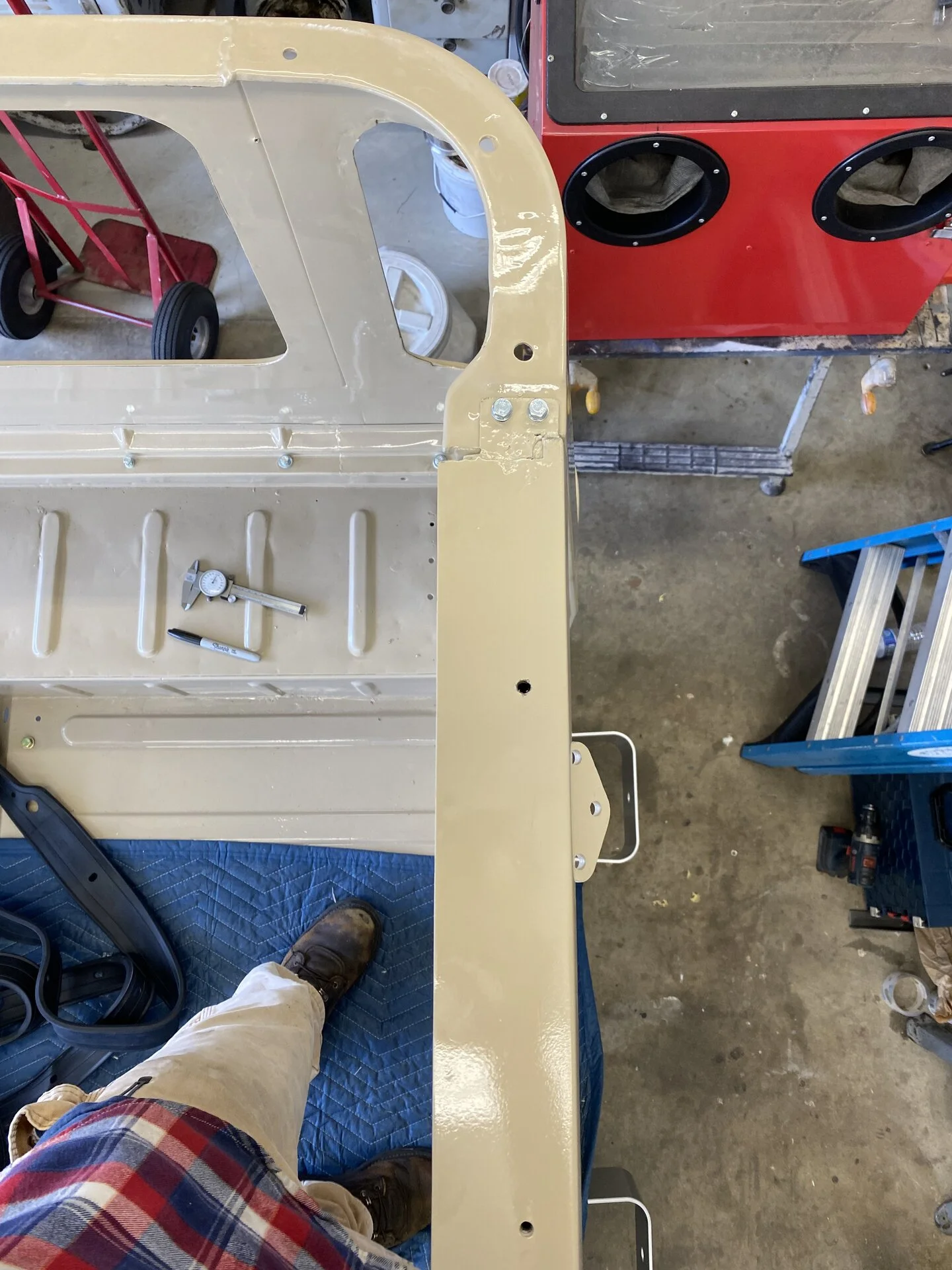

Royal Cake, restoration is looking great! I love that you choose an original 1969 color (happens to be same color as my original owner 8/68 FJ40). I cannot help you with the two fasteners where the curve of the rear windows begin yet only one on your gasket. I have never taken my roof off and never had a leak. I am away from my FJ right now but I can let you know what I find in a couple of weeks. I expect someone else will know the answer to your question be then.
Shane
The roof weatherstrip went through about six iterations IIRC, the most modern of which is the only remaining one still available. And yes, the newest hardtops used only one fastener per side. So you should plan on cutting the second hole yourself.
A bigger challenge awaits when you get to the front doors and find the perimeter weatherstrip Toyota offers now makes no account for the door striker alignment plate. :bang:
Thank you sir! I do like how the Colorado Beige turned out. Cheers!
Shane
Thanks Mark. I was ready to punch out the other hole, but I thought I should ask in case I was doing something dumb.
I don’t look forward to the final fit up. One step at a time I suppose.
